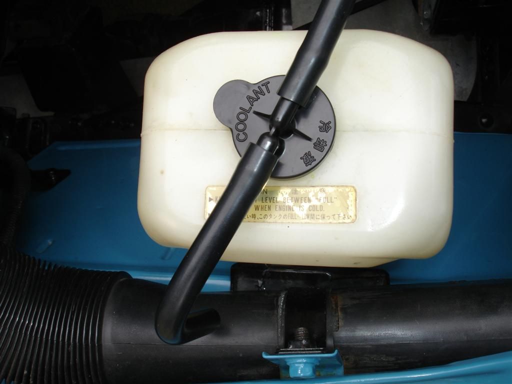

And your cap has caught my eye..
Is that original to that bottle (because your bottle looks the same as the one on my 1979 which has a different cap):
Is that original to that bottle (because your bottle looks the same as the one on my 1979 which has a different cap):View attachment 1017868

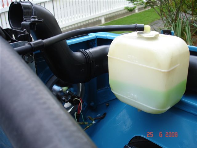

Marbles - Shouldn't you have two rubber hoses connected to your overflow tank? Maybe I'm missing something, but should your overflow tank fill, where does it discharge? :meh:
My '77 has the round overflow tank. The hose off the radiator is connected to the bottom of the overflow tank, and the overflow tank's discharge comes out the top.
(Maybe it's the angle of the photo, and the discharge is directly in line with the intake on your overflow bottle?)
I do believe it is original. Part number is 16405-56011.
Next question.....Do you know if it is still available?
I discovered the 16405-61040 cap (used in some 1990s models like the FJ80 and HDJ80) fits mine if you simply cut the hoses shorter...(because my 16405-56020 cap is no longer available)
And here is 16405-61040 fitted to my reservoir bottle:

My air-discharge is through a tiny pin-hole arrowed here:
And underneath there's a droplet-trap arangement:
(I made a replacement cap for myself from that bit of Nylon rod so that's why that's in the photo.)
You can see I've arrowed a hole in that droplet trap too. (I can't remember if there's just one there or more than one.)
