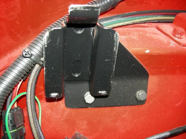

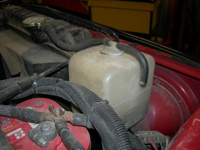

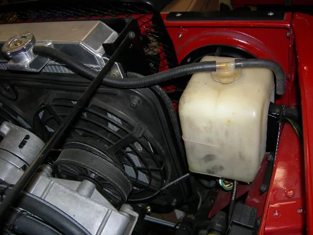

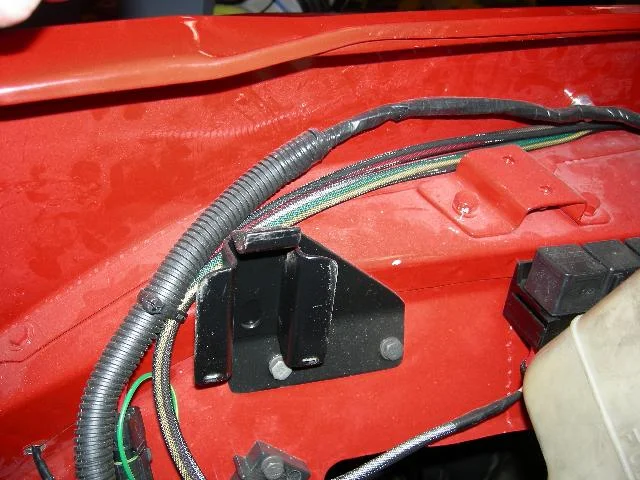

The 60 series trucks have a great coolant recovery tank system that I have installed into early 40 series that did not come with them.
These pics are of the bottle and mount that I am running in my junk:
Another truck in the shop...
This configuration put the tank on the passenger fender with a little braket I fabricated and welded the Toyota bracket to:

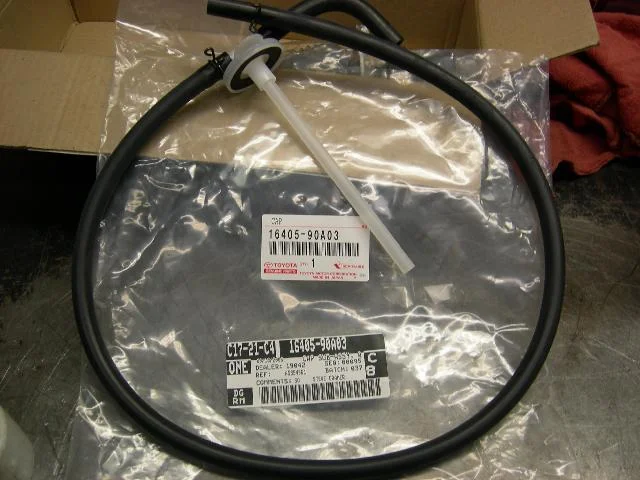

Herb, if you pay close attention to the FJ60 bottle assembly pics that Poser posted, you will notice that where the hose goes into the bottle, it goes in via a tube that extends down into the bottle. The older units also had a tube, and the ones before that fed the coolant in from the bottom.
The point is that if your 'feed' either goes in from the bottom, or reaches down to the bottom, it will 'draw' back in to the radiator better, and will also help reduce blowby from the bottle.
