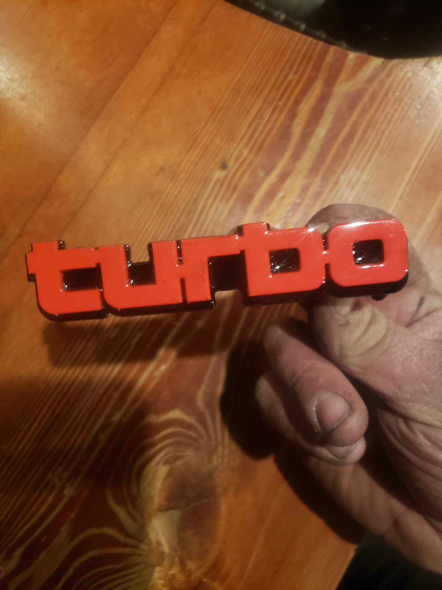

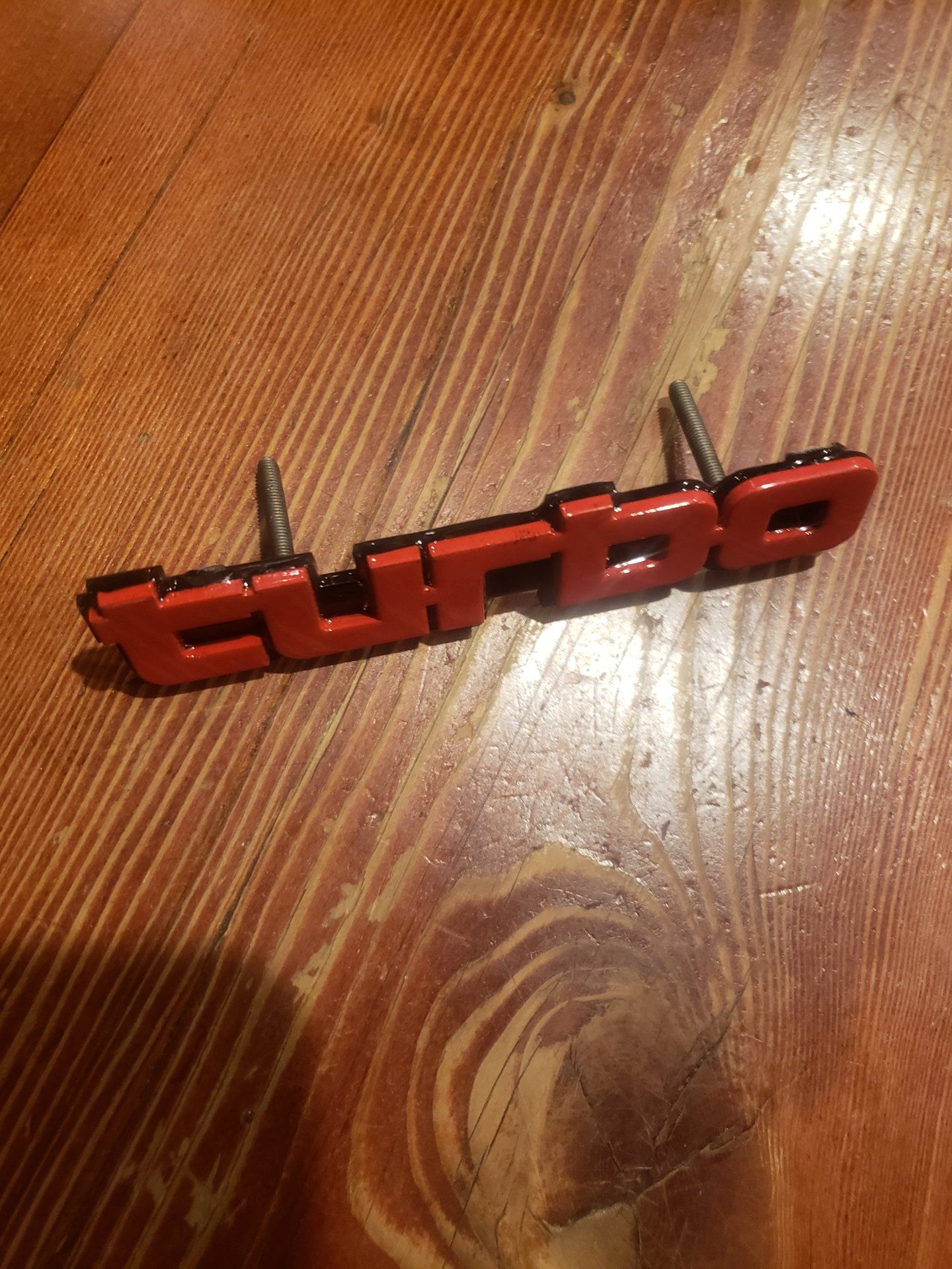

One thing I have been working on is a repro "turbo" logo for many months now. They are two pieces of laser cut stainless that are powder coated and glued together with powder coat clear. I gave one as a gift to @CenTXFJ60 for getting me the dimensions from an original badge he had. Today I coated another with studs on the back to mount to my grille. Unfortunately, I will have to redo it because the red script part drifts on the lower black part before the clear powder coat cross links and slides off center. Once I conquer this issue, it will be a pretty accurate badge. It looks pretty cool though. More to come.

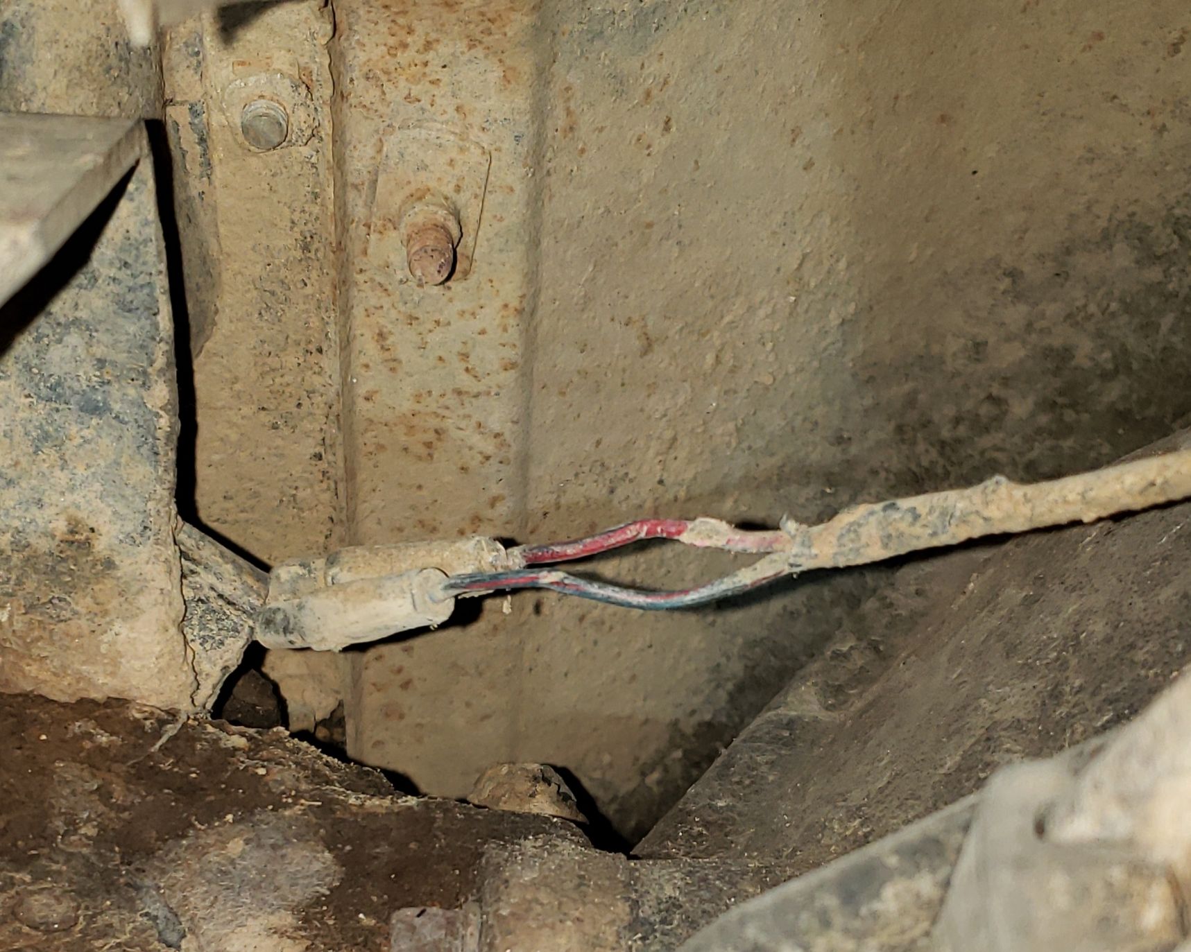

Dude, that’s awesome work. I’ll be a buyer for 3 or 4 if you go into production :). Also, question for you Pat...if you have time can you check the wires that connect to your Reverse light and 4WD switch on your trans and T-case? This is on the 55. If you recall, they cut the harness on this one down. Y the starter and I’m having a heck of a time deciding them via the service manual. Thanks. Jimmy
It's supposed to be cold tomorrow but nice. They evil salt trucks haven't hit the road yet either so I was thinking of driving the 55 tomorrow anyway. That's good incentive to do so. If I do I will crawl under the piggie and see if I can figure it out for you.
The two pieces are cut out of stainless. The base is black powder, only gelled. The top is red. Then the two are overlayed and have clear powder over both. Once melted together and crosslinked (cured) they aren't coming apart. The problem is keeping them from drifting before they cure. I'll figure it out at some point.
Put the studs on the red Turbo and habe them pass through the black back ground.
That's a great idea. I wouldn't have thought it would work but the welded part on the black base metal finished pretty easily when I did it today. I may give that a go
I couldn't find the wires to the 4wd indicator, but to the top of the trans (top plate) these wires go. Red with blue and blue with red. Give me a call or a text for whatever else I should look for since this is fj60-5 stuff lol
Hey Pat, Monroy and I worked on this yesterday and figured out the two wires that power the reverse lights. Meant to let you know. I do appreciate you following up on this.
