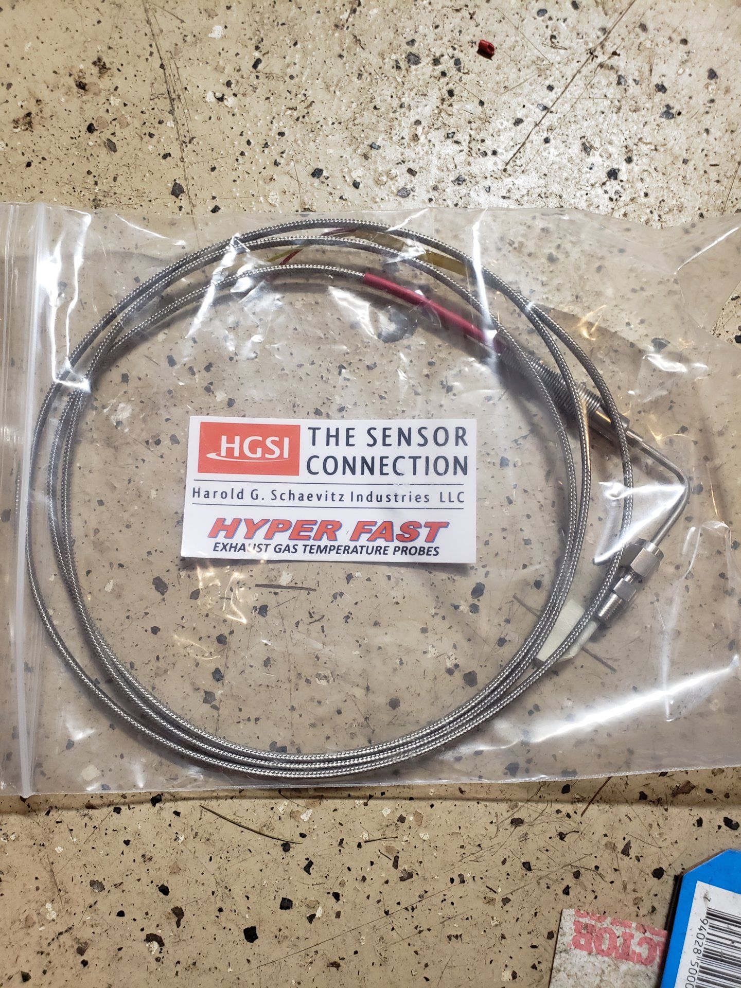

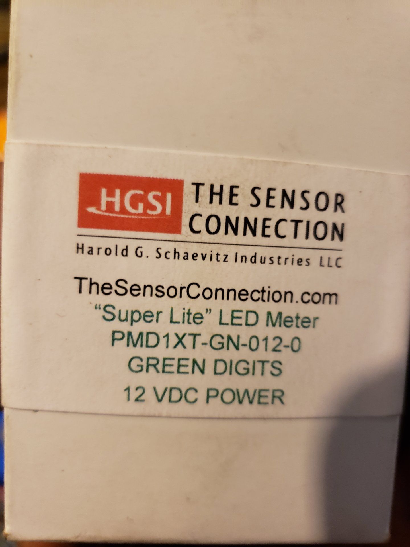

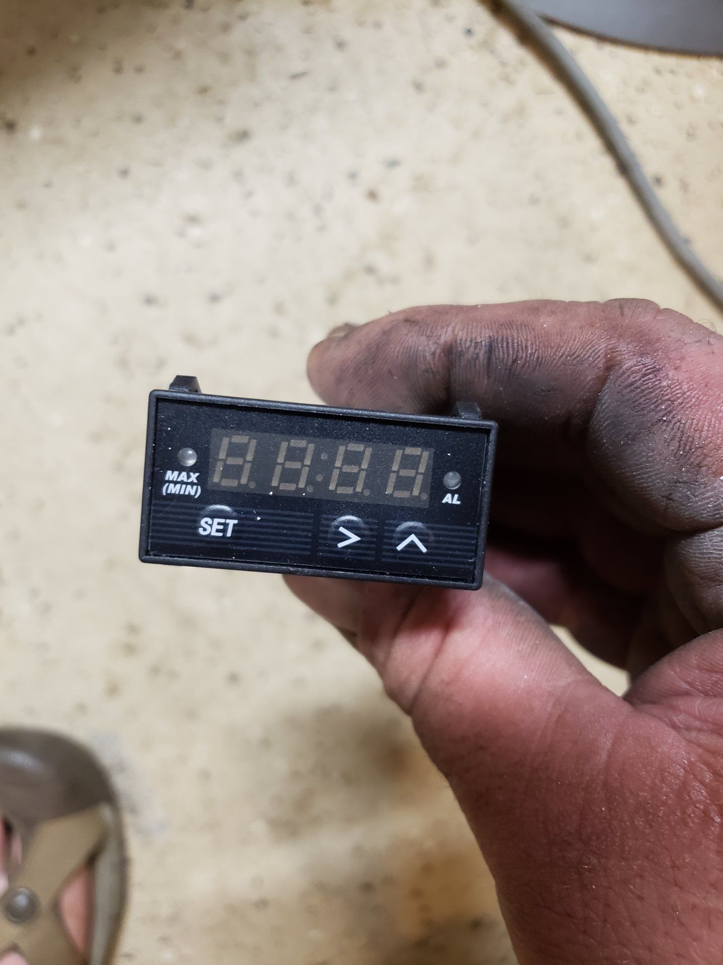

I hope this one works out but it looks really promising. HGSI "The sensor connection " for an egt probe and display. I wanted a nice factory looking display to avoid the gauge pod look. Auto Meter is awesome but round displays are all I could find, and pricey. These guys are in Michigan (greatest state in the union imo) and do industrial stuff mainly. I think I went way too long on the probe so I might be getting another one, my mistake.
Total cost $136.78 which is awesome.
My plan is to take the 4wd blank on the 60 and turn it sideways to mount the guage. Will take some fiddling but time is on my side o_O. Anyway I am pretty stoked on this one and I will keep the results posted, good or bad.

I added in a thermocouple connector on mine to make a pigtail and take out some length. I haven’t tested it yet to make sure I got the connector right.

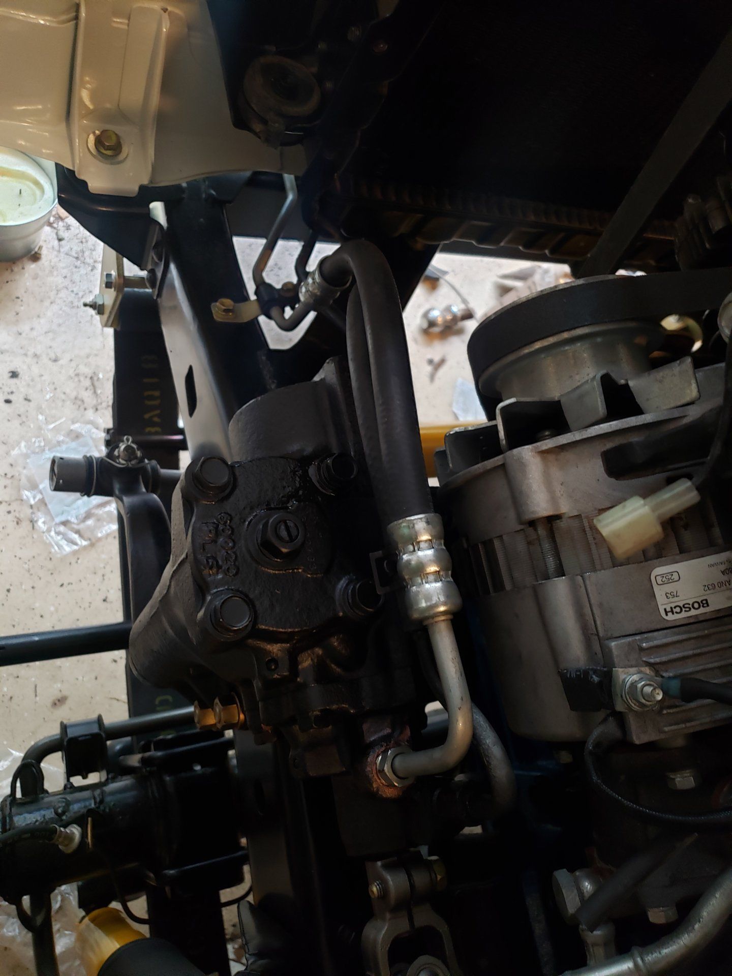

A few things done this eve. I got the power steering lines pretty much in. @bdyer12 , gave me the whole setup he made for this engine in his 60 so it made it pretty easy.

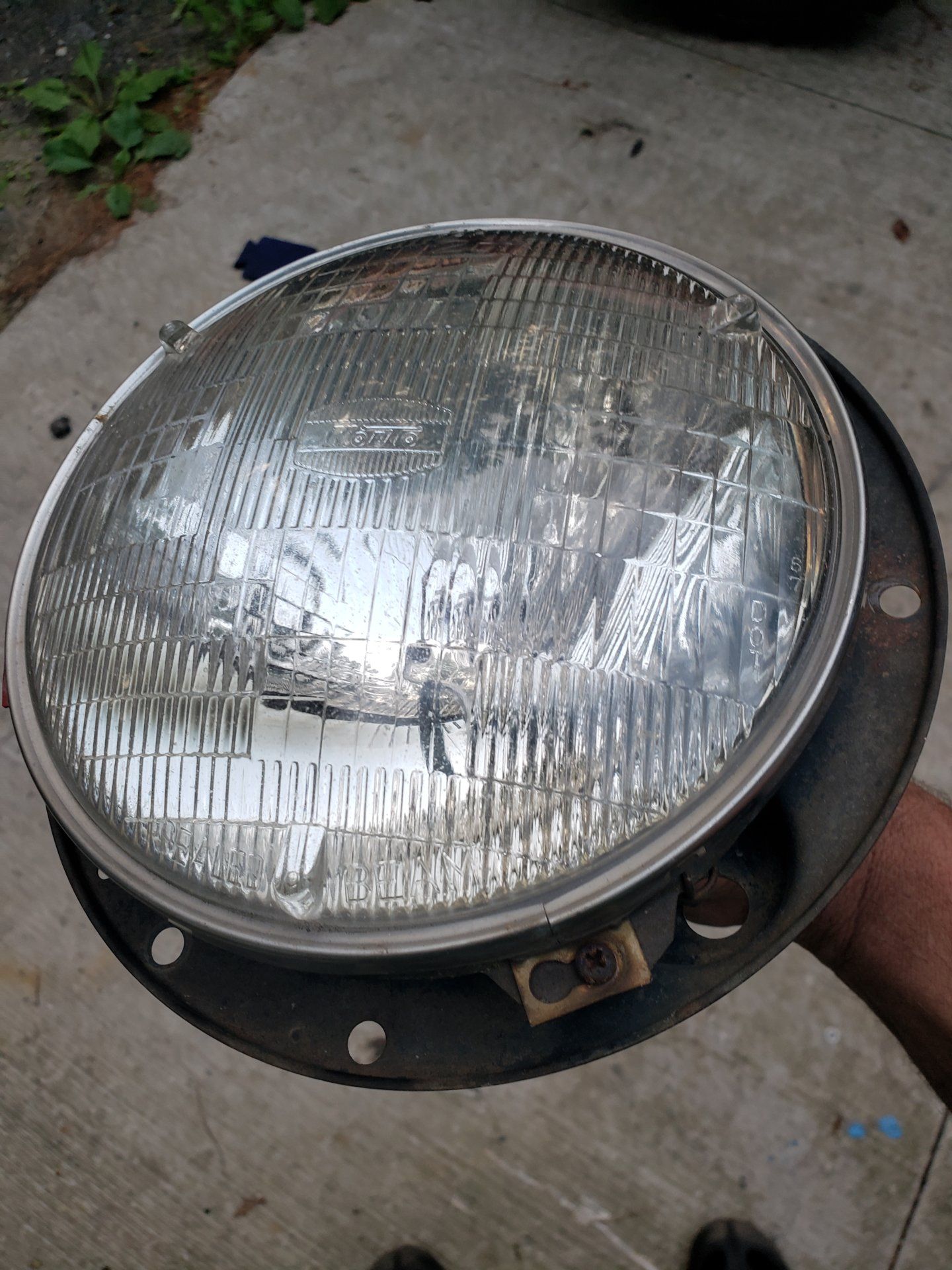

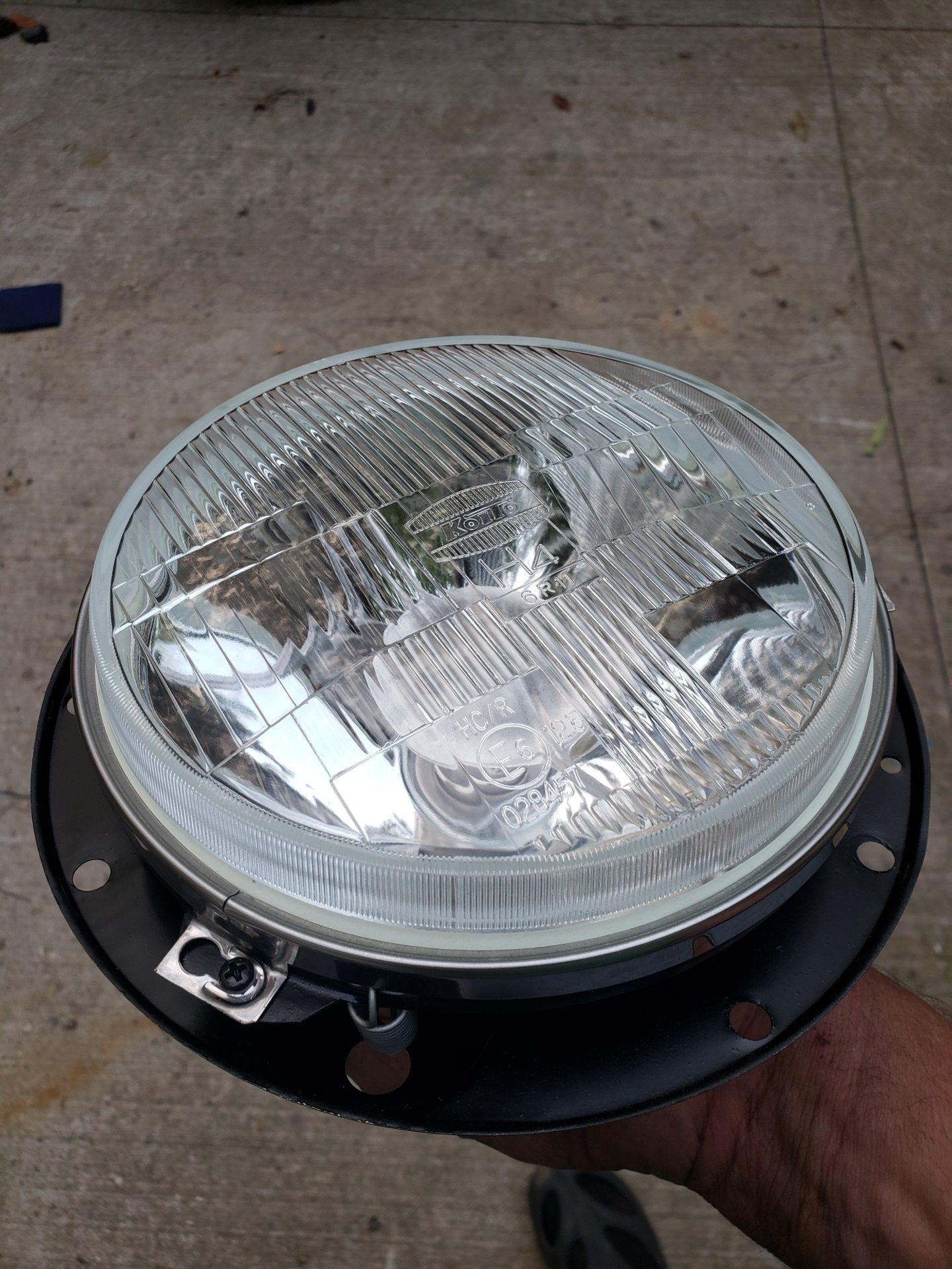

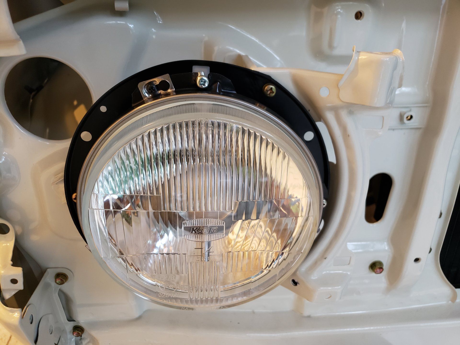

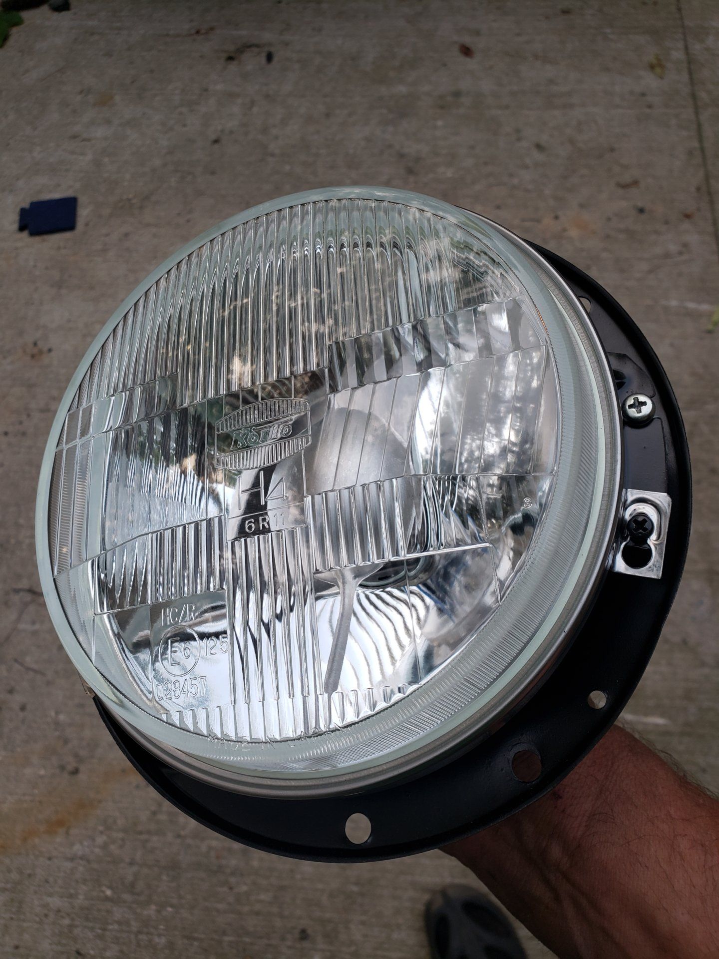

And one new headlight assembly together. New bits from mr T make it looks so nice I hate to cover it up!
Here's the old.
And the new

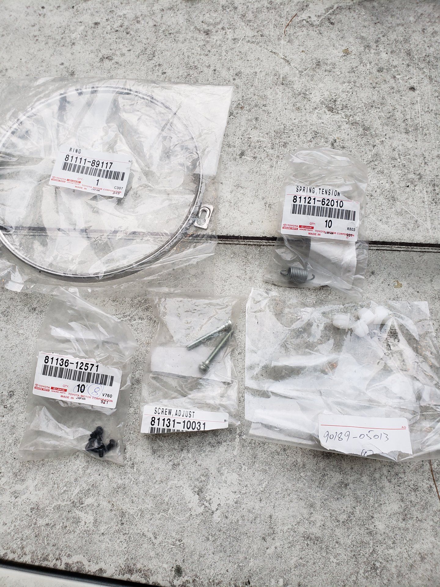

Here are the small parts and numbers
Looks amazing Pat! Are those the non sealed h4 lights?
They are the same kit you have in your stash room ;) .
I guess they are sealed, they have that rubber cover on the back.
I want to say it was either @NookShneer , or maybe @HemiAlex , I stole that kit idea from? Then I saw you had the same thing Roma.
Excited to try em
All that is still available? Looks really nice!

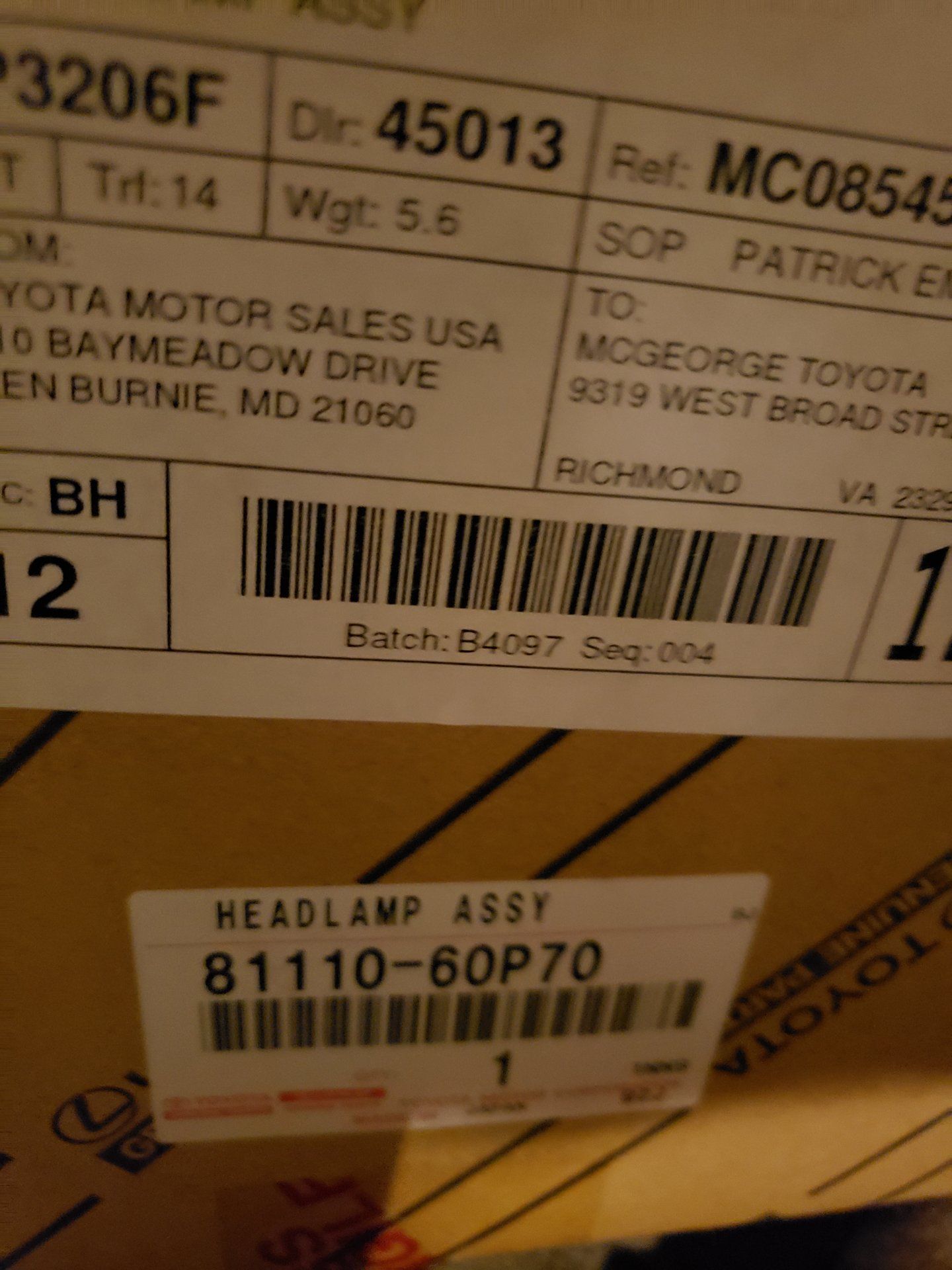

Yes, not necessarily the correct parts. I cant remember which pieces I substituted but they fit perfect. I found all that on partsouq. Amazingly inexpensive too.
Here's the light kit. I retails for around $50 so the discount dealers in the US will put it around $35.
It is way cheaper overseas but the shipping is high.
Smokin deal for the 2 lights and the relay harness
I bought two of them, and they work great. The cut off pattern is sharp and they are very well built!
What is the harness portion? Is it factory replacement wiring or is it like the Arb relay kit?
It’s a relay harness without the plastic sheathing of an arb style. Works just the same.
