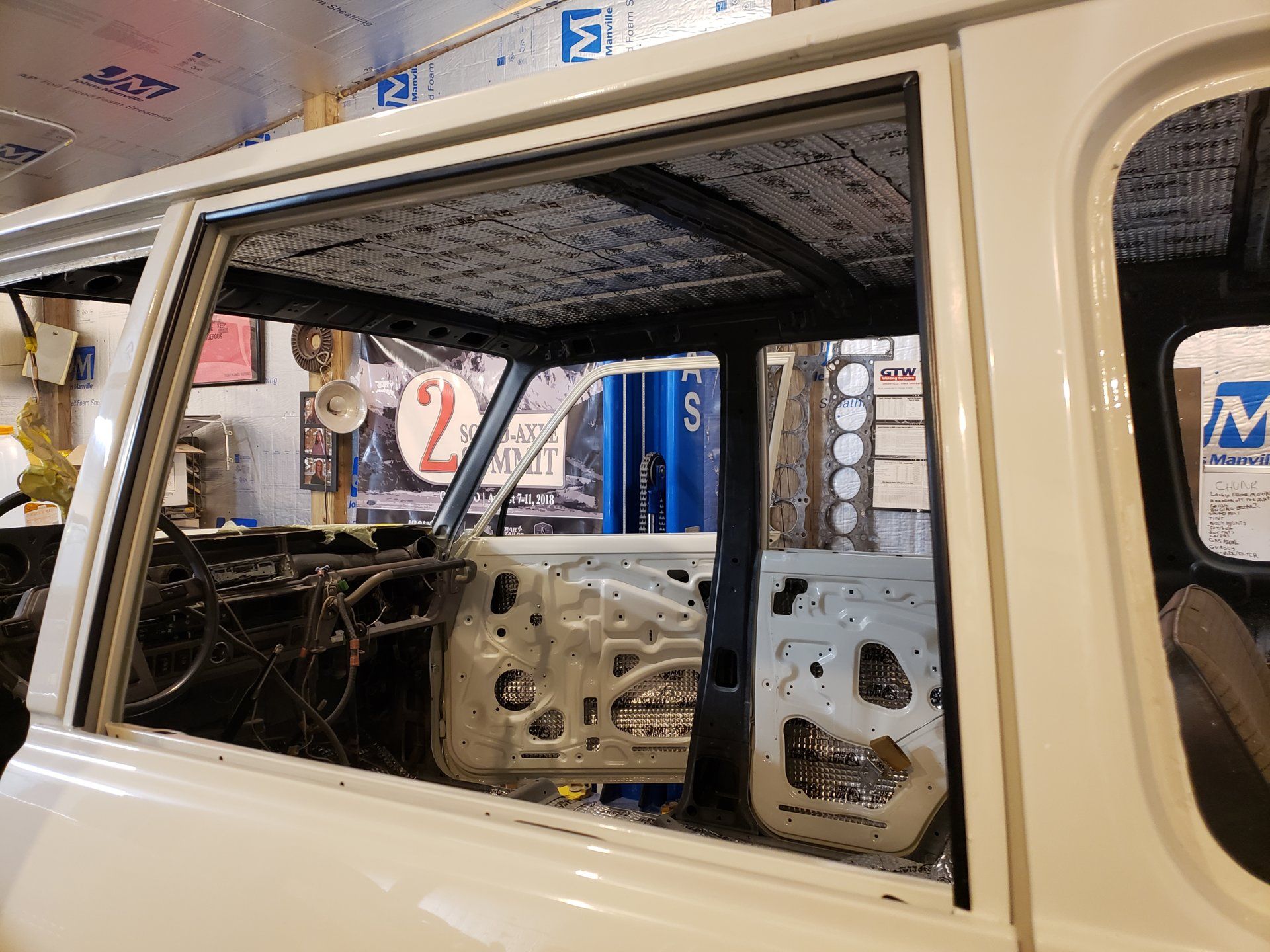

Lizzy's boyfriend has been helping me as well. He came over tonight and got the sound deadener mat done in the doors and quarters. Getting close to done on that project

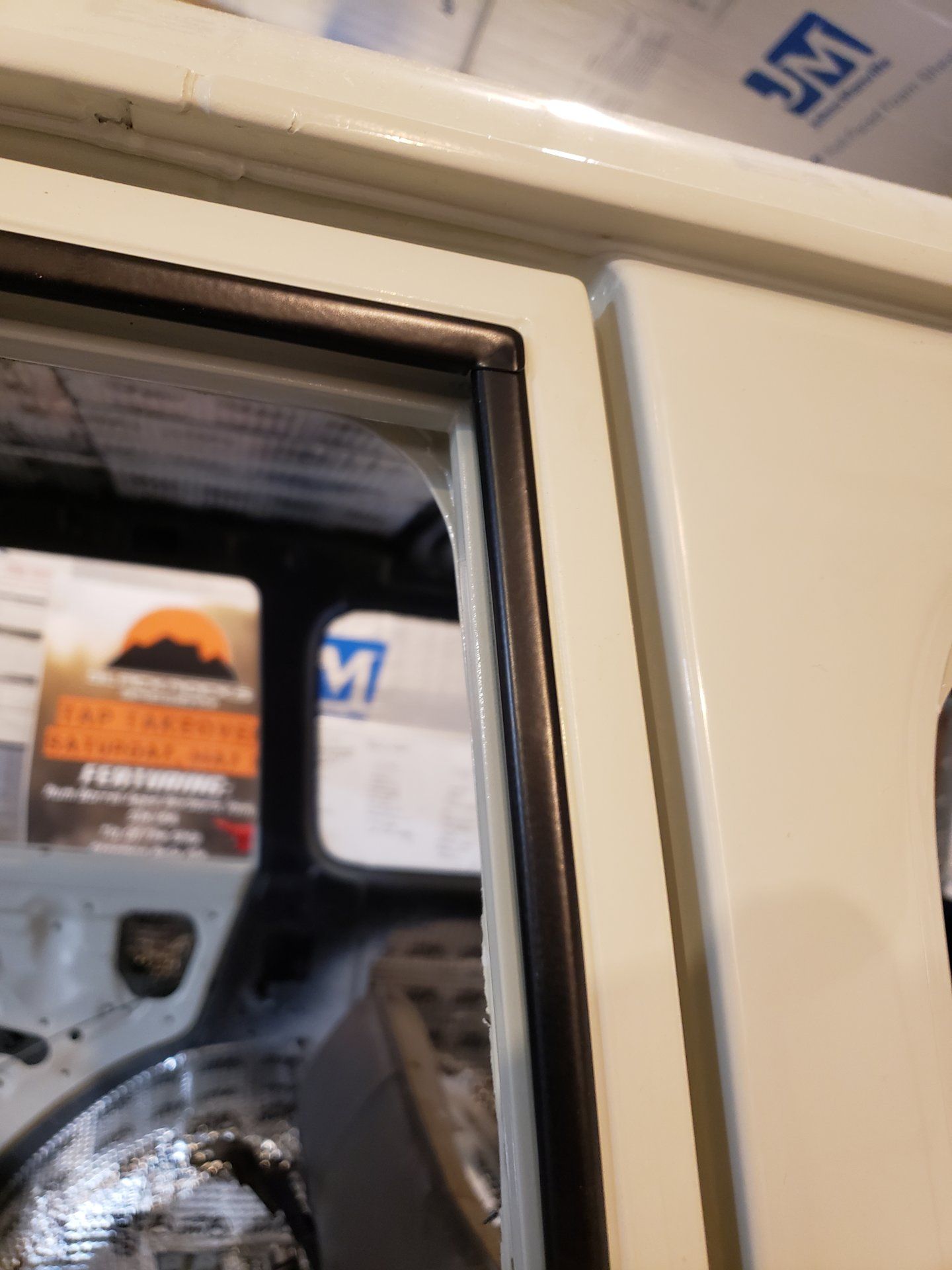

Today I did an experiment with coating the stainless trim around the door windows. I did them in satin black and I am really happy with it.
