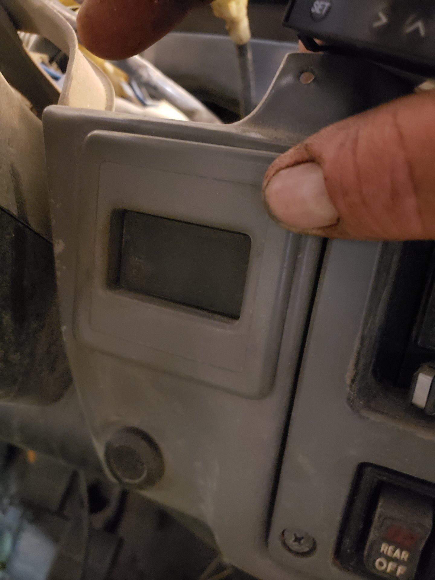

My plan is to take the 4wd blank on the 60 and turn it sideways to mount the guage. Will take some fiddling but time is on my side o_O. Anyway I am pretty stoked on this one and I will keep the results posted, good or bad.
Heres the spot I plan to put it turned 90°
I went back and looked and the reason I bought the 6' thermocouple is because it is the shortest they have. I may have to coil it up under the dash. Not optimus prime bit will do.
