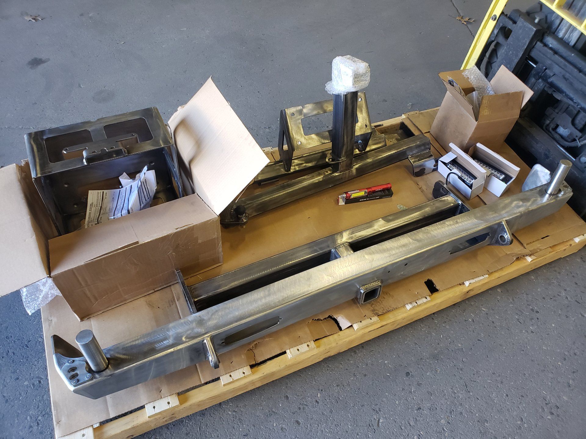

Today was a big day for Chunk items showing up. On the recommendation of @ceylonfj40nut and having seen his bumper on his red 60, I decided on a 4plus rear swingout bumper. @lcwizard was great to work with and got it to me quickly. I ordered it bare so I could do my own powder coat job on it. The bumper is really beefy and looks to be very well made. as much as I'd like to jump right on coating it, I will wait til it is near time to install so I won't have to be so careful with it.
Dave even threw in a sweet led flashlight/flood combo and a 4plus keychain. Love it.

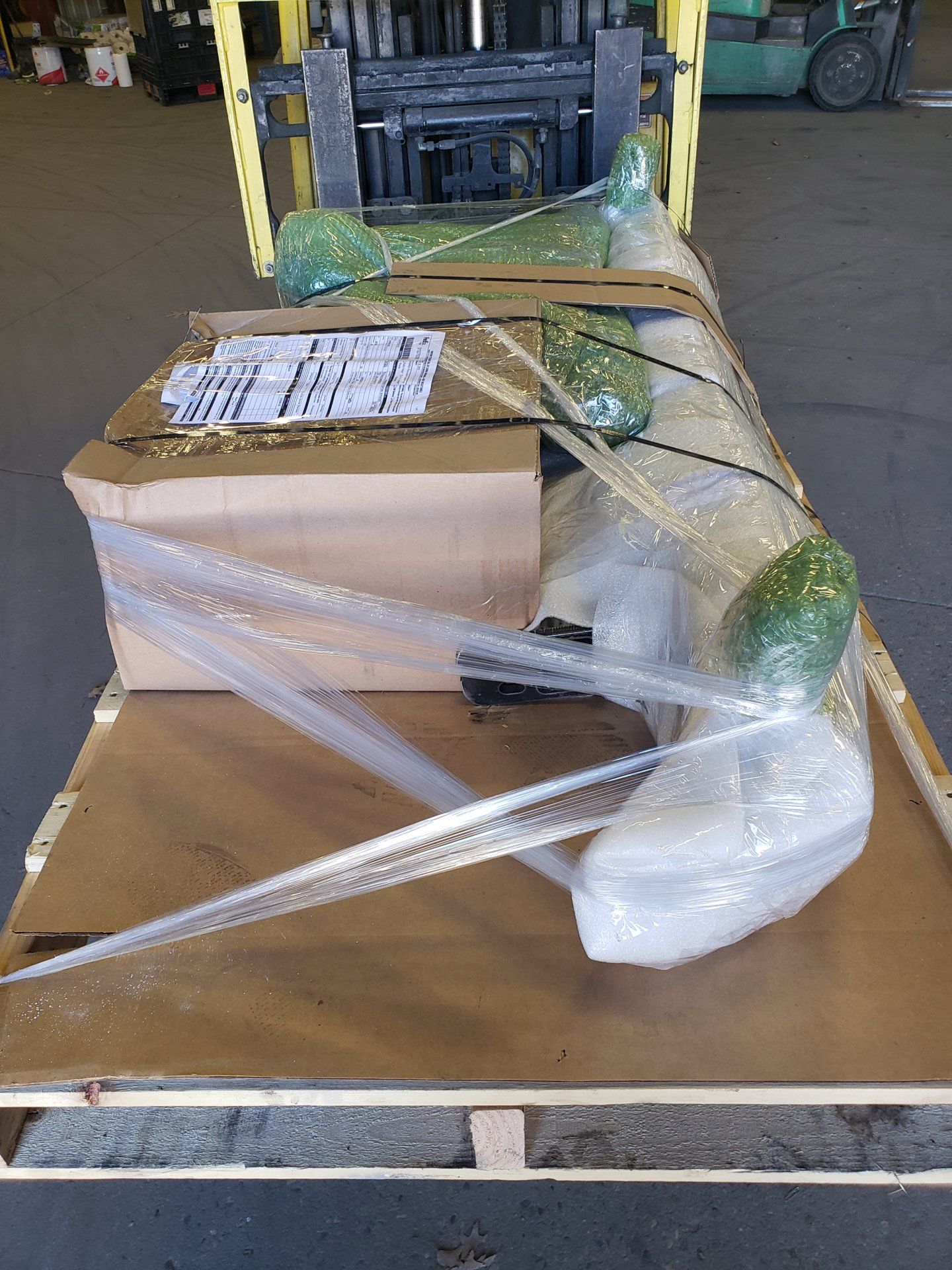

The other big item (s) was a skid from Cruiser Outfitters with a lift for Chunk and a lift for my 55 (Bacon Double Nickel). I needed them both so I bit the bullet and combined the order. Kurt @cruiseroutfit saved me some shipping $$ this way so it was worth it. I can't wait to get to bolt those pretty new pieces on the truck!
The guys took in all my info for what the truck would have for weight (bumpers, winch, diesel engine, gear) and set me up with the right spring combination.

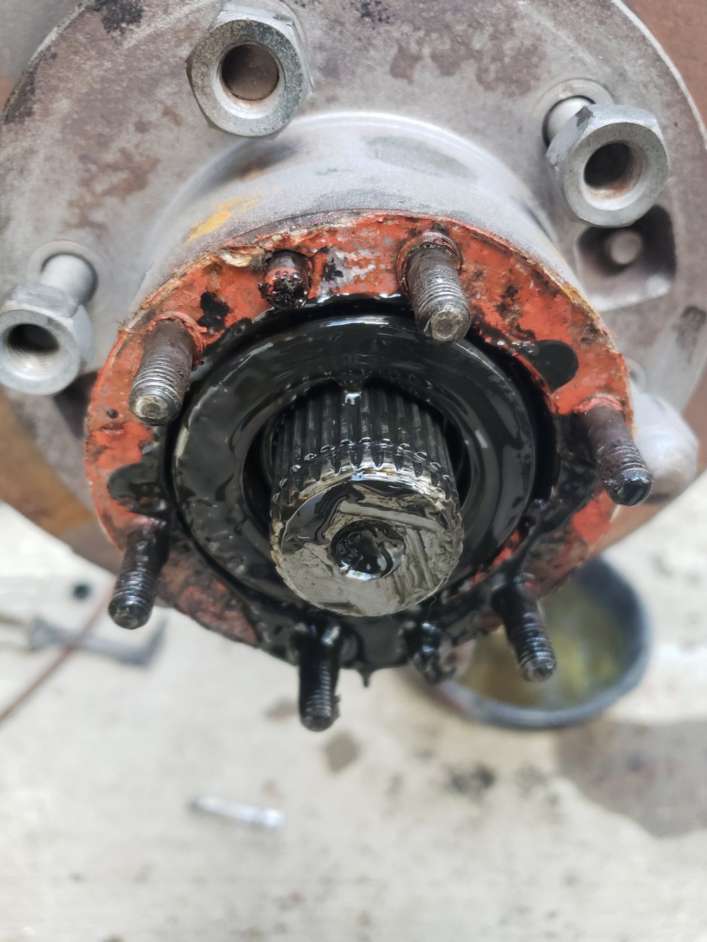

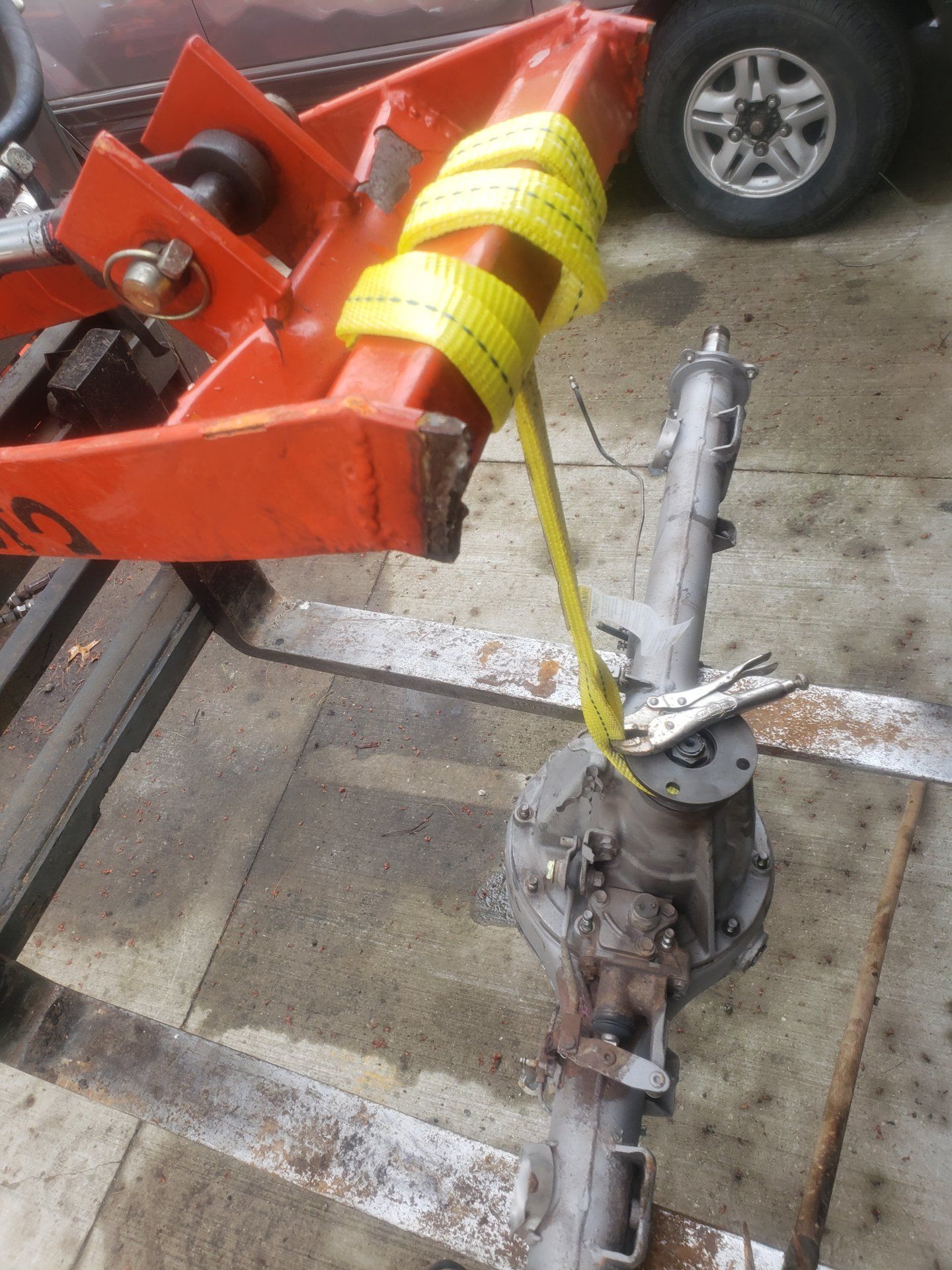

I started the axle teardown today. The drums were tough to get off but I got 'em. I took off the entire backing plate/brake assembly so that work remains to be torn down. My grapple on my forks worked well to pull the 3rd member out of the housing so I didn't have to wrestle that monster and try to break the seal. Hopefully by tonight I will have the little bits off of the housing and the front torn down so I can get the housings on to powder coating and installed. My plan is to build the axles back up in the chassis, on the hoist. I think that will make the best use of space in the tiny workshop.

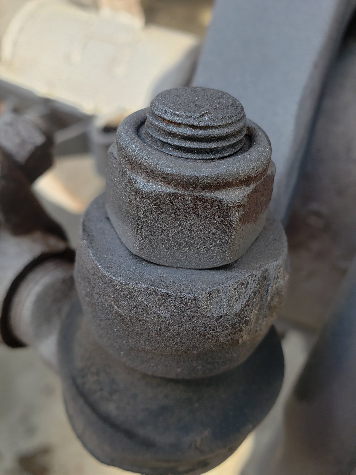

Definitely some crappy repair work in the past for these axles. Nylock nuts on the steering arms, lots of rtv, cobbled up drain plugs, broken lockout hub, mega birf soup. Fortunately it is a Toyota so under the nastyness, the importand stuff looks really good. The front birf joints don't feel so great so I might have to do something with the axles, but we'll see.
I got the front all apart so tomorrow I hope to prep the housings for powder coat. I've got a bunch of roof rack stuff to coat this weekend so I hope to coat the housings then too. The grapple worked great again pulling the front diff out of the housing.

That nylock nut yikes
