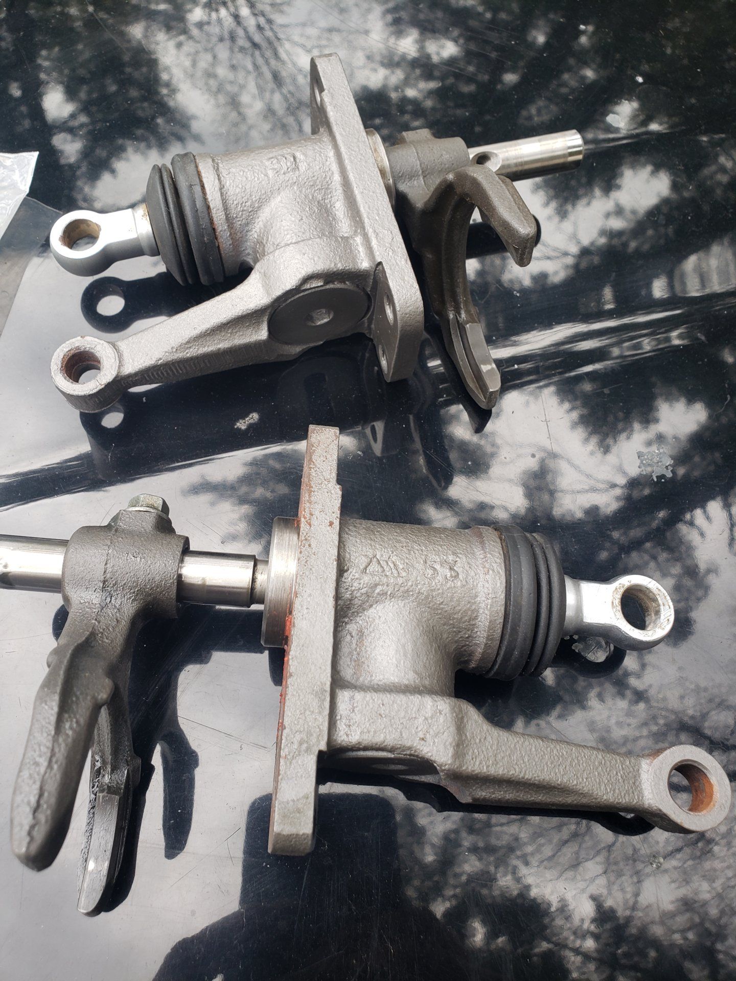

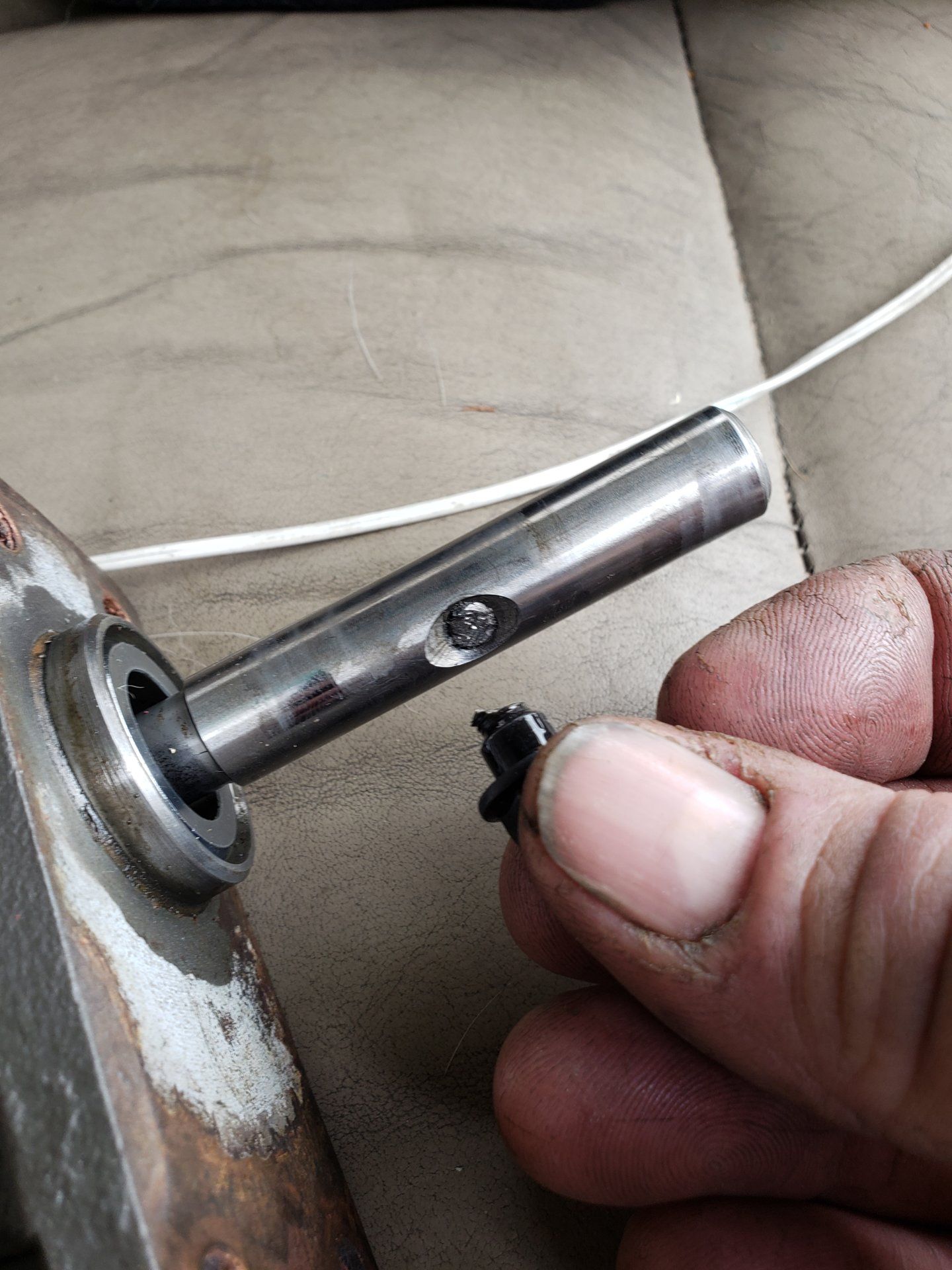

I got a bit nervous when I discovered the rear locker wouldn't engage. Upon teardown I found the head of the bolt the holds the shift fork broken off. The broken piece stayed up in the actuator thankfully. Quick trip up the street to see a buddy at the tool and die shop he works for (and me too, doing powder coating) to get the broken part out. He tig welded a stud on the broken part and popped it out for me. The shouldered bolt that goes in there is amazingly still available from Toyota so two new bolts are on the way for both front and rear lockers.
I got a bit nervous when I discovered the rear locker wouldn't engage. Upon teardown I found the head of the bolt the holds the shift fork broken off. The broken piece stayed up in the actuator thankfully. Quick trip up the street to see a buddy at the tool and die shop he works for (and me too, doing powder coating) to get the broken part out. He tig welded a stud on the broken part and popped it out for me. The shouldered bolt that goes in there is amazingly still available from Toyota so two new bolts are on the way for both front and rear lockers.View attachment 1976621View attachment 1976625

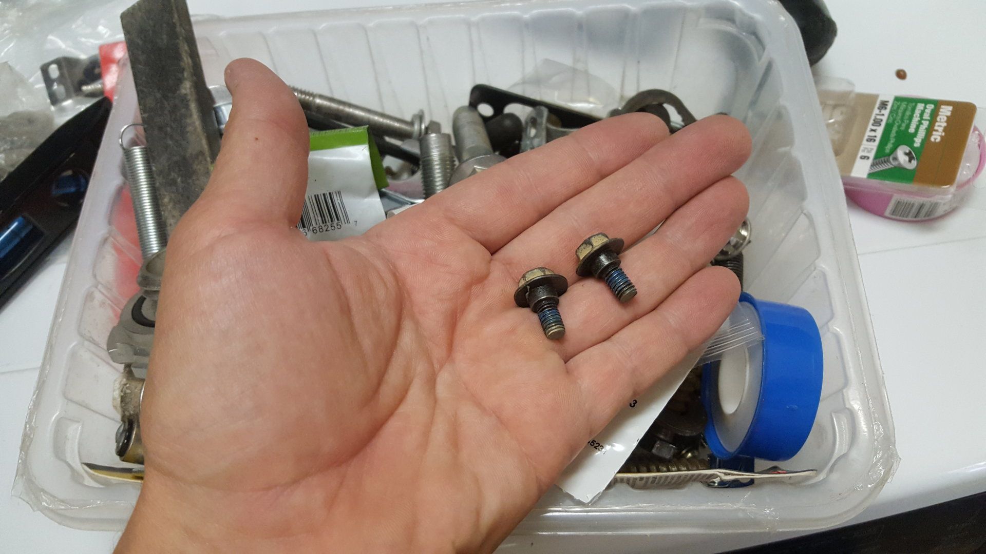

I have a couple of those bolts for spares. Same as the 80 elocker ones.

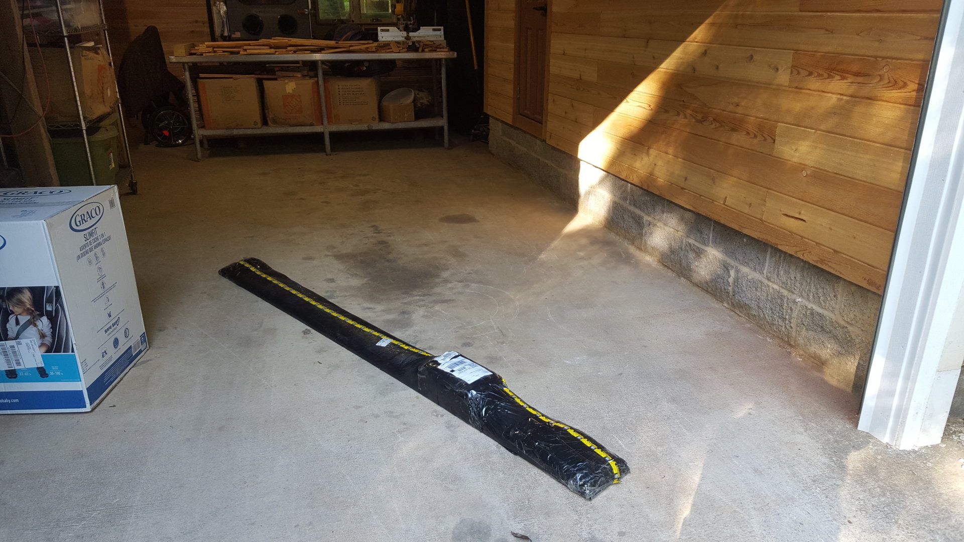

Just came home to a big package in my carport. What could this be?

I figured I would save the extra I have for the spares box. Brand new retail is $2.99 so I figured it was worth replacing both bolts. Too bad all the other parts are obsolete. New cables would be nice. Mine work fine, but they are ugly. They will clean up ok.
Something shiny in that package there, methinks.

Wasn't first oil stain and definitely won't be the last. Shiny it is! Awesome packaging by the way Pat.
