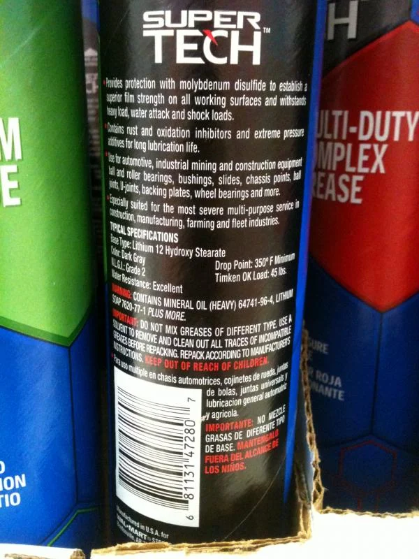

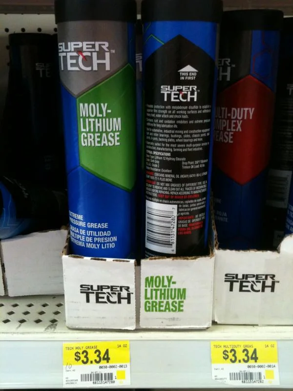

Found some cheap stuff at WalMart that also meets the criteria. I will add it to the list on page 1.

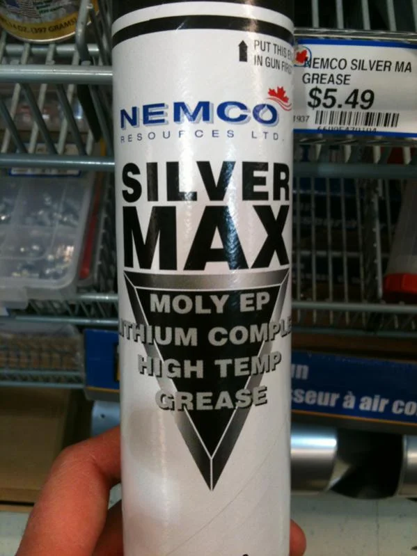

For us Canadians I found this stuff at Princess Auto... Spec sheet:
http://www.nemco.mb.ca/pds/grease_silver.pdf
Also it looks like Canadian Tire has gotten rid of their Motomaster Moly Grease in favor of Valvoline P/N 504974
I have used that Nemco brand in two axle rebuilds now with good results. Used the Moly3 from Cat in the past and I cant tell a difference.
