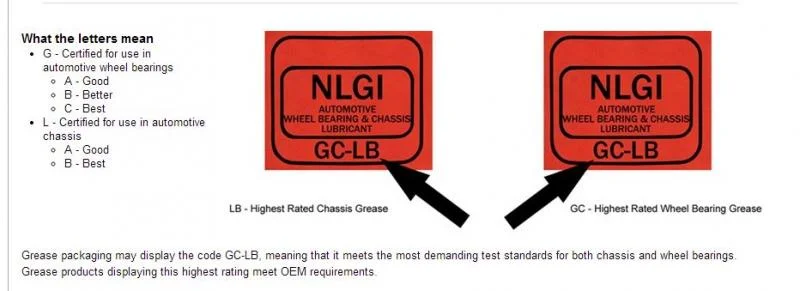

NLGI and ratings
"Performance Classifications within these Groups result in two letter designations for chassis greases (LA and LB), and three for wheel bearing greases (GA, GB, and GC). The automotive industry is in general agreement that the highest performance classification, to date, in each group (LB and GC) is suitable for service relubrication." - https://www.nlgi.org/product_certification/
"The product is recommended for all types of bearing and slide applications, for shock loading, pounding, rough chassis usage
and high loads. Two NLGI grades are available for seasonal temperature changes.
Palladium meets the requirements of NLGI GC/LB" - http://www.valvoline.com/pdf/hd_palladium_grease.pdf
There is NGLI 0, NGLI 1 and NGLI 2 Palladium. The gray looking one is the NGLI 1, however, it has a group rating of LB and GC. So, it's good for both chassis and wheel bearings. The difference is in the temp your running your equipment. Keep in mind that Palladium is approved by CAT for industrial equipment, which is wayyyyyyyyyyy harder on grease than a Land Cruiser.

So am I correct in thinking I can buy a single grease for both the birf and the wheel bearings?
This one for example: Valvoline Palladium
Or, in addition to the example above, should I definitely be using a different grease specifically for wheel bearings?
This for example: Valvoline SynPower Extreme Pressure Fortified
If it has the correct rating for wheel bearings, there is no problem with using grease that has molybdenum in wheel bearing applications.
So using Lucas X-tra would be OK for repacking the Birfs and wheel bearings since it's rated GC-LB?
