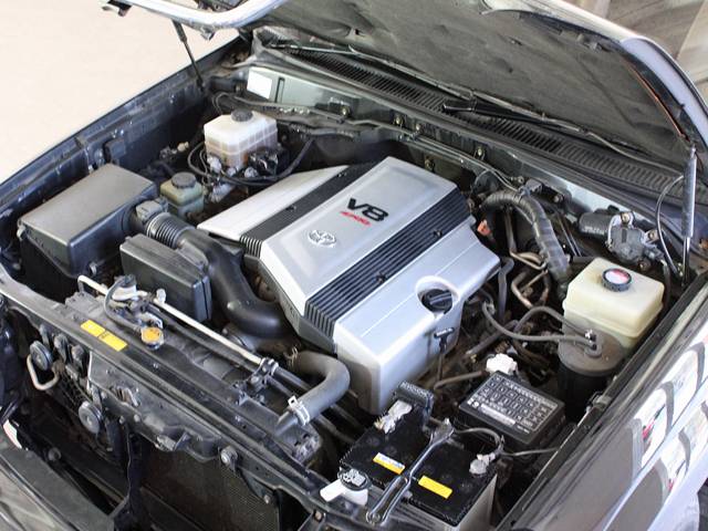

The finished product should look something like this....
