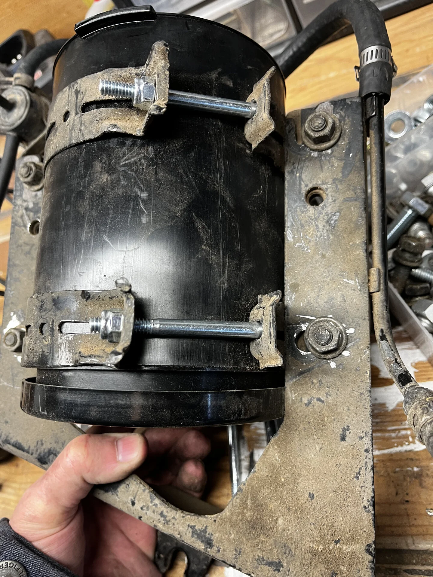

Can confirm the VC120 solved my problem of excess vacuum build-up. Went on a solid 2 hr drive and took the cap off when I got home to check. Zero issue now. I also did like someone else in the thread and removed the swivel hose from the bottom of the original, drilled a hole in the bottom of the VC120 and mounted it.
Hey there. Is adding the swivel hose necessary or preferred? I just sourced a VC120 and ready to replace it. Any problem if I just connect the two upper lines?
Thanks
thats all i did. seems fine to me.

On the top. VC117 is way too long, about 3-4 inches too long and as thick as VC120, it will hit the hood if you try to mount it in the brackets.
BUT... I didn't want to mess with ordering another canister so I took off both canister braces, stuck it in there, shoved it down, zip tied and it works just fine. I also got some fuel line from autozone and routed it to the OEM fitting for the wheel well.. Will mess with VC120 down the road.

If the link gets stale, it's Autozone part VC120 for early 1990s GM cars with the 3.1L V6 (pontiac, oldsmobile). The dimensions were close enough to ours, so I pulled the trigger on a hunch. And it works beautifully! I wanted to run thru several fill-ups before I posted, and I can say that after 6 fill-ups, my 80 finally operates like a normal car (as the gas pump anyway). No sound, no air escaping, etc.
It has the same style connectors and pulls in fresh air from the bottom just like the 80s. Using the highly calibrated "blow with your mouth" technique, I confirmed that this canister is almost identical to the stock 80s as described in the FSM. Minor details on mounting:
  • There is no hose connection on the bottom like the 80s, so you can remove the hose completely. This replacement canister has it's own filter and cover on the bottom. In stock 80s, the hose simply routes down to the frame area. I assume to pull in fresher, cooler air.
  • The diameter is just a bit larger than the stock 80s, but you can see in the pic below that it fits in the stock bracket, in the stock location, using the stock hoses. You'll notice that I used a ziptie in place of the bolt on the bracket - a longer bolt would be better, but I didn't have one around. And it's a tight fit, so I don't think it's going anywhere
  • The "tank" port on the canister uses a larger diameter hose barb, but a little persuasion works.
