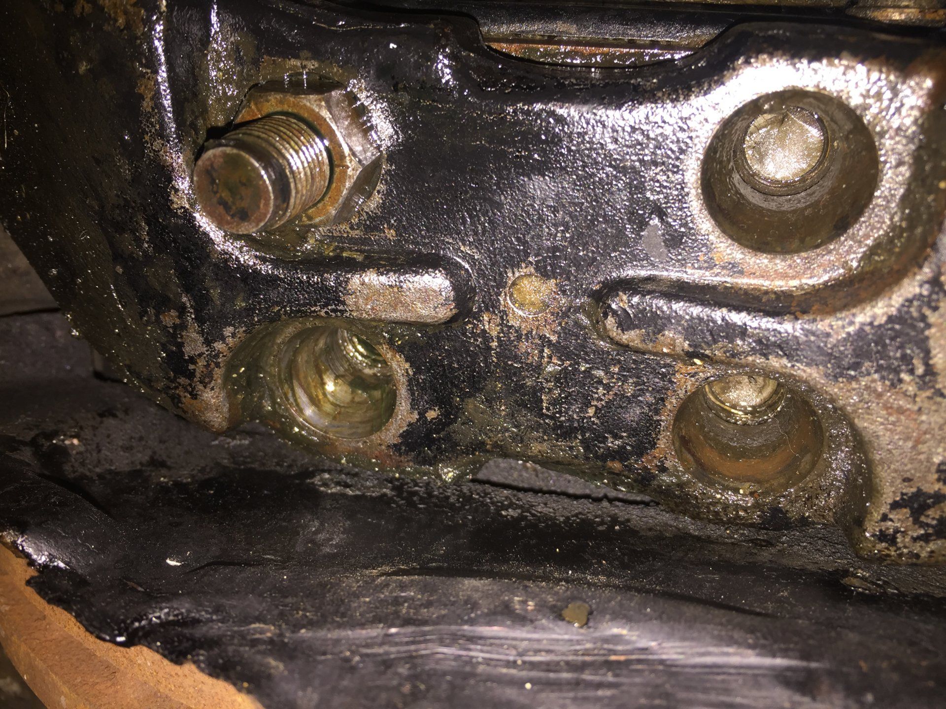

This happened to us last night, our son was driving, fortunately it was in a parking lot, <5mph.
I've serviced the front end a couple times, but I've never removed the studs.
When i'm re-assembling i always double check torque settings, so i'm 99.9% sure the nuts were torqued correctly.
Thank God this didn't happen at highway speed.

If you tension studs overtightened and stretched in the past, they still wont hold tension over time.
1 good and tight
1 loose (so I removed it)
2 sheared off
Only caught it when I saw grease at the tip of the remaining nuts.

The "good and tight" appears to be missing the cone washer and flat washer.
Good catch!
Yup, already replaced the “good and tight” with a new set of stud/washer/nut after taking that picture.
Tomorrow is a mission to remove those sheared ones. 😂
