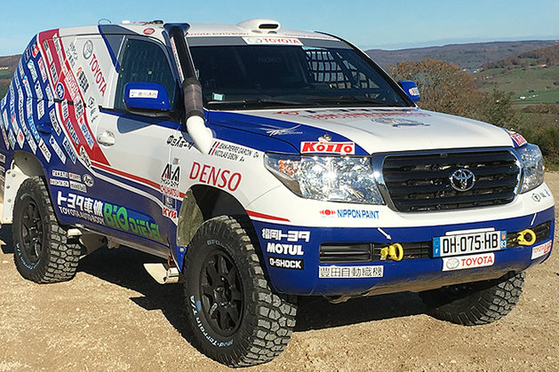

No malls on the route of the Dakar Rally, either; but those pesky snorkels keep showing up:
Are you sure thats not the exhaust for the Flux Capacitor or the ram Air exit for the roof mounted scoop? :steer:
