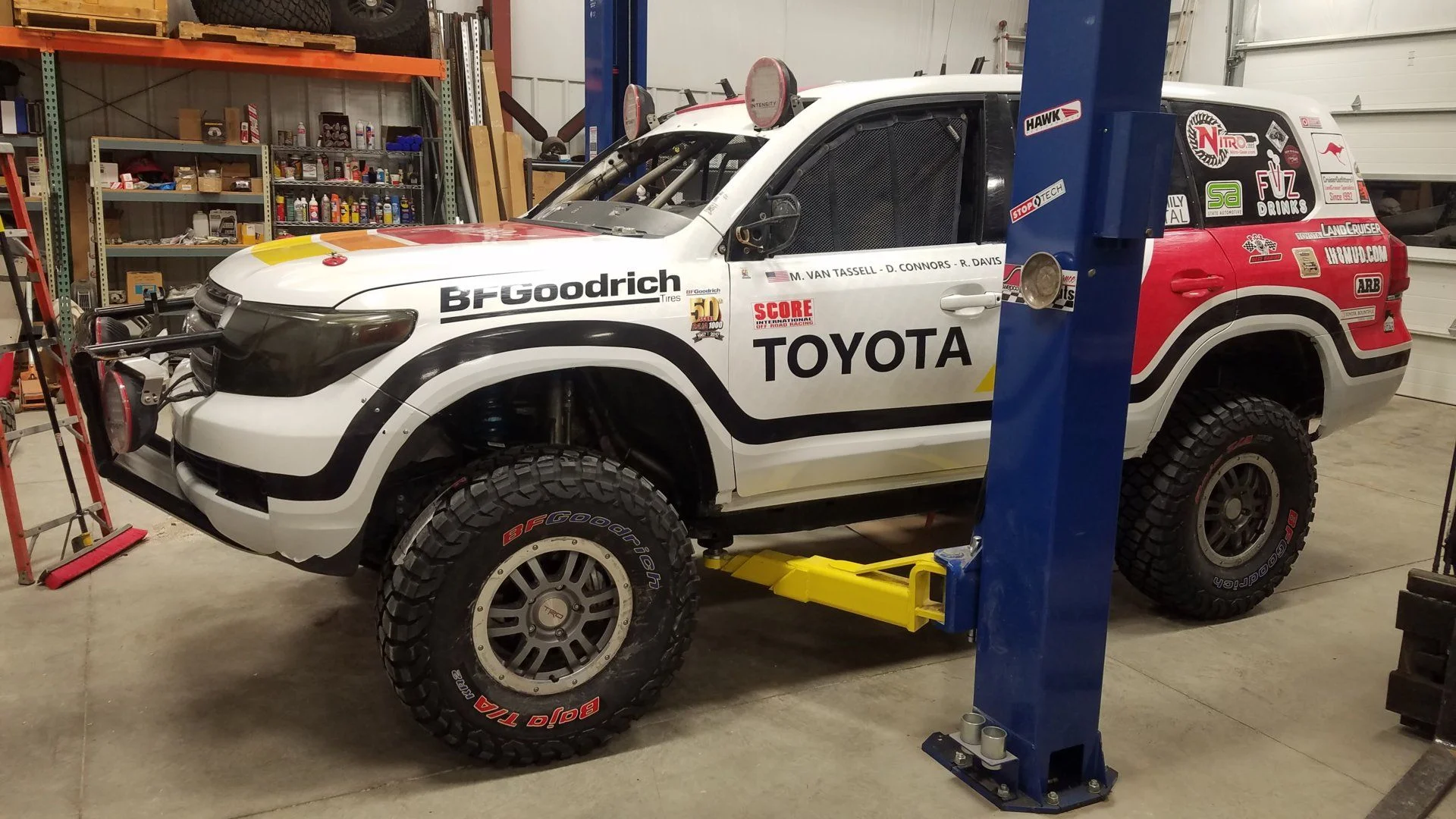

Excuse me if this has been covered earlier in thread, but is there a “lift” aside from a body lift? If so, how is the caster corrected with factory UCAs? Not a concern in a race truck?
All adjustment is via the factory lower cam bolt setup and we get it close to spec. With the bodylift, trimmed fenders and a minimal suspension lift (2"?) the 37's clear.
She done... ready for the race after approx 200 man hours of prep work and ~$14k in replacement parts and spares. We have some decals to place on the new hood (LCD and Maxtrax :cool:) and we'll check fluids in MX. Other than that, wish us luck!

Yes, we can and do trim fenders. I cut these ones and welded a small price of round stock to reinforce the edge. Keep in mind that is a true 37" tire.
Awesome. So did you guys switch for 35s to 37s?
I noticed the body mount at the rear of the front tire has a little chop too for clearance.
Any guess as to why some many people feel the need to swap to aftermarket control arms?
It's always had 37's Baja TA's

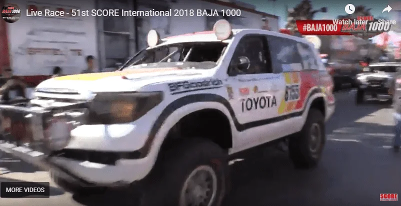

LIVESTREAM
Timing and Scoring Monica/Canguro is 8155
Good Luck!
Awesome...following the livestream.
