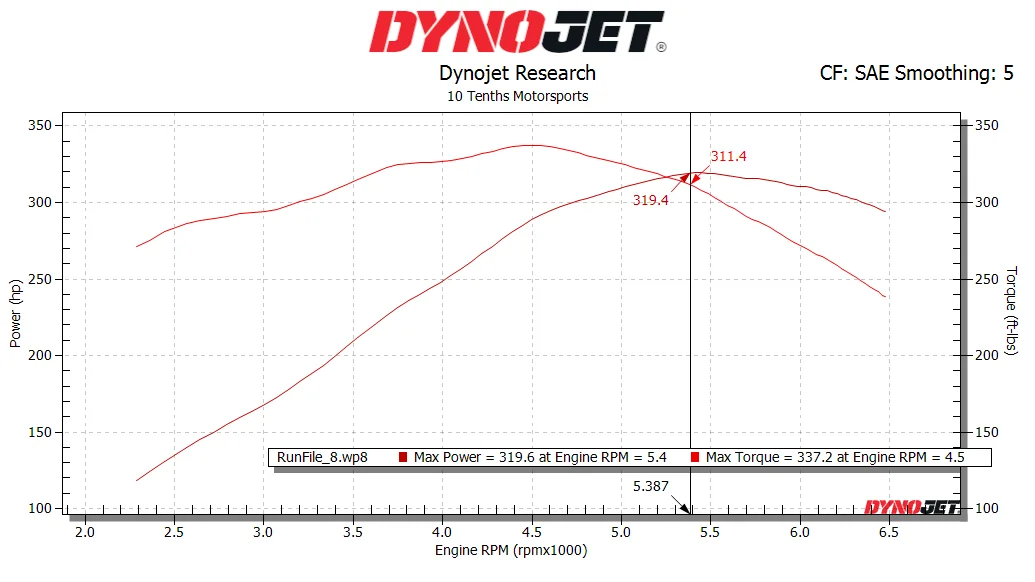

Dyno numbers incoming

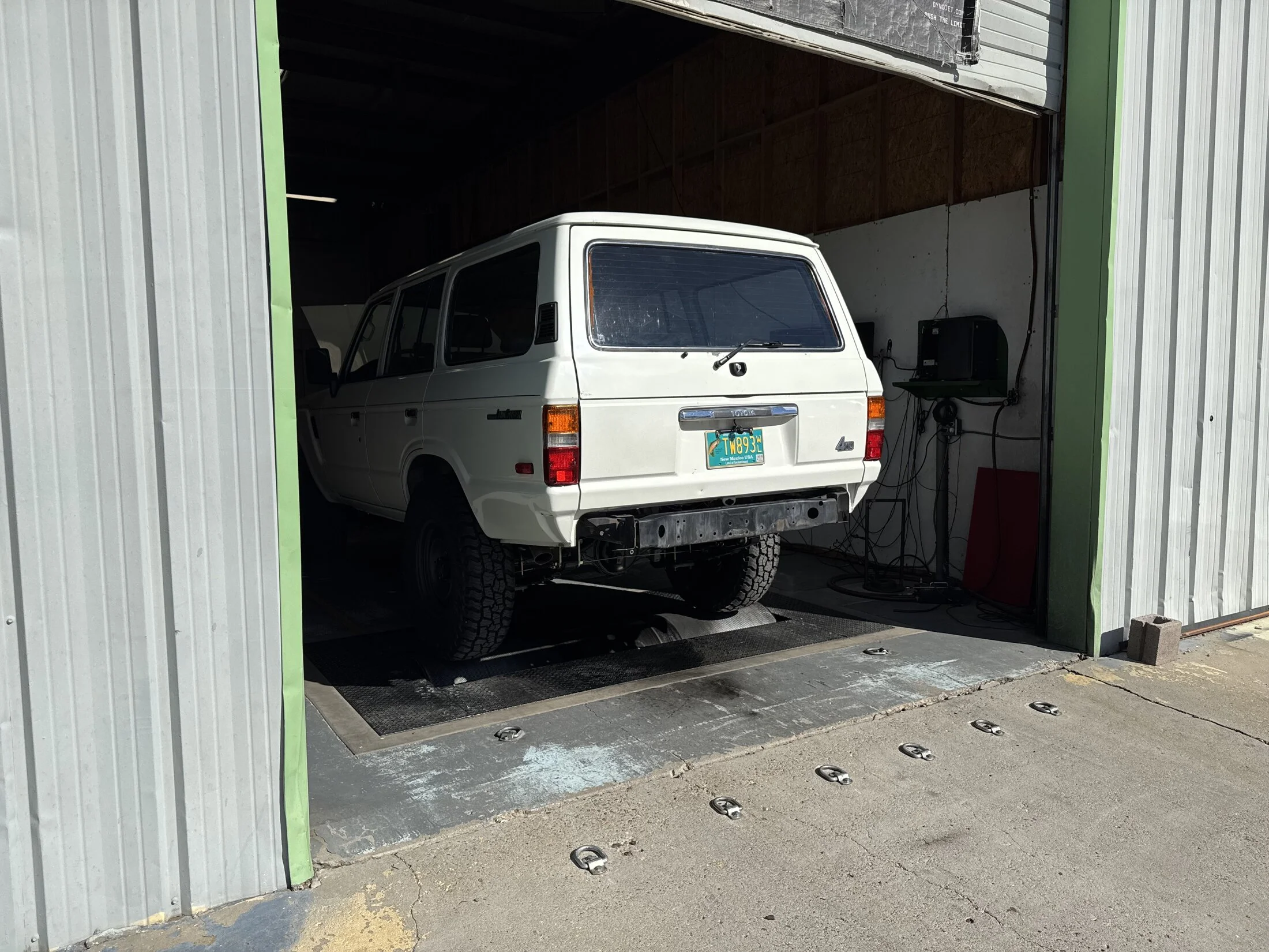

Currently making ~310hp at the wheels at 5300 and about 335ftlbs at 4500.
Possible the reuse but modified intake from the 80 is the limiting factor but honesty it sounds great and runs great.

Very nice. Curious how it feels before and after. Did they update anything in the computer in particular that is notable?
Tuner said that the base tune had way too much timing and way too lean. ~70hp difference between pretune and post. Idles way better, no stumble. Revs great now. Adjusted the fan temps to let the engine warm up properly.

Wow. That’s incredible. I’ll bet the drive home was great.
I gotta get going on my intake so I can take mine in…
That's an impressive bump after programming! Did you use a bigger cam when you deleted your AFM?

I had a custom cam made by CamMotion, but it’s very similar to a Truck Norris cam. But yes did all the normal stuff with the DoD delete, ls7 lifters, upgraded springs, etc.

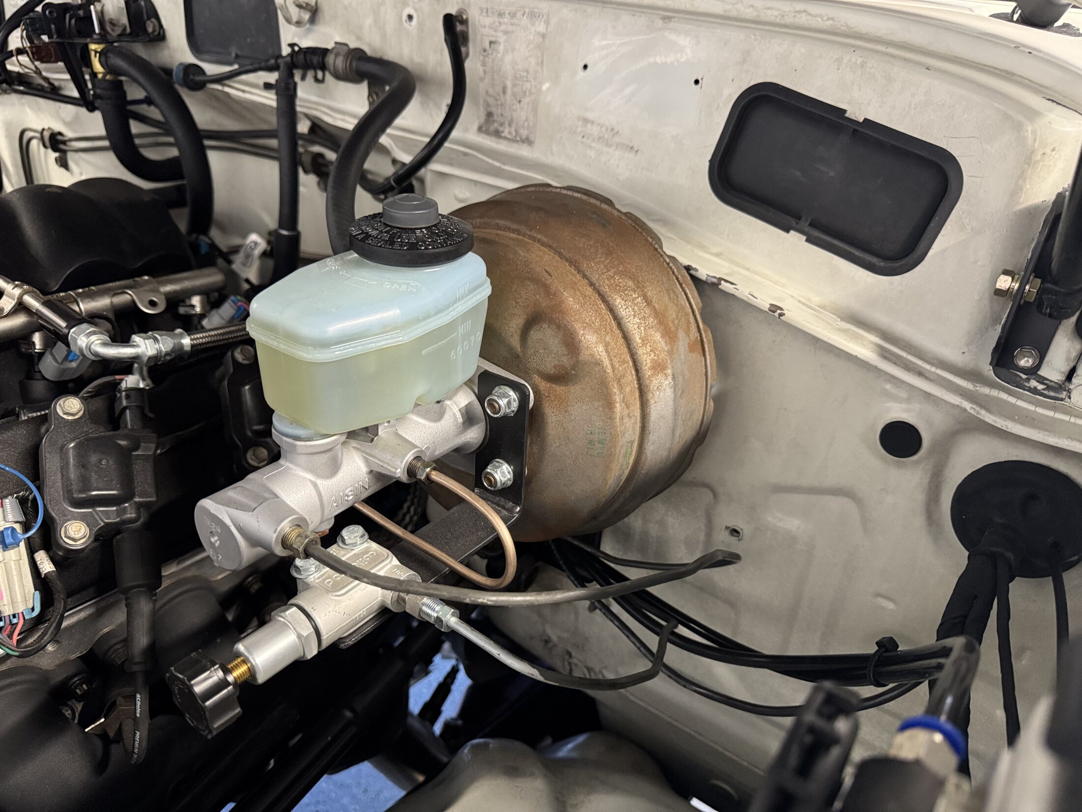

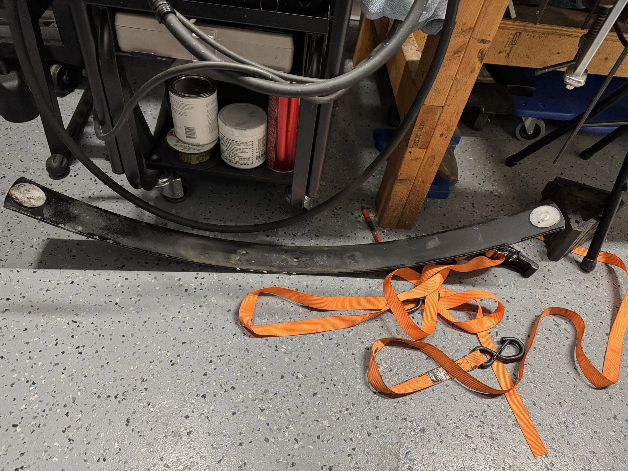

Front end felt super stiff. Was running the -7 springs from Dobinsons, removed the 3rd from bottom leaf when installed. So I pulled the 5th today.
I estimate that with an aluminum LS and 6L80 my front end is 300-400lbs lighter than stock.

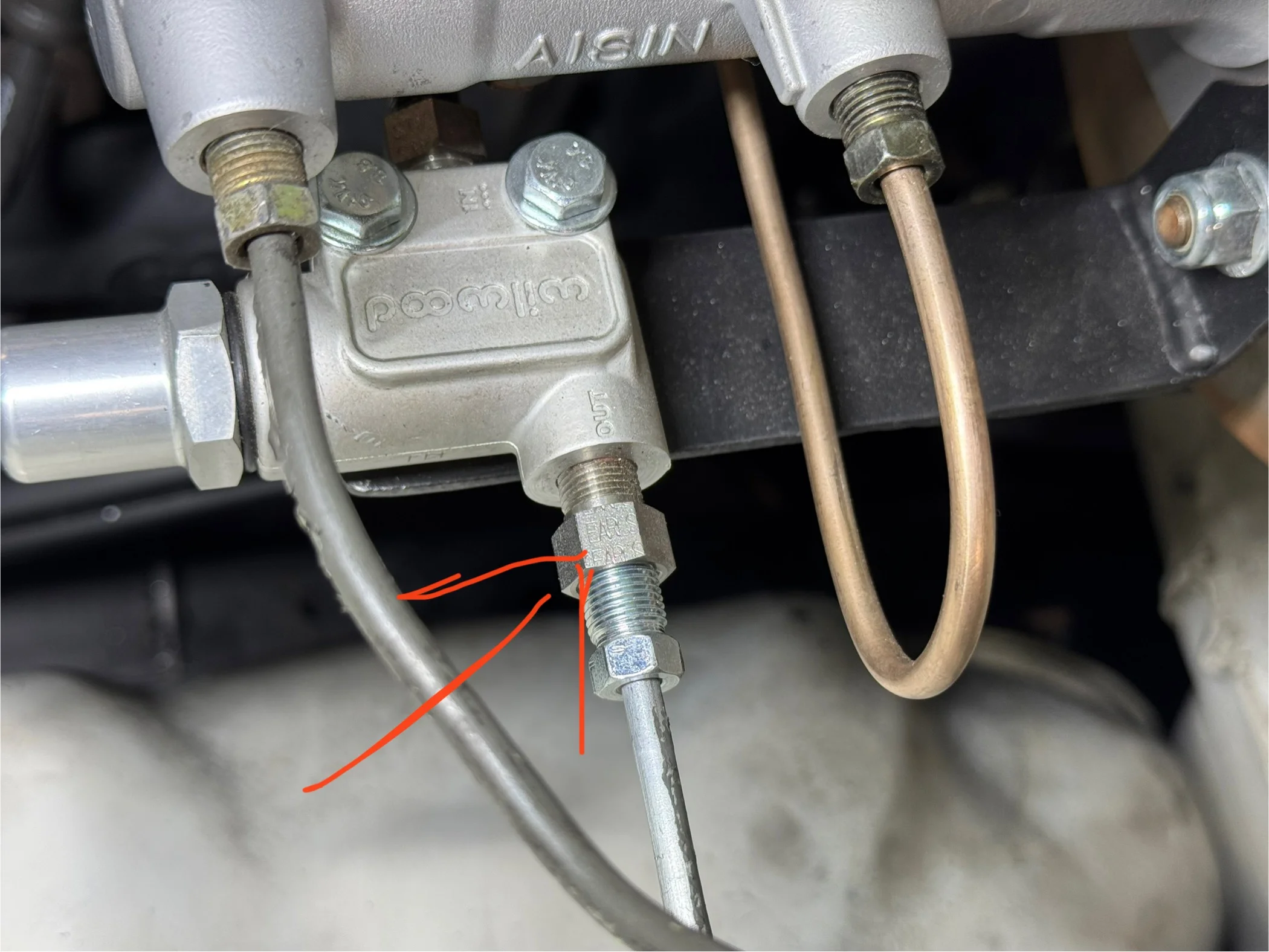

Also found this joint to the earls adapter was leaking. If you use this adapter I recommend putting a new m10 fitting and flare in place. The fitting is too shallow and the OEM fitting barely gets a single thread
