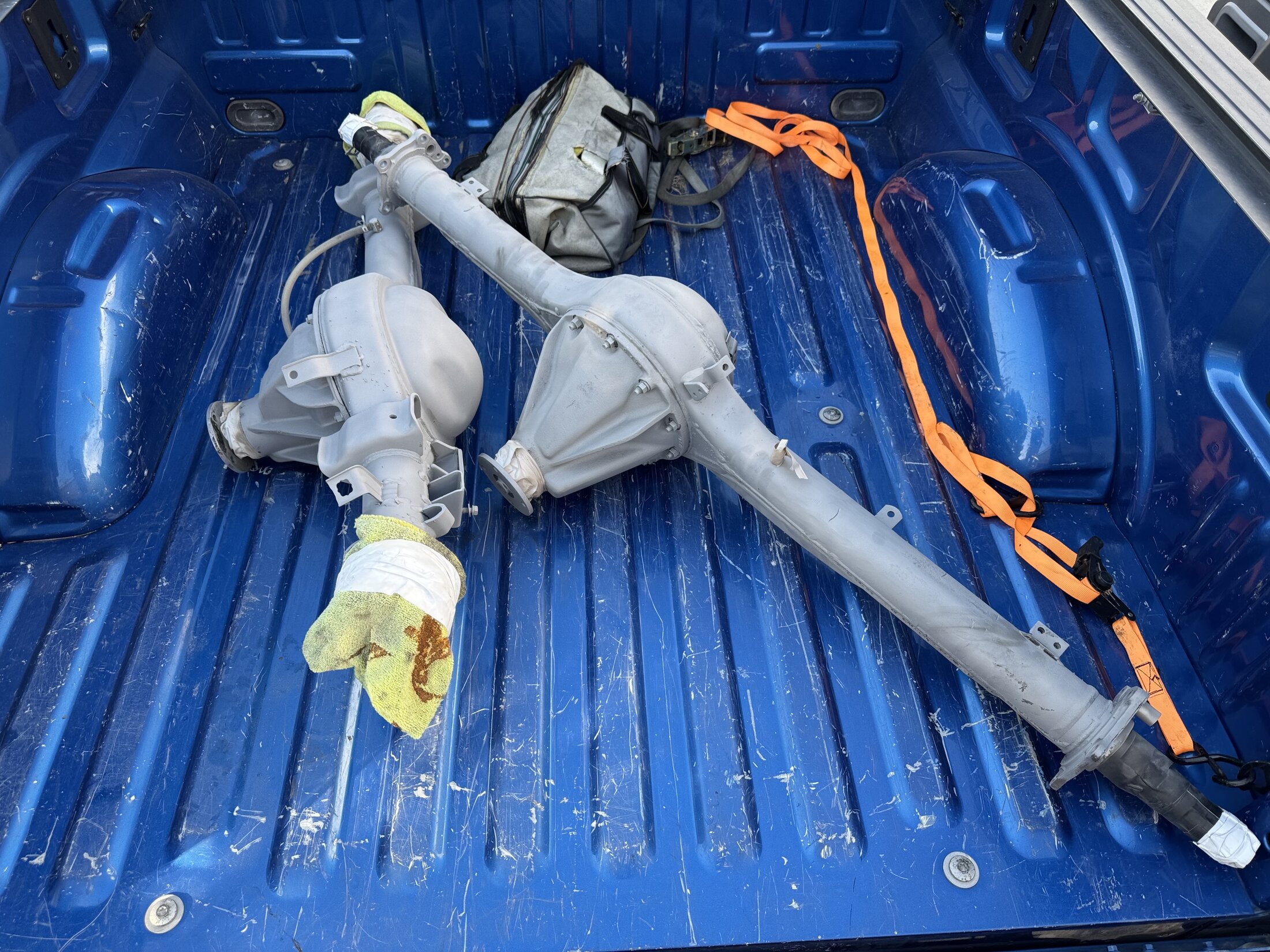

Working on the FF 80 axle disassembly. Pulled the shafts out, over half the hub studs came out at the same time…. What’s the consensus ? Replace with OEM studs?

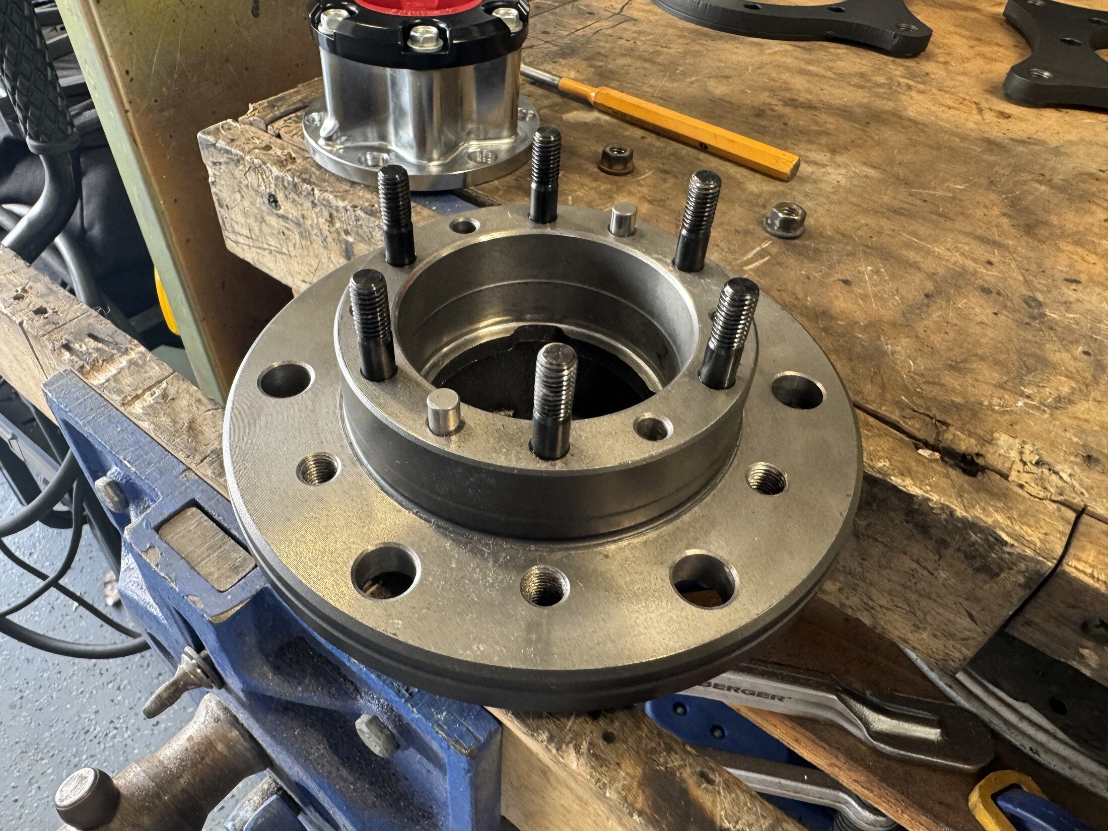

Started some assembly on the hubs after masking and painting last night. I don’t paint wheel or brake rotor mounting surfaces or sealing surfaces.
The FROR kit comes with ARP studs. Have seen mixed reviews, but the way the OEM ones came out on the rear, no way these are worse

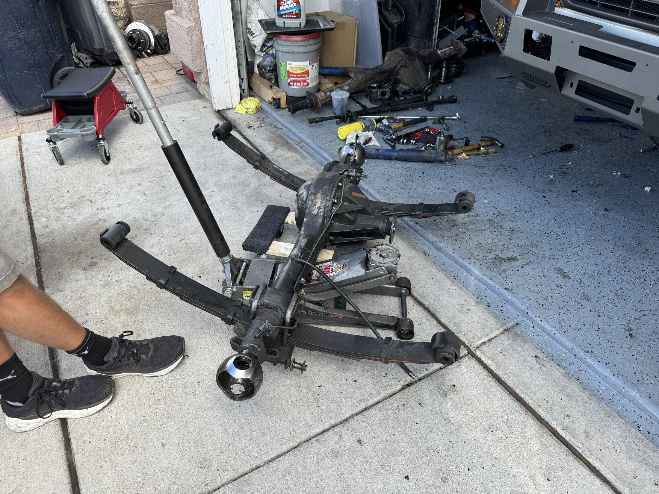

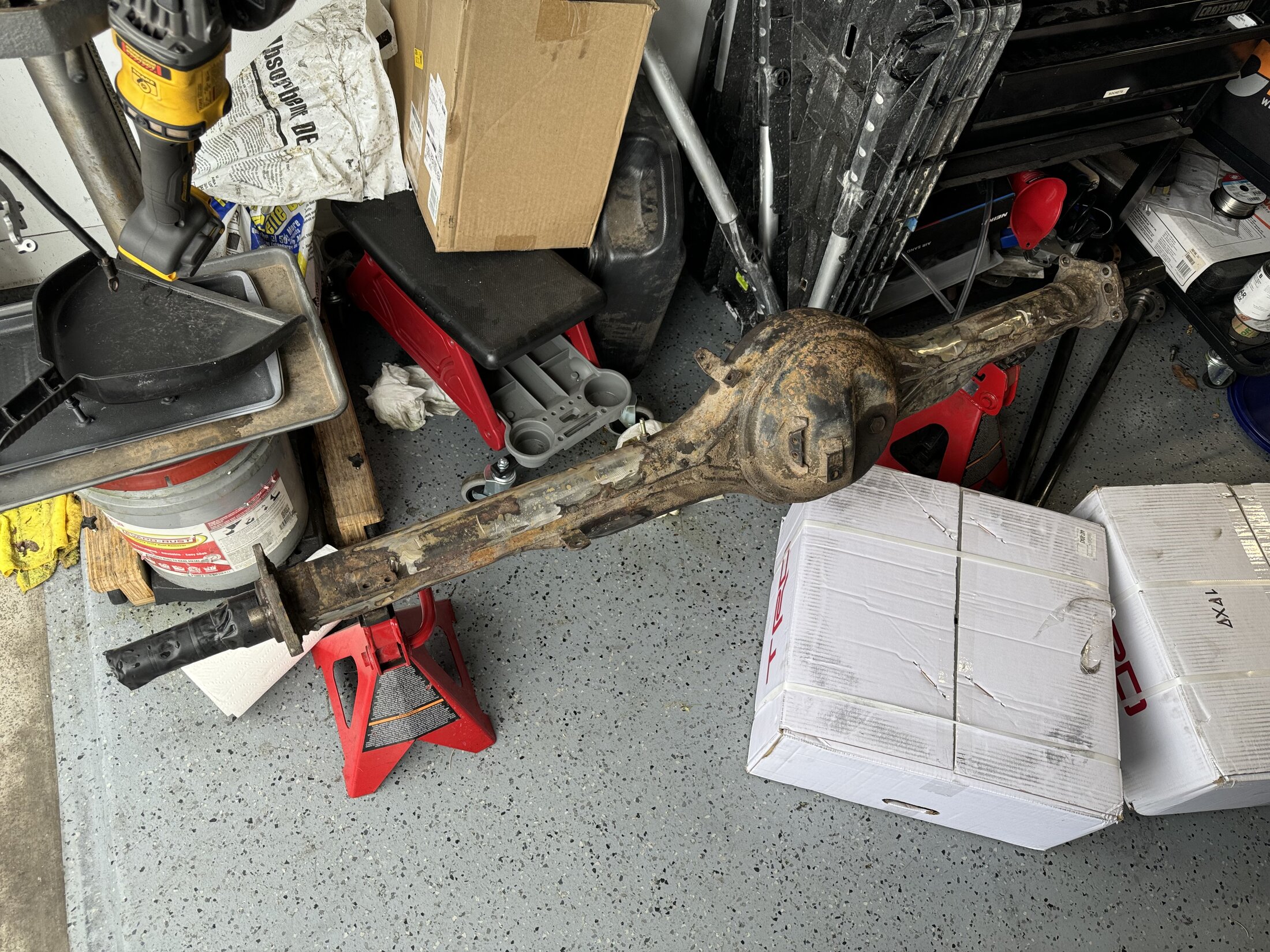

Got the front axle out in prep for rebuild and new lift kit

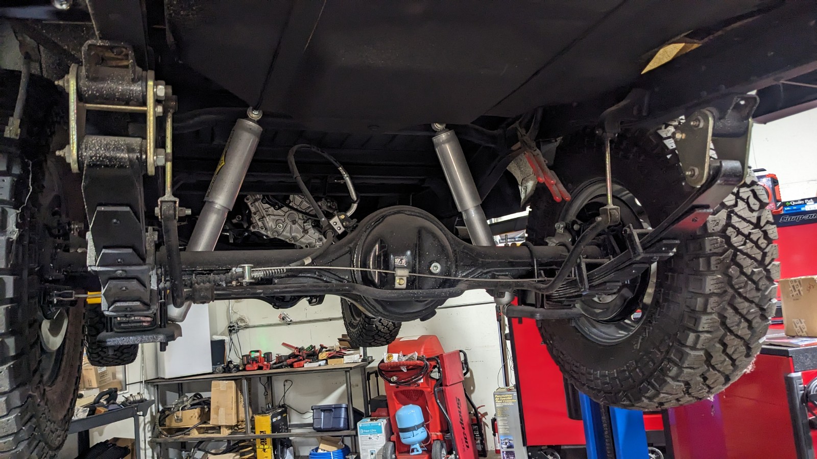

Removed the 3rd leaf from the leaf packs based on some fellow feedback here for the Dobinson's. 4 deg caster shims also

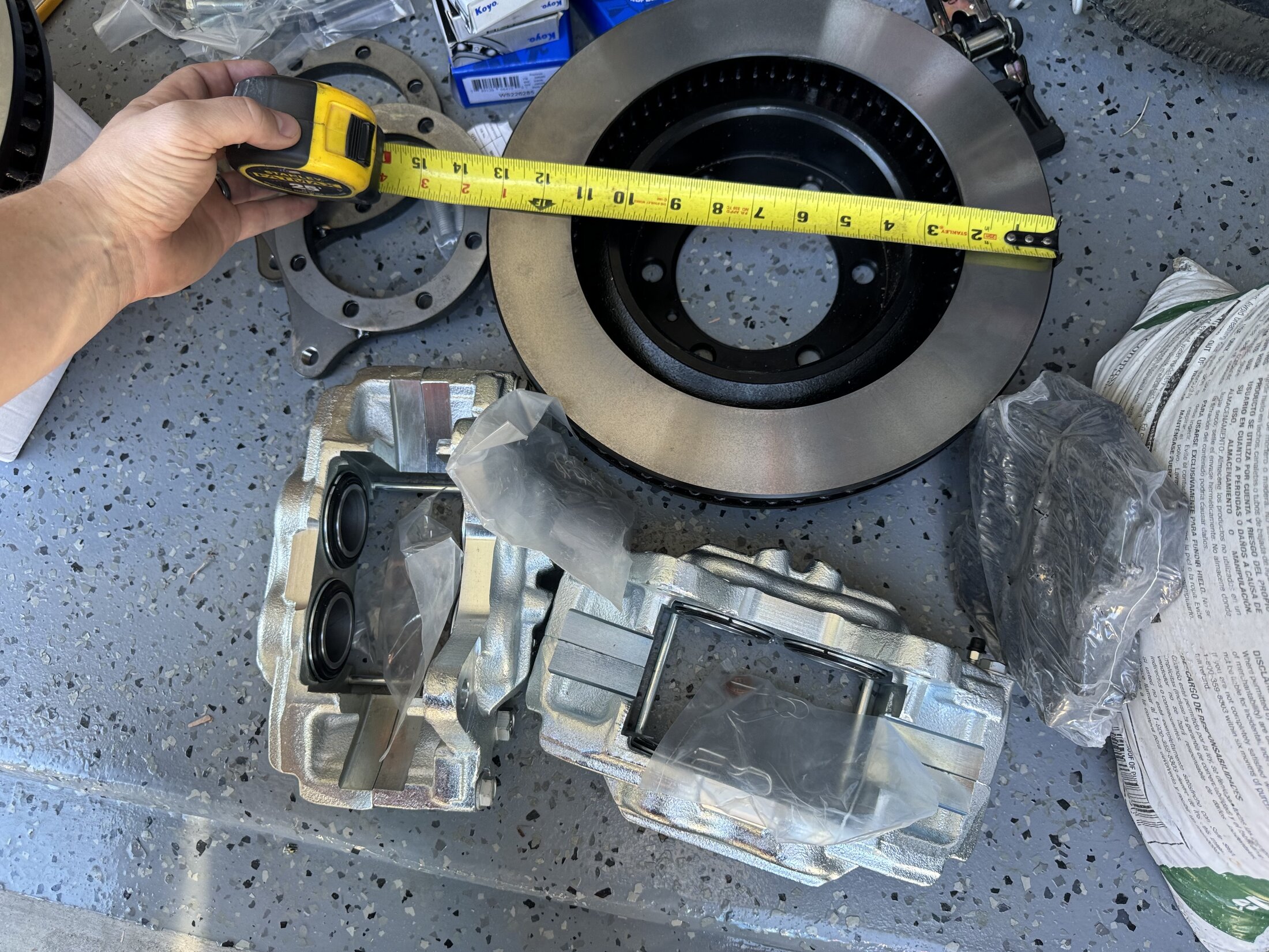

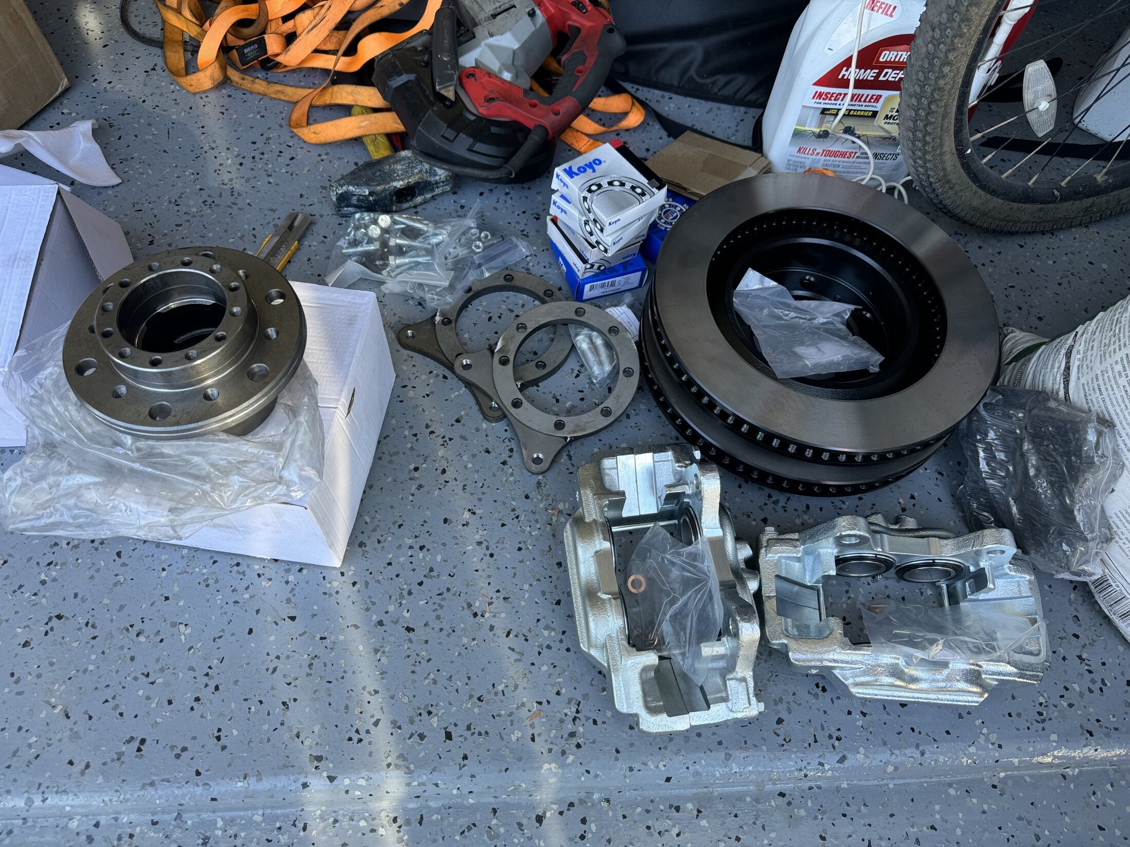

Started the normal knuckle rebuild, and got the big brake kit and IFS hubs on to match the 80 rear width.
