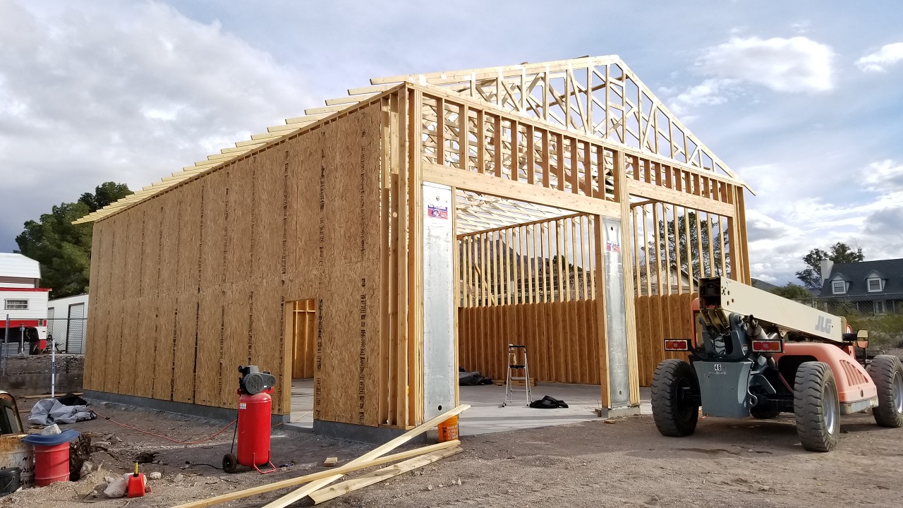

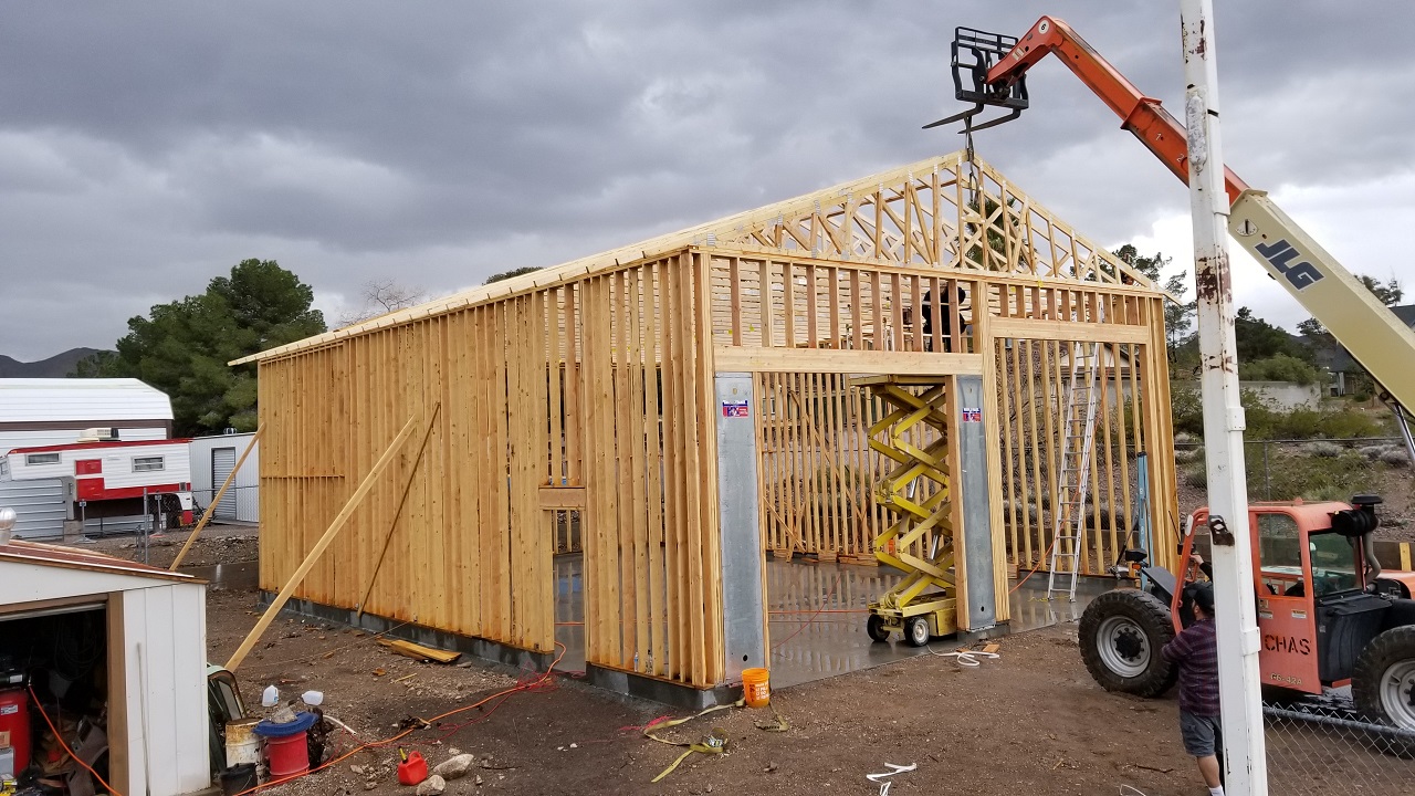

Coming right along, what are the grey “Hardi frame” panels for under your left door? I’m not familiar with them up here.
They are for shear... since the front wall is almost entirely made up of the garage doors that provide little to no shear. They have 24" 1 1/8" bolts that go down into a 4'x5' concrete footer. Had I made the garage wider and allowed room for 1 4x8 piece of OSB on each side of each door I don't think I would have needed them.

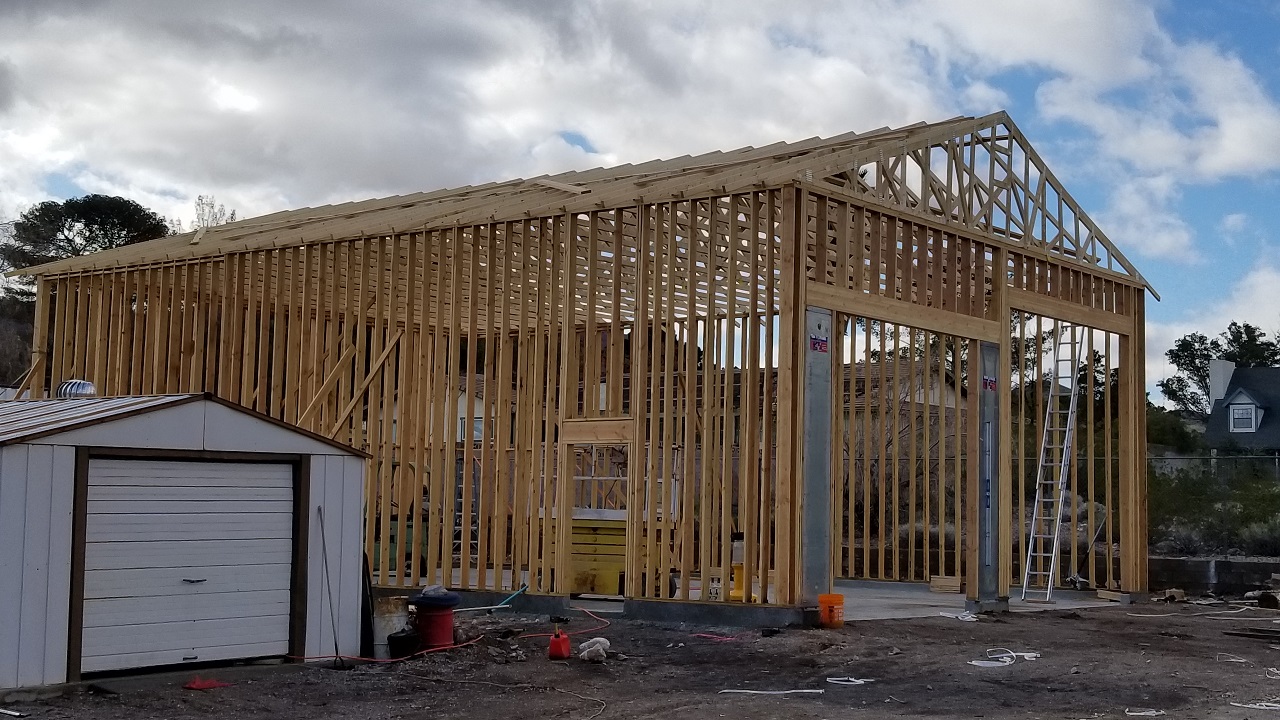

Ended up setting the trusses right on schedule -
Started sheeting the sides pretty much immediately after -

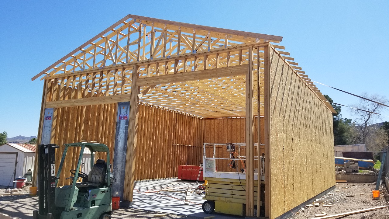

Day 1 progress of sheeting the roof -
Roof all done and trimmed up! -

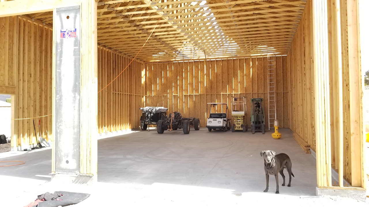

Rolled the 45 frame into the shop for the first time!! What an awesome feeling having so much space! -

Looks awesome, speedy work! What are the metal panels called on each side of the shorter sectional door?
They are called Hardi Frames. They are for sheer since the garage doors take up the majority of the wall.

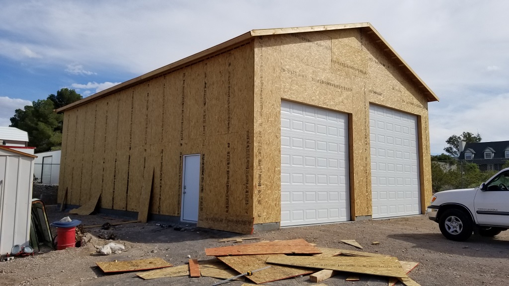

Well, due to not much going on in Vegas right now I've had plenty of time to work on the shop, and it's actually getting close to being signed off as completed by the city!

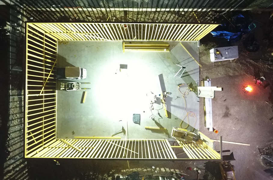

My neighbor took this awesome drone shot one night during framing -

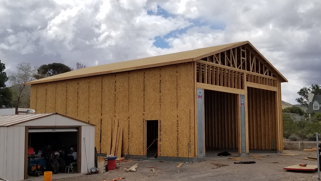

Got the front sheeted, garage doors installed, walk in door installed -

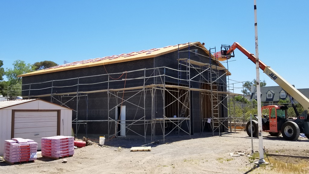

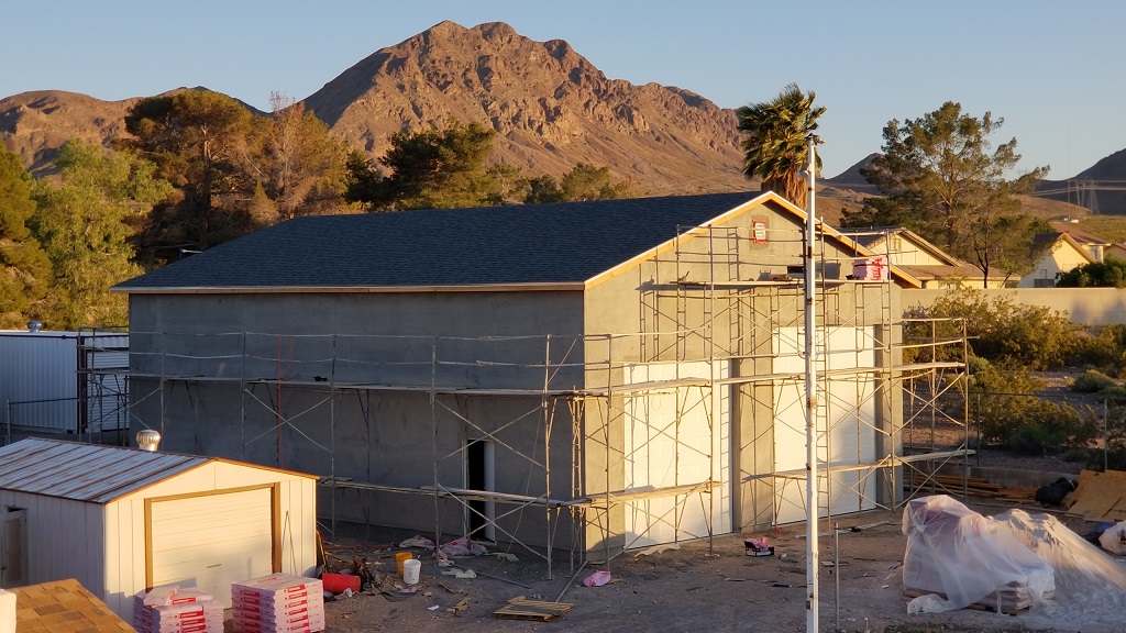

The stucco guys set up scaffolding to start as we got the roof ready to shingle -
First coat of stucco on and roof is done! She's water tight!

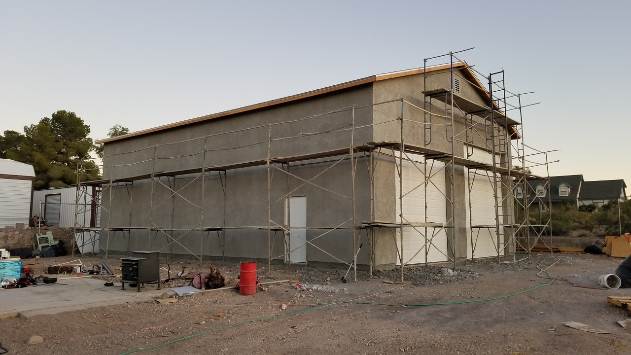

Stucco is done and they're leaving the scaffolding up for me so I can paint the shop with it.
