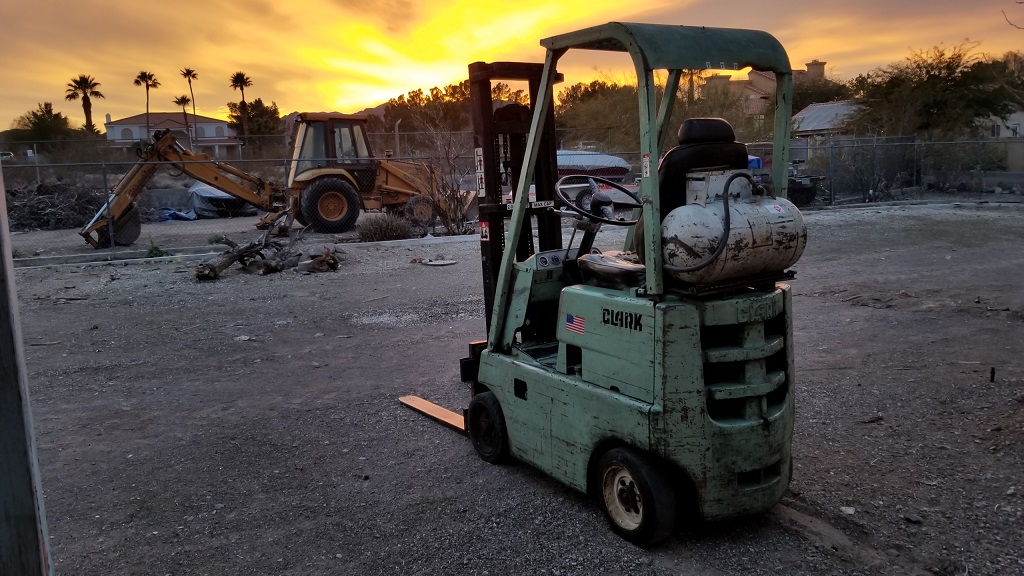

And the newest machine to help out around the shop and property
It didn't run when I got it, but all it needed was a new starter. Runs great and now I actually look forward to doing a body or motor swap!

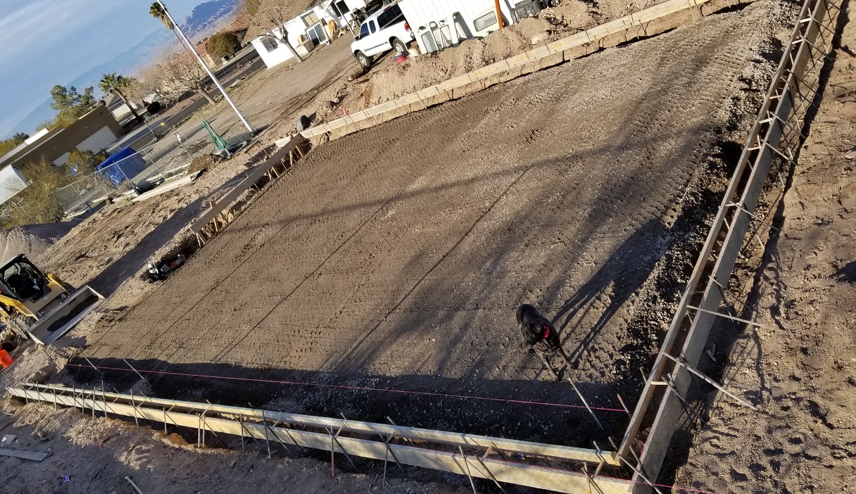

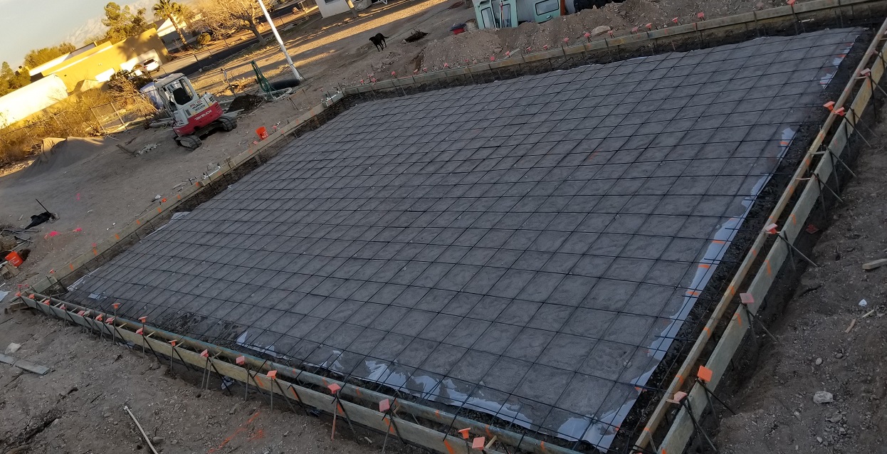

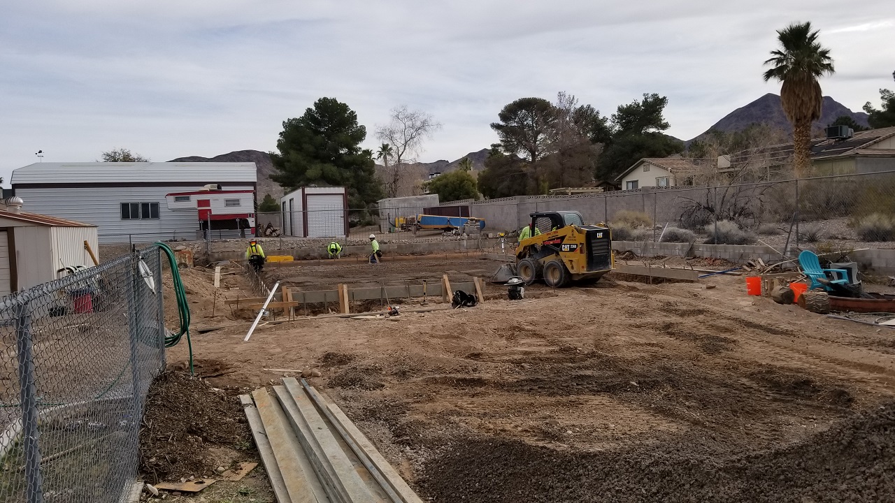

Got some good progress done this week! Concrete company is doing a great job with pad prep -
The pour is scheduled for this coming Monday!

I don’t see any extra thick spots for the hoist, or are you going thick on the whole floor?
Slab ended up being 5" thick, and I dug out an extra inch in a 2'x3' pattern under each post, so 6" should be good.

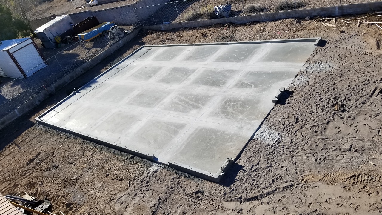

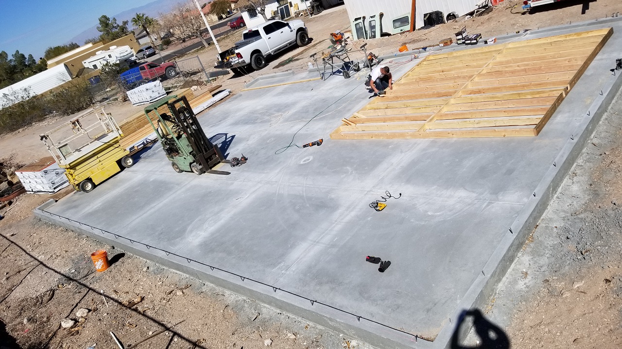

Pour went smooth and everything looks great! Letting it cure right now and plan on framing the weekend of the 20th. Fingers crossed to get the framing done and roof trusses on within a few days. Each of those relieve cut areas are about 10'x9'

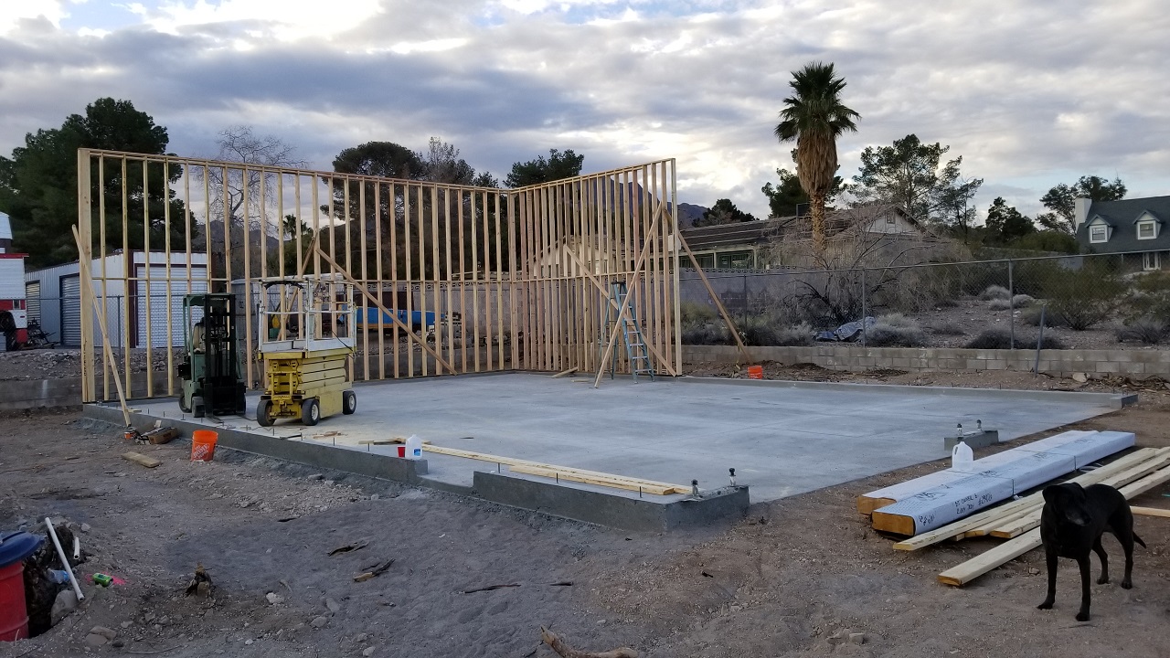

First wall going up!! They didn't look like 16' long boards on the ground... we even measure to make sure they were! After leaning them up we couldn't believe how tall this shop was going to be! The curb is about 6", plus the 1.5" mud sill and 3" top plates, so the walls will be just shy of 17' high!
And the end of our progress on day 1. We had to block the studs on the end wall and 16' out on the side walls for shear, which took a huge amount of time!

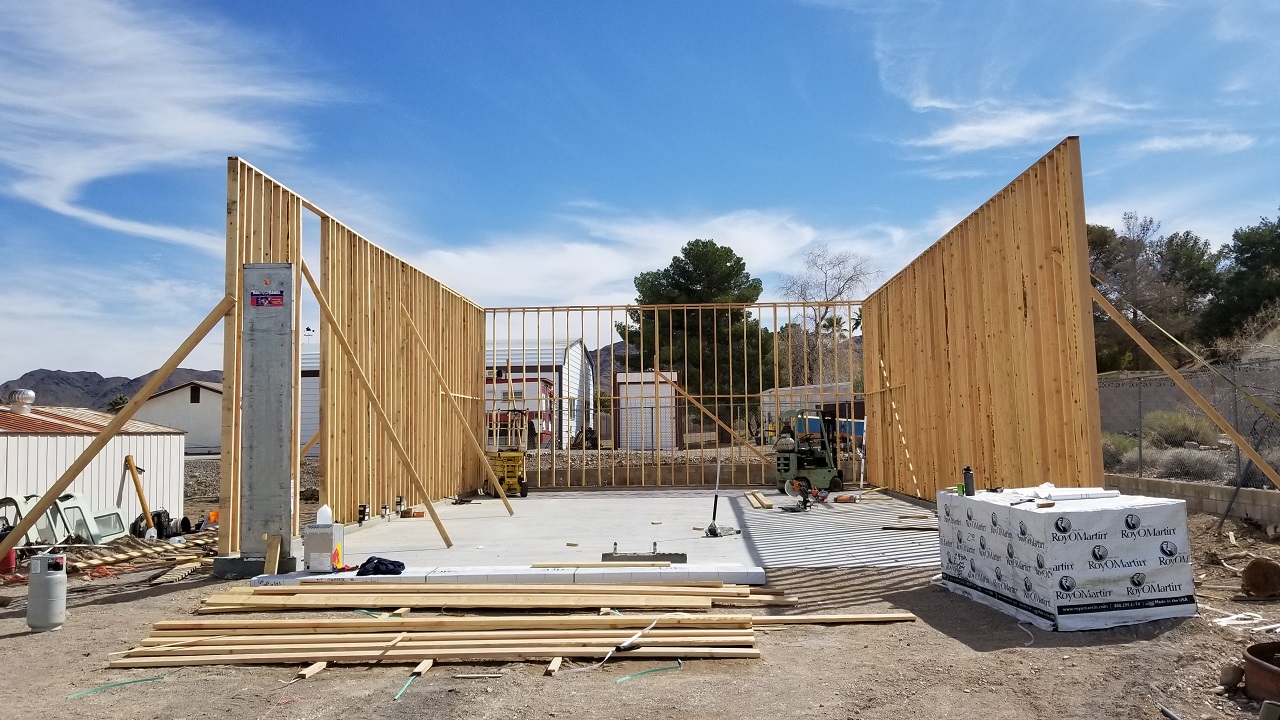

The 3 walls up and one of the Hardi Frames

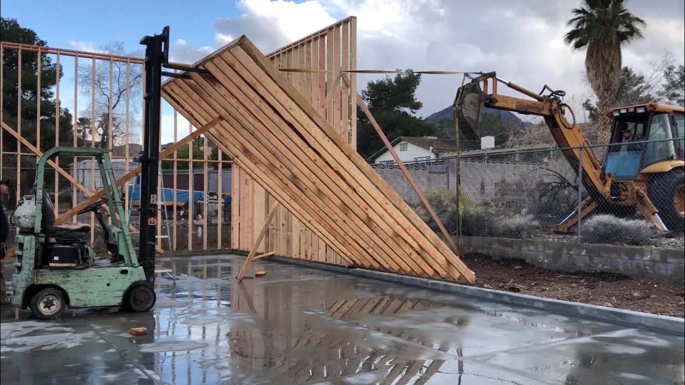

It has been really nice using the equipment I've purchased. Each time I use it I have a feeling of relief I'm not renting it any paying by the day. It really takes a stress out of the project. In this pic, the backhoe is lifting the wall from the peak forklift height which is only about 11'. Very nice not having to manually tilt up the walls!

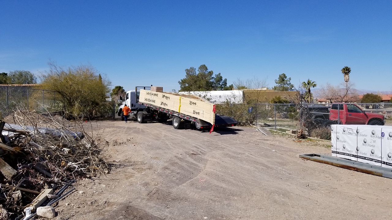

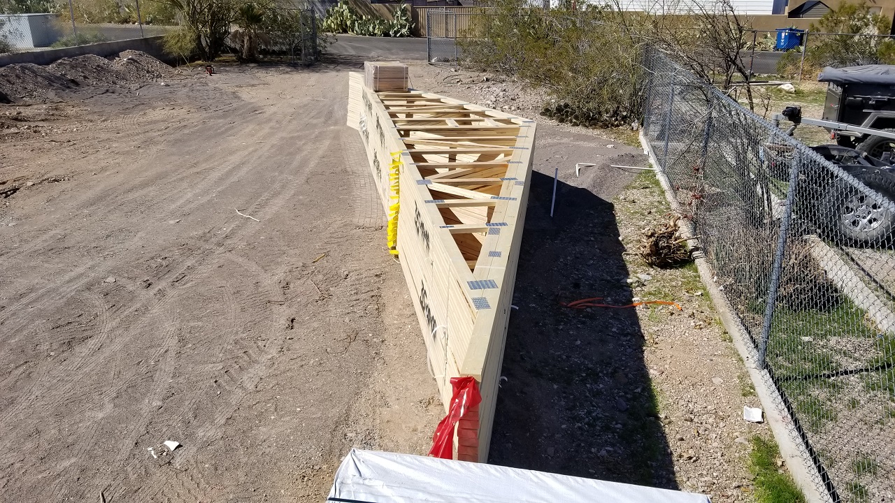

Trusses got dropped off last week

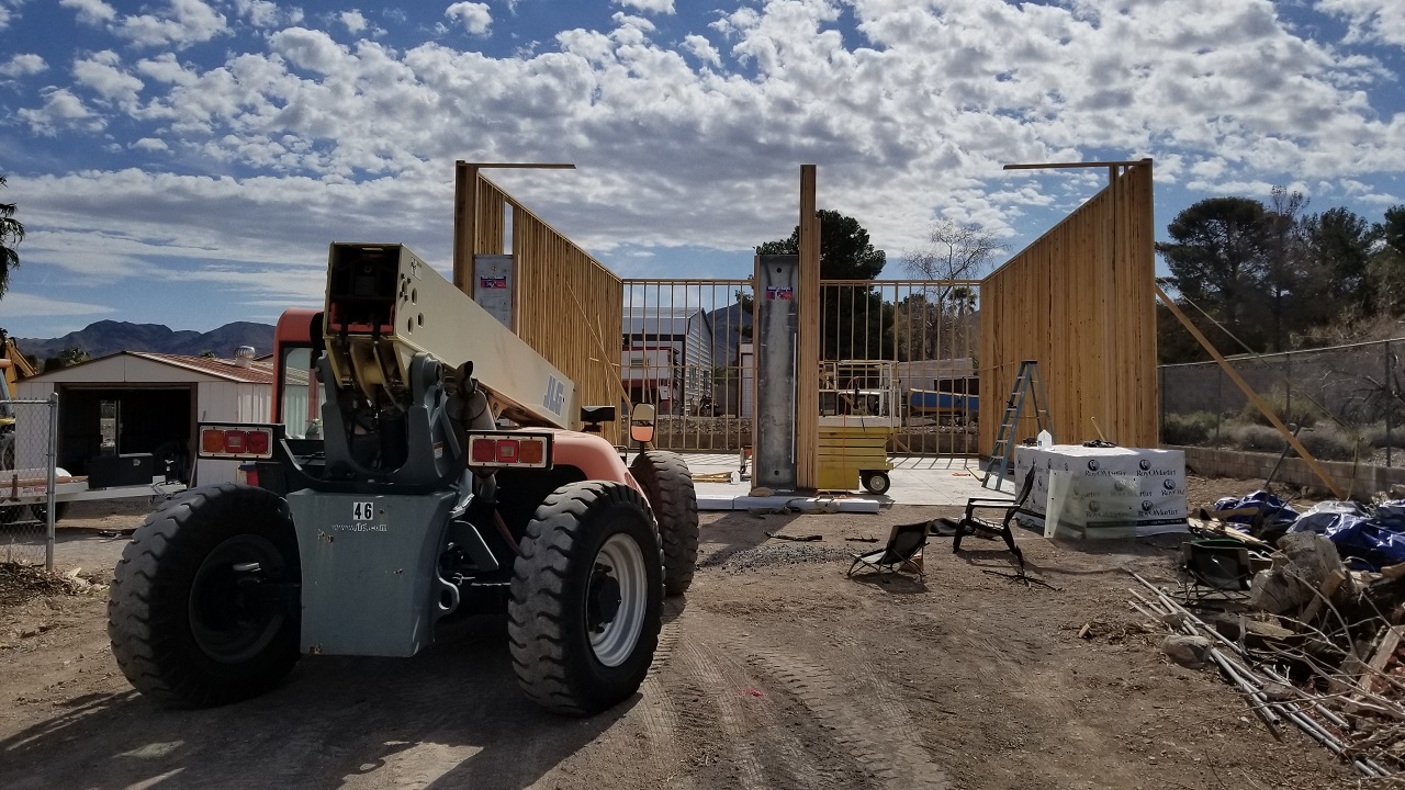

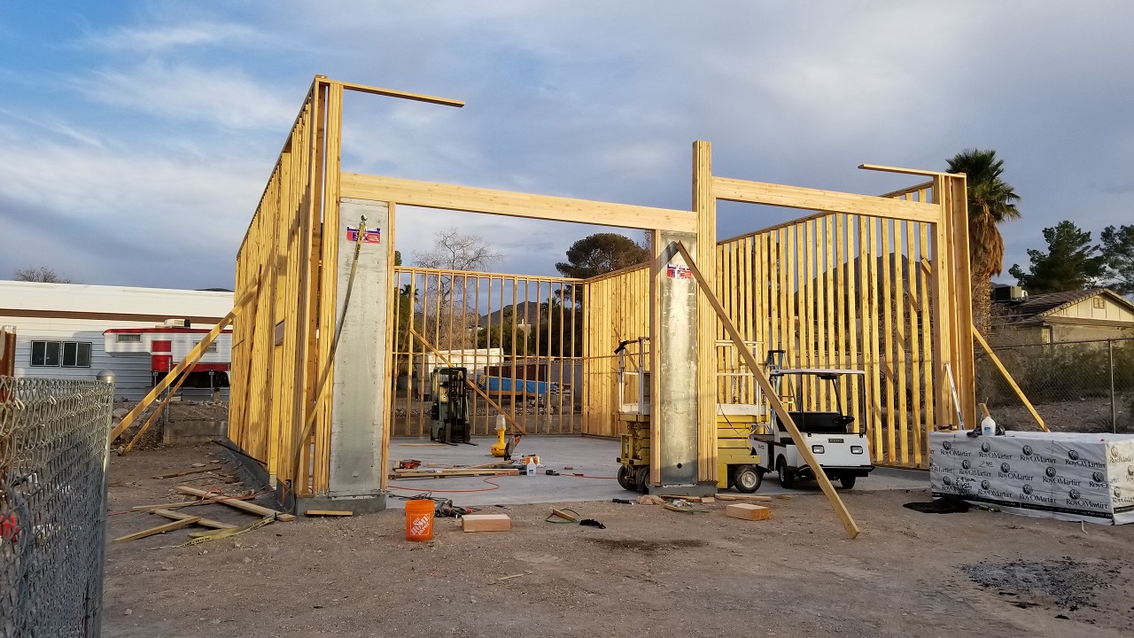

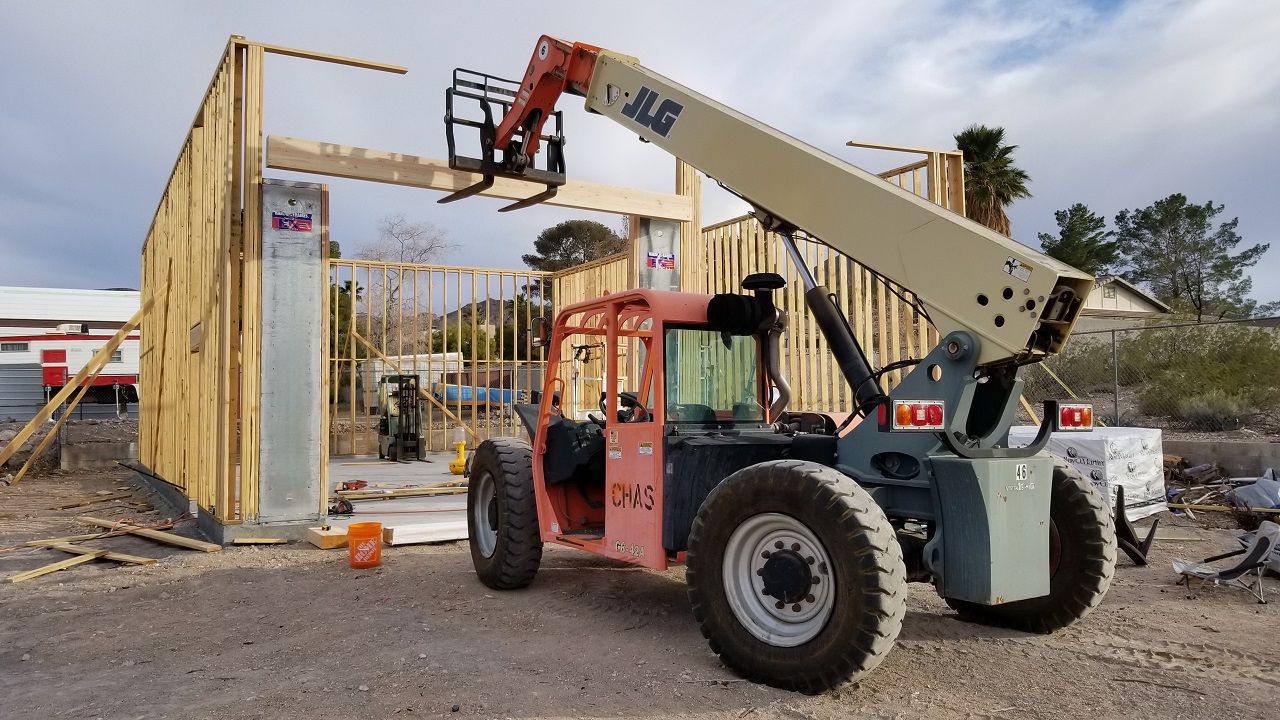

Extremely lucky to have generous neighbors.... one of them brought his 40' high lift forklift over for me to use. Made putting up the garage door headers a breeze! Also planning on using it to set trusses
And how the garage sits now... Need to finish framing above the garage doors, then I'm ready to set trusses and sheet the outside! Stucco and roofing and the exterior will be complete! (Can also see my newest purchase - EZGO Industrial flatbed cart under the 14' door)
