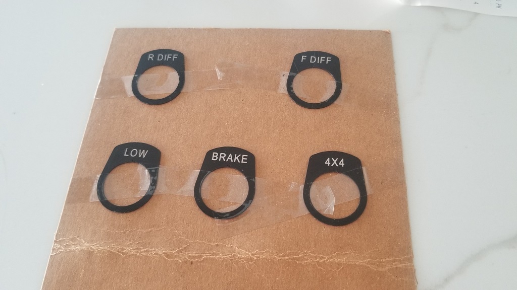

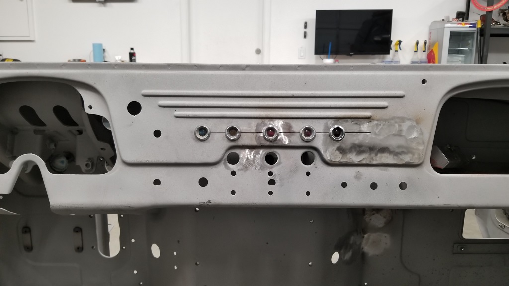

I rounded up a few other OEM 40 series warning lights to use with my levers. On the left, a green light for 4x4 (center diff lock), then amber for LOW, then red for REAR Lock, then red for FRONT Lock, then red for BRAKE on the far right. I deleted my factory ash tray for a cleaner look as well -

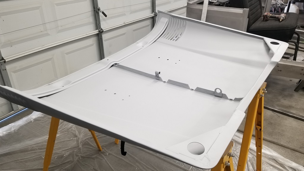

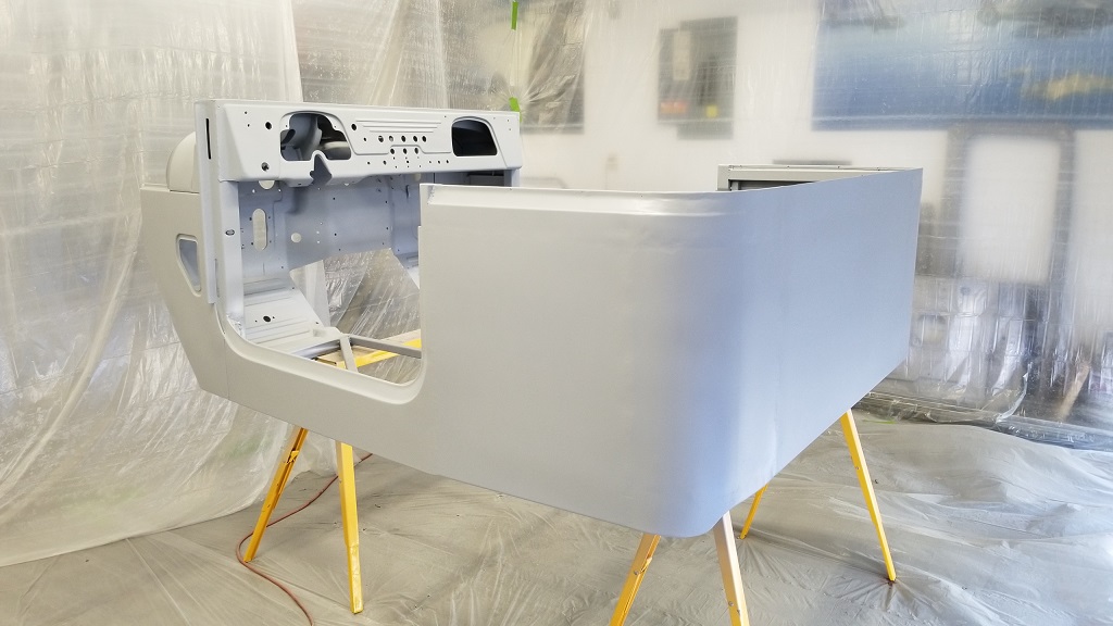

I decided to epoxy prime the under side of the hood to make sure the gun and primer worked like I wanted. I figured this would be the most inconspicuous surface... I was happy with the results. Planning on doing the rest of the vehicle myself now -

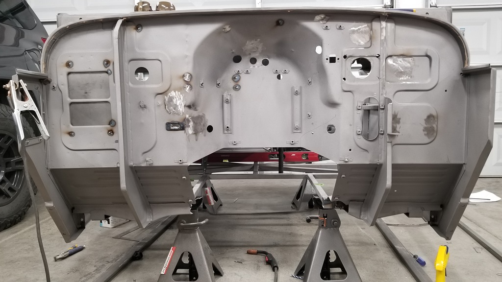

Lots of work on the firewall... Filled all holes I wouldn't be using, blocked the heater/vent plate, cut the factory rib to make room for the 80 series booster, increased the brake pedal rod hole to 3" and put 4 new holes in for the 80 booster. I think I'm done with it!
Planning on priming the tub tomorrow, and the rest of the panels the following day!

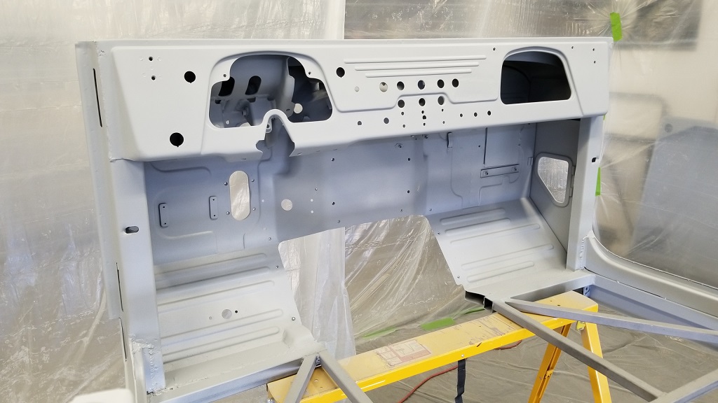

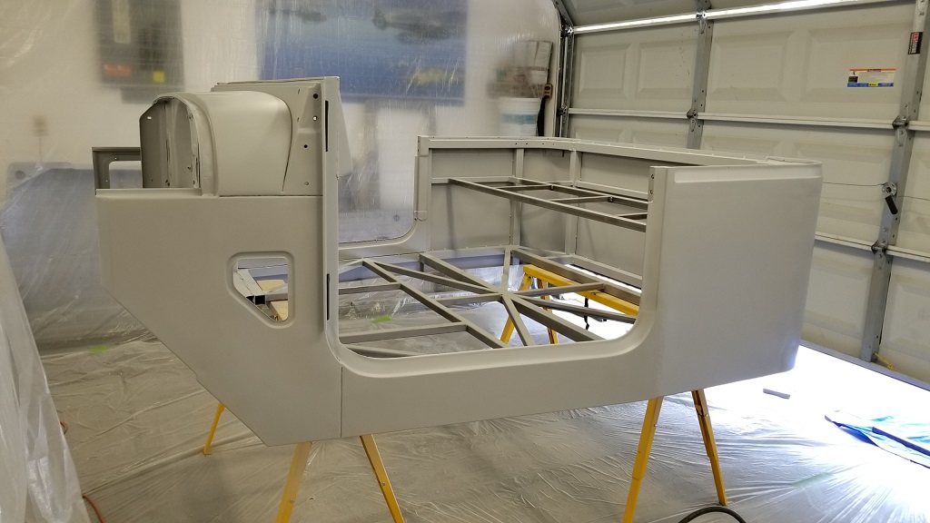

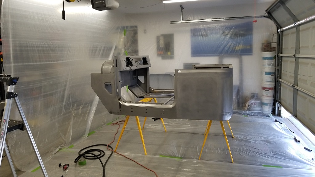

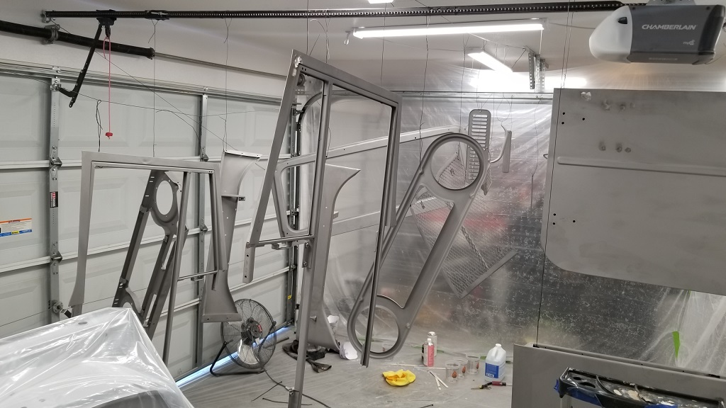

Weekend went according to plan and happy with the results! I thought about spraying everything in a friend's booth, but rain was forecast and I didn't want to chance getting rained on during the commute. I made a home made paint booth and the epoxy laid down pretty well

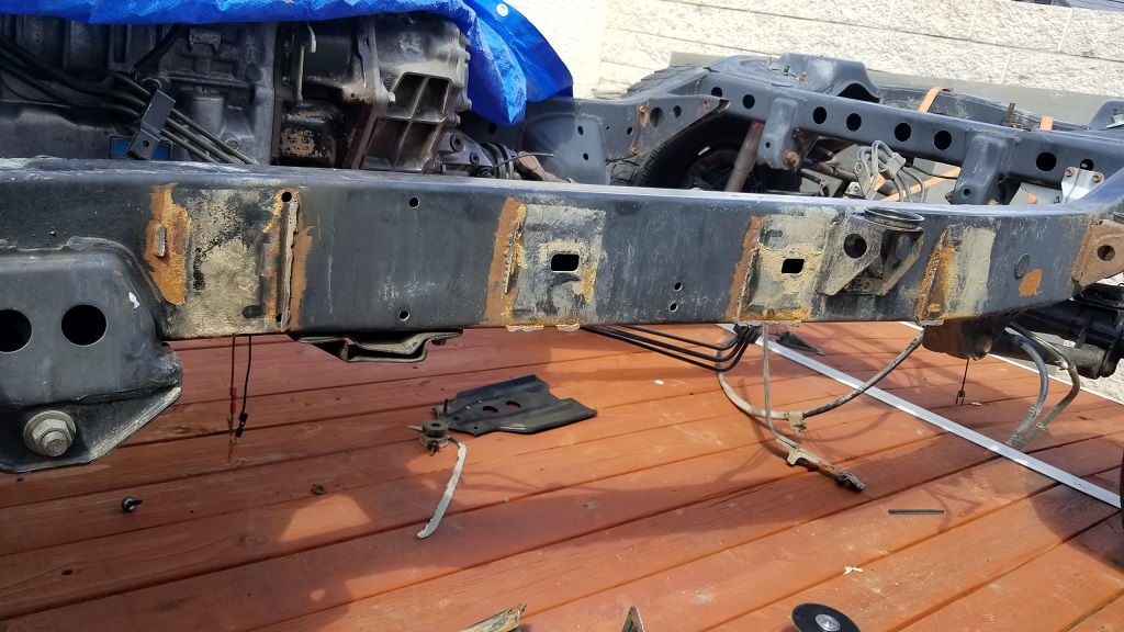

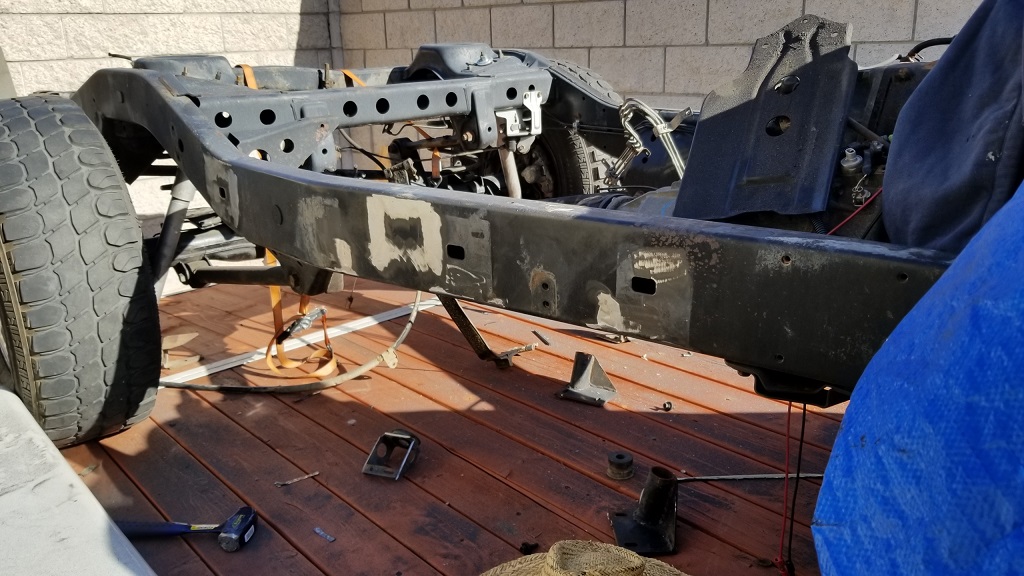

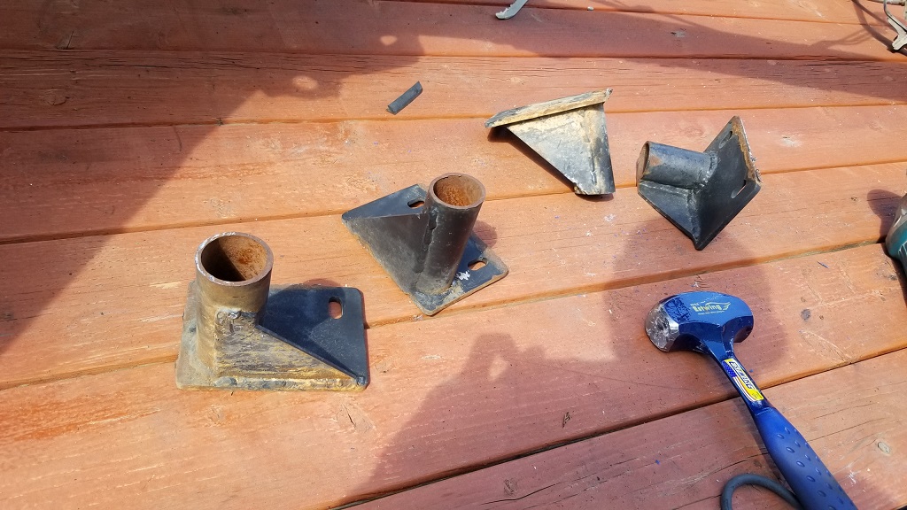

I did 3 coats of epoxy primer. After shooting the tub, I finally cut off the awful 'slider' mounts that someone welded to the frame. Thankfully, they were terrible welders to it made it much easier to take them off. It was tricky cutting through the welds without hitting the frame though... I also took off both middle body mounts on each side.

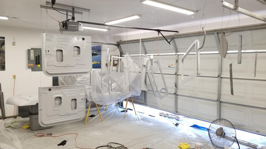

I let the tub dry overnight before moving it to the corner of the booth. I then got creative with some bailing wire and made quite a few hangers to keep the pieces off the ground
And everything shot -
Now I need to put filler on the welded seems, high build primer on everything, sand everything down, then ready for paint! It's nice seeing everything one color now, and not having to worry about any of the pieces getting surface rust!

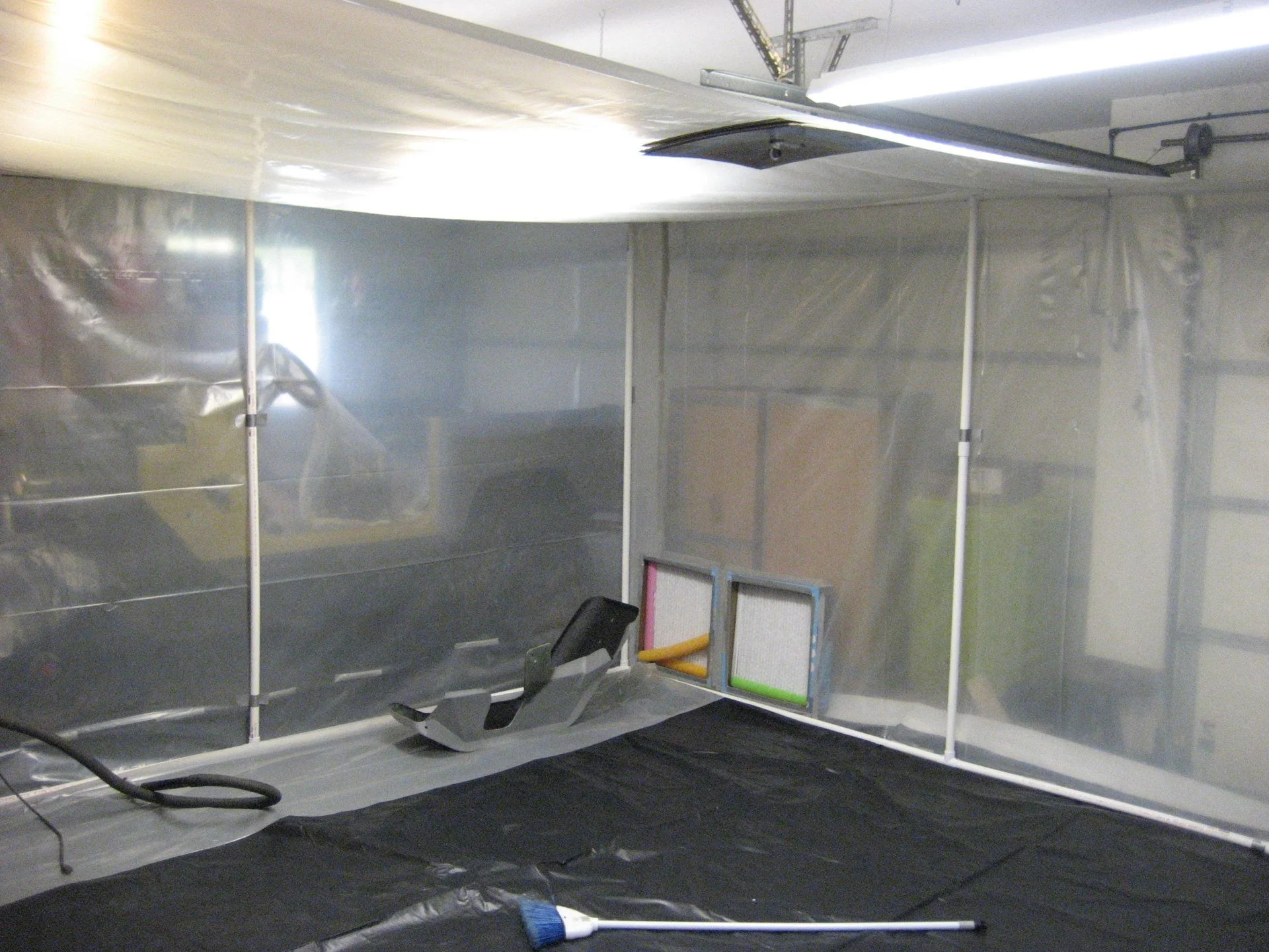

Your "booth" looks a lot like mine when I did my paint job...couple lessons I learned and it appears you have mastered is lots of light!!!
The more the better so you can see what you are doing better :-) I did not have enough light and there are places where it shows that I couldn't see what was being laid down on the panels ..(Bummer..) Be sure you have tons of ventilation and if at all possible, fan motors that do not spark! Won't go into why that is important o_O..
I'd imagine that Vegas is dry enough that you won't have any issues with moisture in your compressed air lines, but watch for that little gotcha too...

I did order some light labels from Redline out of Colorado and they came out perfect!!

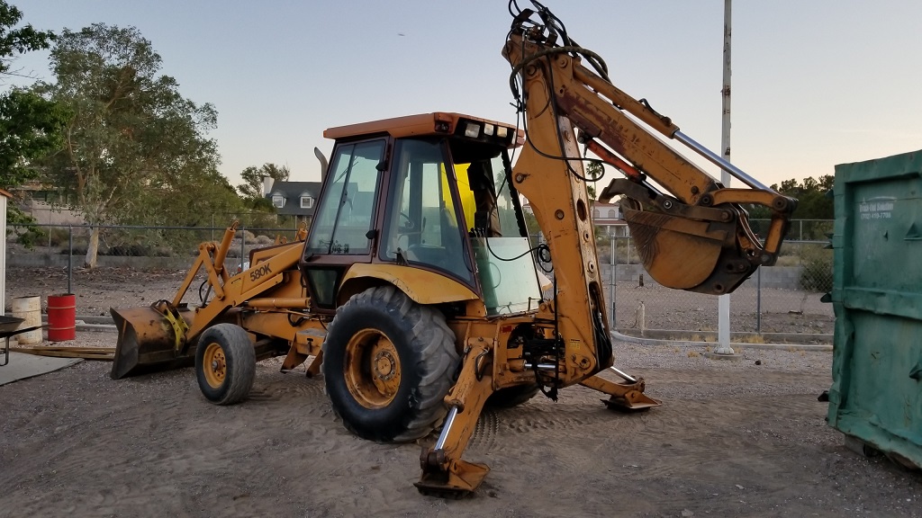

I also got to buy this toy to help out around the property!! I've been having a lot of fun with it!
Thanks for your patience and I'll post more if I have time to work on the 45!
Um yeah... this crowd generally enjoys shop stuff as well as truck stuff.
Gratuitous backhoe pics aren't a problem.
