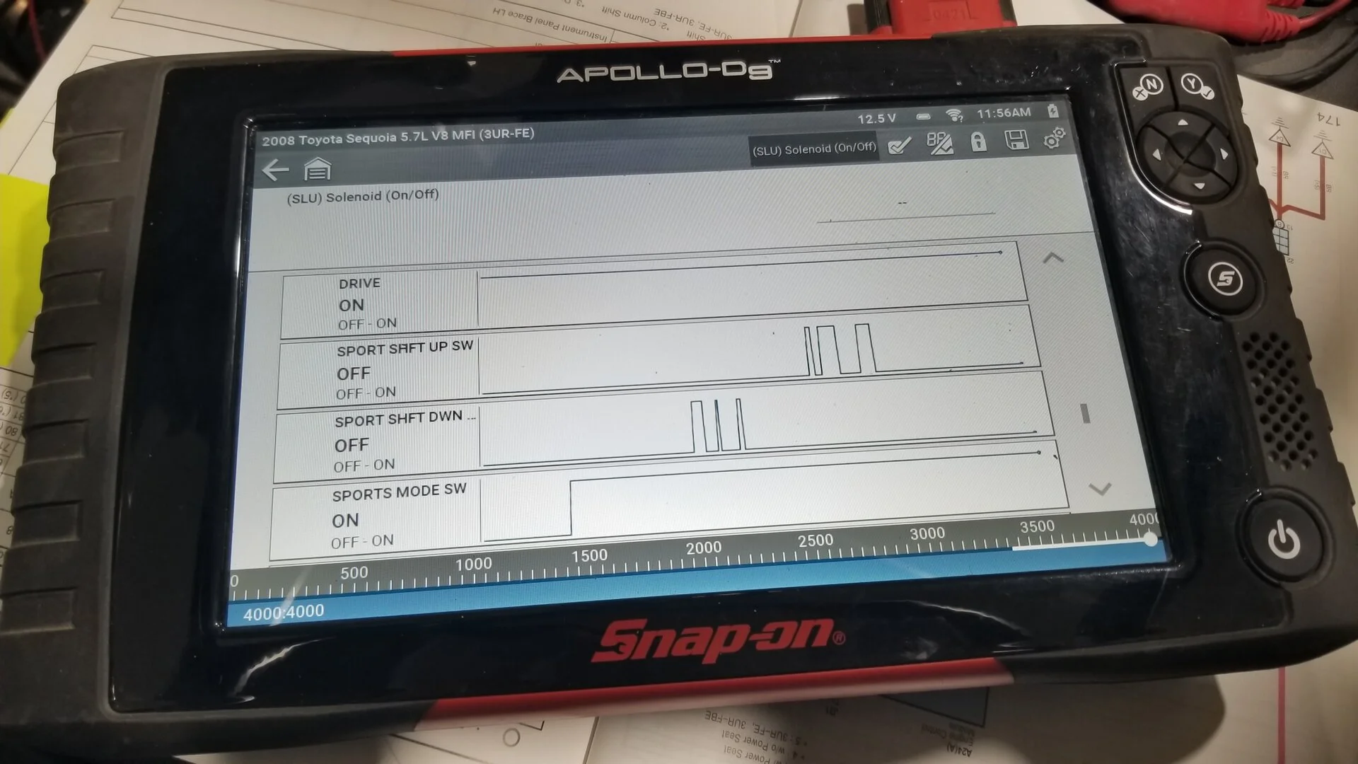

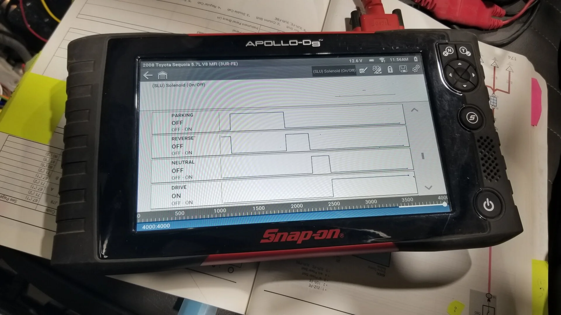

Trying to knock more stuff out every day. The last couple days was all focused on getting the manual bump shift to work. For some reason, it wasn't letting me shift it manually. I used a Snap On scanner to get into the transmission which told me exactly what it was trying to do.
This shows each gear and when I cycle the shifter through P R N D -
This screen shows the activation of the manual sequential shift mode and the pressing up the shift up / down buttons -
The issue ended up being the neutral safety switch. It needed a diode as the start circuit was backfeeding 12v into it, so it thought it was in P or N at the same time as R or D. Once the diode was put in, the code went away and manual shifting worked!

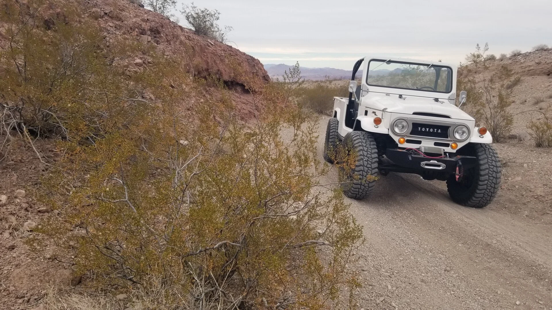

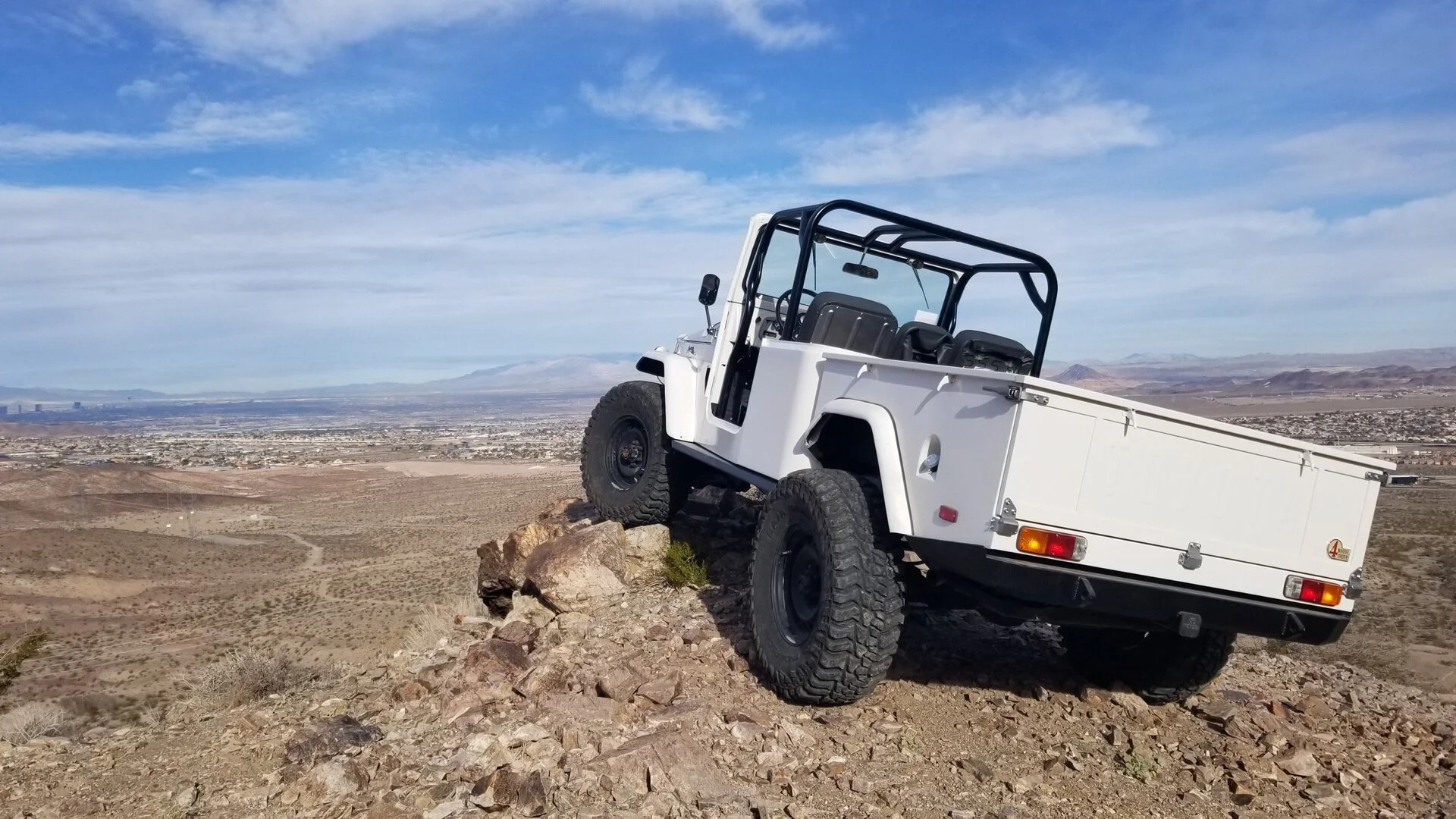

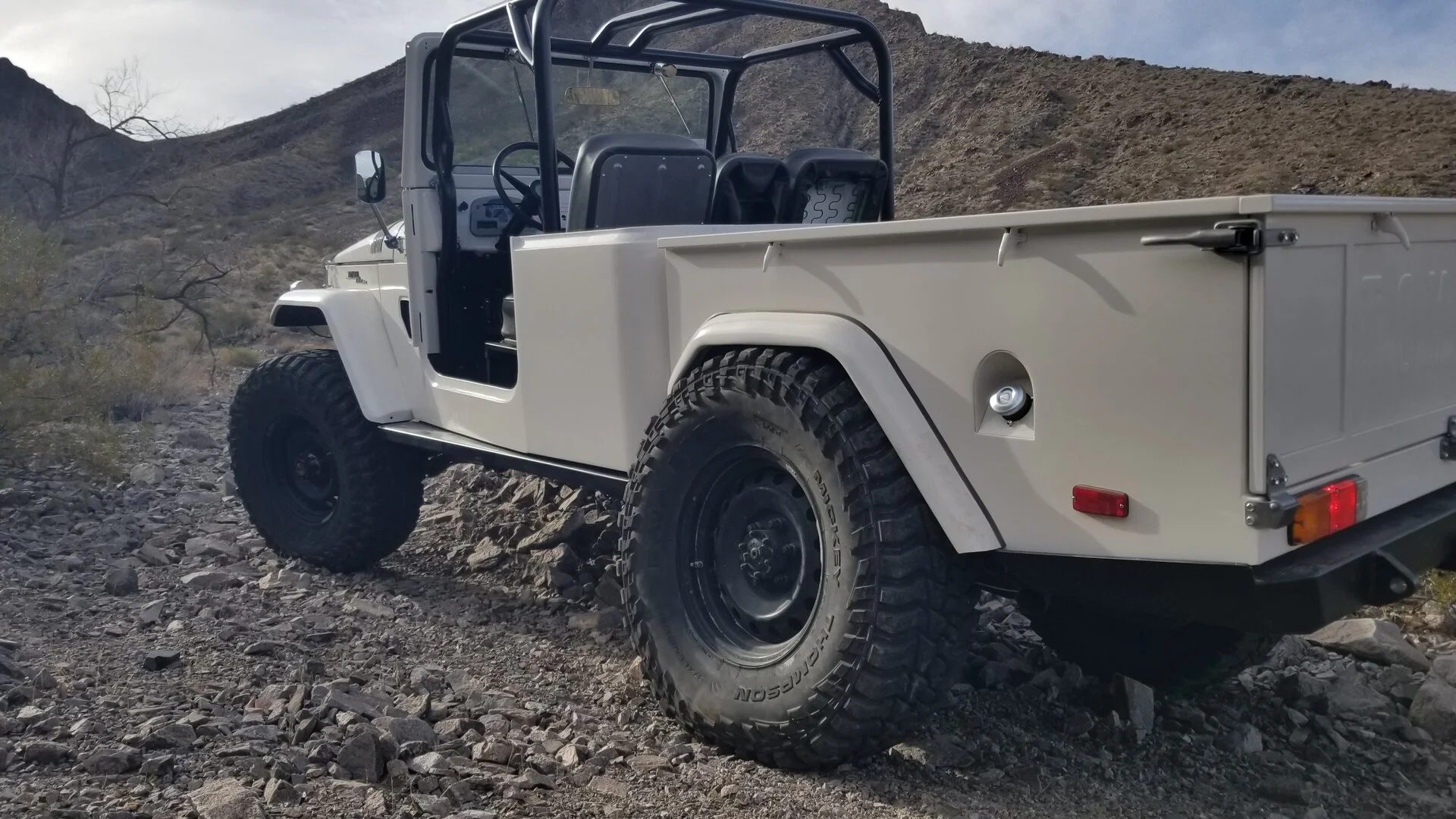

Got her out in the desert today for the first time. All systems worked well and made it back home without a tow strap so I'm happy!
Awesome to see it out on the trail. Looking forward to seeing it with the top on.
Thanks Dennis, me too. I'm delaying the fiberglass work as long as possible 😏

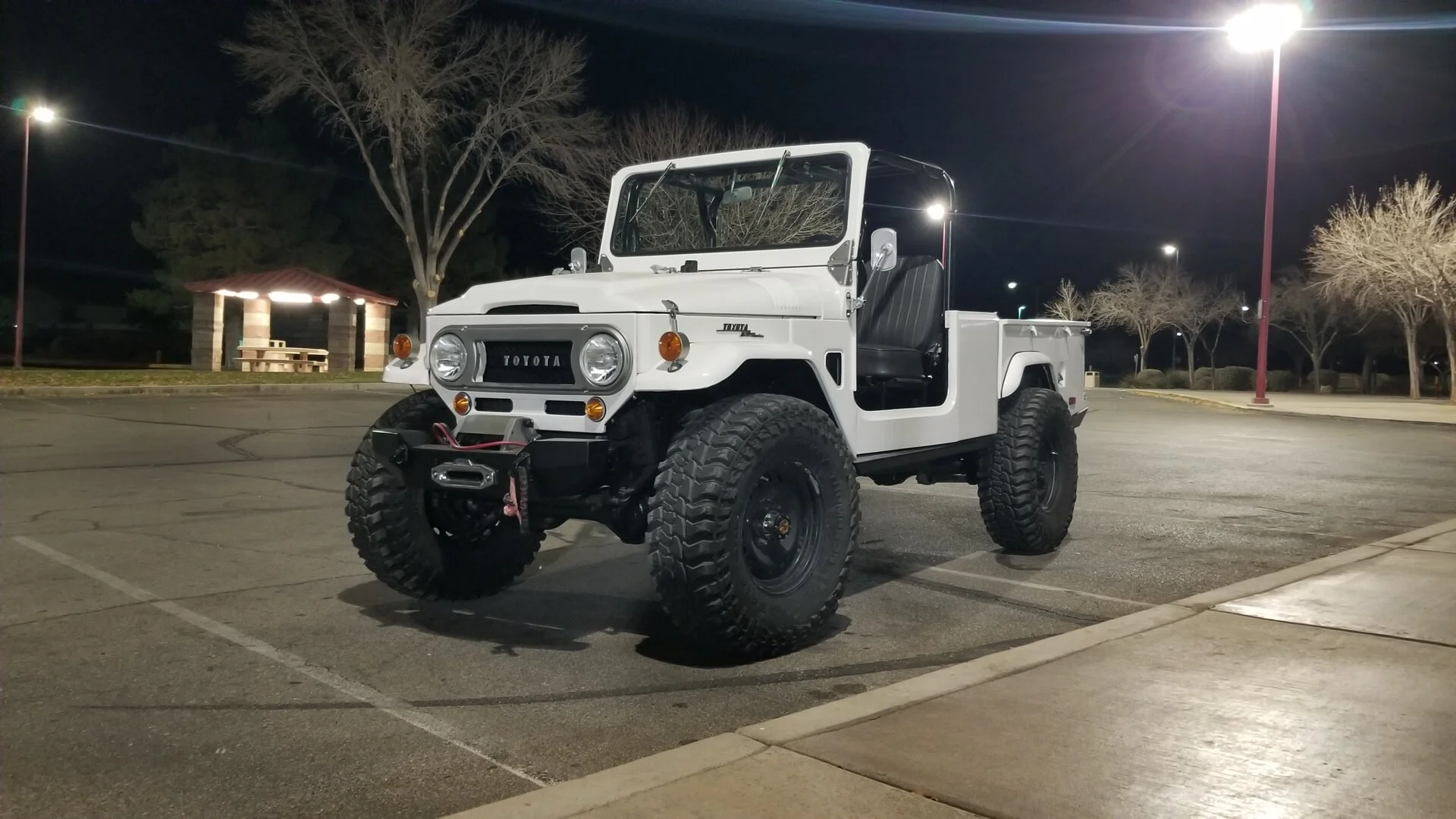

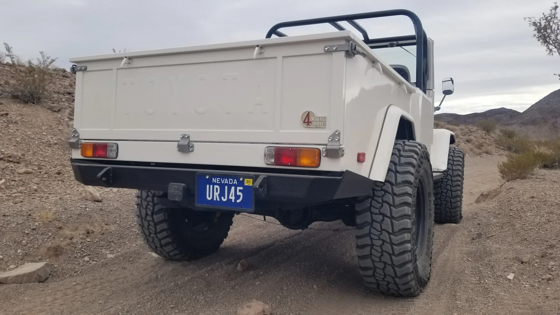

Lots of paperwork and phone calls the past few days, but with a huge amount of assistance from @2manycruisers , URJ45 is now legally registered!
Towed it to the DMV for VIN inspection, engine swap inspection, and smog inspection -
Finally getting my new plates I ordered back in November -
What a better way to celebrate than a quick trail run with my loyal companion -
Almost hit 100 miles on the way home -

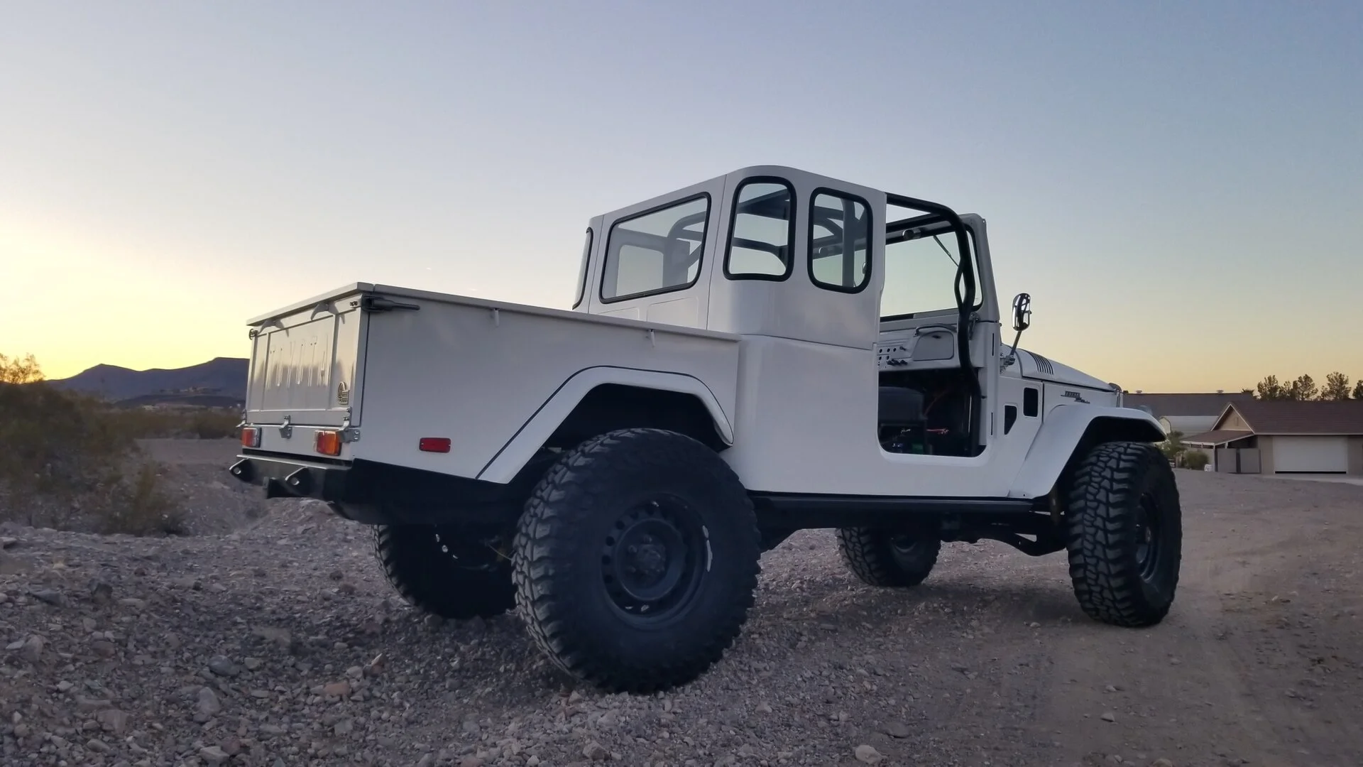

This thing is a blast to drive.... it looks like a 45, it drives like an 80, and has the power and sound of a 200. What more could you want?
Still a lot to do on it. The biggest things on the checklist -
Fiberglass top
AC / heater
Dash controls and levers
Longer bump stops
Seat belts
Today feels like a win though, so I'll take it and enjoy where its currently at.

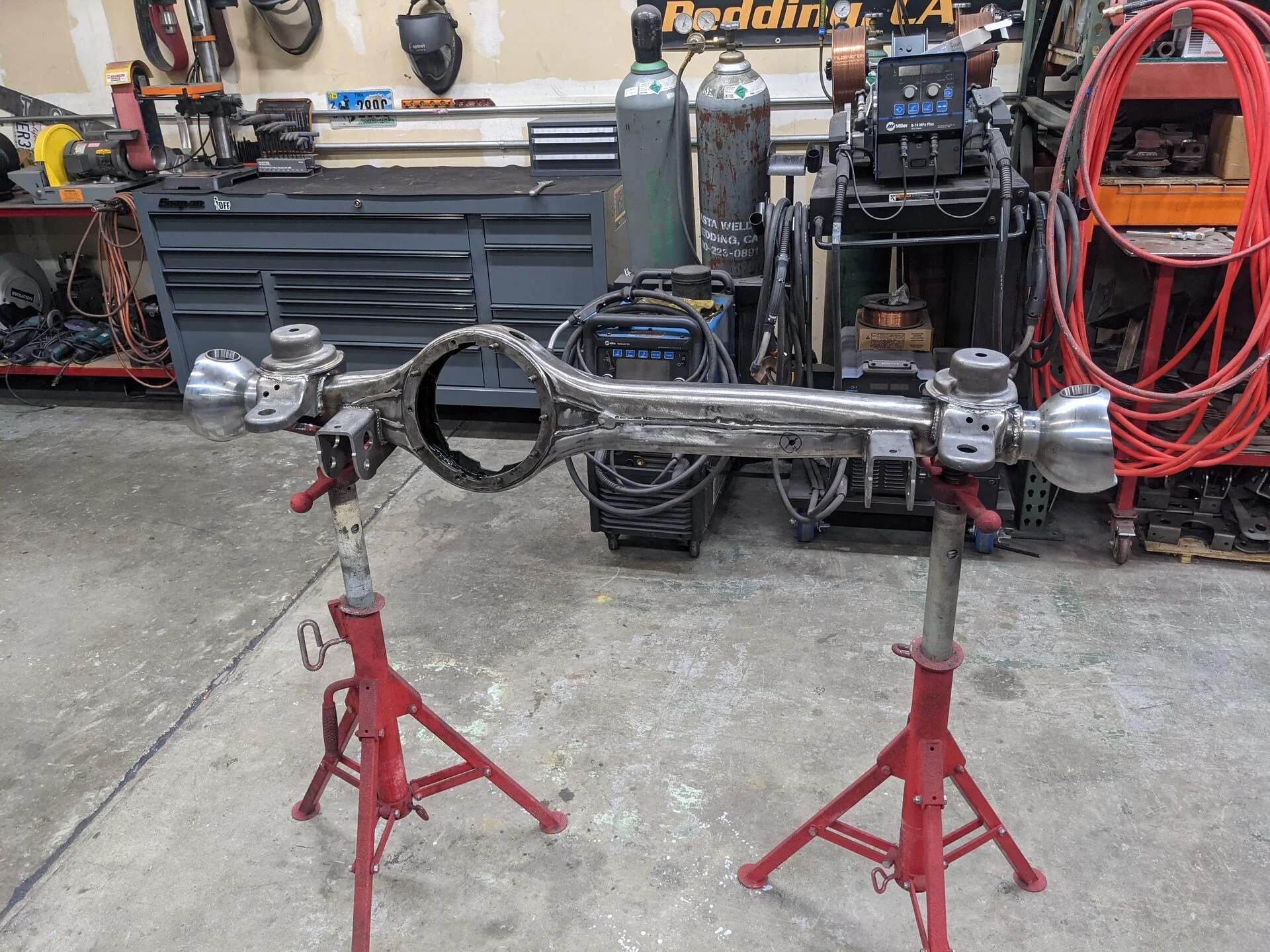

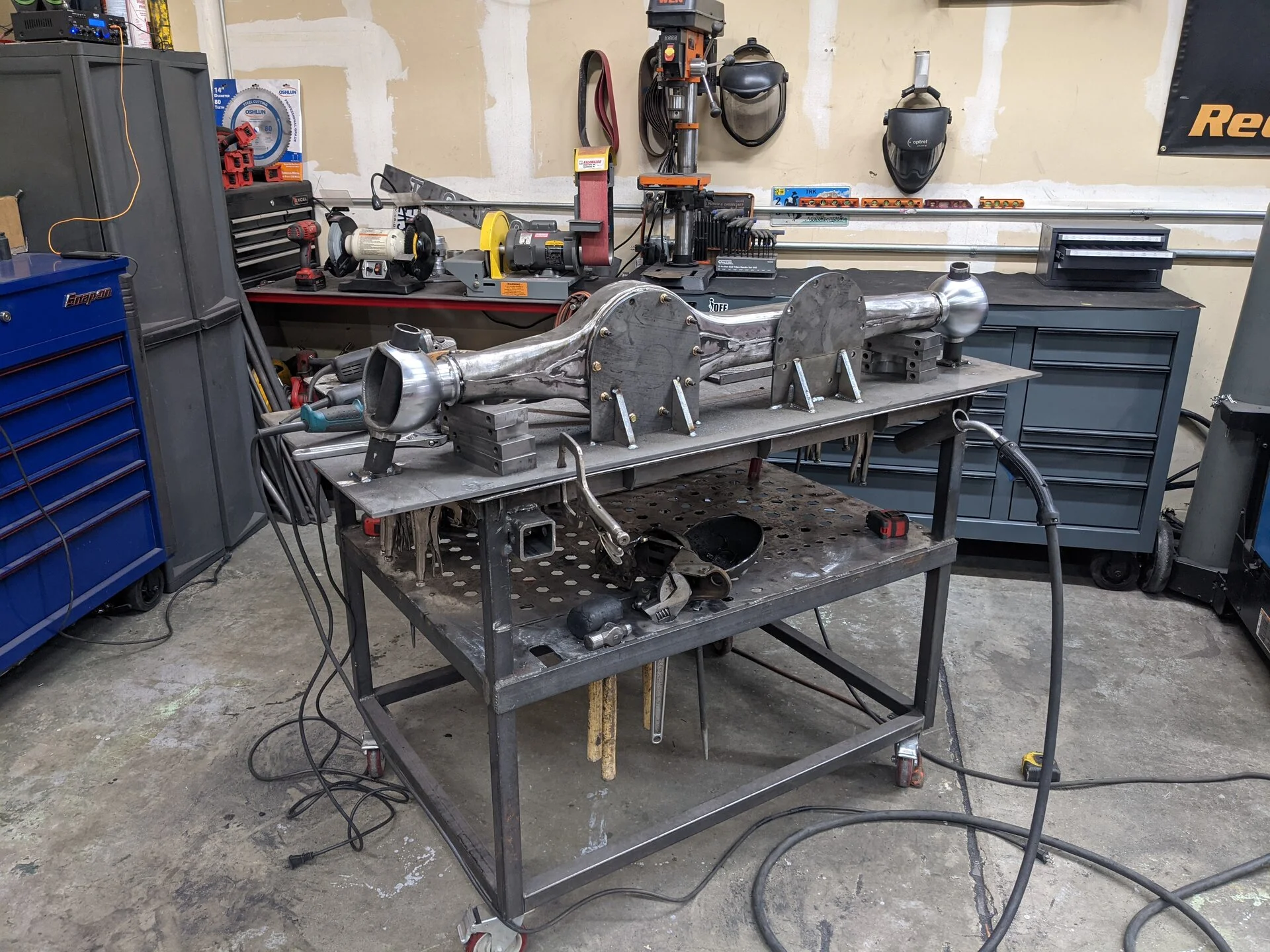

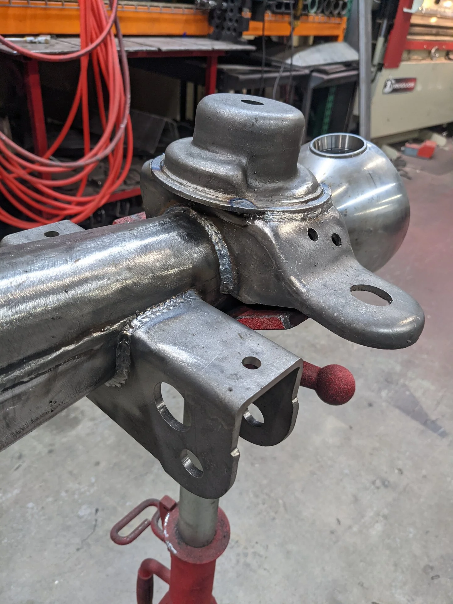

Nice job! I had thought about making a jig for the face of it like you did. Definitely a few ways to go about it.
Did you remake those mounts? They look really clean... its so hard to cut them off nicely!
Thanks,
Yes I have all the axle brackets in stock along with 4130 CrMo knuckle balls for the 80.

Cool. You're welcome to use the bushings for the 3rd member if you'd like, but it looks like your jig places it for you.
What build is that for? What drivetrain?
Complete 2021 tundra drivetrain in a 60.
