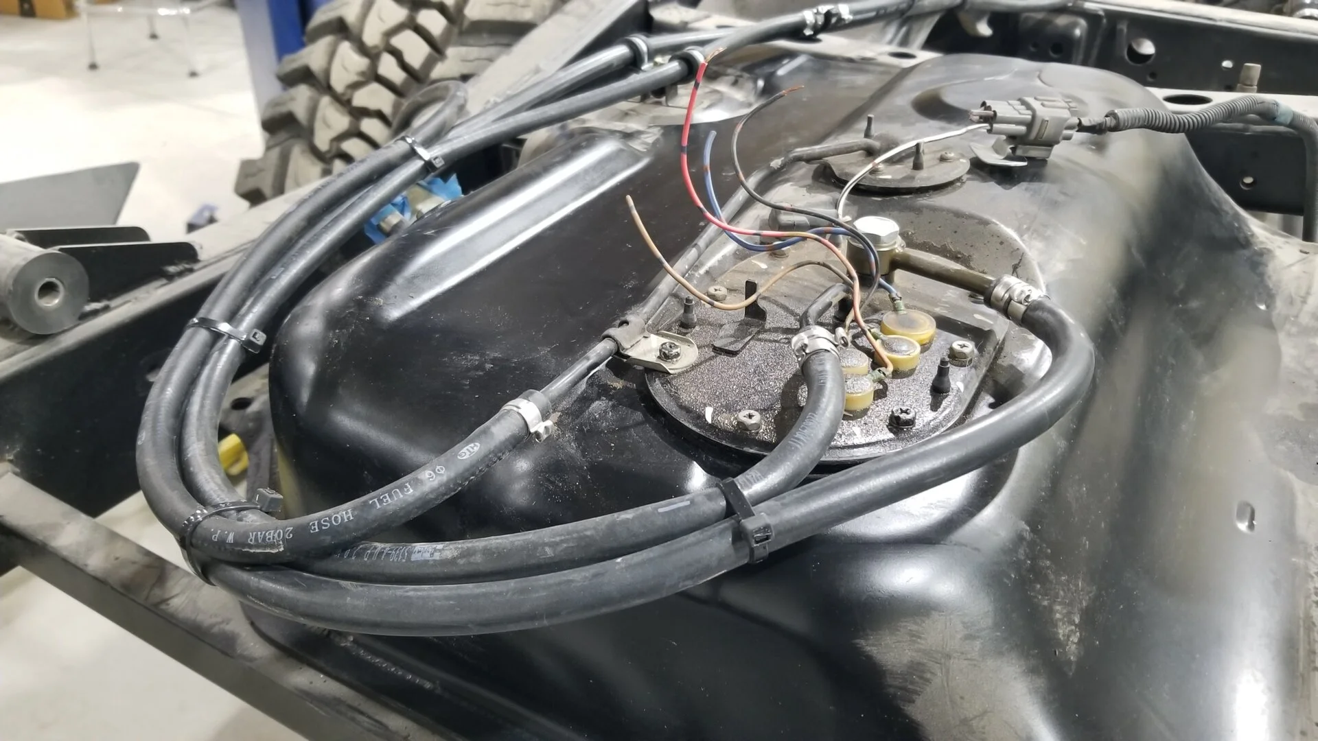

All fuel lines plumbed from the tank -

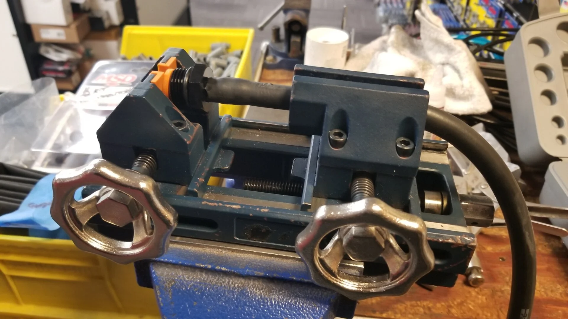

Used this cool little vice for the push-lock fittings. It really does make it much easier -

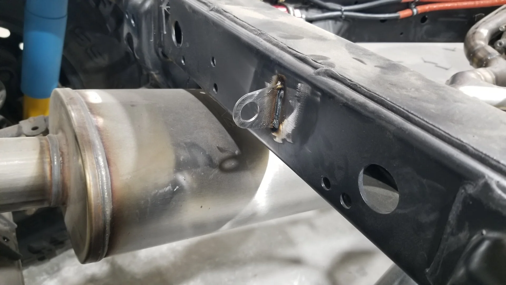

Making brake lines tabs -

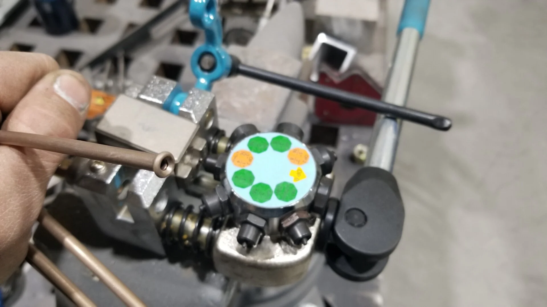

Brake line flaring tool is a life saver -

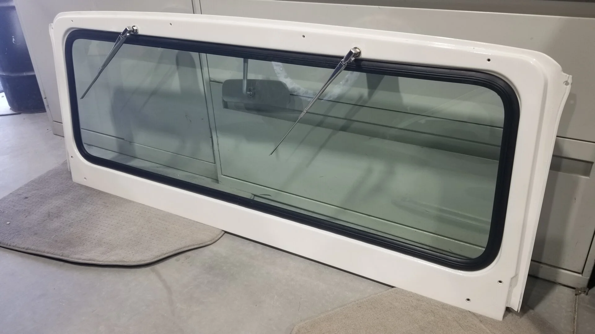

Dropped my hard top and windshield frame off at the local glass and tint shop. They knocked it out of the park!
New windshield cut and installed -

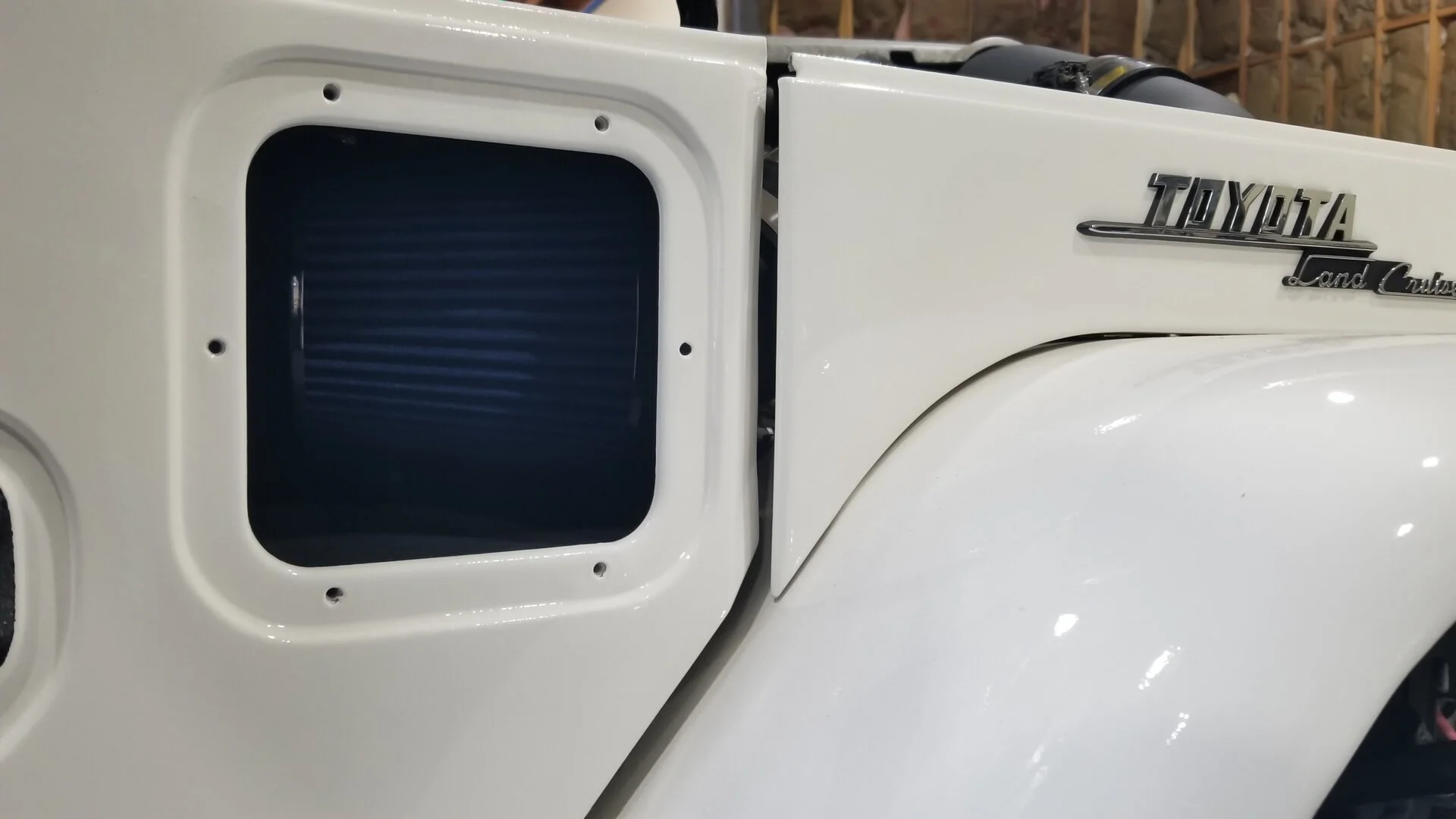

New side and rear glass cut, tinted, then installed. They also tinted and installed the corner glass -

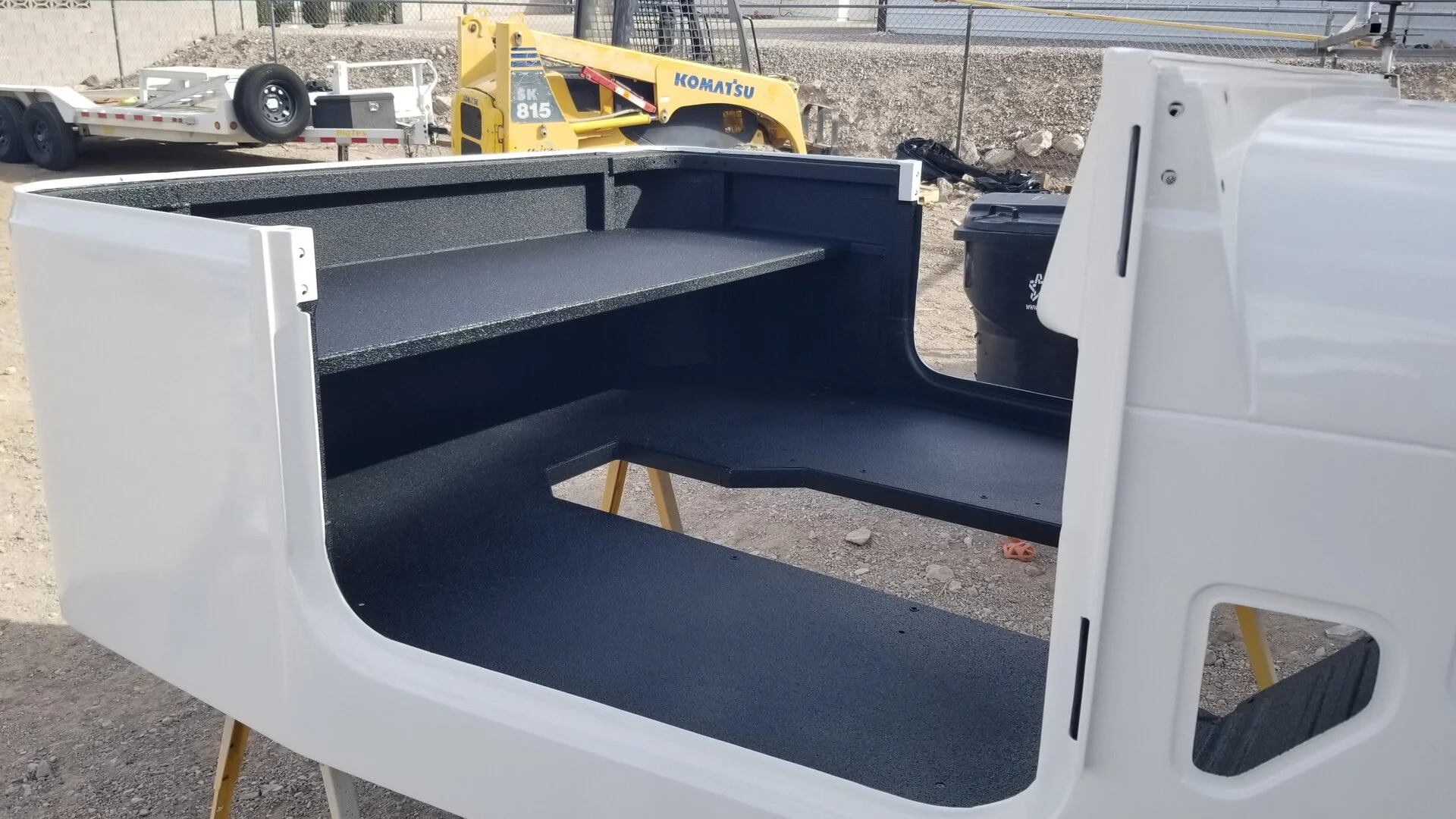

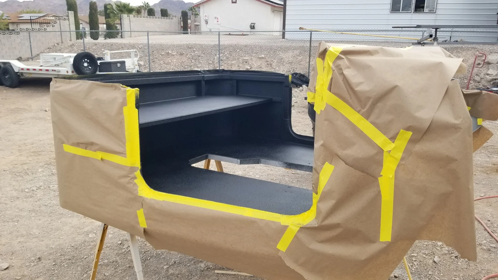

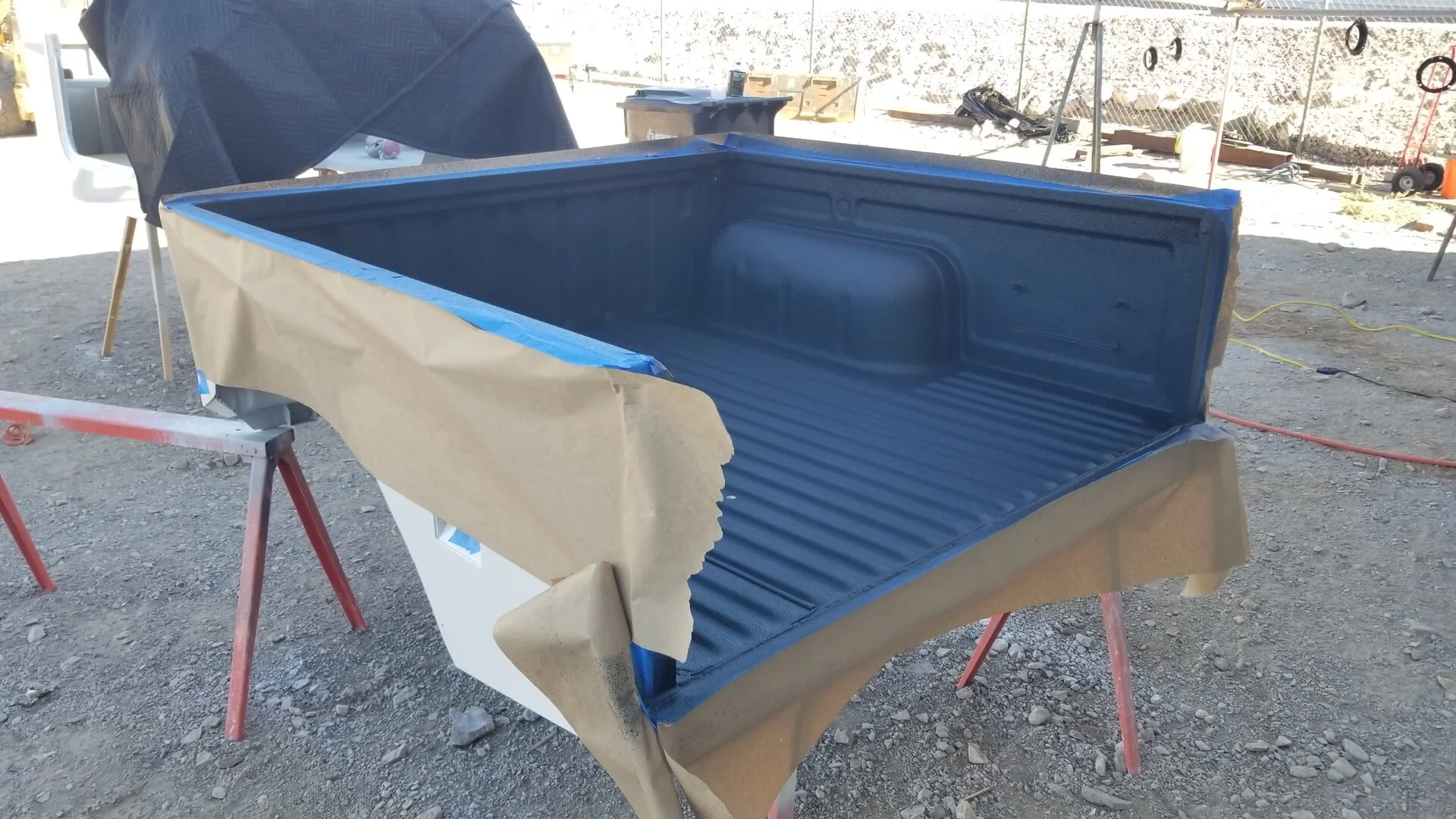

Raptor Liner in the bed and tub -
Using 80 series type weather stripping between the fender flares and bed -
Liner to go on the bottom of the tub and bottom of the bed tomorrow, then I can mount them on the frame for good!

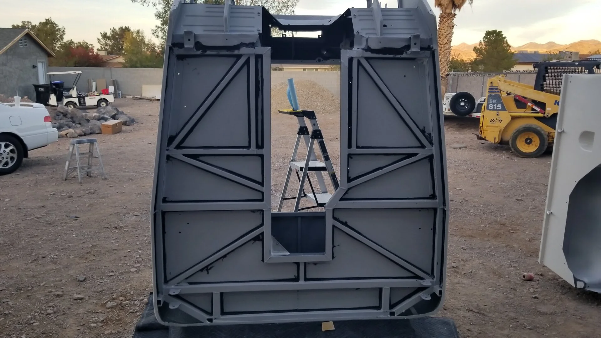

Bottom of the tub and bed was seam sealed and lined -
Fenders and tailgate also lined -

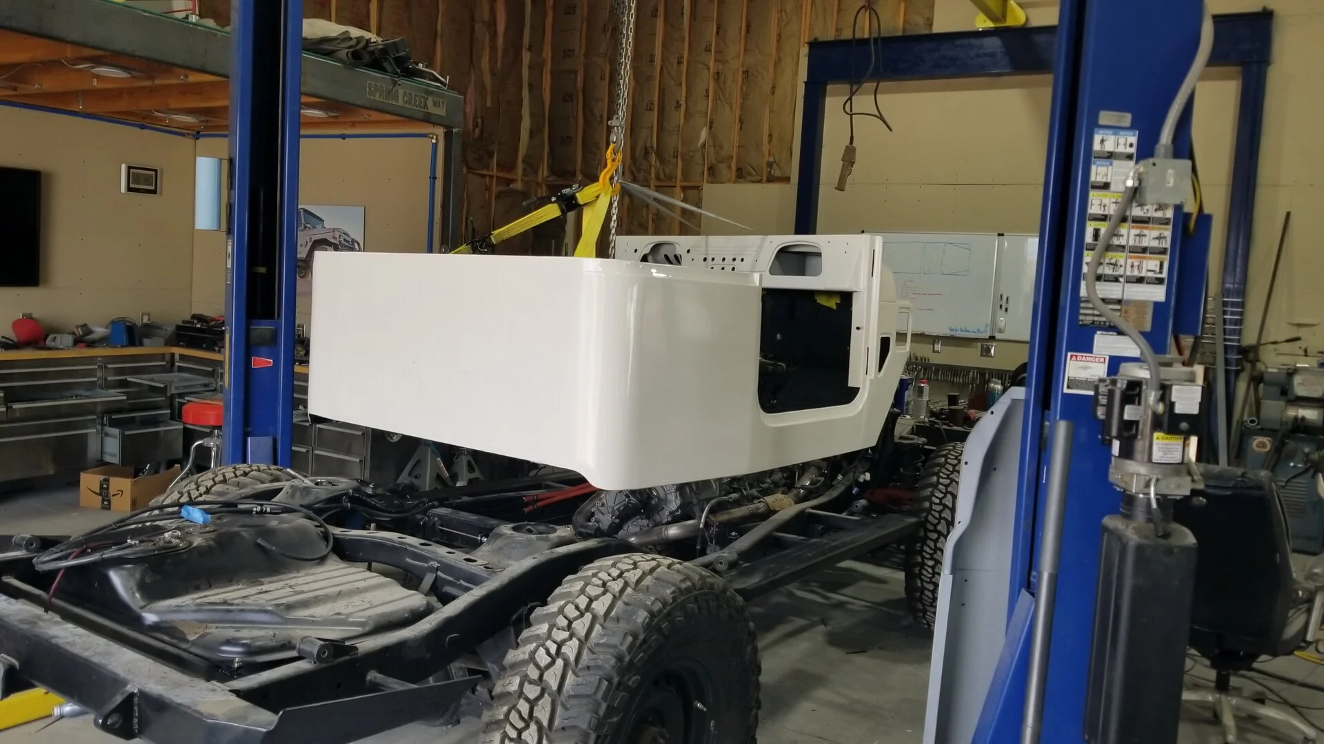

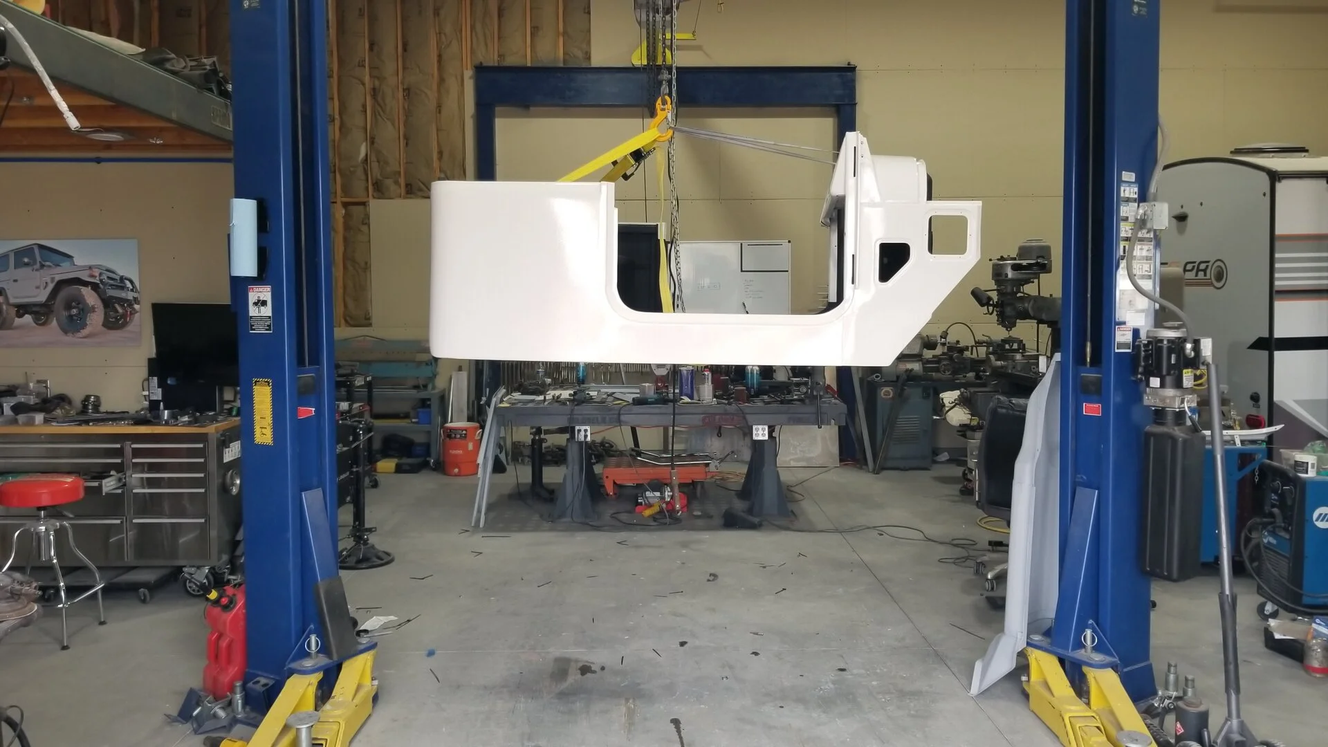

Tub finally moved back into the shop
Contact!

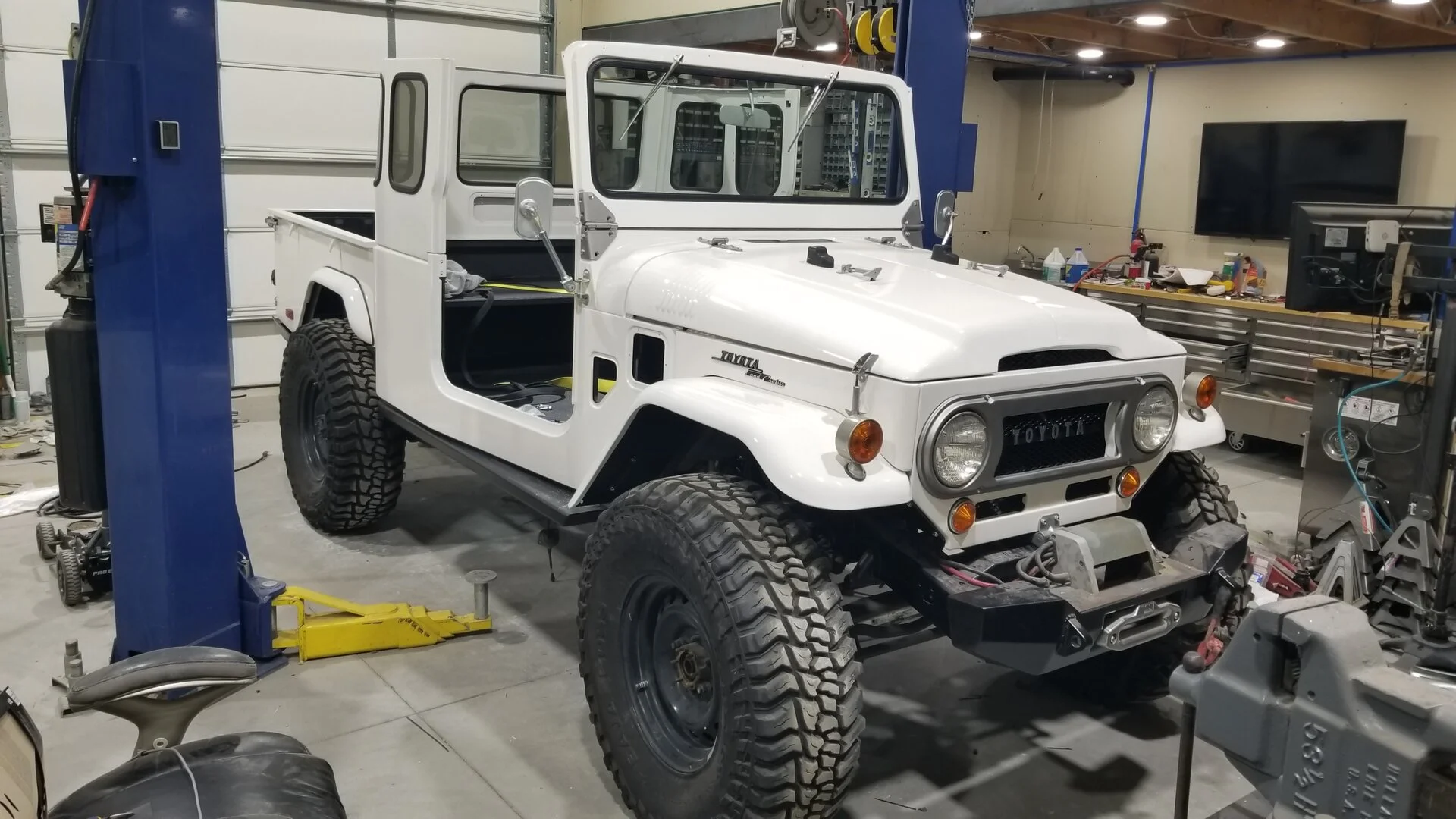

Time to bolt stuff on! Like legos for adults as @mtn biker and I talked about
And how it looks at the end of day 2 of assembly -
Tomorrow I'll get the roll cage in and start laying out some wiring and battery placement. Moving pretty fast now. Was going to try and have it running by next weekend, but forgot about the holiday!

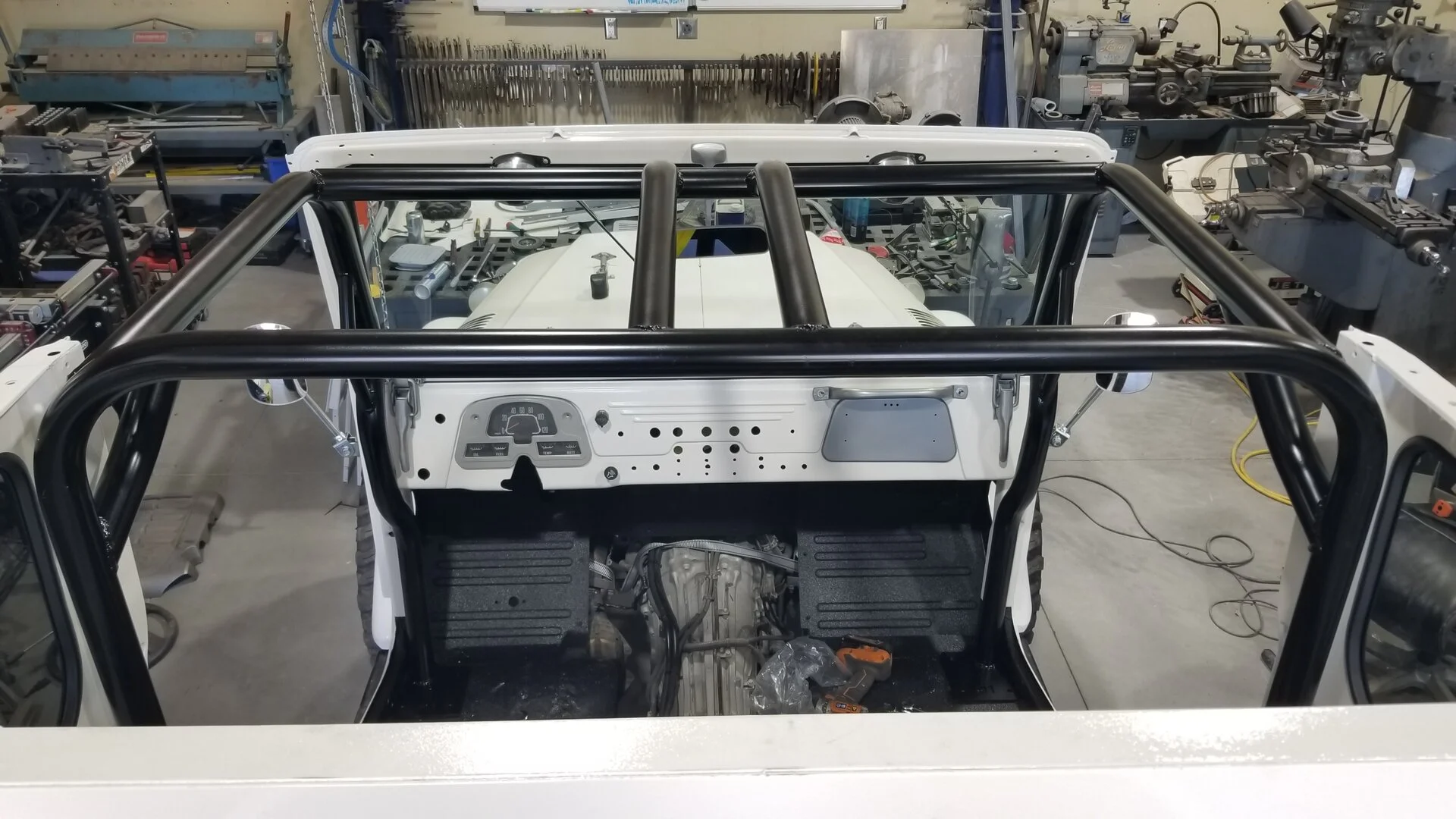

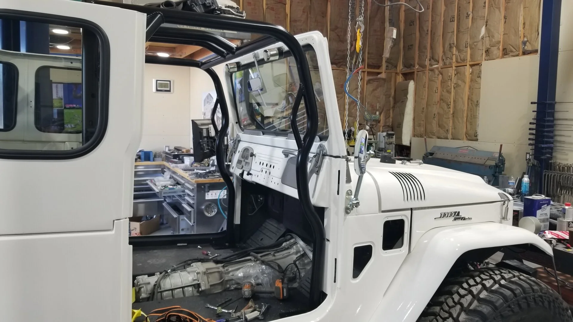

Got the roll cage in. I realized I never test fit the cage with the wiper motors in. My heart sank when I figured out how close they might be, but there ended up being plenty of room -

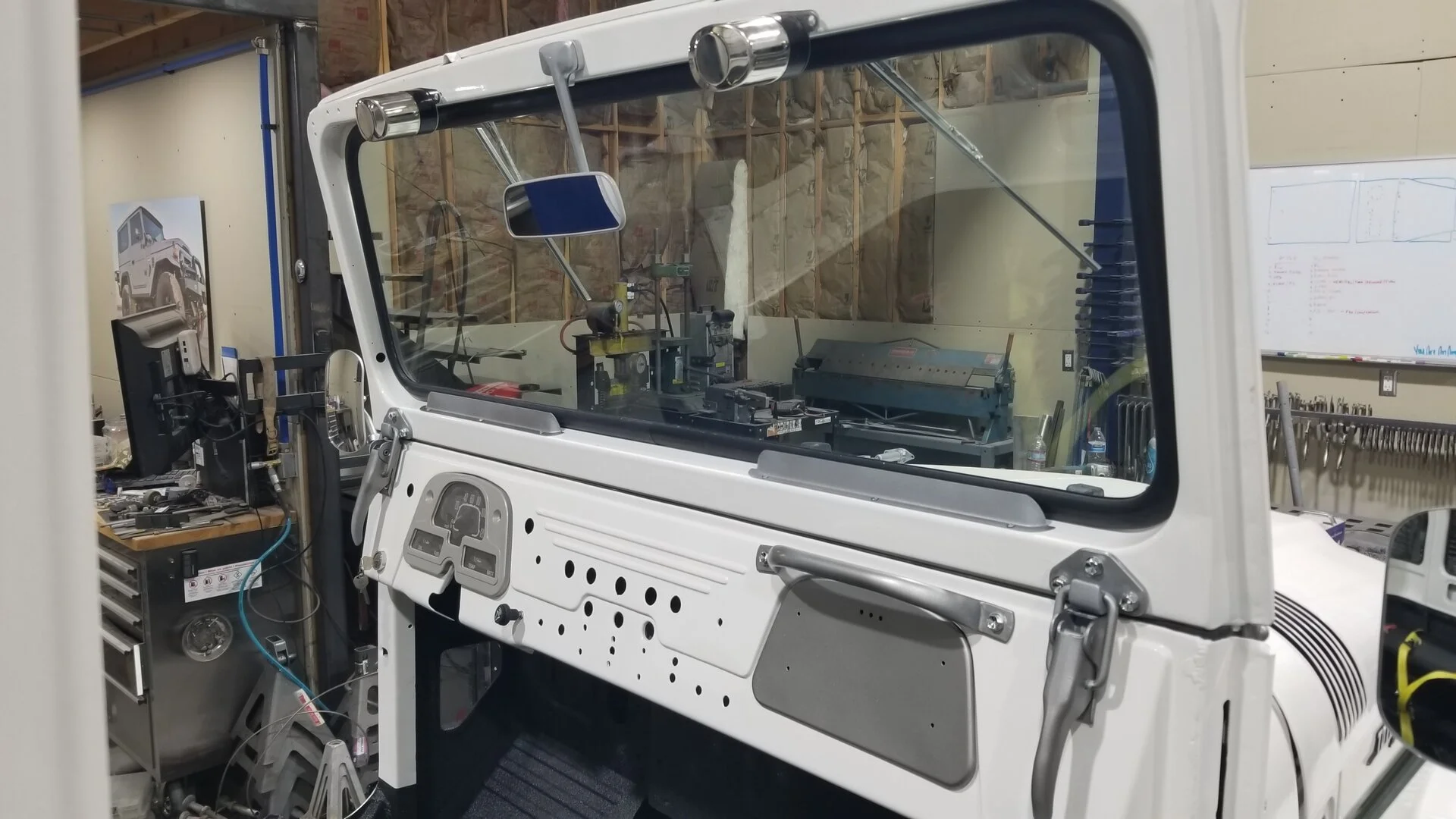

Blinker stalk, shifter, and many other dash pieces going in -

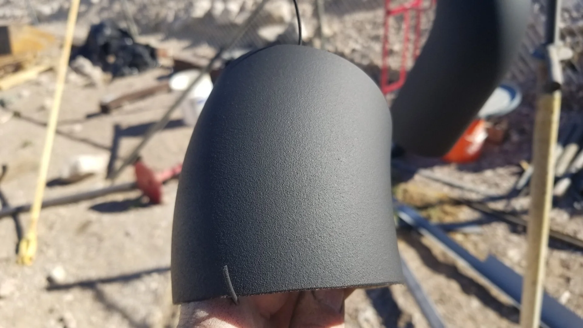

For anyone looking for a factory-type plastic finish, this SEM aerosol is awesome. It's a little spendy but the result is worth it.

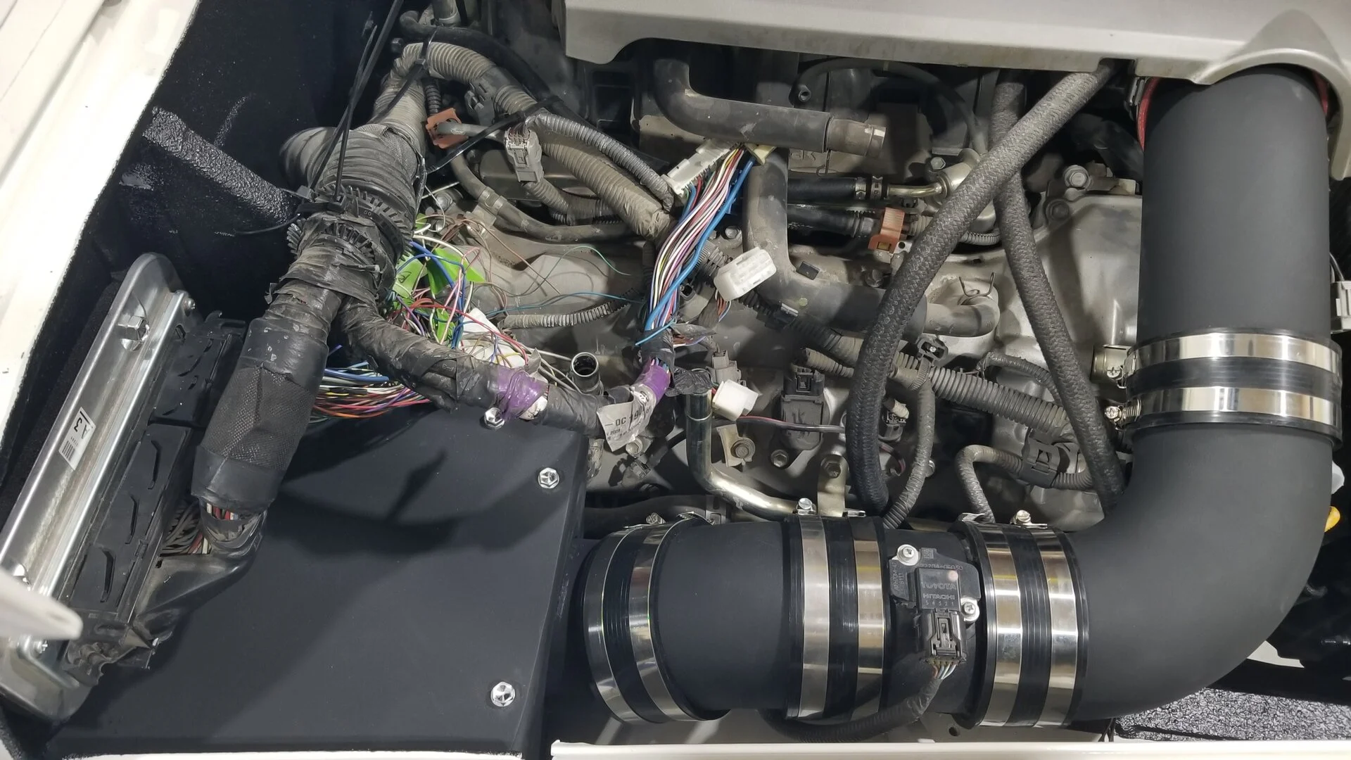

The intake tubes were polished aluminum. This is the end result -
Filter is tucked in nicely and should only have cool air coming in -

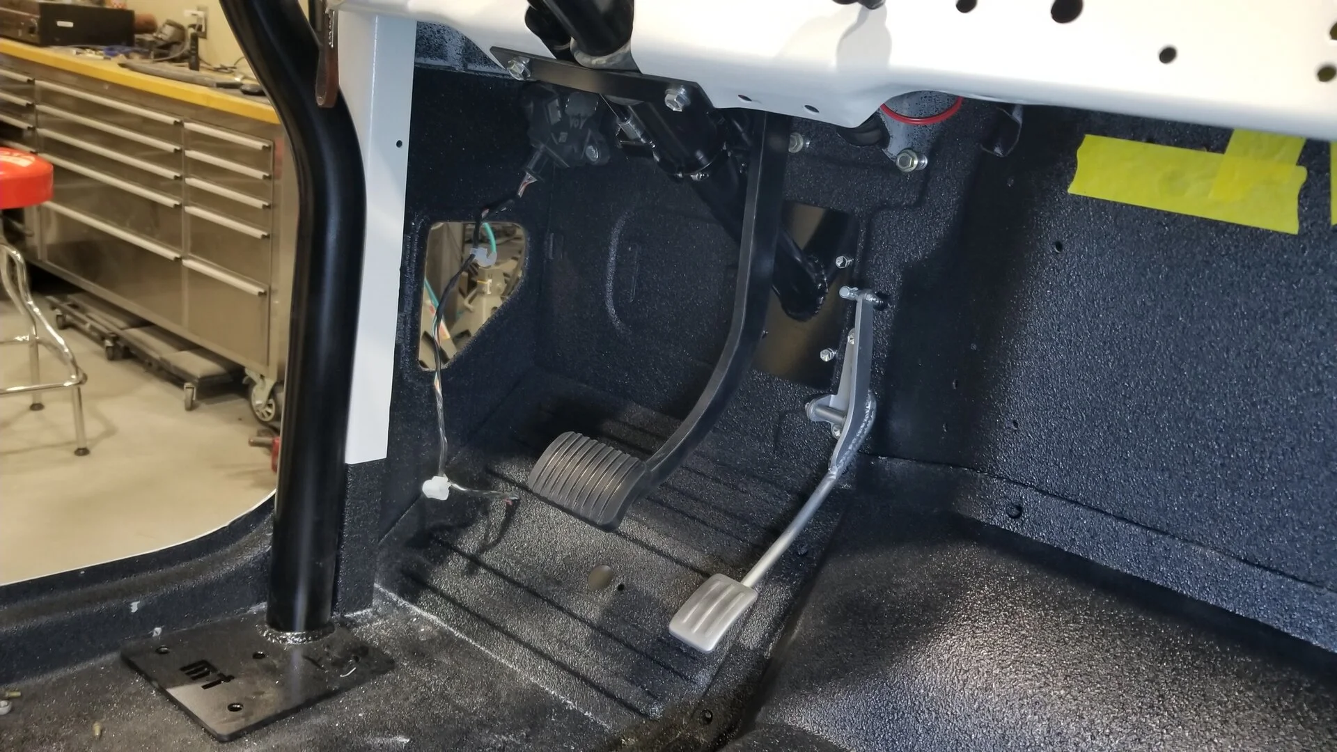

Both pedals in -

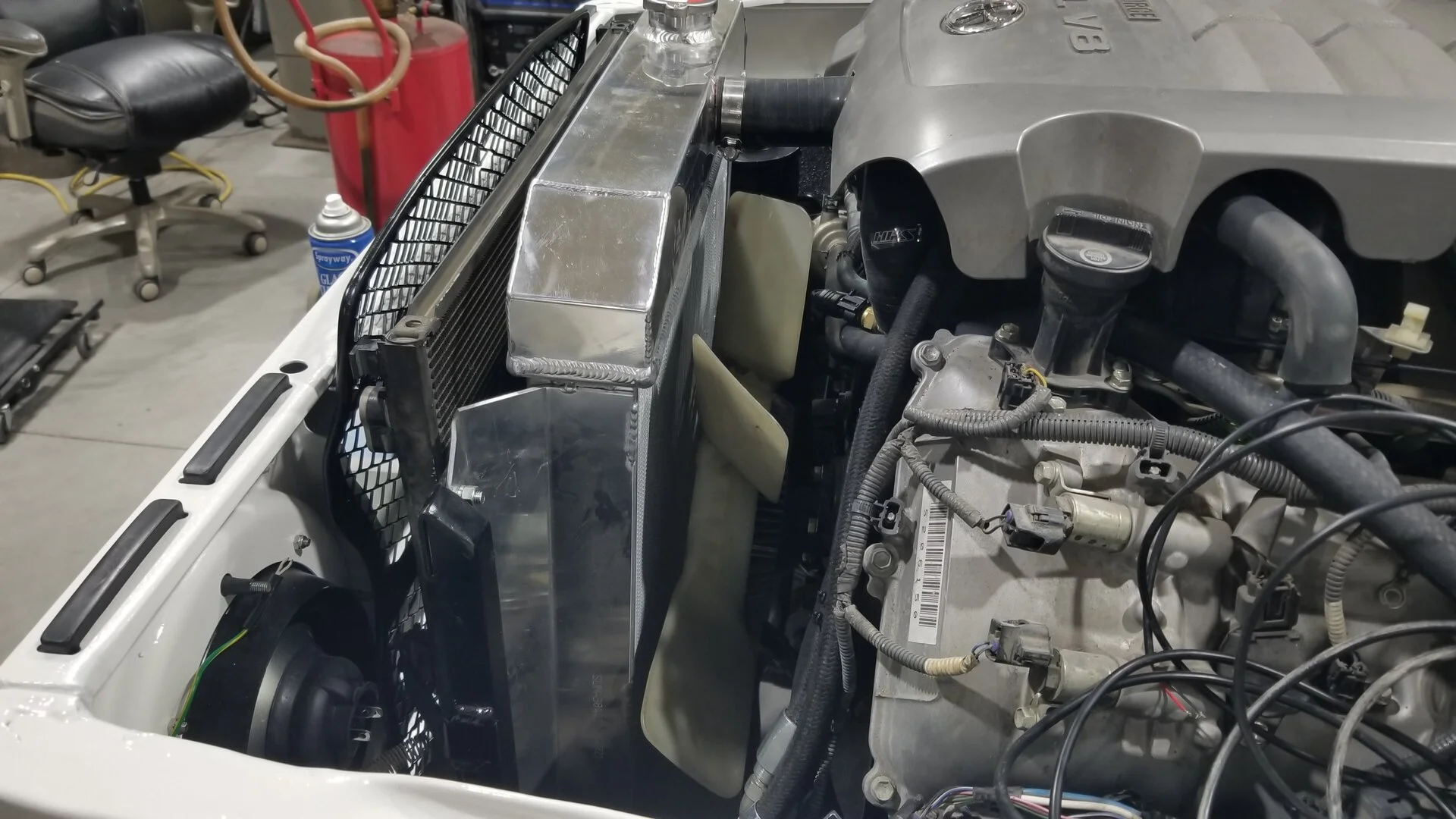

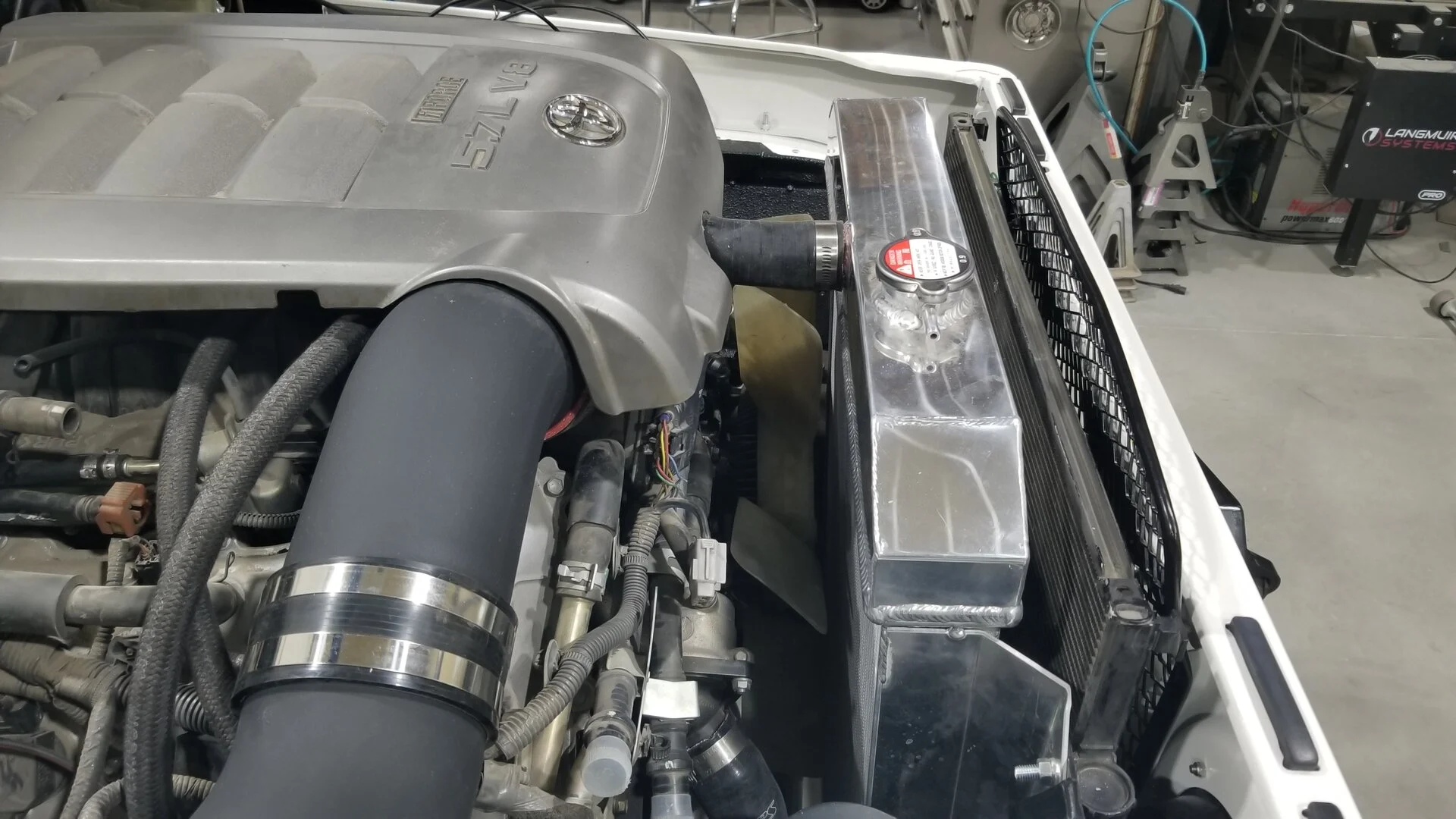

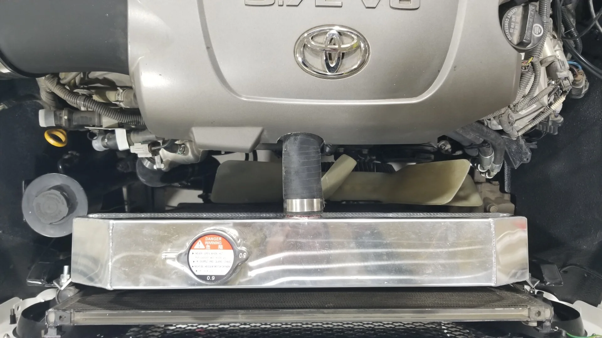

Power steering reservoir in, and just finishing up radiator hoses -
Awesome work!
Hard to tell in the picture angle, are you able to squeeze in the mechanical fan?
Thank you
Yes, the mechanical fan is in there with the oem fan clutch. After trying electric fans with the 4.7 and eventually moving everything around the change to the mechanical fan, no way I was going through that again.
In my opinion, there's no replacement for a mechanical fan with a V8 swap... Especially while running AC. I realize there are a lot of V8 swaps in general with electric fans, but in a 40, the front is so narrow and it really limits the size of the radiator you can run.
Awesome work!
Here are a few pictures (pre shroud) -
That will be fun when you have to change the timing belt.

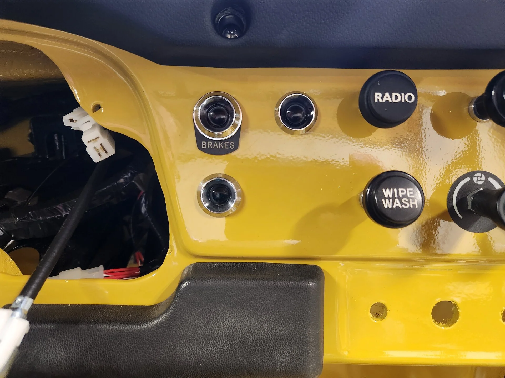

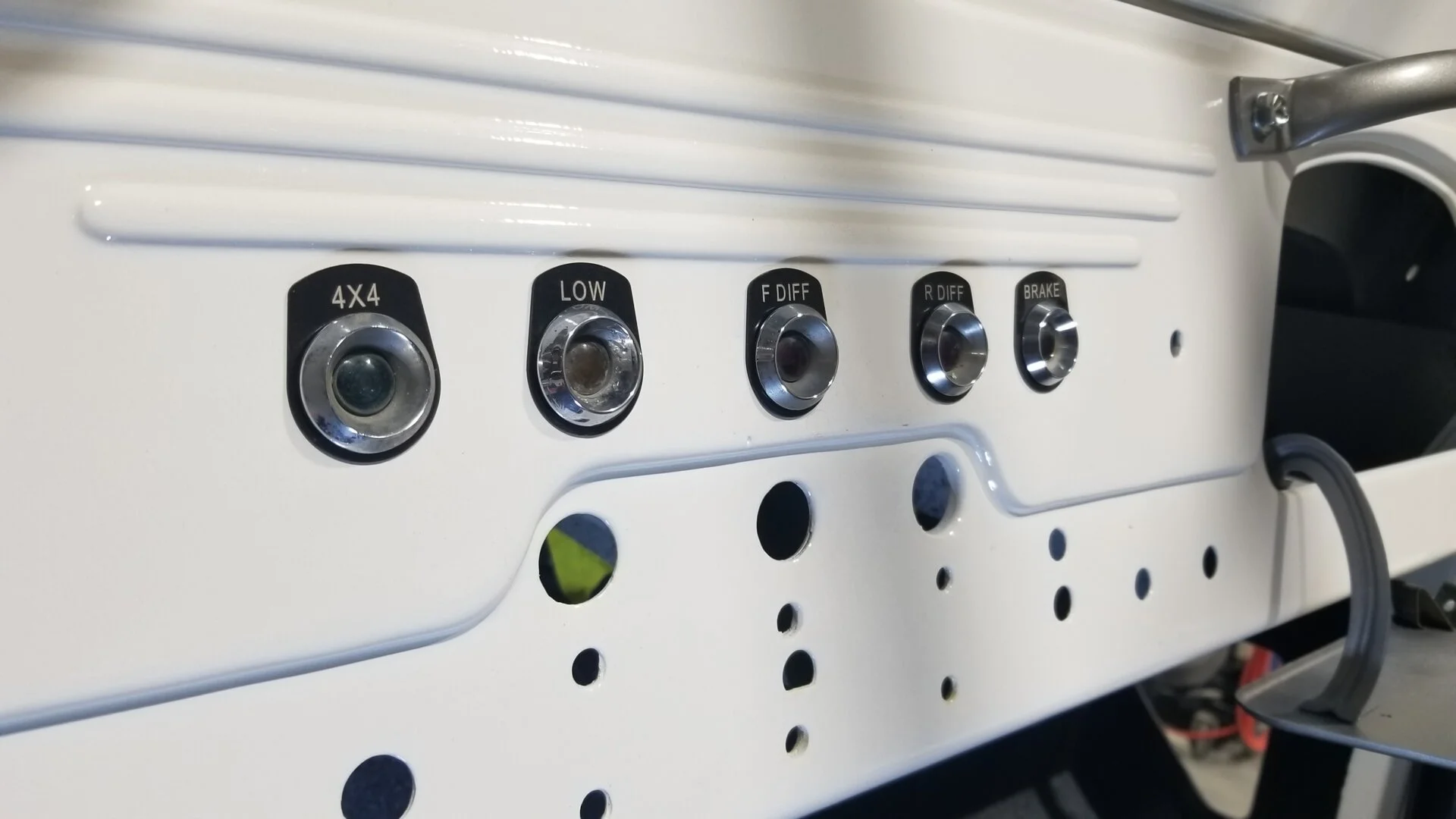

Where did you get your 4WD light tag?
4WD Below brakes and to right of brakes need seatbelt too
