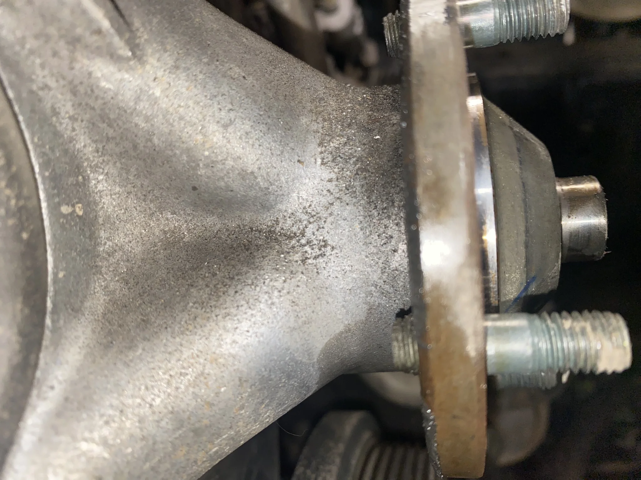

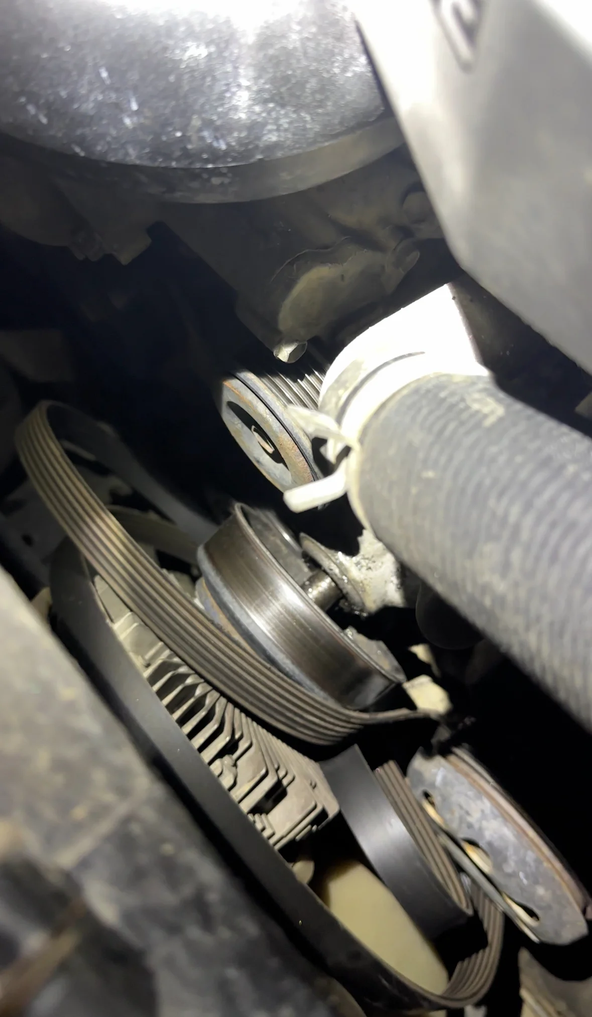

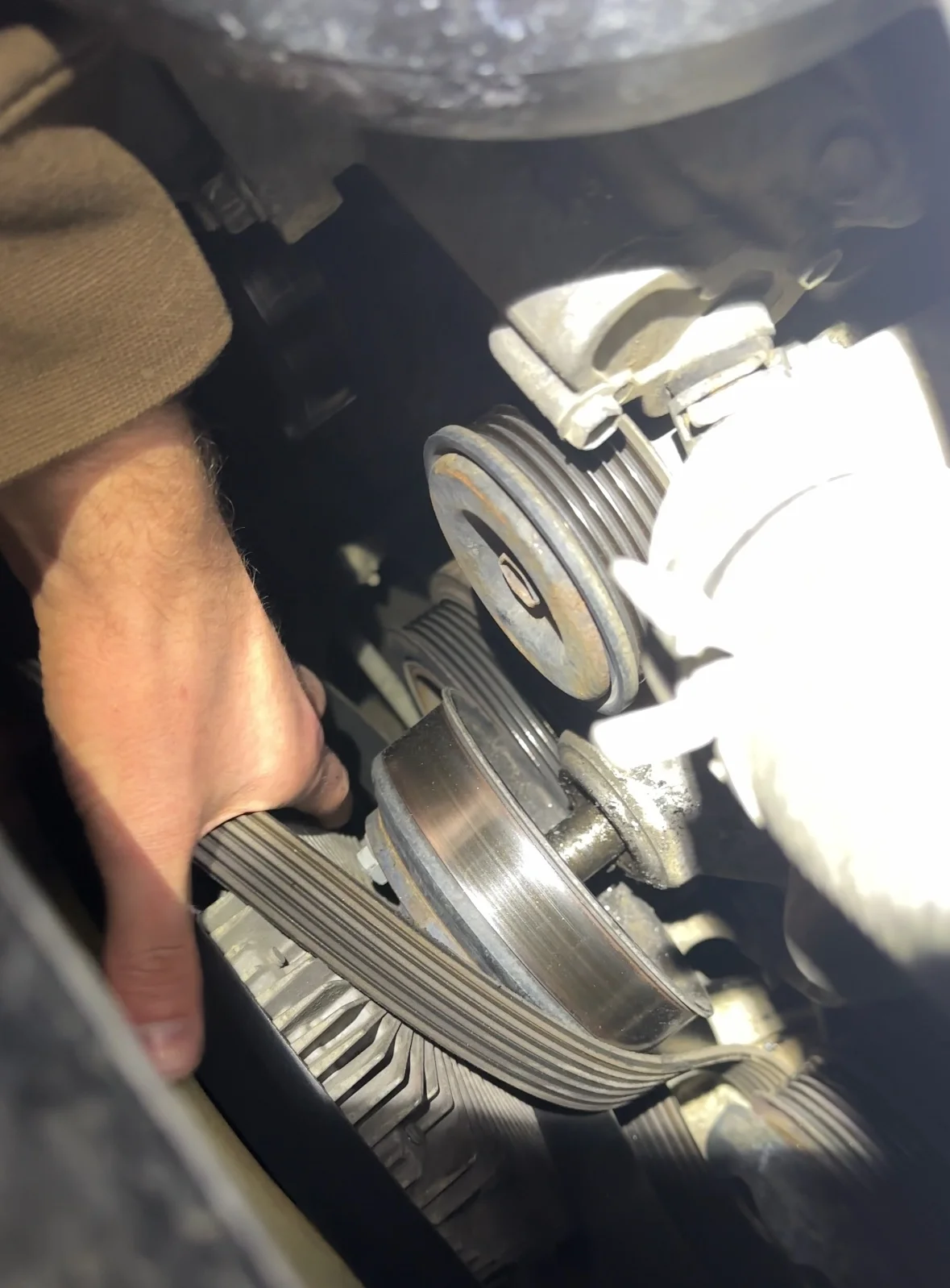

After a 600 mile roadtrip to Montana, I heard a clunk and I lost my power steering and my battery light turned on. Of course this has to do with my serpentine belt so I figured it just snapped. The car never overheated likely because its January in Montana so I limped it back the final two miles to my destination and then popped the hood. I then looked in to see that my fan was dangling in the engine bay with the serpentine belt completely loose at the front of the engine. From what it looks like the shaft of my water pump completely snapped and now I'm wondering which parts I need to purchase to get this done other than the obvious water pump assembly. I'm currently thinking of purchasing this water pump kit but am very open to suggestions. I also will buy this t-stat and have read some of the suggestions made in previous posts like radiators which has already been replaced. I also want to replace the serpentine belt of course so I would like to know if anyone has any better choices than this.
What I'm most scared of right now is if the impeller section of the water pump could've fallen into the block or if that is totally not how that works because half of the reason I want to do this myself is to save money and the other half is to learn because I never had someone to teach me this stuff. Thank you so much for your time and kindness for helping me.
One reason it didn't overheat on your short trip is that your water pump is likely still fine. Did your radiator survive, or did the free-roaming engine fan take it out?
Water pump is spun by the timing belt so like steve said its probably fine. Although replacing the fan bracket is about as much work as replacing the water pump/timing belt so if you have some concerns there now would be a good time to address them

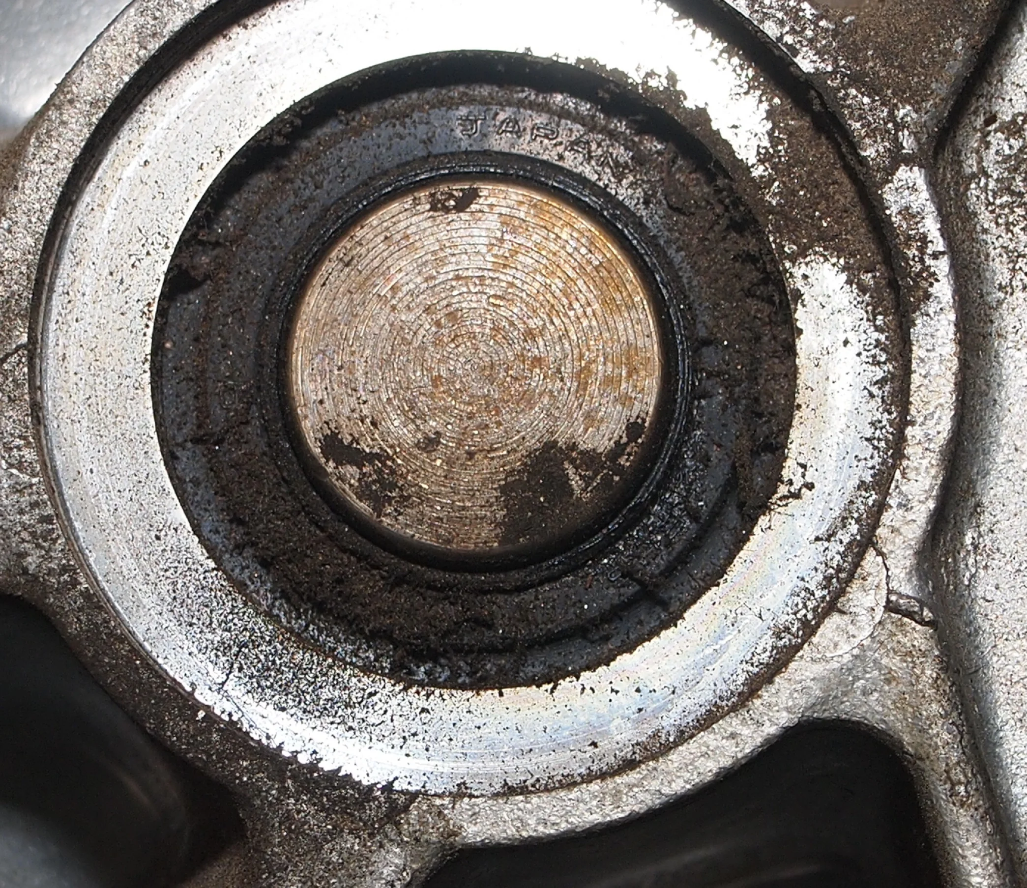

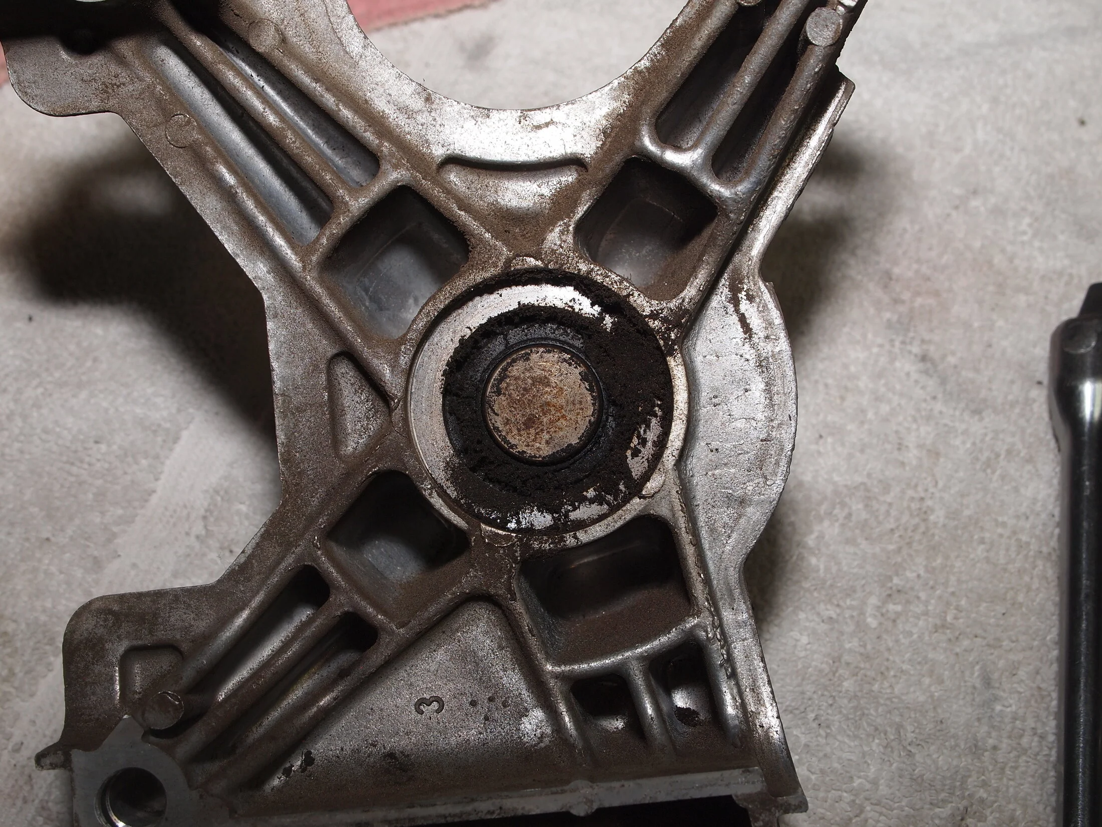

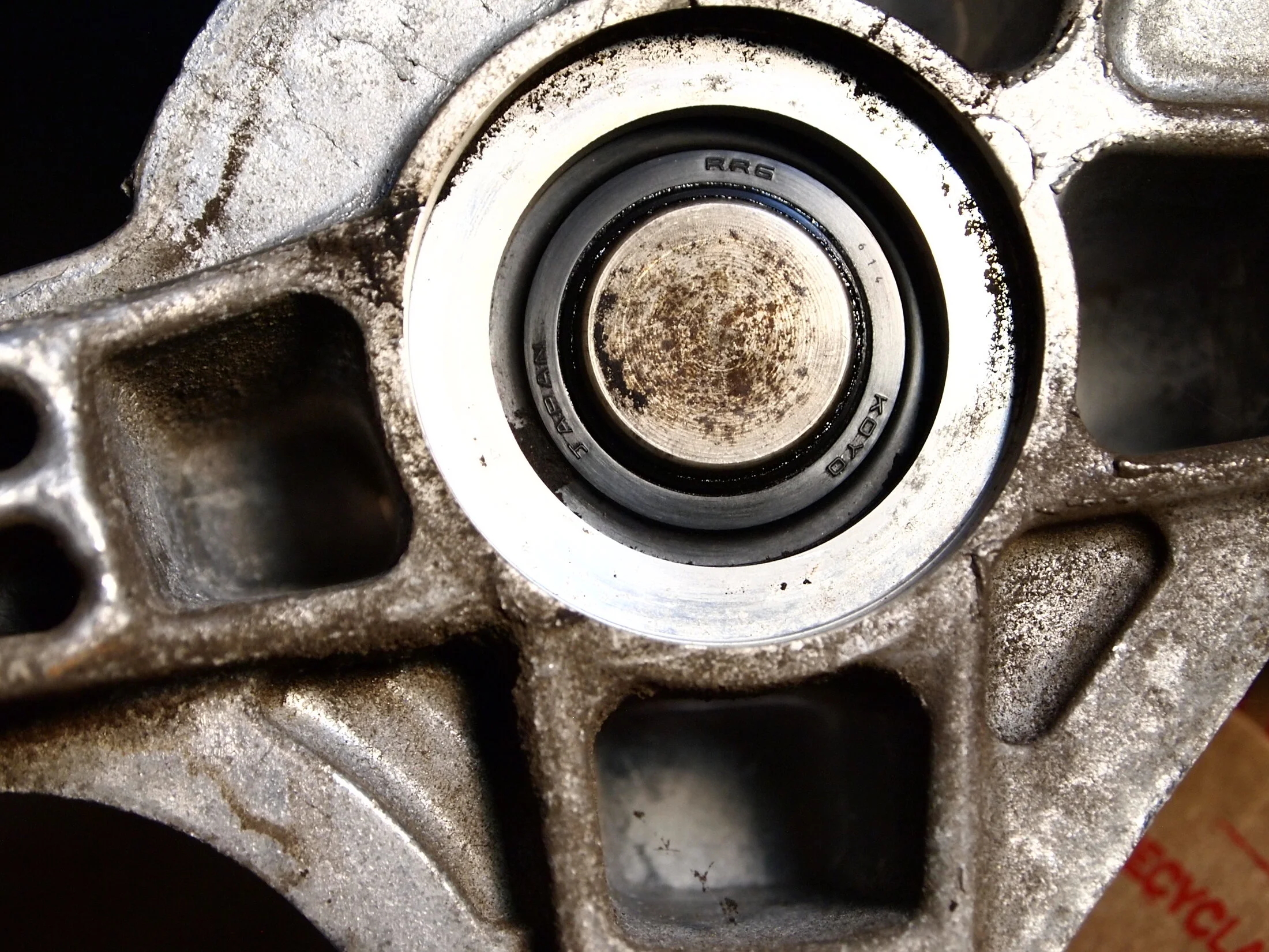

During Time belt service we remove fan bracket. There is one thing we can only inspect, when fan bracket is on the bench. That is the seal in the back. FSM states: Replace if any oil seen coming from seal. I'm overly cautious in grading. Any, and I mean any sign of oil on seal, I replace the Fan Bracket .
Dust sticking to oil on seal:
Even after lightly wiping grim away. Glistening of tracs of oil, can be seen on seal.
This one is hard to see. But what's there is oil coming out bearing on front side and metal fillings stuck to oil.

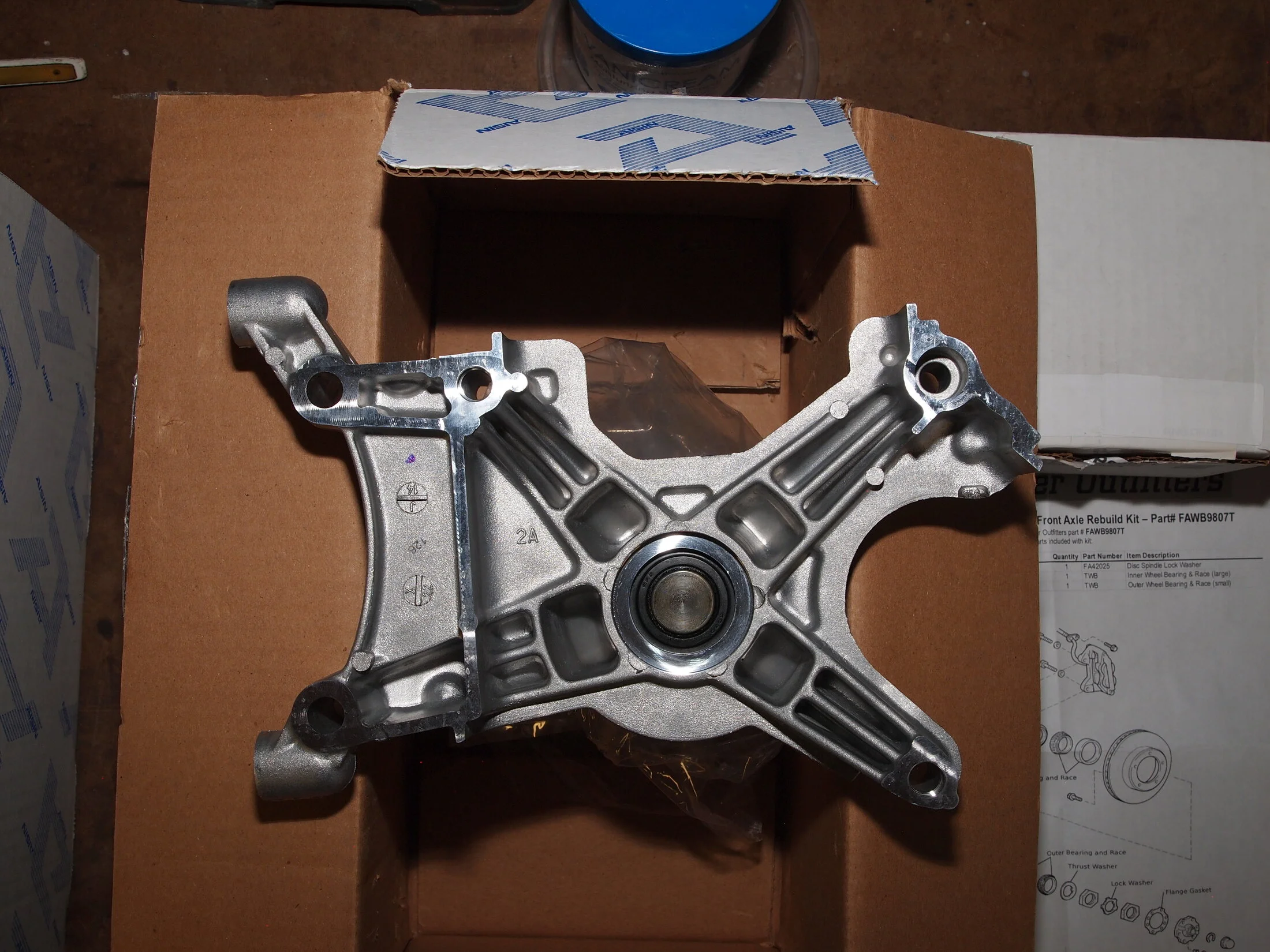

New

Here's a fan bracket bearing, that has failed. But caught before seizing. Driver notice sound and vibration.
