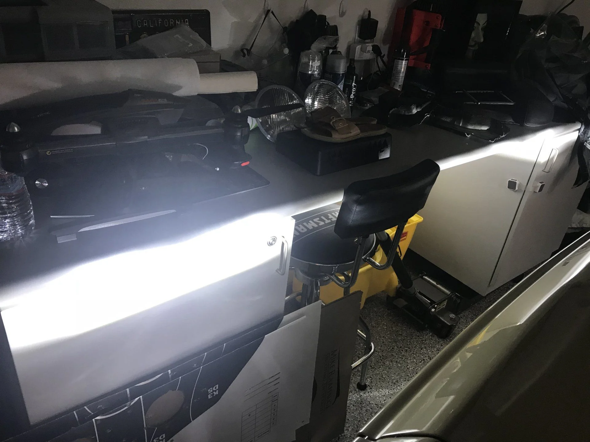

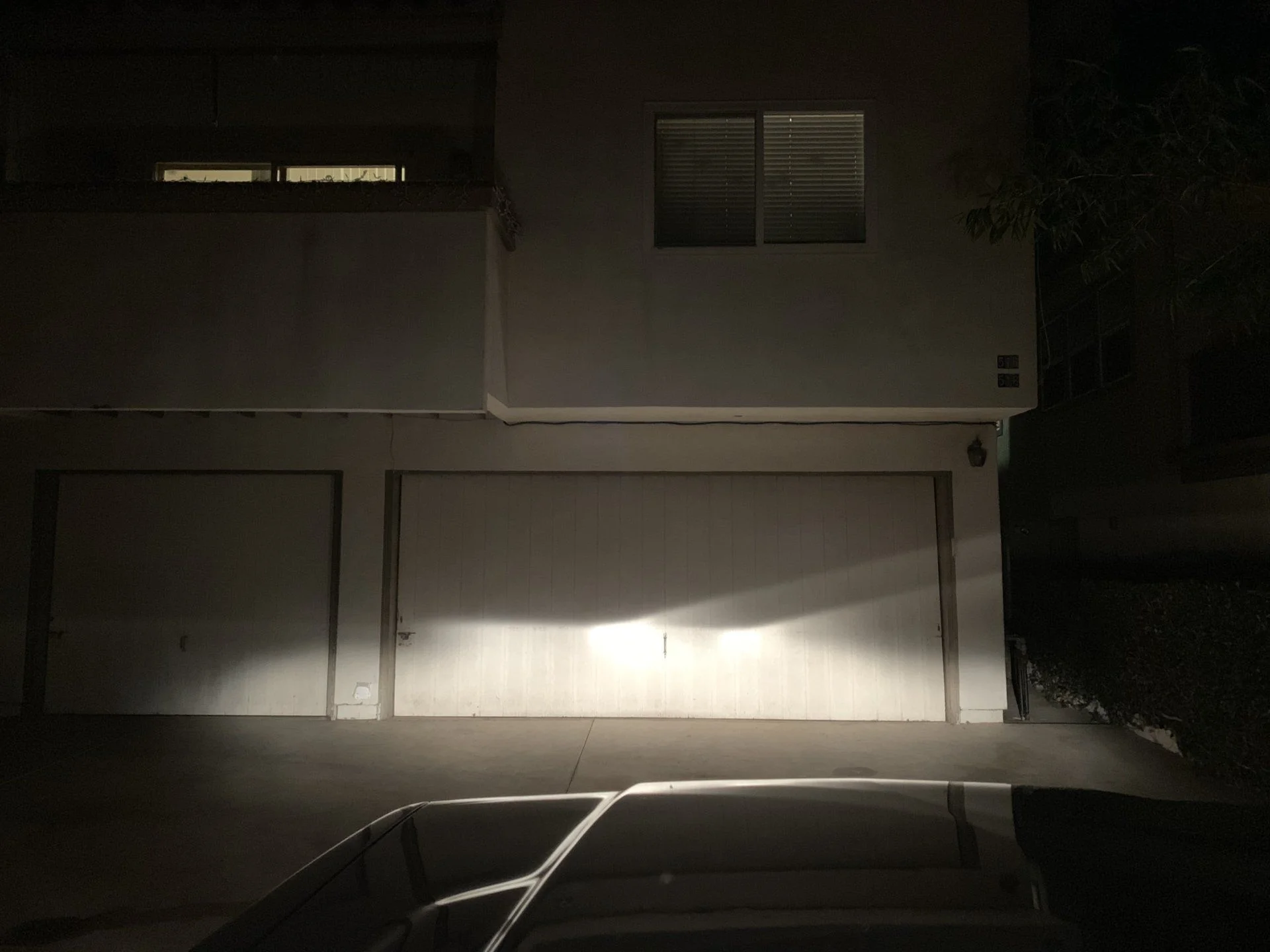

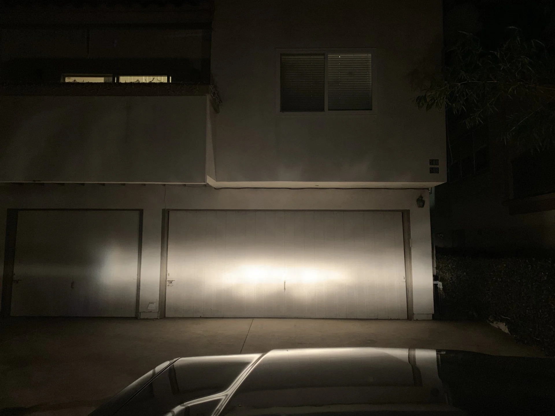

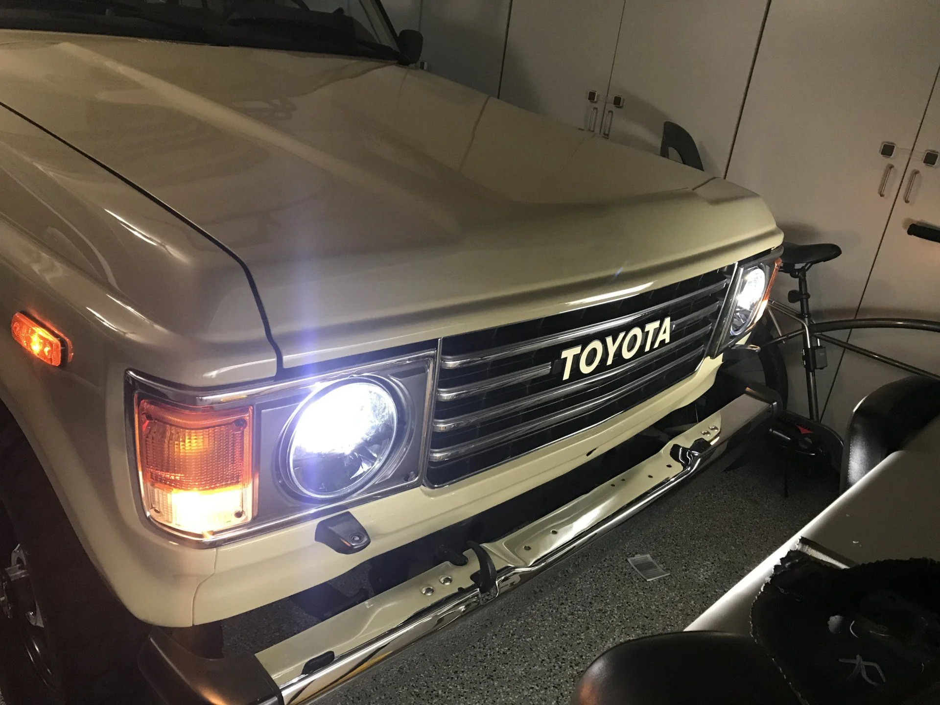

What you’ve all been waiting for.
Low beam and high beam for Koito H4 upgrade with relay harness installed.
Might unplug relay harness and plug stock wiring into lamp for comparison as well. I’m very content with the upgrade, especially for the price!

Nice!! You beat me to it. I just finished installing my Koitos and upgraded relay harness too. Love the results. I will post some pics when Im driving at night again. Worth the money spent on this! ;)

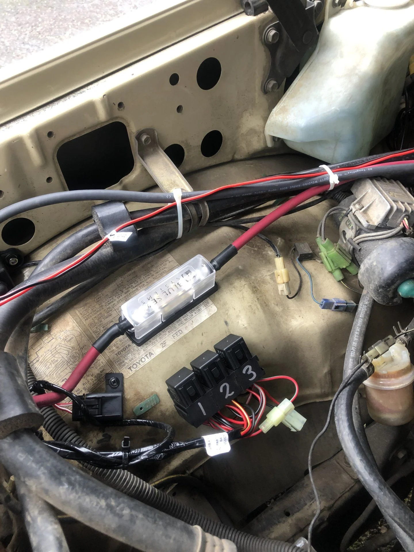

How’d you mount the fuses? I’m curious to see how you mapped the harness out. I can’t believe what Toyota/Koito provides for the price, it’s a great package.

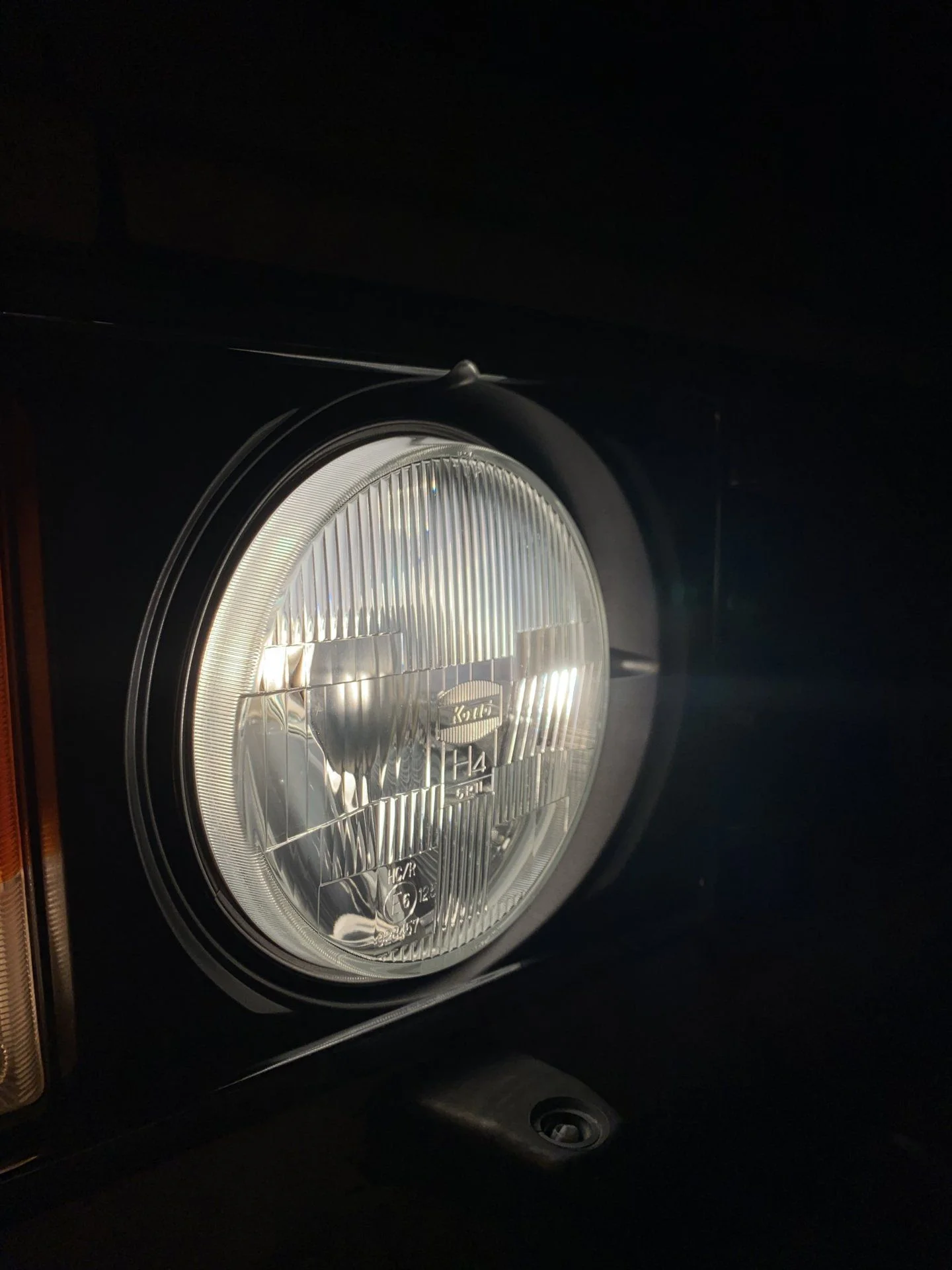

I’m having trouble getting the three tabs on the back of the city racer housing to line up with the mounting “cup”. I’ve tried crimping them open a little more but I can’t seem to get the new housing to sit flush with the mounting bracket. Did you have any issues with this?
I actually had to file a bit of material off of the 3 tabs on the headlight housing to get mine to seat flush. Didn’t take much.
How do they look in the road? We know you can see your garage door now ;)

I ran mine like this. Running out of space though for my ejecteical
