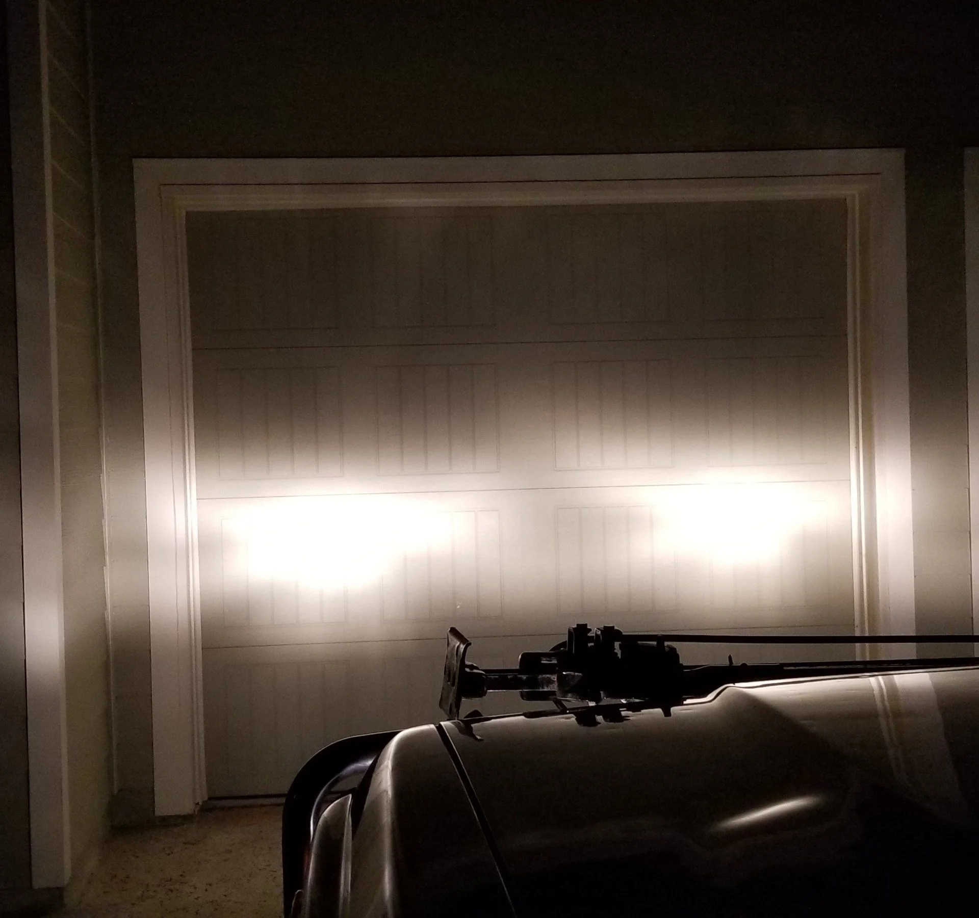

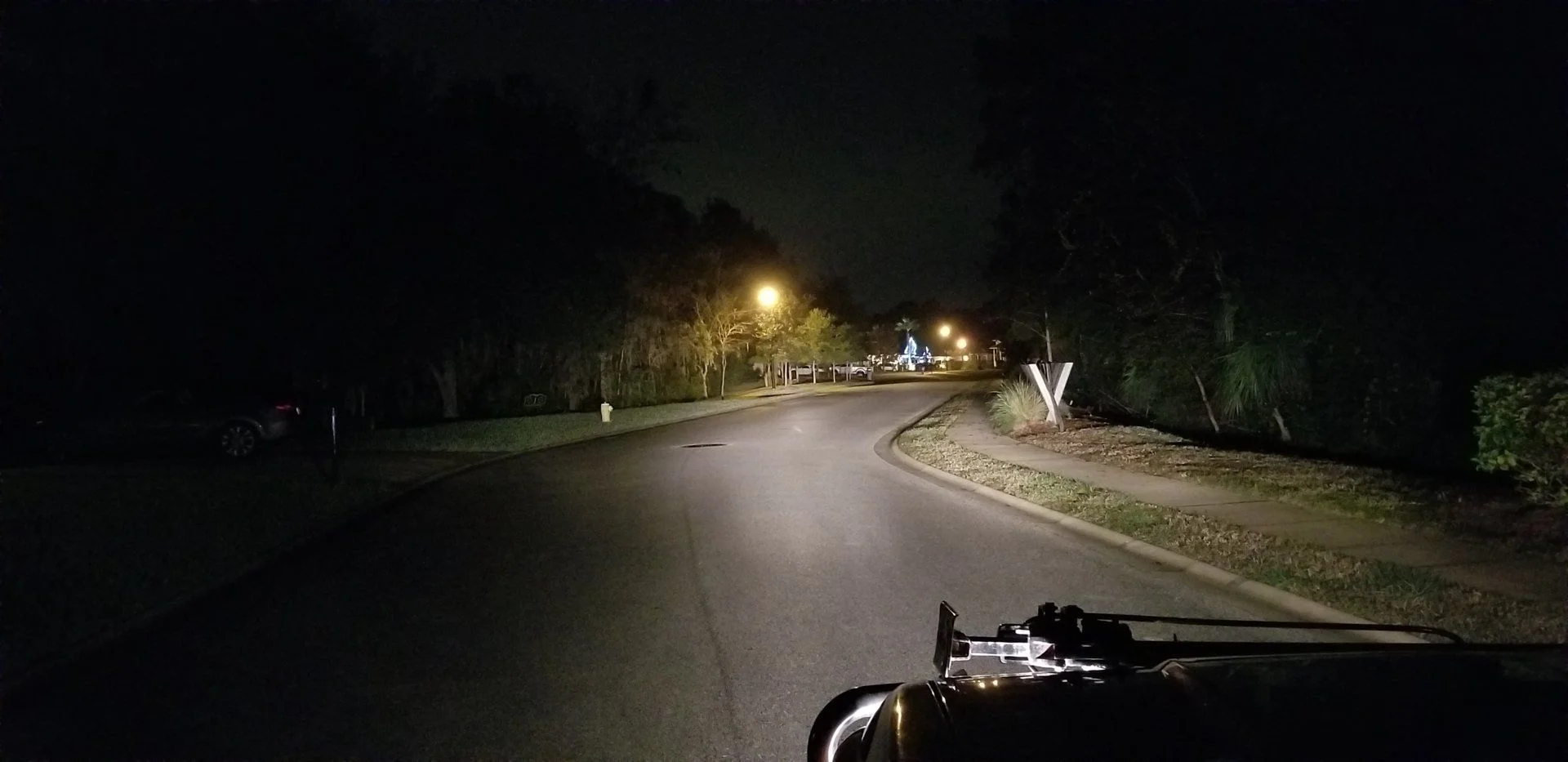

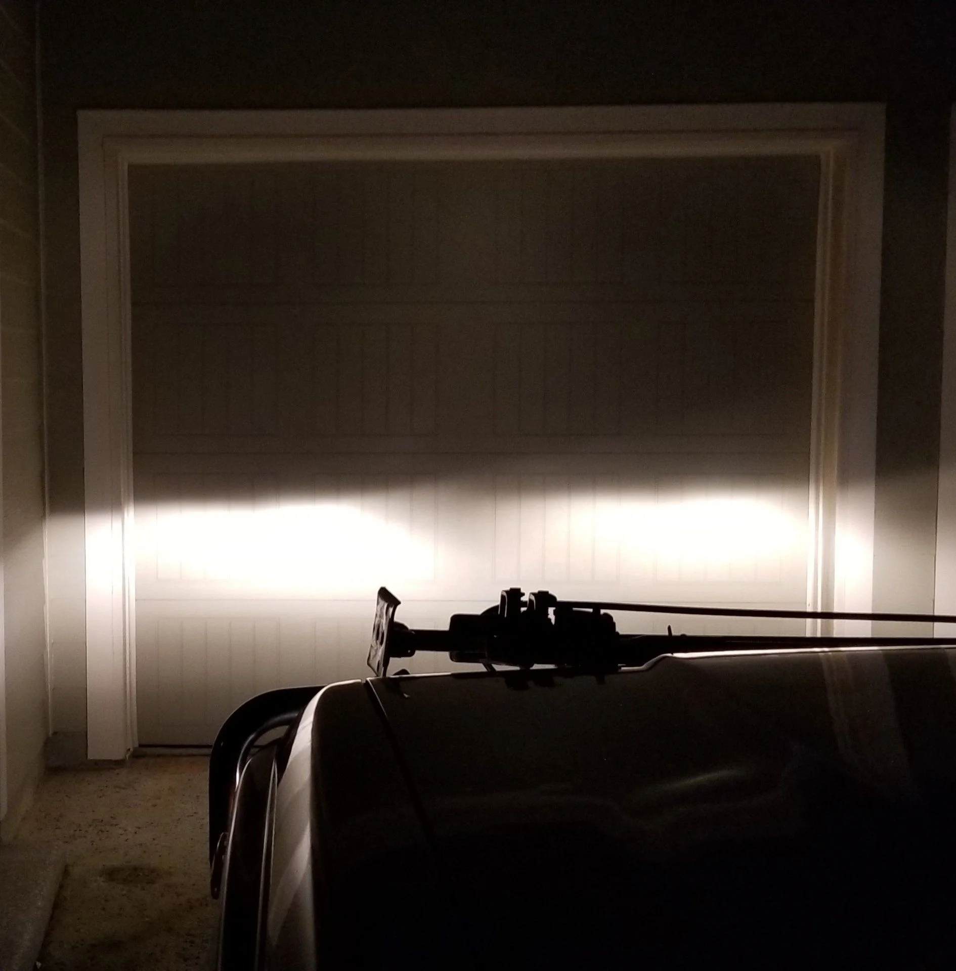

So I just purchased the Hella H4 Housings from Amazon and installed them. They did not come with bulbs but I put a 55(60) in from the autoparts store. A ton better than stock and this is with stock wiring.
First is with no lights on
Second is low beams
High beams
Low beam pattern
High beam pattern
They work great and I'll see if I can snap some pics over time in some weather and different lighting conditions, but overall I am very happy with them.
Nice. I put the Hellas in and they were ok. Then I realized they were aimed too high. When I got them lined up they were very nice.

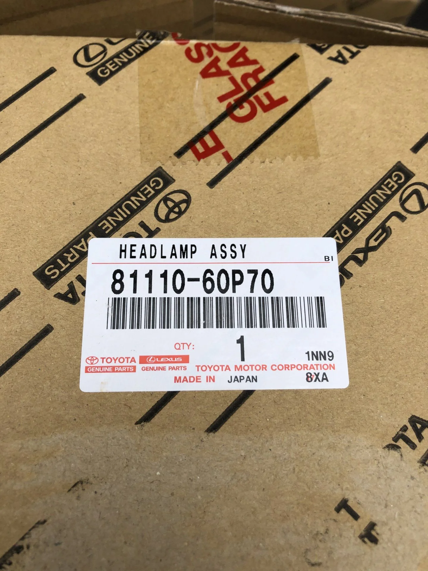

Tried to order the kit @mattressking got from a dealer in Spokane and they said it was discontinued, I’ll post if I can find someone who has it.
