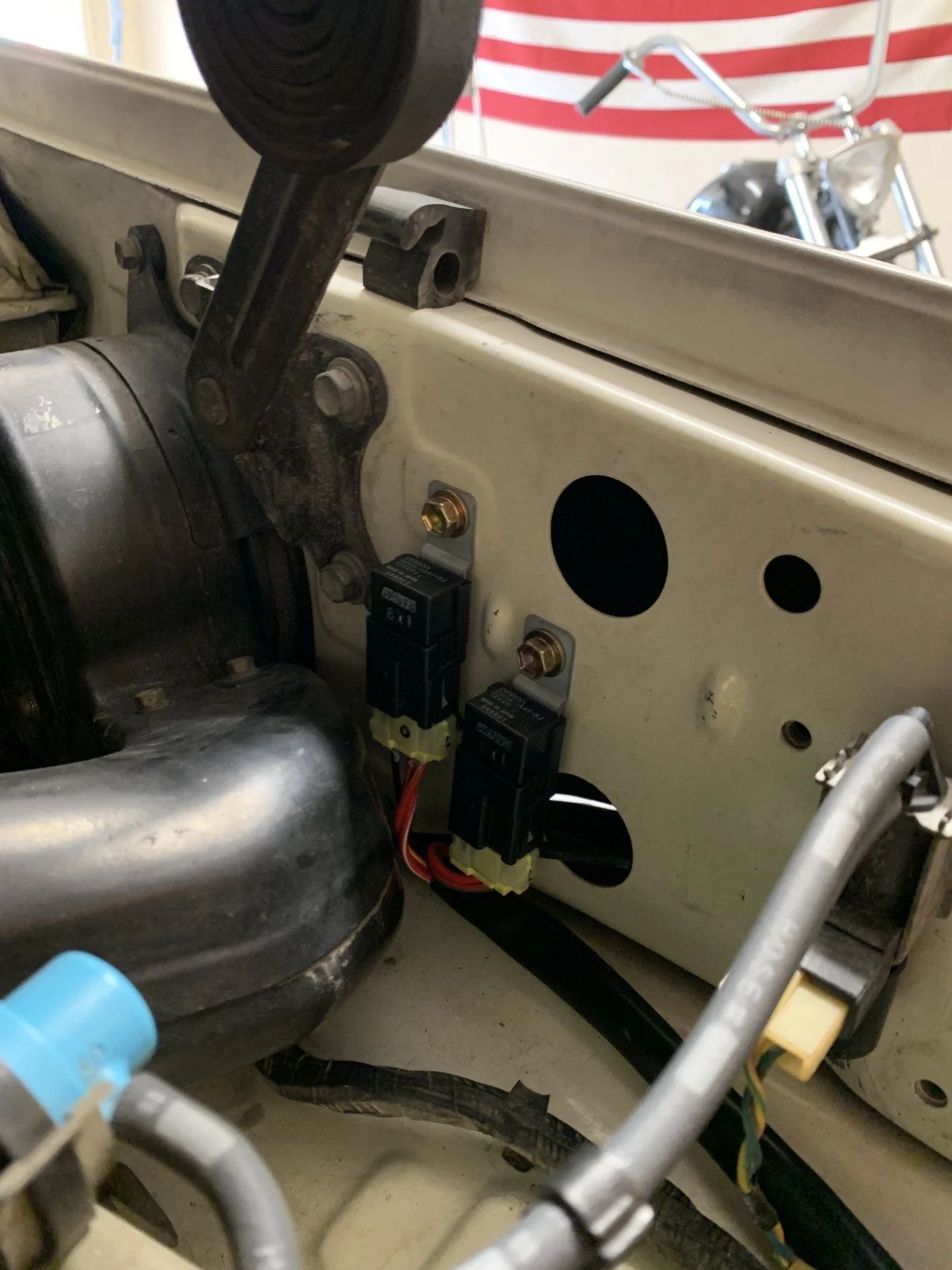

I have not rewired my lights yet but I need to look at the stock headlight relay and see what it is rated for. However I will likely just use the stock relay as is and then wire its outputs to a separate set of relays for Low and high beam..with appropriate wiring and new connectors. I by a lot of wire from Waytek. I also have a contact in Poland who I know of that makes reproduction wiring harnesses for old Honda motorcycles....with correct wiring colors, connectors, etc....and will add updates if needed. If I send him a headlight harness and discuss upgrades he could be a potential source for a stock looking harness.
Thanks for the info. Ive already rewired a lot of stuff in the engine bay including new airgas 2 awg battery cables and a dual battery setup. plus many other low voltage things.

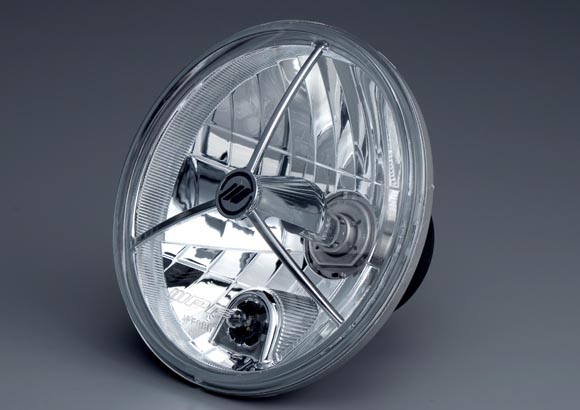

I'd really like a set of these IPF lights but they are only offered for LHD traffic pattern.
