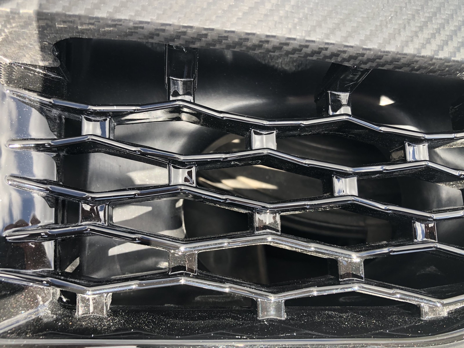

These vents come with a bit of short ducting on the base. This should help reduce some of the water from rain etc that can get on engine parts. With where these are located I'm not too worried about it. The driver side duct needed a little custom clearancing and is over the back corner of the charcoal canister, and the passenger side is over the edge of the air box. Neither spot is too vulnerable for water issues. Little hard to see through the vents but maybe you can make it out.
Hoodvents by Adam Tolman, on Flickr

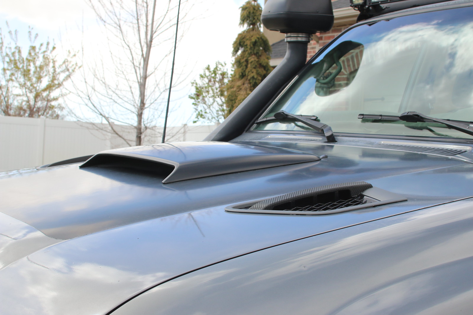

A few of the result.
If you would have told me your plan before you did it, I would have told you "don't do it". Now that it's done, I stand corrected. Those vents turned out great.
Now you need to wrap the hood scoop :/
Do you have some knowledge about these vents I should know that would make you say "don't do it?"
No, I just would have thought the look of those intricate (and very LR looking) vents wouldn't have flowed with the 80. The carbon fiber overlay was a great idea. I think the end product turned out really well.
