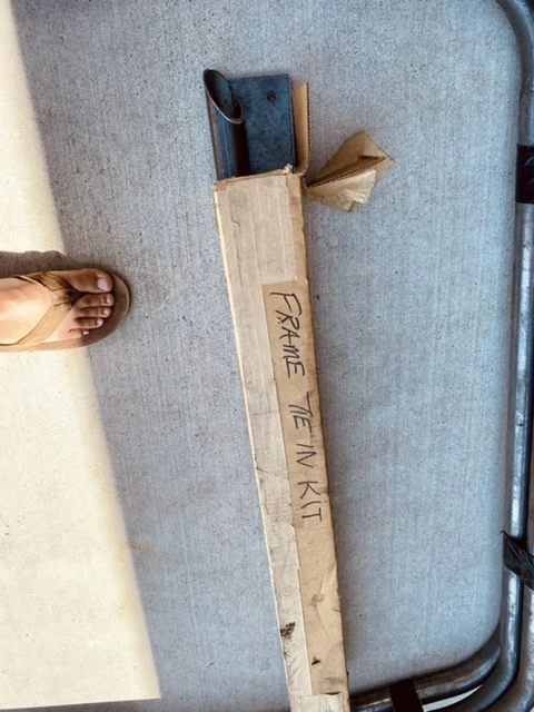

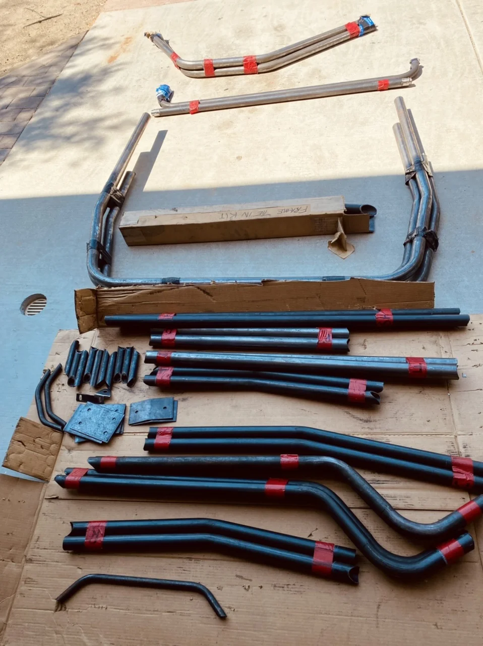

Hey guys, one of the safety the upgrades I want to add is a roll cage.
I ran into a fellow FJ55 owner online from Colorado who had a Redline Land Cruisers roll cage. He sent it with a buddy and we met near Monument Valley. I think these ran for around $1200 from Redline. He gave it to me for $250.
We won't talk about the gas money and time it took to drive over from San Diego, since it really was just a good excuse for a quick camping trip in the 100 series to see some beautiful country.
I have a guy here who will do the welding and help with the install. I'll post photos of the process once we dive into it.
Here are a few photos of the cage and of the quick trip to pick it up.

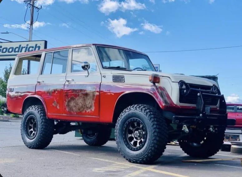

My current plan is to run 285/75/r17 tires on 17x8.5 wheels with a -38 offset. This is a photo of Kevin R's rig with this setup (he said he just had move the exhaust a bit). That's an *almost* 34 inch tire.

Yep, 33”x10.5”-15’s on stock steel is all the rage right now. This is with or without hubcaps. Newer style aluminum wheels are normally shunned and dismissed with rolled eyes and a nasally exhale, but I do have to say the wheels and stance of the above shown 55 with the knee-level, mid-close photography looks pretty good.
