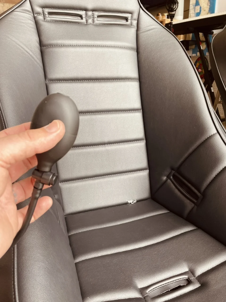

It's a suspension seat that should help save our backs a bit on the trails. I also added the inflatable lumbar support.
The driver seat is heated.

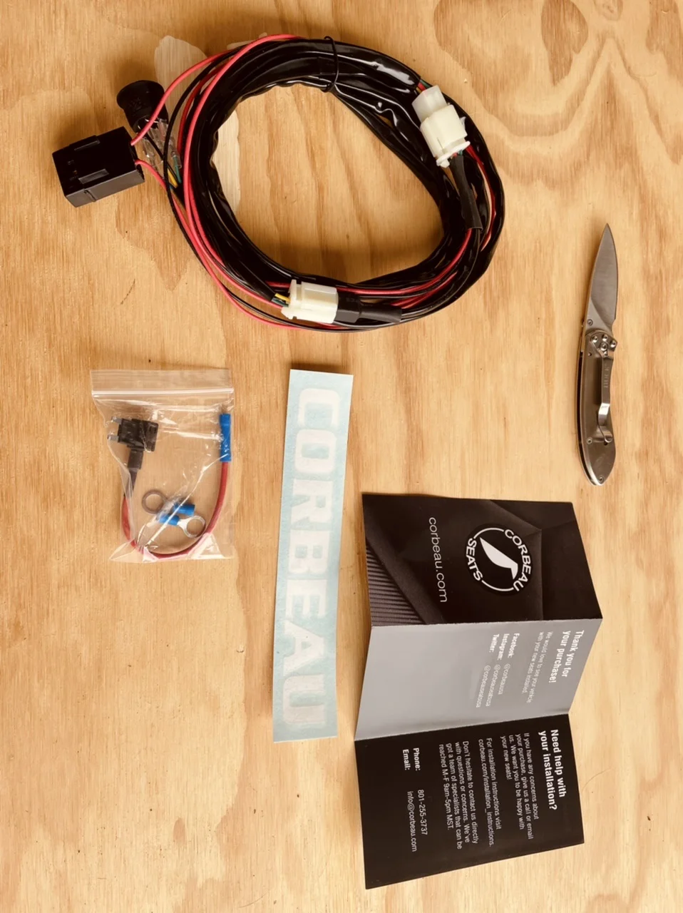

Just opened it up. Looks like the damaged package had brackets, harnesses, and mounts.
So comfortable! I'm a big guy (6'3", 220), which is part of why I chose this seat. Feels good. Tried pumping up the lumbar support while sitting in it and this seat basically hugs/supports every inch, including up on the sides a quite a bit.
