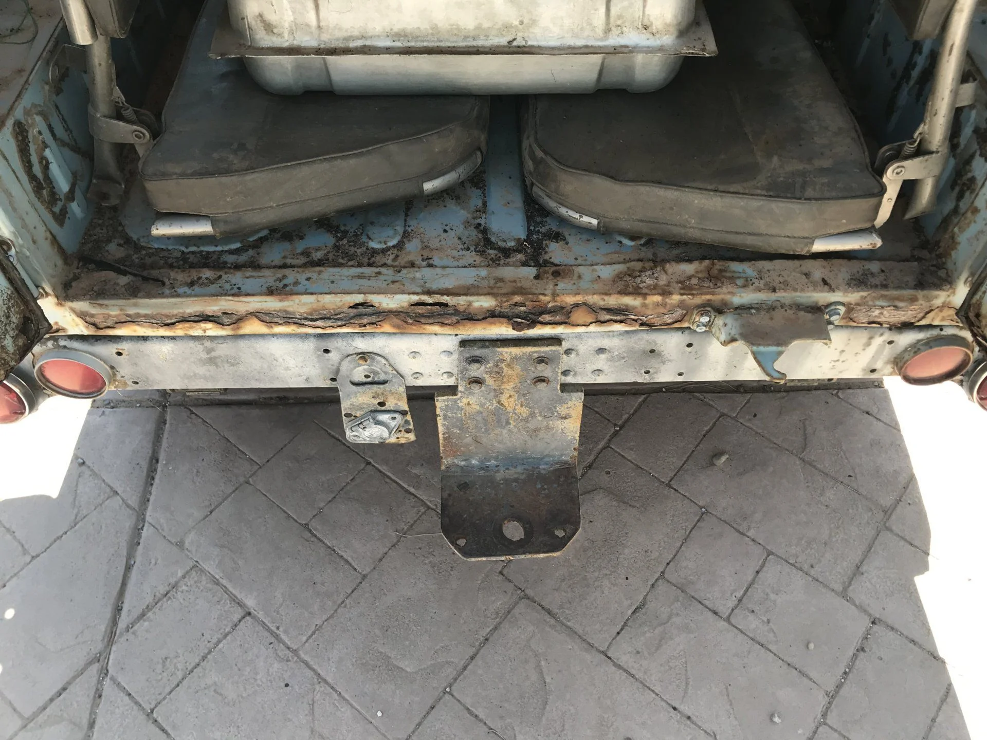

Rear Sill: Rust has eaten through a few layers of metal, but not all the way through. It also hasn’t wrapped around to the rear quarters yet.

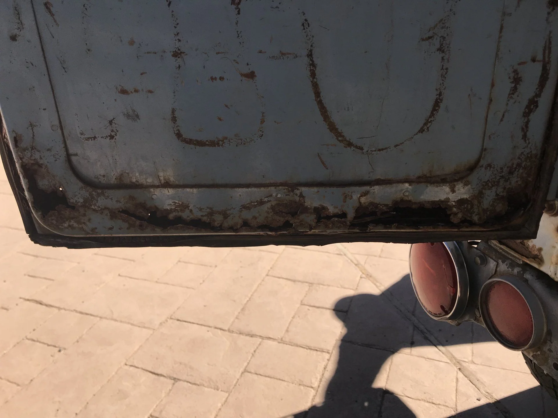

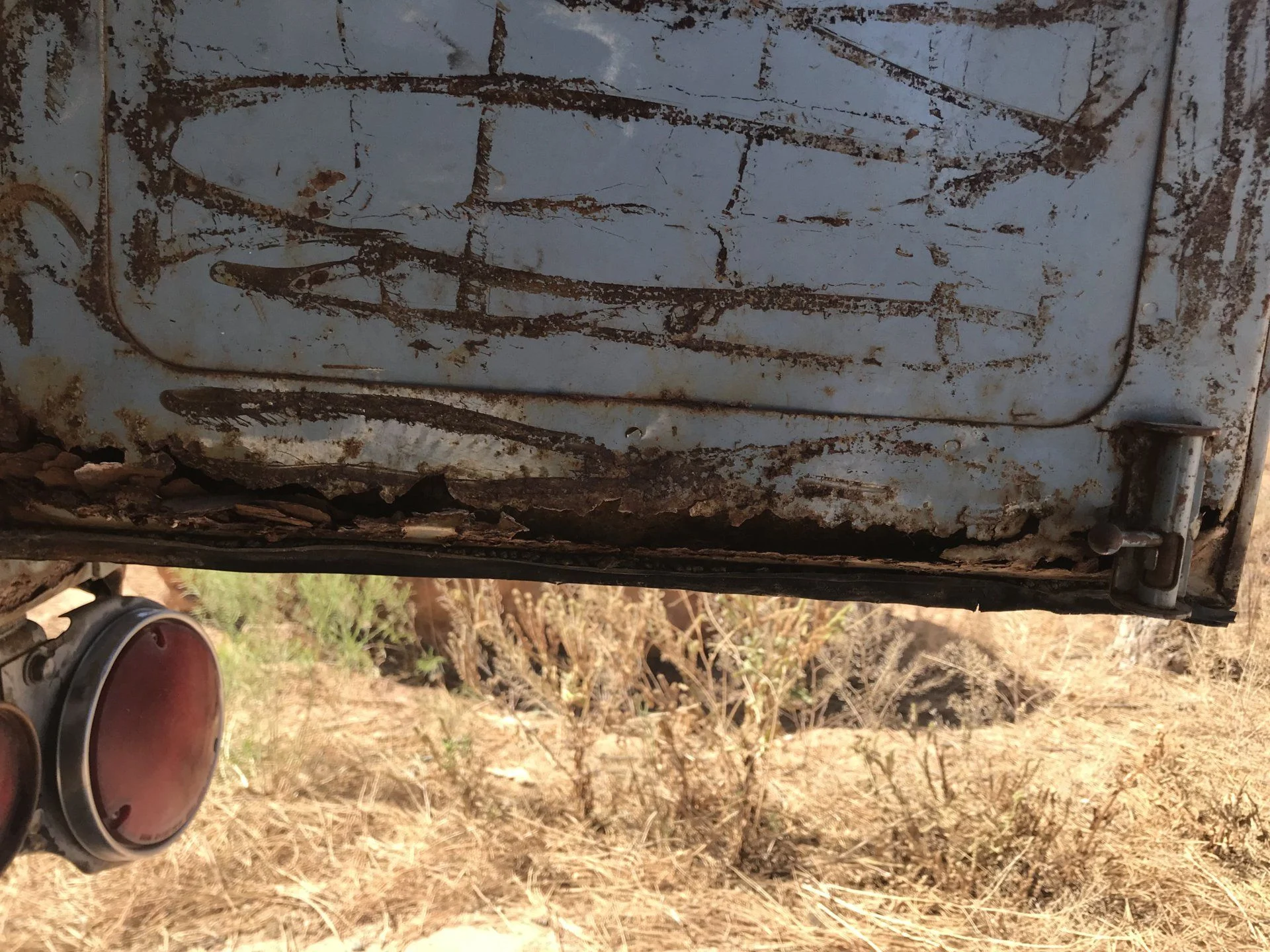

Barn Doors: The bottom edge of the Doors have been rusted through from the inside.
View attachment 2017533View attachment 2017534
