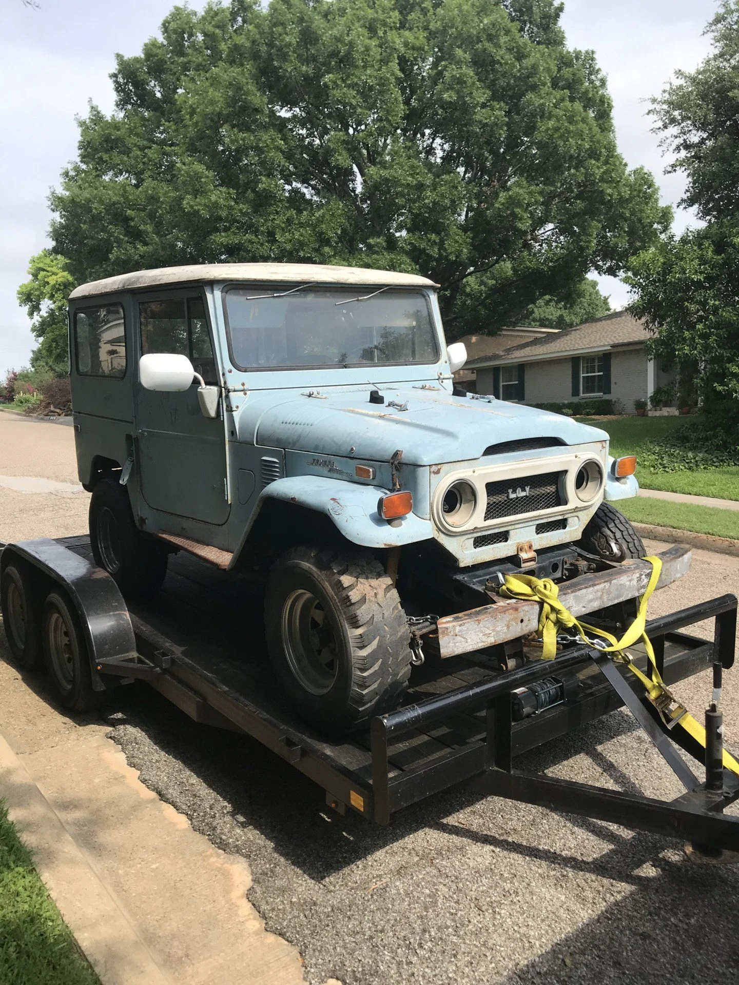

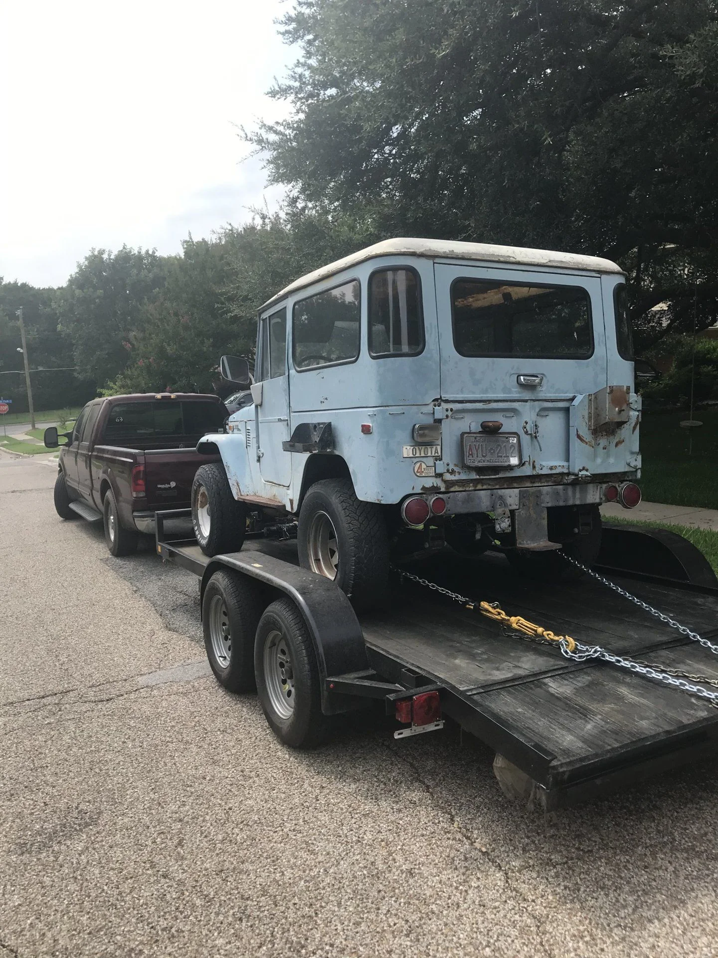

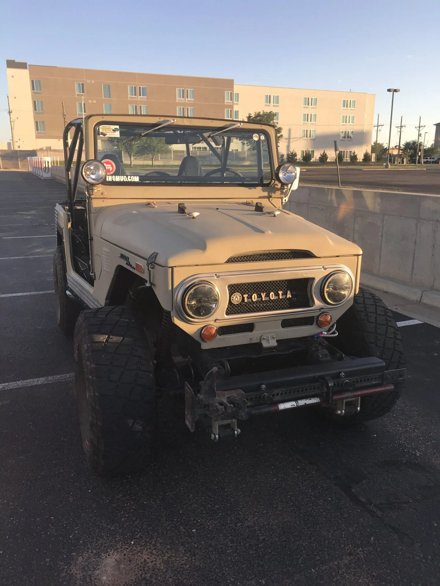

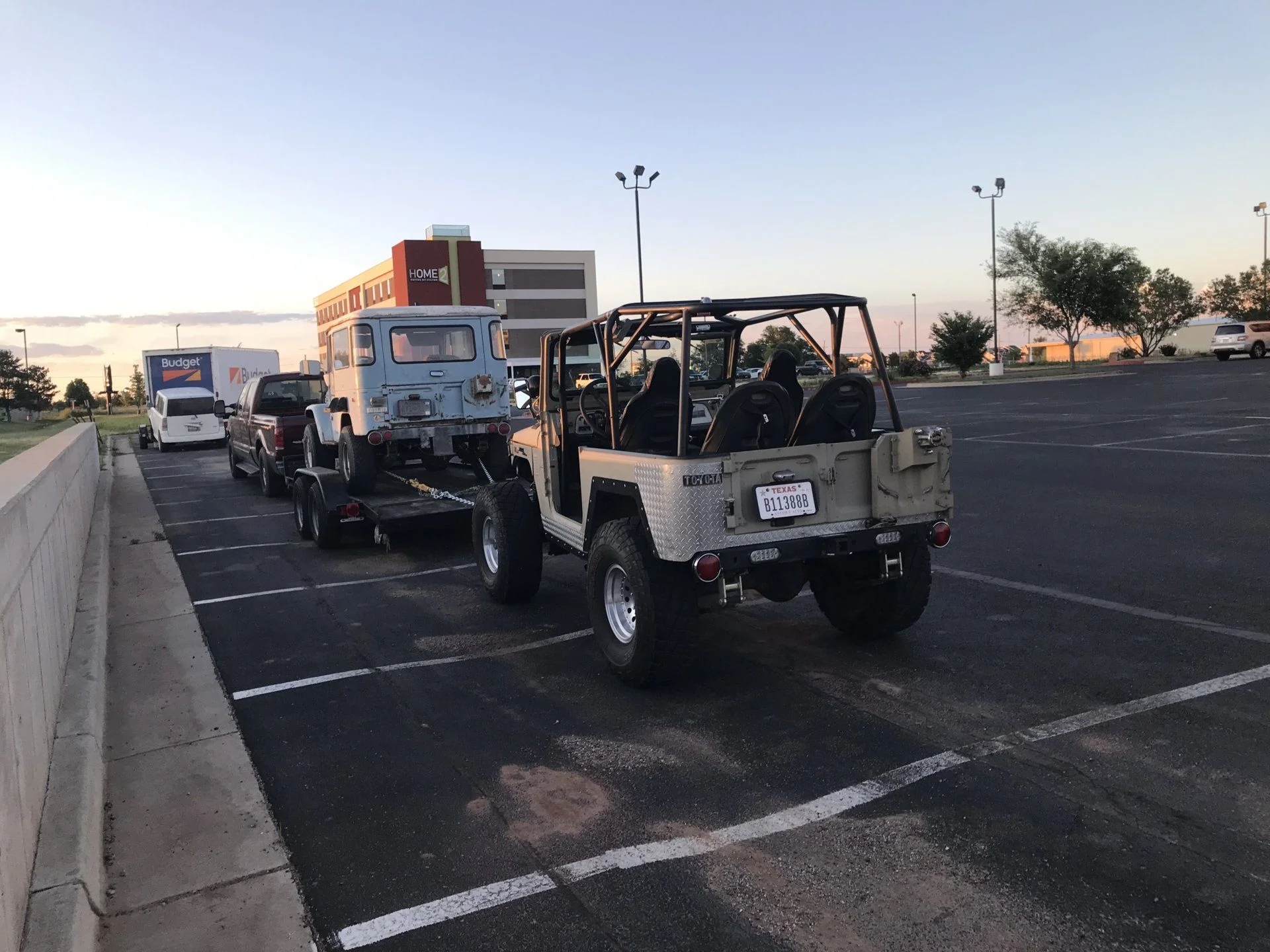

We stopped for the night at a hotel in Amarillo and plan to finish the rest of the journey home tomorrow. We met with @POTATO LAUNCHER for dinner and he brought his sweet 40 along. He also had a look at Bluebonnet and pointed out some cool features I didn’t know about. Apparently 73’ was the only year for the factory rear reverse light and the last year without the interior roll cage.
View attachment 2011267View attachment 2011268View attachment 2011276

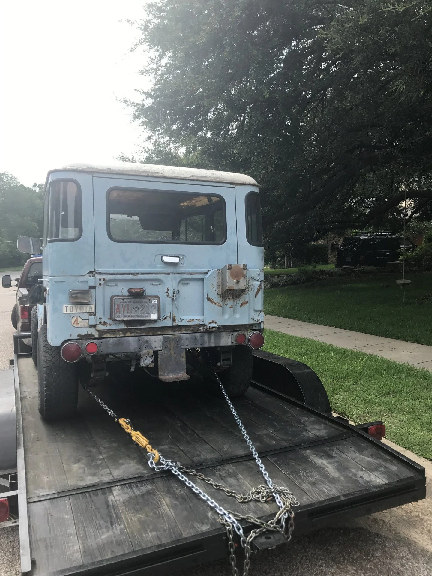

That is the original plate 1972👀
She is home! Although the neighbors aren’t too happy :grinpimp:

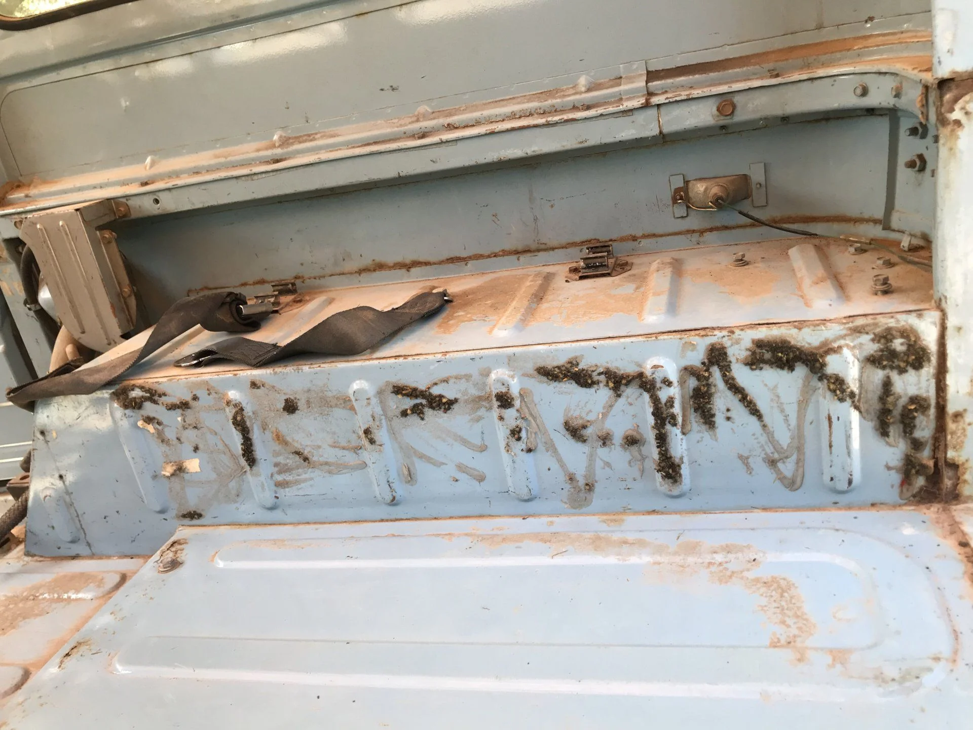

The First order of business was getting the interior cleaned up a bit. The Red New Mexico dirt had found its way into every crack and crevice in the truck.

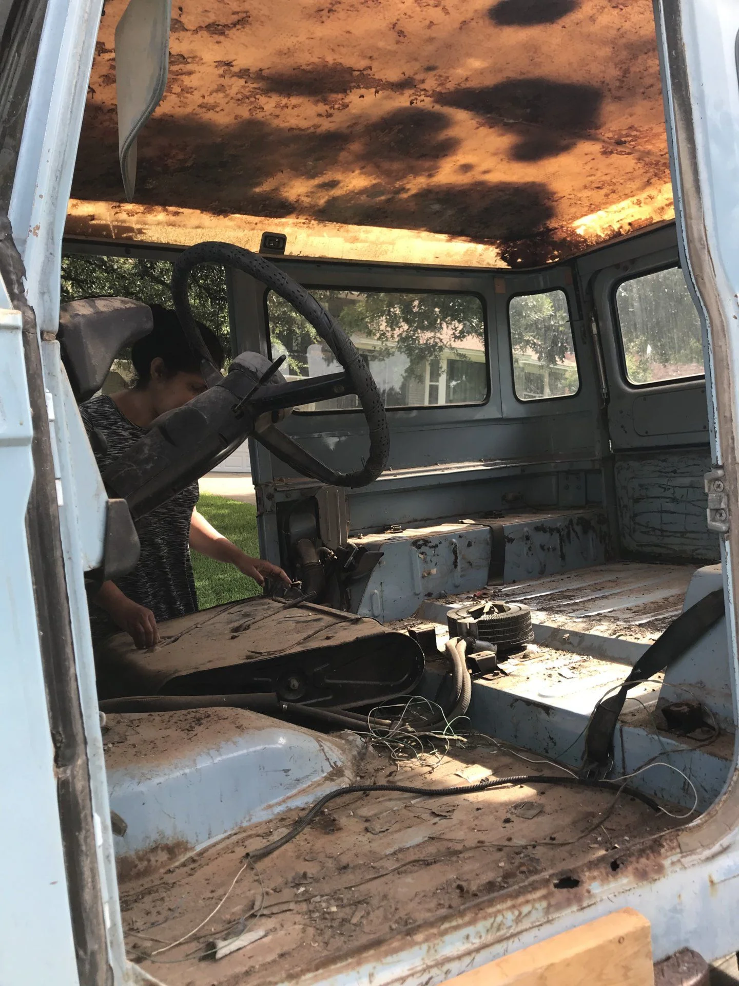

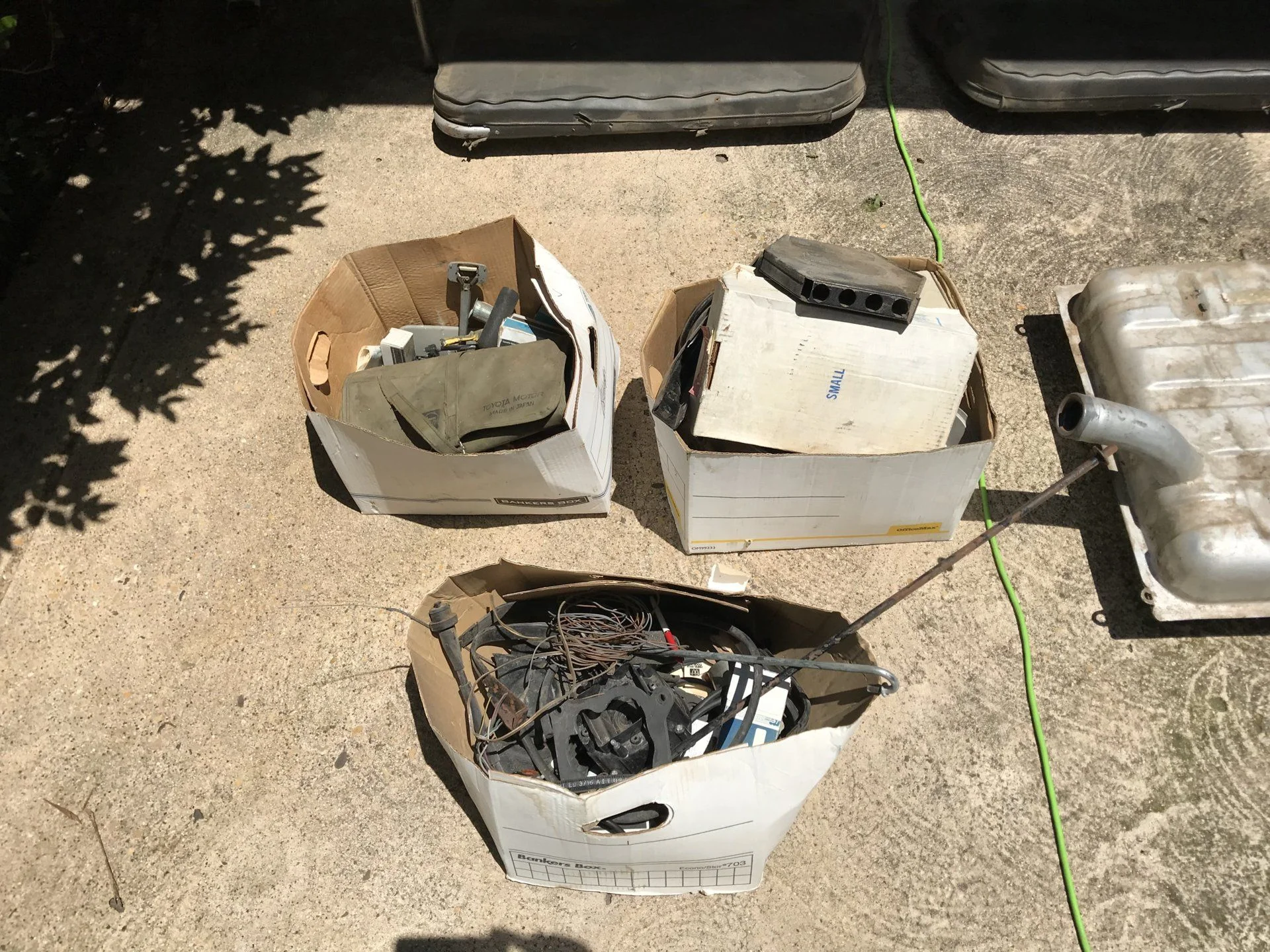

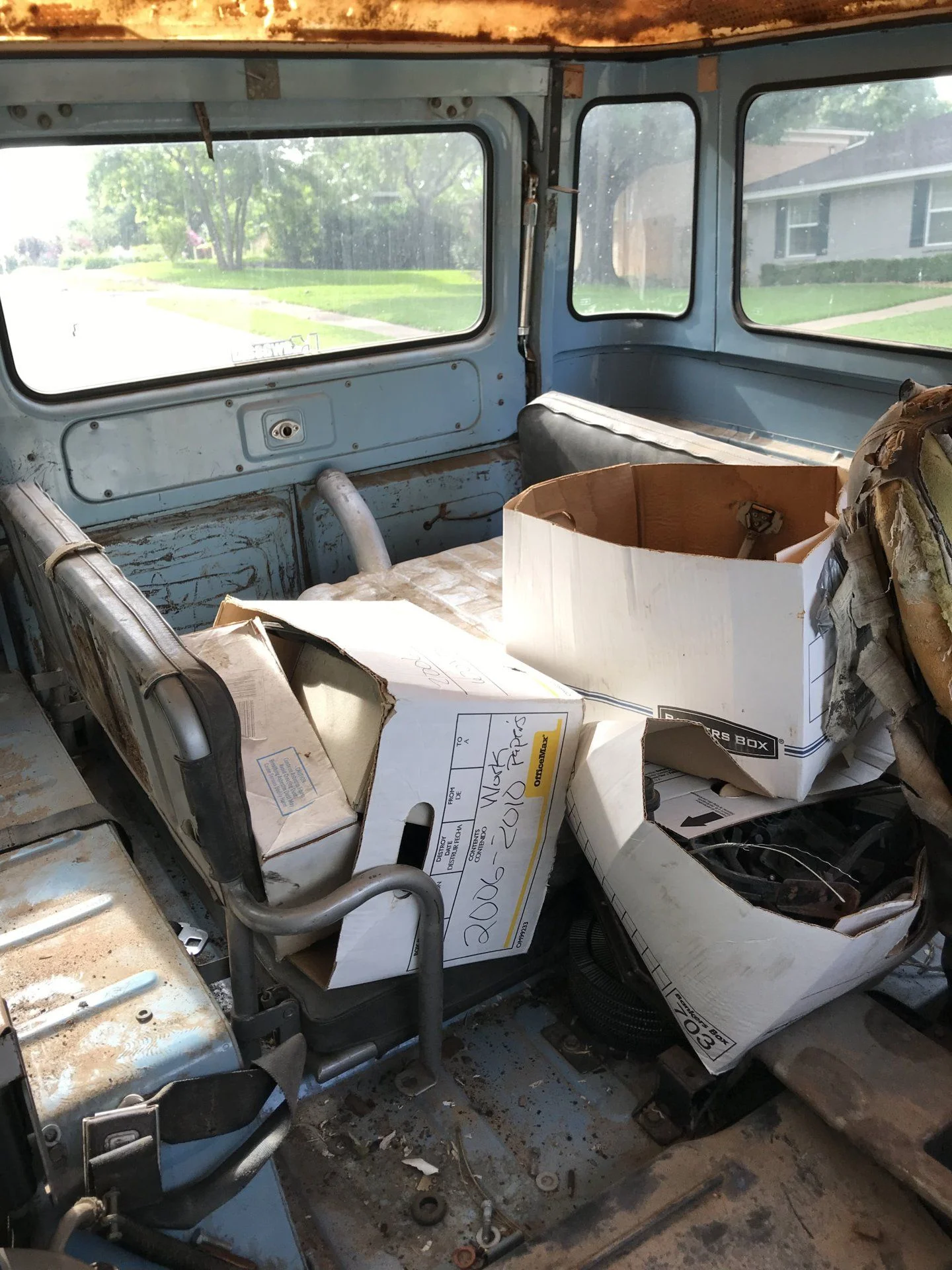

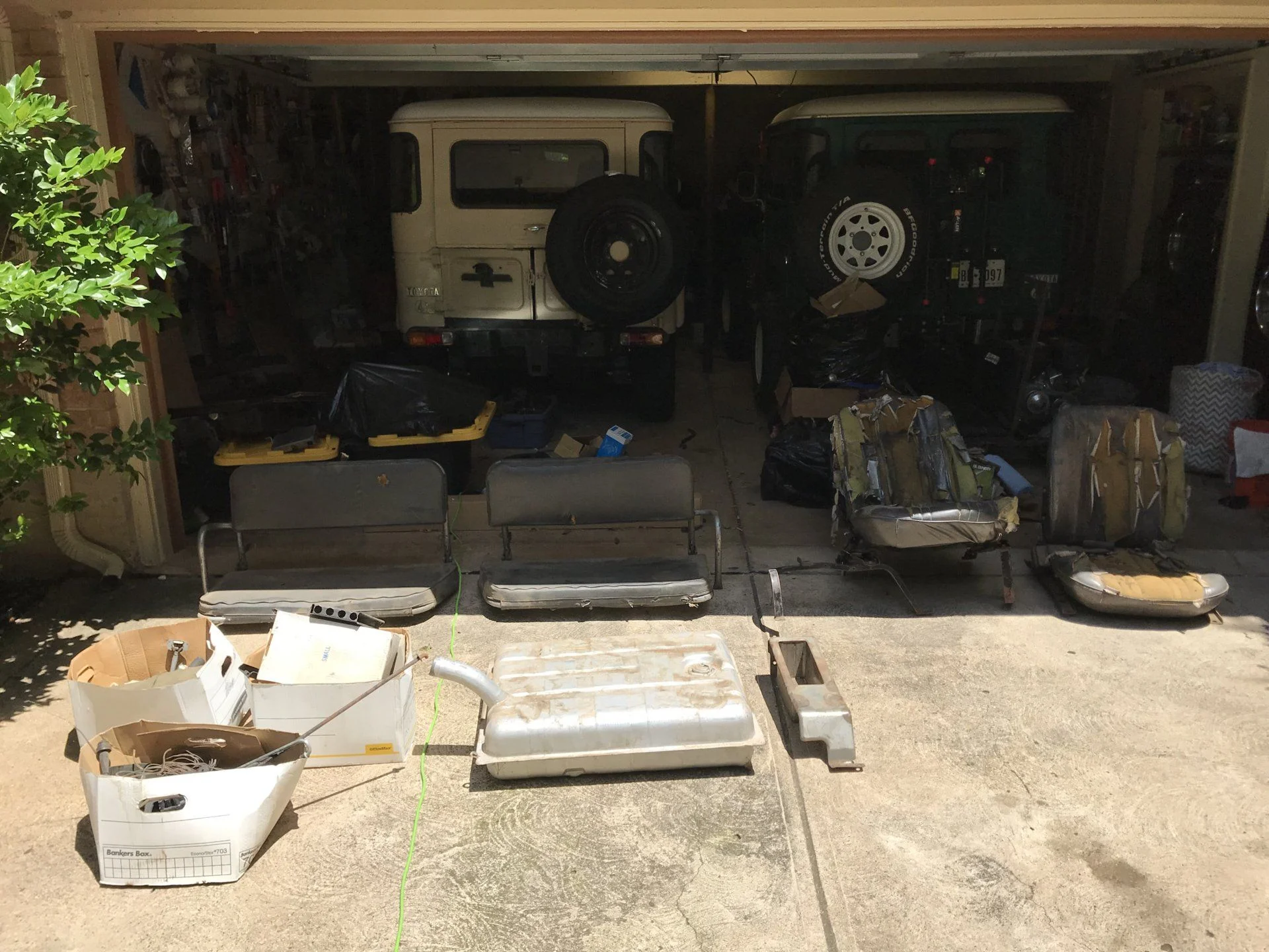

I pulled the front seats, rear bench seats, spare gas tank, center console, and 3 boxes of parts out onto the driveway. (Sandy and Kermit kept me company :) )

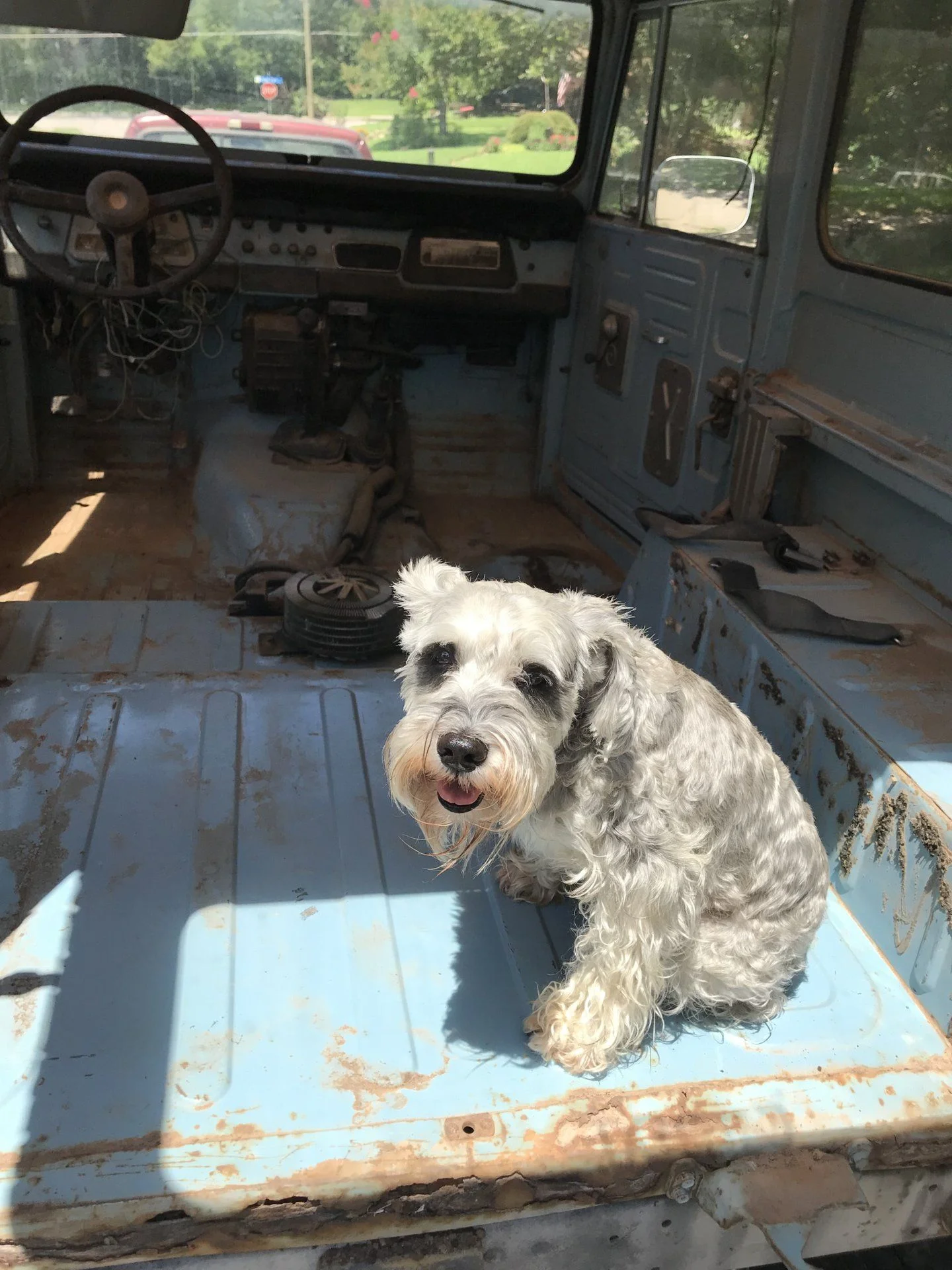

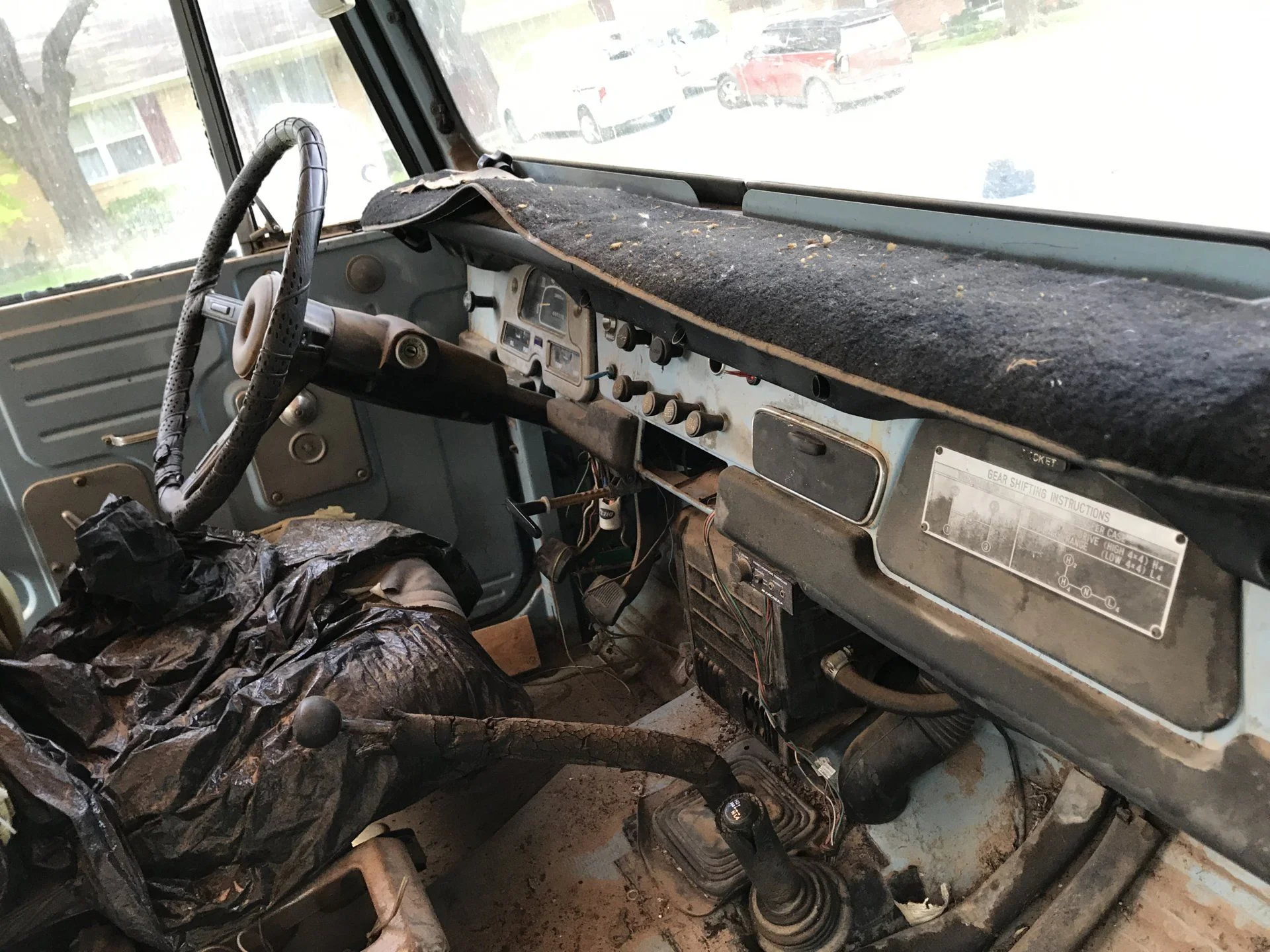

This is what the empty cab looked like:

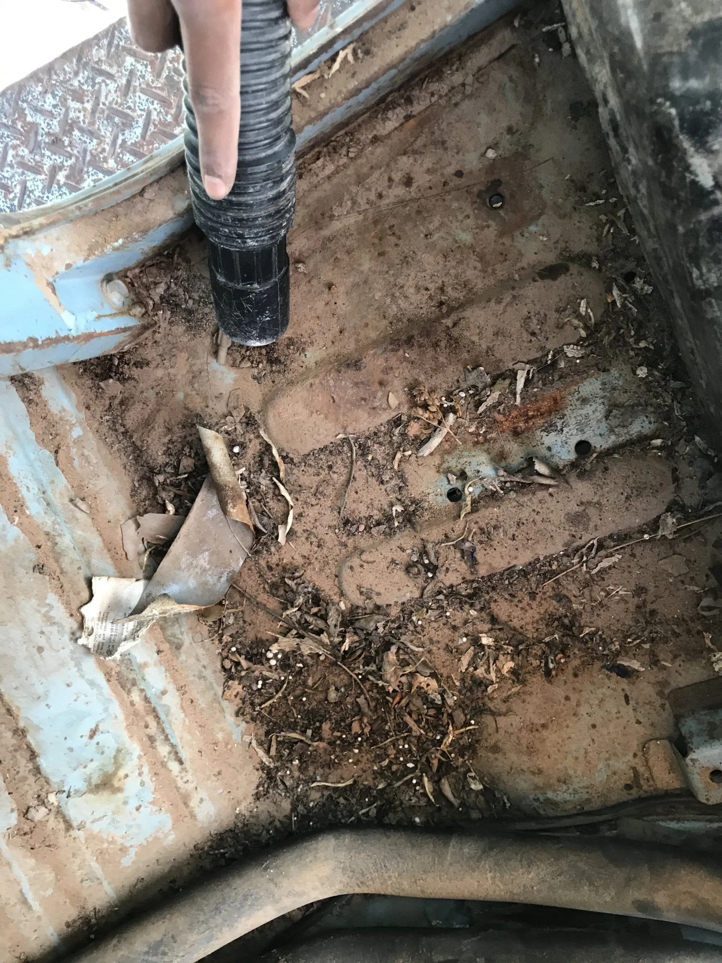

Then I grabbed the shop vac to suck up the loose dirt.
While vacuuming I found this deposit statement that we think belongs to the original owner:

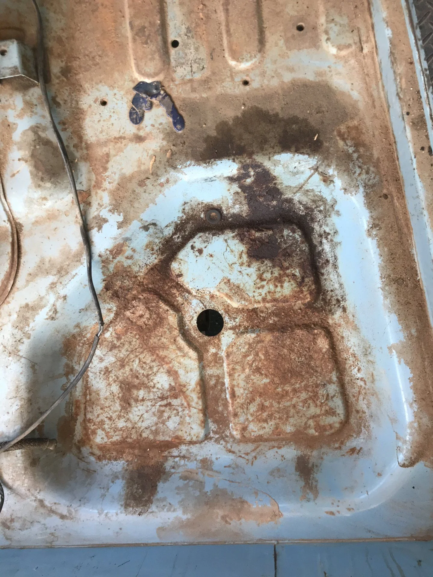

Ten minutes into the ps floorpan the vac quit working, so I decided to go old school with a brush and spade. I worked my way around the truck until all the loose dirt was collected. Zeus Approved :)

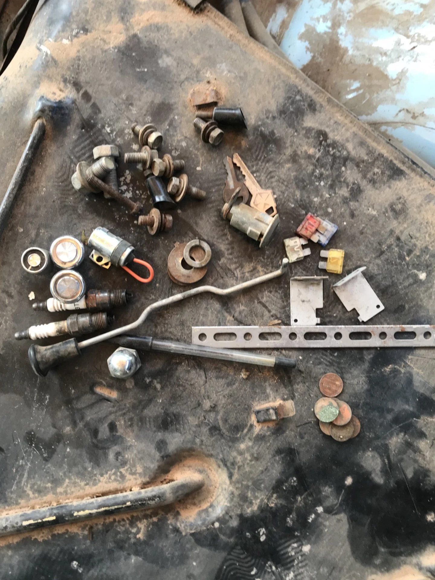

Then I pulled the gas tank and cleaned out the dirt underneath. Here are some miscellaneous items I found from under the gas tank and inside the glovebox:

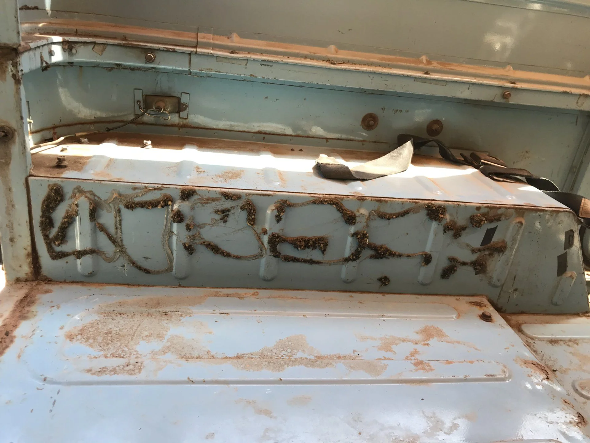

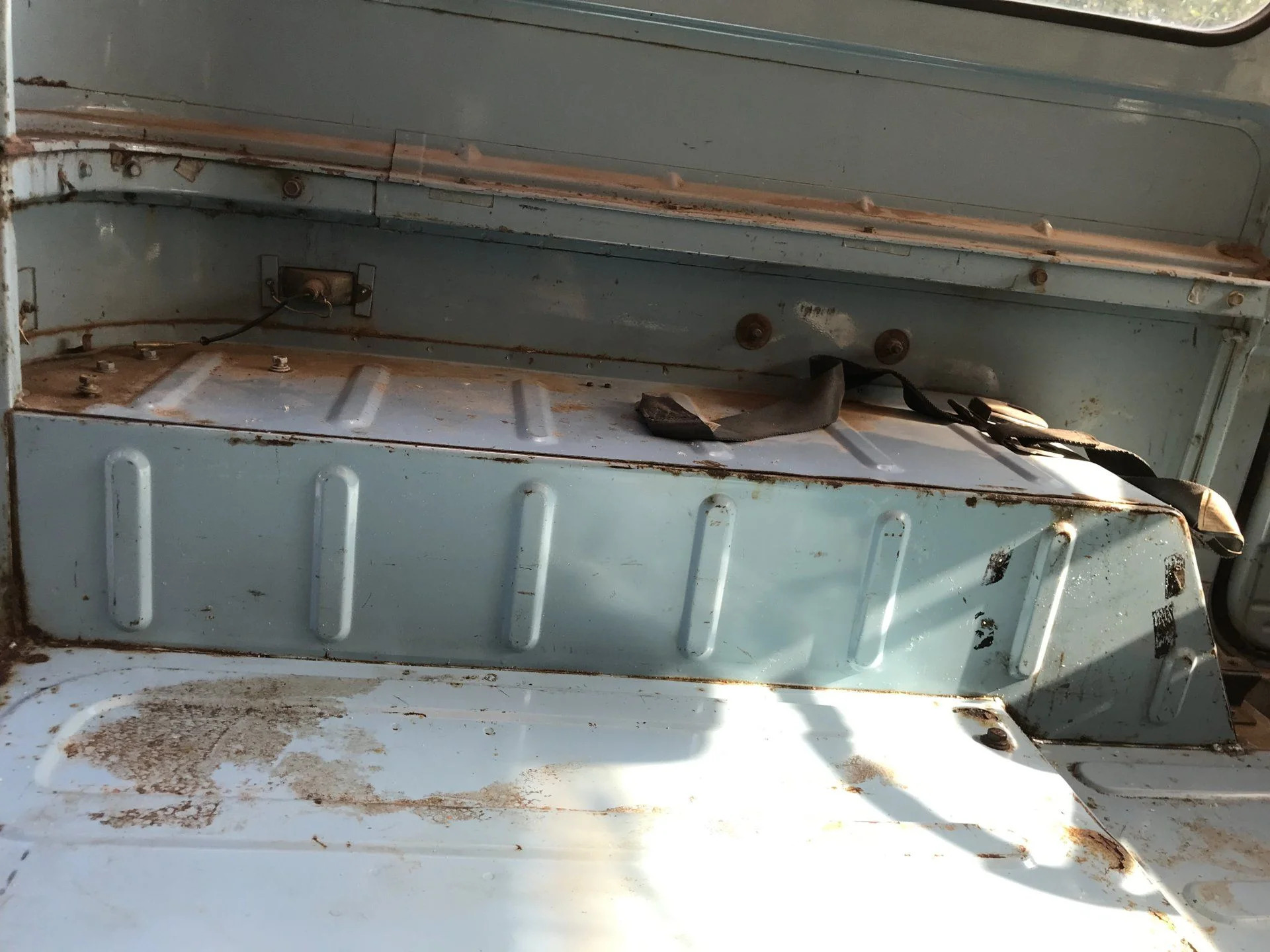

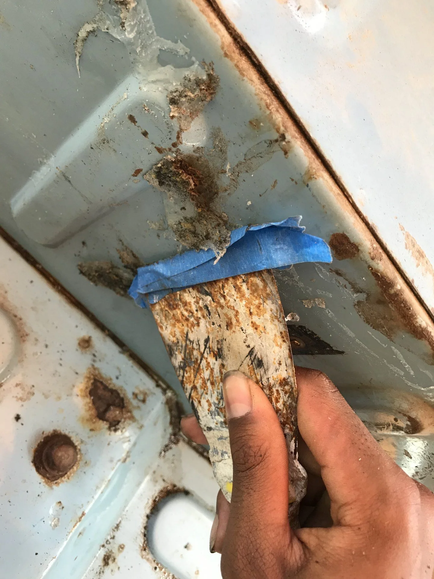

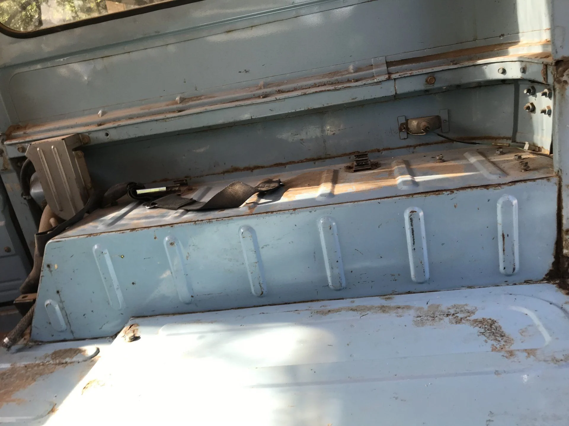

On the Rear Wheel wells there was some old insulation and sticky glue remnants bonded to the paint.

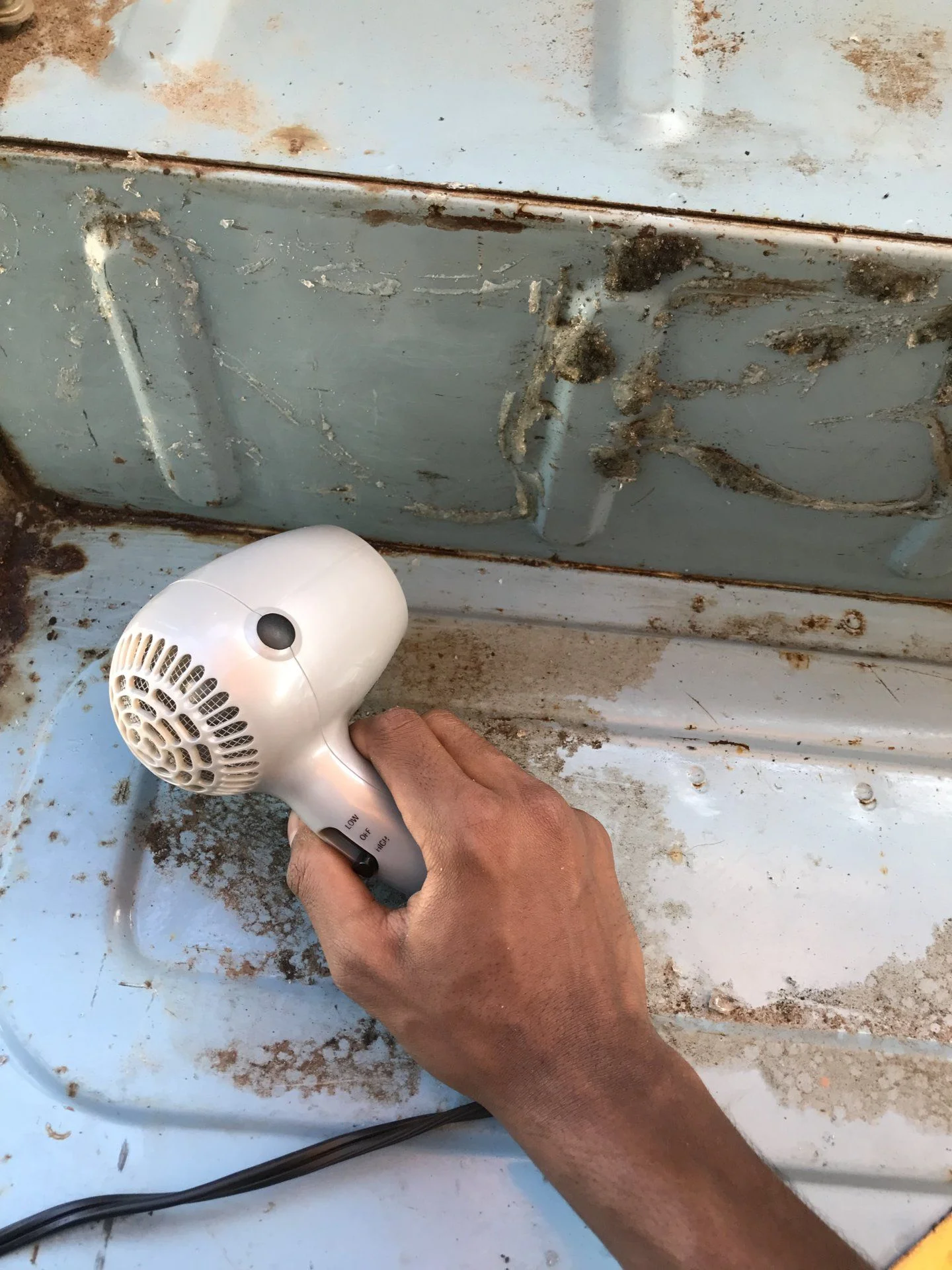

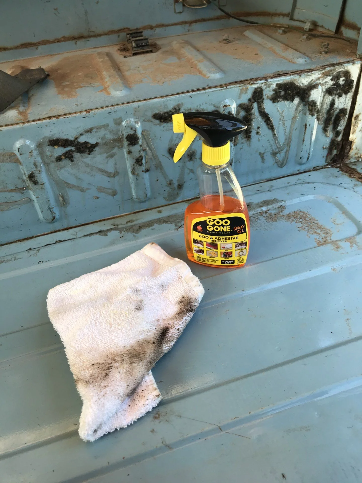

I began by heating the glue with hairdryer and worked a quarter of the wheel well at a time with a paint scraper. I taped the edge of the scraper to avoid scratching the paint. I repeated this process several times and used my fingernail in the hard to reach areas. Then I sprayed the remaining residue with Goo Gone and let it sit for a few minutes. Then I wiped off the excess and I’m quite happy with the results:

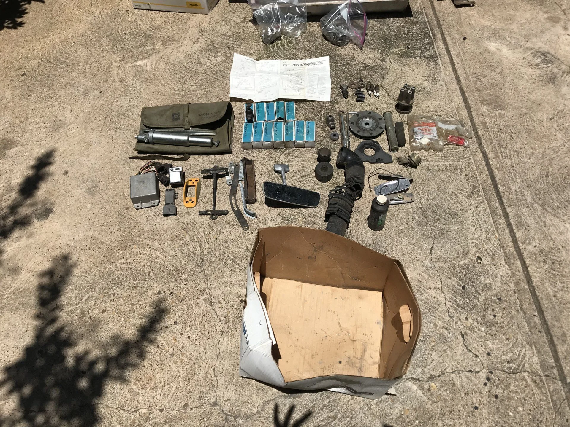

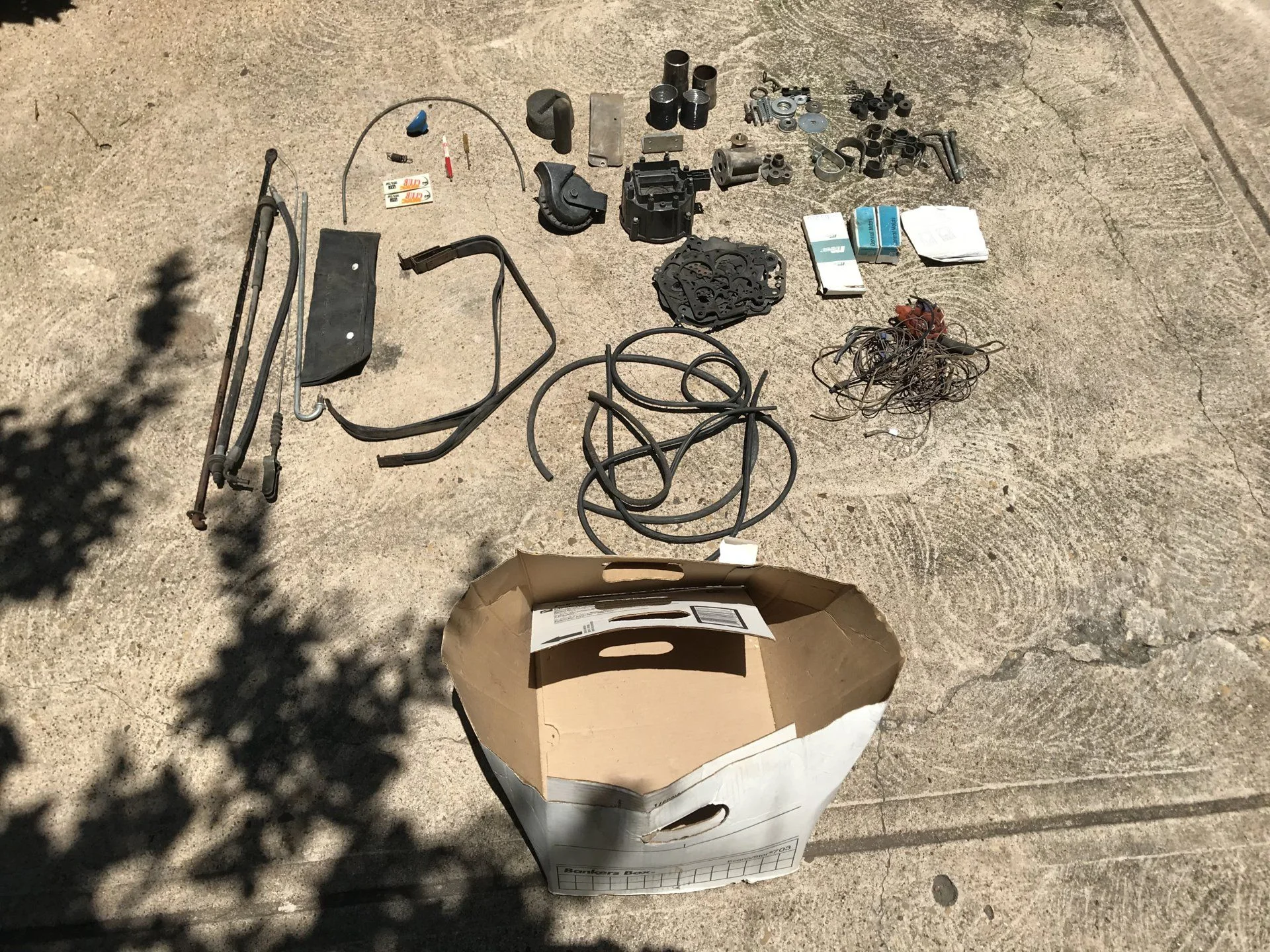

The next order of business was unloading the 3 boxes of spare parts. This is my favorite part with any restoration/refurb, its like Christmas came early :grinpimp:
2013506
Here are a few big ticket items from each box
Box 1:
2013507
Hood Prop. Carburetor Gaskets. Distributor Cap.

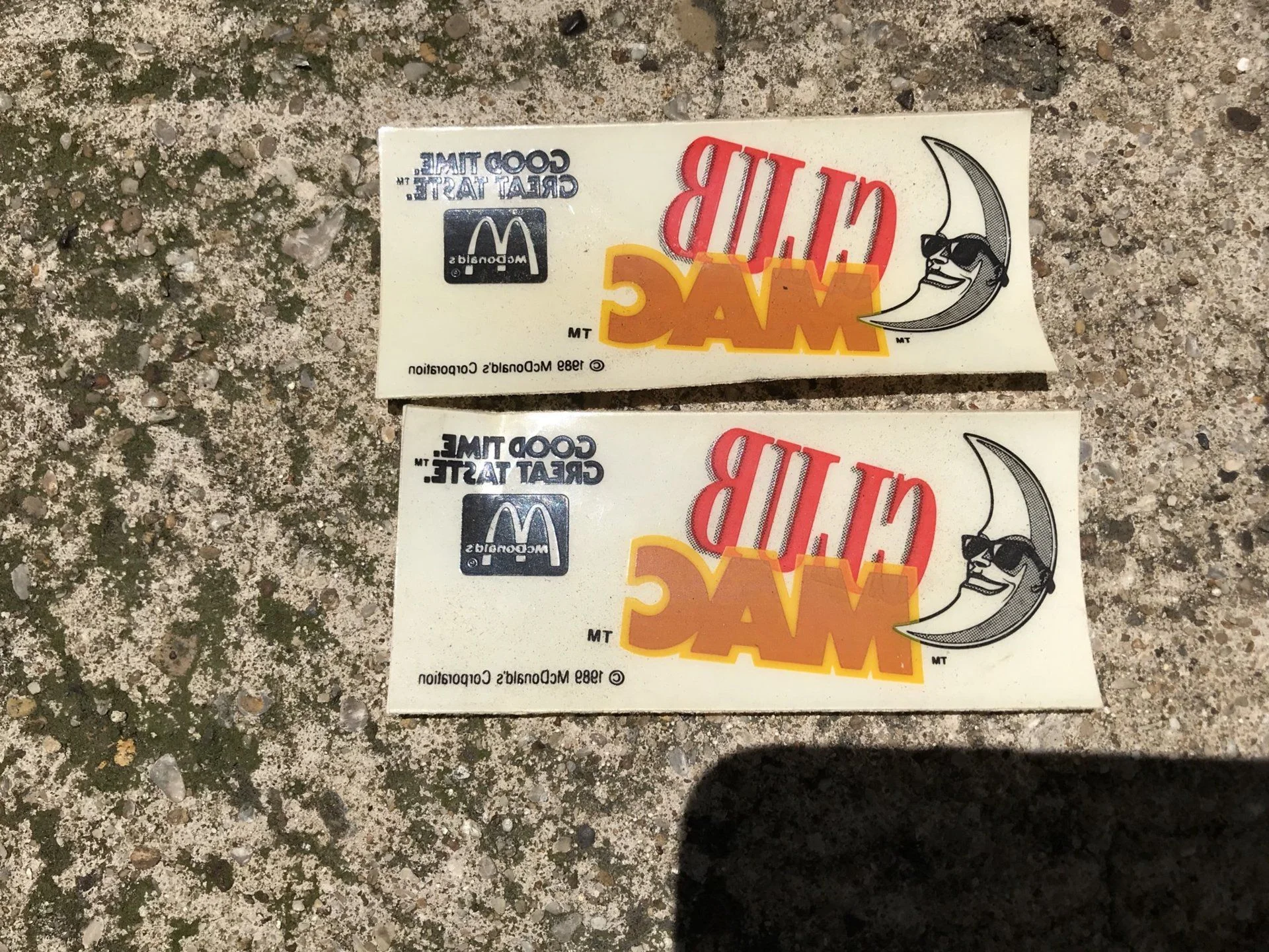

Found this McDonalds tattoo from 1989:
2013508
Box 2:
2013509
Toyota Grease Gun. Rearview Mirror. Alternator Brackets.

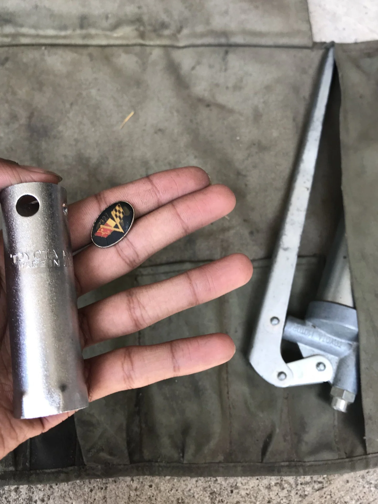

It’s pretty awesome that the tool roll is still with the truck. That’s a cool old pin. If you don’t keep it for your self I know someone who would gladly take care of it.;)
