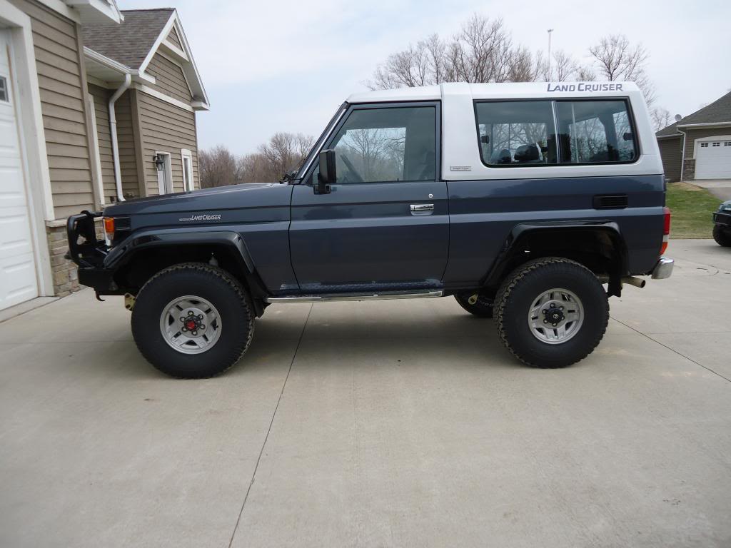

So cosmetically, it is pretty much done---except for the crappy factory rear bumper, which I am going to replace one a new one makes itself available. I was really surprised when I tried to shut the doors with the windows up. Must not be many air leaks, because you have to shut a little firm due to air pressure---but that is a good thing!
Kind of looks like Charlies twin---mirror image though.
NEW AVATAR!
Easily the 2nd best looking BJ74 in the States. :cheers:
Just kidding ...... It's beautiful.
