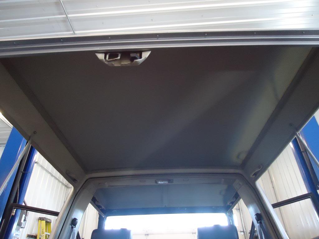

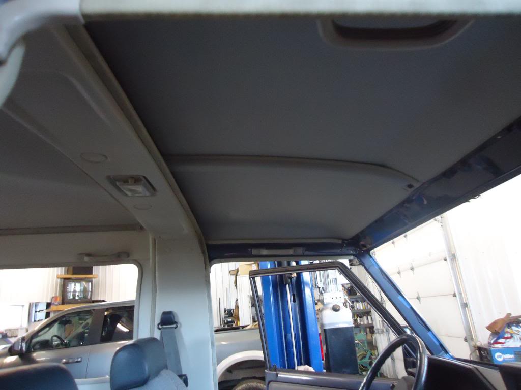

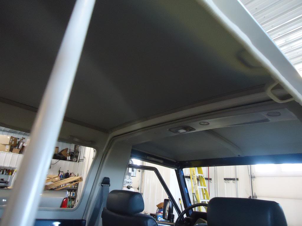

I got the FRP top back with the new headliner installed. Going to wait and put the trim pieces in until after the glass is installed, which should be later this week

The headliner looks great by the way.

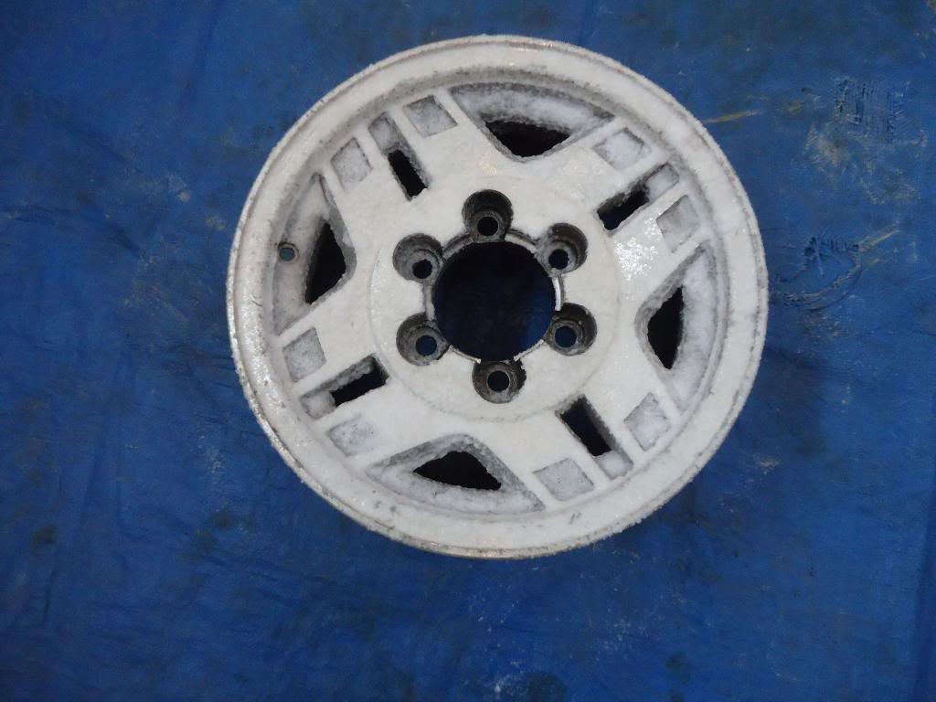

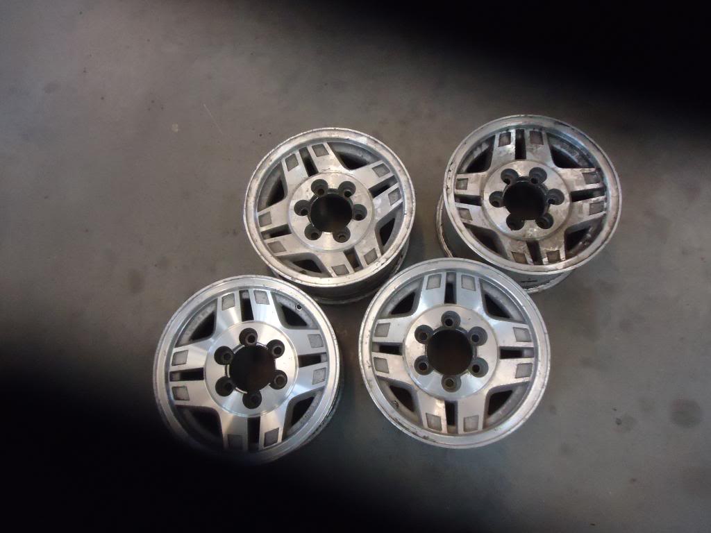

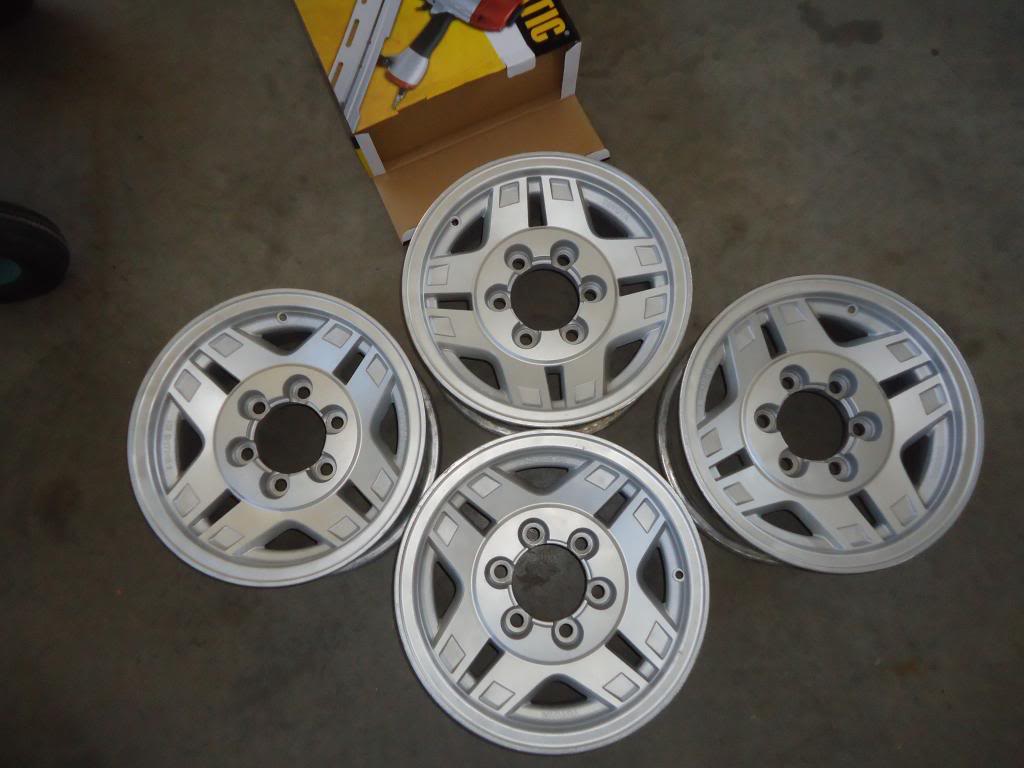

Well I found some 15X7 4 spoke rims like were original. (sorry---bad pic
Started off stripping the clearcoat off of them with paint and Varnish remover.
Then I glass beaded them with #8 glass bead. Real fine, but a pretty nice surface
Next I will do some polishing---see how that goes, then powdercoat with semi gloss clear
