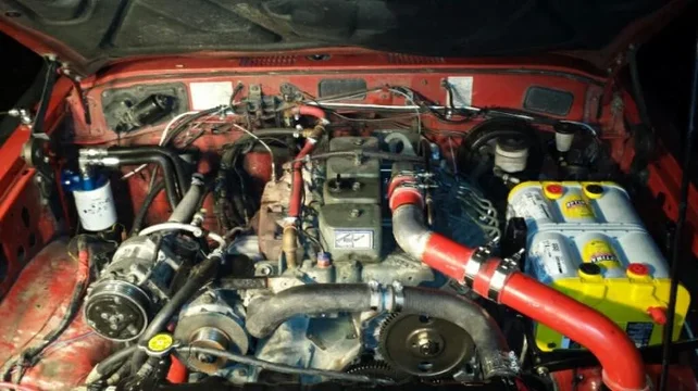

I forgot to add these pics. You can see the remote oil fitting have been changed. Thanks for talking me into getting that done, it looks better and takes up less room.
The front engine cover it taken off to be resealed properly. Has a small stubborn leak.
You can also see the airbox is out. Getting a larger one put in. If the new one works, then I should be able to drive through the rain without turning the snorkel head. The water would pool at the bottom of the box and the air filter would be too high to suck up the water. Then unplug the drain at the bottom when you want to dry it. In theory it works, let's see if we can get reality to cooperate.

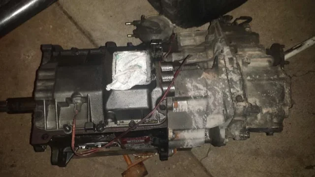

Ok mudders need some help. While taking out the transmission and transfer case yesterday to reseal some gaskets, my buddy was not able to secure them correctly and they fell on their side breaking the vacuum assembly on the TC. That's the piece that makes it go 4wd. Now I need a need a replacement, but the only ones I can find are almost $500. I have finals this week and that's been taking up most of my time. I was hoping to pick up Big Red by this weekend to take the family on a trip, now that's very doubtful. To be honest I'm not upset or angry, I'm just glad he didn't hurt himself. So if any of you know where I can source this for an affordable price please let me know.

On the ground. The input shaft has a small leak and needs a new seal.
another angle
And here's the bad news. You can see where it's broken. I know this is probably the best time to convert it to a lever actuated 4wd but I need it ready by the weekend and I'm tried of waiting on it.
He's already made contact with Jason at cruiser parts and we're waiting on an answer. I'm just trying to source one ASAP just in case. Thanks

I don't know if it is the same as the old 3speed tcase vacuum actuators, but if anyone knows if they will work I have one.
Thanks, I'm not sure if that one works, but if it does I'd like to buy it from you.
x2 for calling Georg at Valley Hibrids, but get his twin sticks instead = more betterer :D
orangefj45@sbcglobal.net
Or call Cruiser Parts llc up in NH for a good used replacement. cruiser specific junk yard.
http://cruiserparts.net/
And there's another one down near ATL???
I think you can run it down the road like it is...
