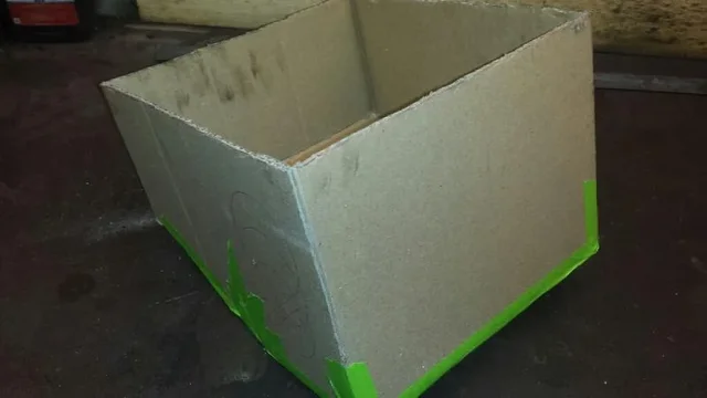

Got done with most of my tests, and it's my weekend with my son. Hopefully the weather will cooperate and won't ruin our plans. In the meanwhile here are some teaser pics of the continuous work in progress that never ends and goes on indefinitely.
first you recycle a cardbaord box
second you learn how to spell cardboard
then you put it in a 3d printer named Jacob and come up with this

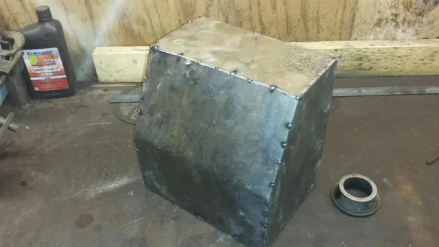

another angle

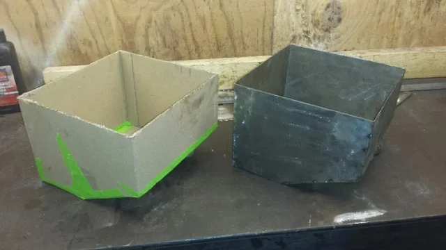

Side by side

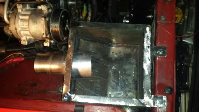

This new larger angled design should remove all restrictions and pool the water at the bottom away from the filter. It's not a final product yet so be kind with your criticisms. I just came up with what I wanted but the talent is Jacob, the guy who is making it happen.

Still not done.
here's it mounted in its spot
Here's a rough idea of what it should look like. the air filter is facing away from the inlet to lower the odds of water suction.

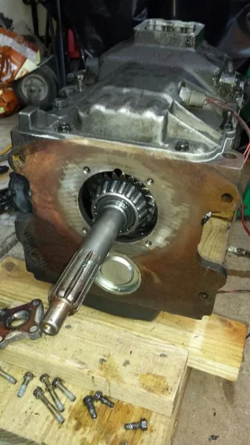

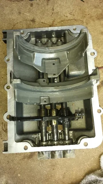

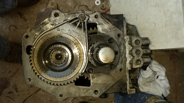

Here's where it stands as of now. The transmission is separated from the adapter and transfer case to be resealed properly. I really hate having a small oil drip marking up the driveway and worse I really hate hearing about it from everyone. I'm going to reuse the oil I have in the transmission since that's a few weeks old, but I can't remember what oil weight to add to the transfer case. I know use the search button and I will. I just need real time recommendation and experience as far as brand, synthetic or not and so on.
On a separate note, I decided to have my buddy fab up a second shift lever for the 4WD. I truly want this to just be a mechanical rig with minimum electrical and vacuum accessories (exception is off course the winch and lights). However it will be a few months down the line. Trying to justify the current mods right at Christmas time and trying to avoid buying expensive gifts for others is a tricky thing.

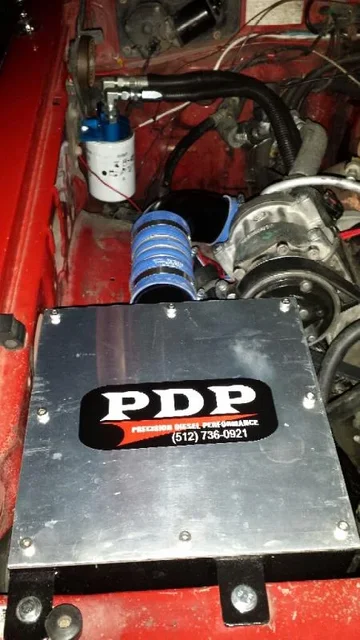

Here's a picture of how the engine bay looks right now.

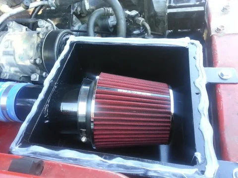

The only thing left to do was put a bead of silicone to really make it air tight. I also plan on replacing those blue couplings with something heavier duty. I fear they might collapse under vacuum.
