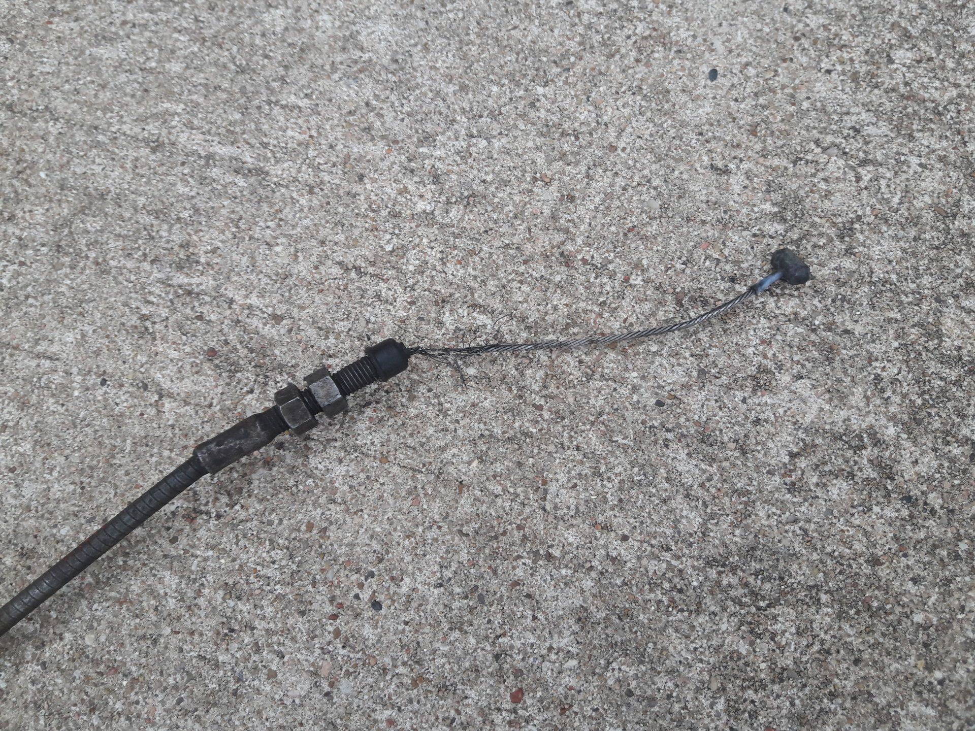

@The Phoenician The 3FE FJ80 cable is virtually the same and works fine. Get one! There’s a thread on here with the Pioneer part number.
Accelerator Cable PIONEER CA-9013 fits 90-92 Toyota Land Cruiser | eBay
@cruisermatt , thanks for the heads up on this. I ordered one and will keep the other as a spare if the bike shop manages to fix it.
I love this community.
Yeah, I needed a new one for my conversion and was looking at making one of the Lokar or other Toyota cables work but the 62/80 pedal connection is pretty unique and I decided it just wasn't worth my time to make something else work.
Some people have complained about the Pioneer cable not lasting as long as the Toyota one. I have the FZJ80 version (CA-9015) on my 1HZ/FJ60 conversion and it is working great. Pretty good bang for the buck.
Installed the new accelerator cable. Had to do minor filling to get it to seat correctly. Let's see how she does on my way to San Antonio .
Nice to see you got that fixed before going out of town and having that cable break. Regular inspections are a great way to prevent future breakdowns, especially when something is visibly wrong.

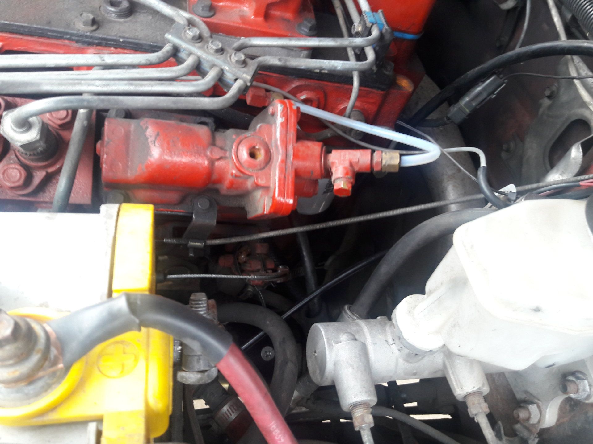

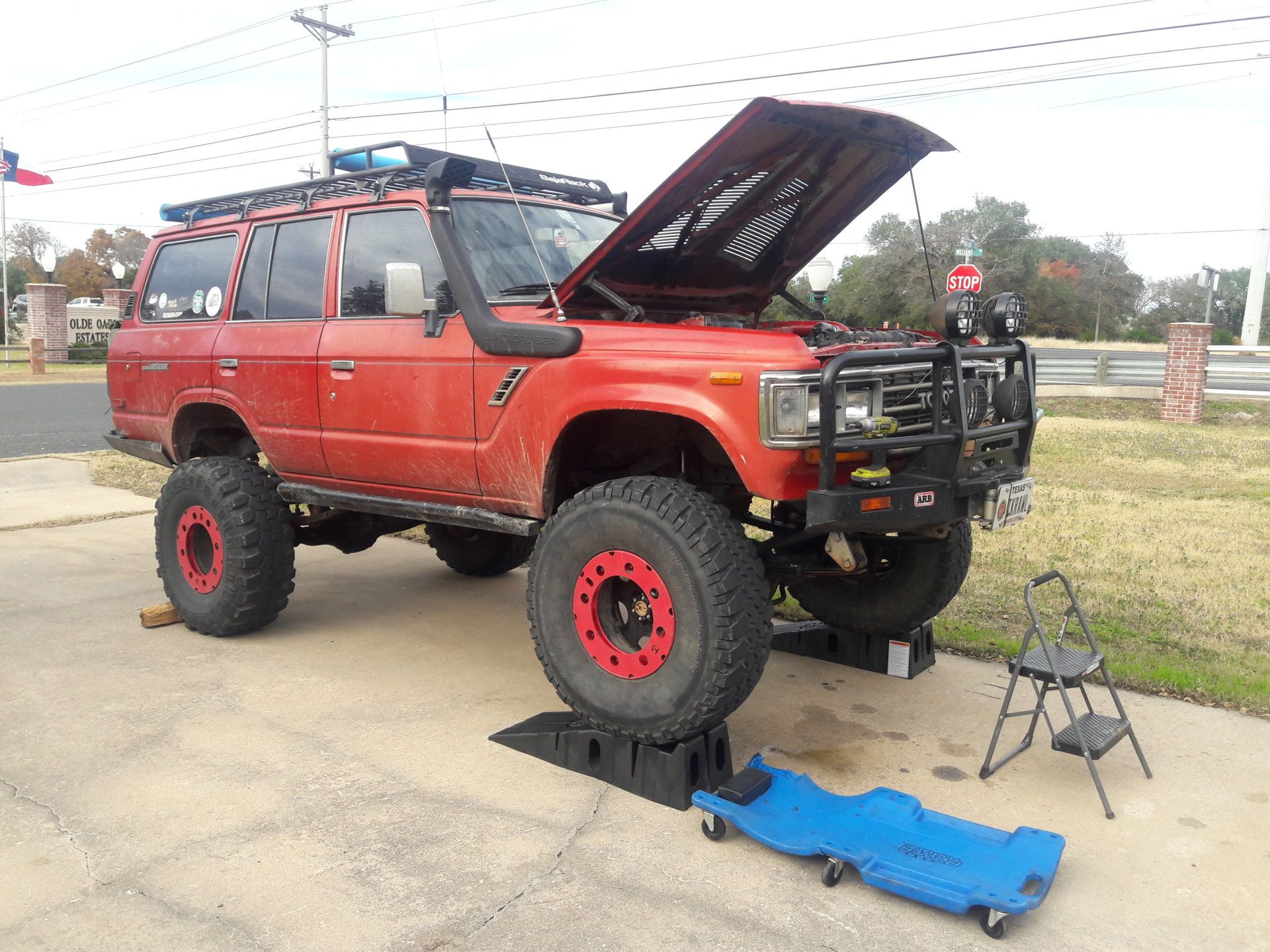

Decided to burp the system and tighten up some bolts and check on that oil leak.

Are those ramps really needed? lol.
I figured I'd use any advantage I had to get the air out of the cooling system. They do make it a lot easier to work under the truck though.
