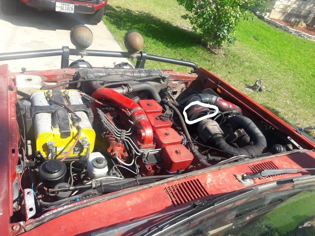

While driving this with the hood off, I noticed a leak in the small turbo where the clamp goes. It only happens when I gun it, not really a huge deal but it is dirtying up the engine bay and kinda annoying. Any suggestions on how to seal it?
Replace the turbine oil seal
