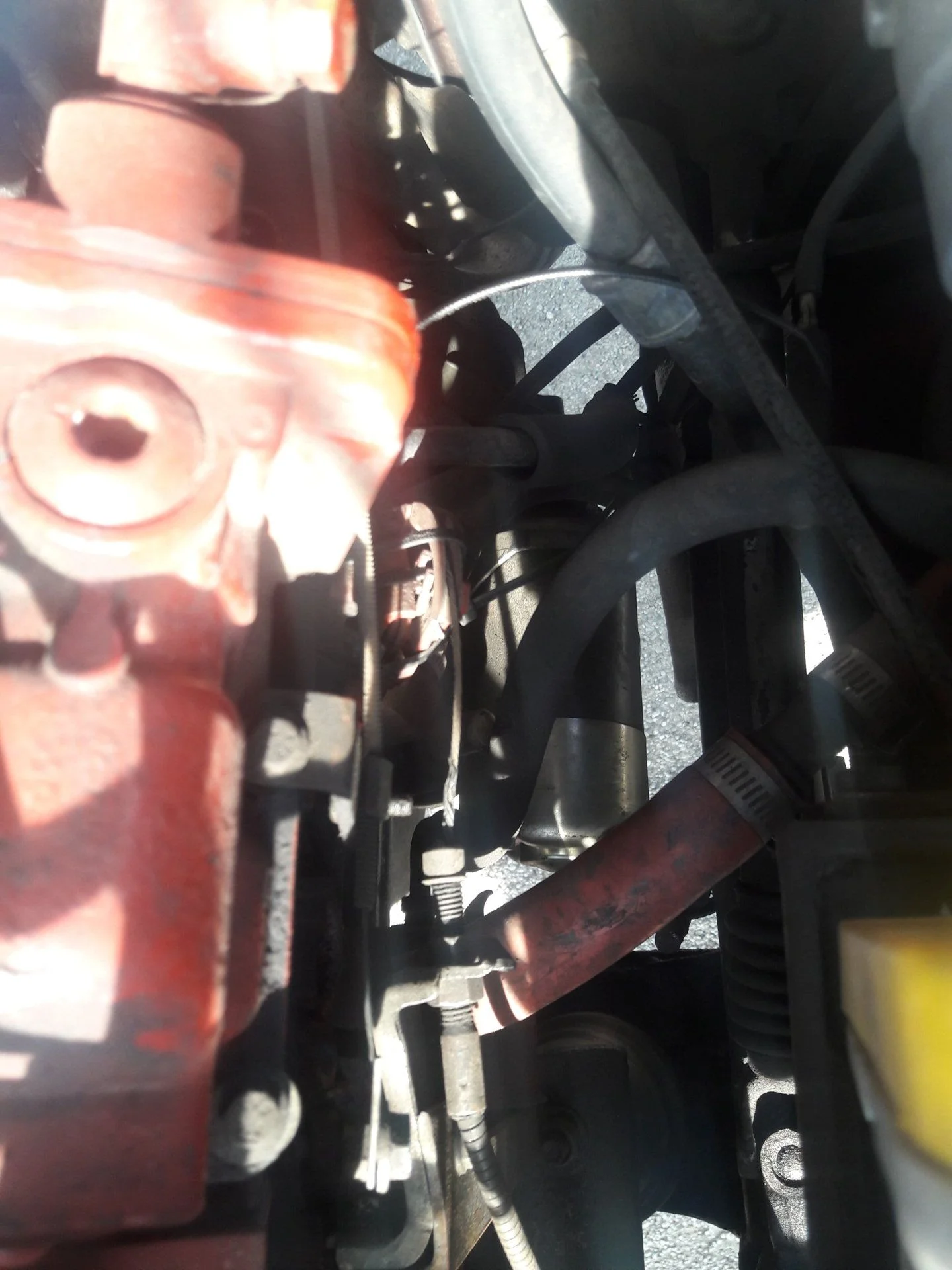

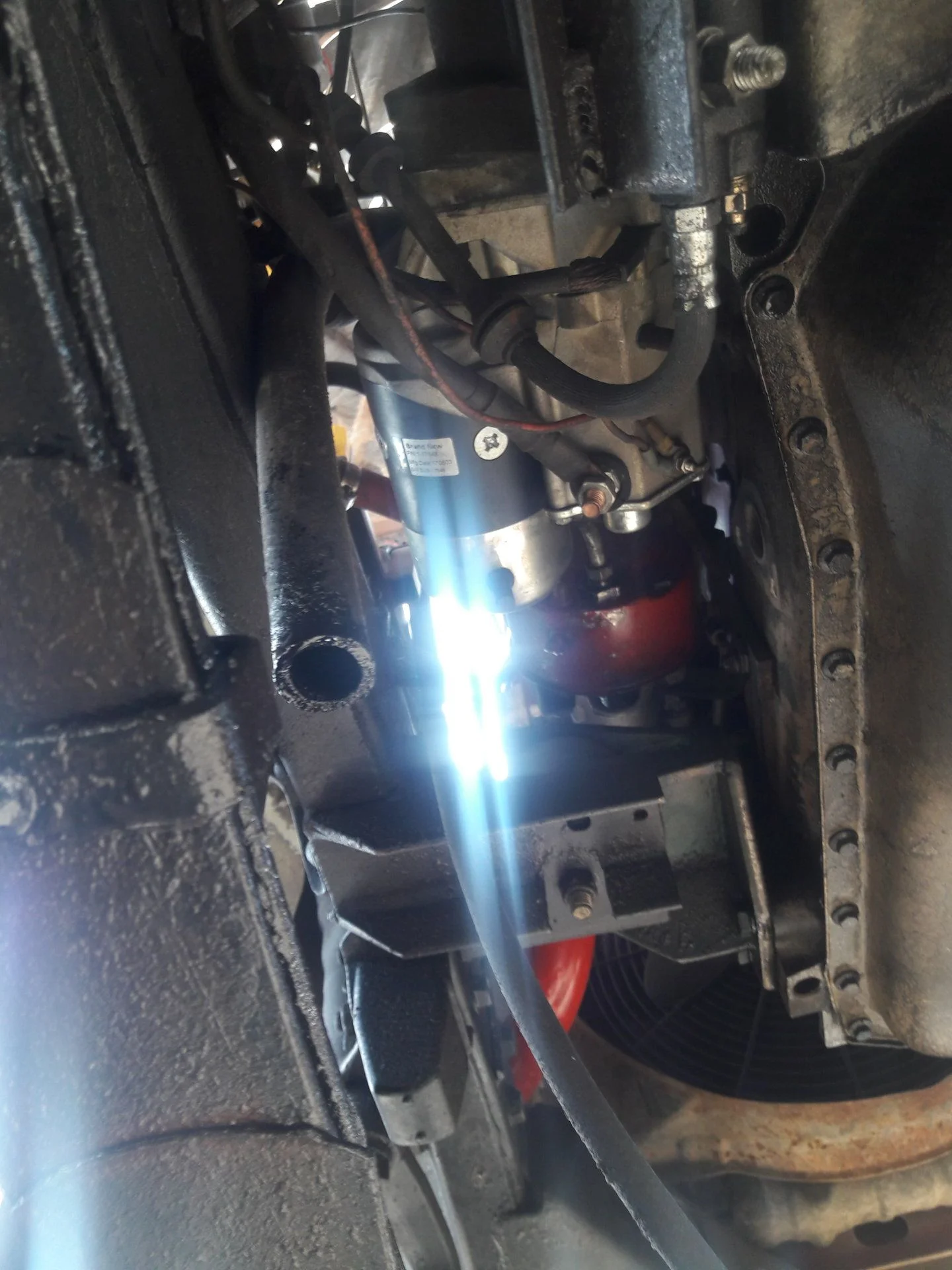

Let me know if you need better pics. Had to snap them quickly. I can't see any leaks from the head gasket

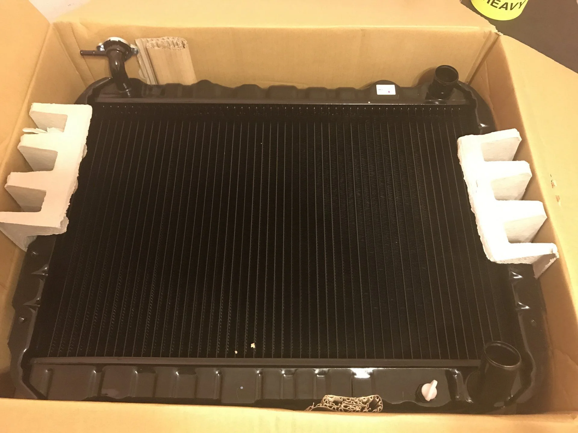

OEM T.Rad HJ61 radiator is still available in the US market.
See your dealer: 16400-68160 About $400 bones.
Or an HJ61 radiator. These don't have the automatic tranny cooling lines that are needed on US spec 62's. Toyota radiators also come with the radiator cap.

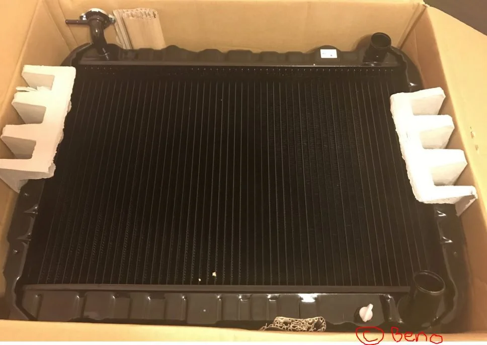

Mike, is your radiator the stock 62 one or did you swap a new one in a while ago?
Some options:
Thanks Dave. I swapped a new one in a few years back, looks identical to the picture. It's a shame to replace it so soon.
If you go the Champion route they will accept the Toyota rad cap. I'm sure they have a bigger one than stock.
