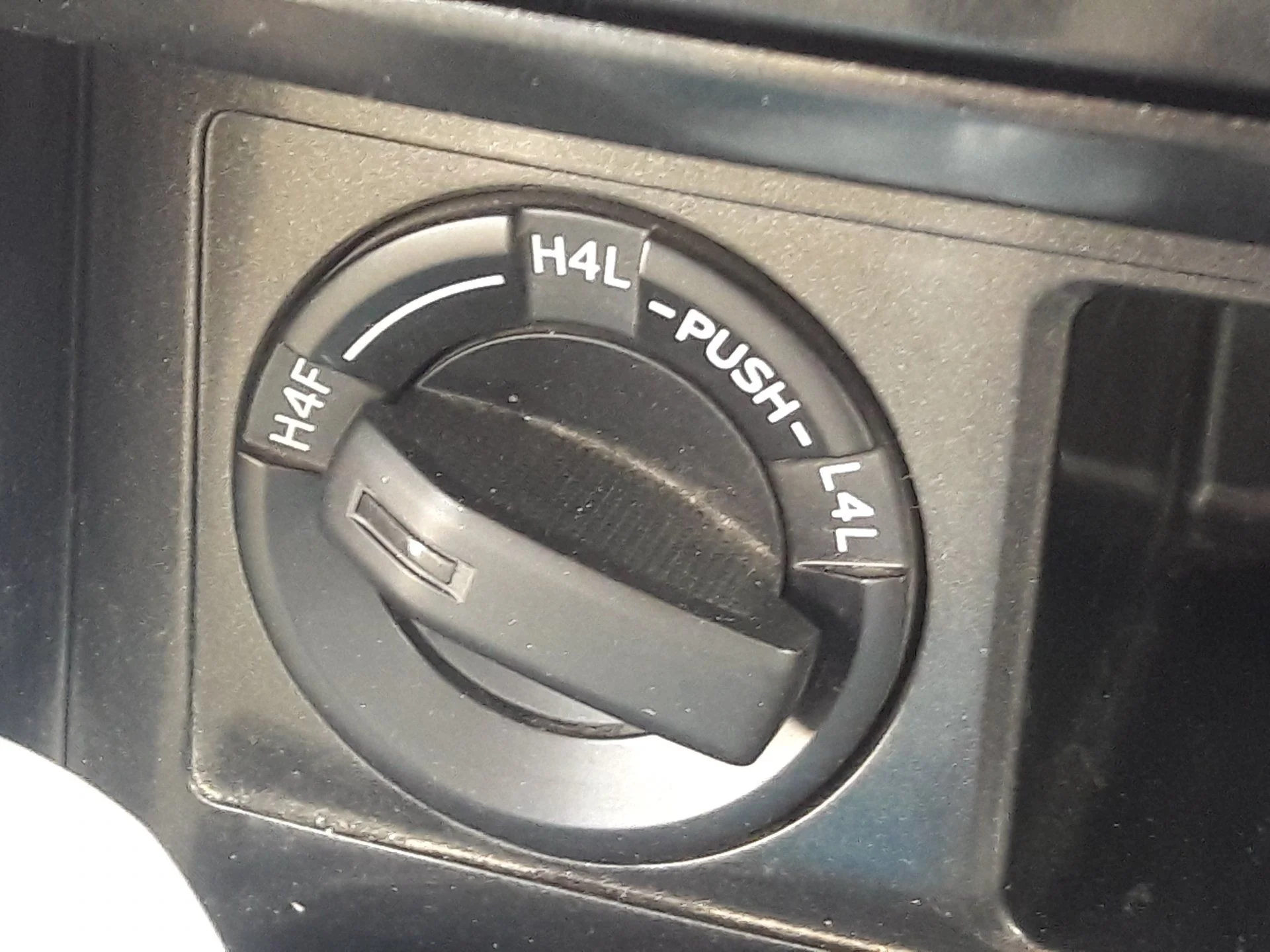

Today I drove around in a Prado and saw this little selector knob. Anyone know the difference in the settings?
From this thread: Limited's Full-Time 4WD Like AWD? - Toyota 4Runner Forum - Largest 4Runner Forum
H4F = High gear "free" (unlocked) --> I call it "F"reeway mode.
H4L = Locked but high gear. This will drag a tire when making a tight turn and should only be used in required conditions and not as an 'always on" mode.
L4L = Low gear & locked (you have to be in neutral and press the button to switch to this mode or out of it). This is the low gear mode you will use when on off road trails or other road conditions that require high torque but low speed and again minimal tight turns.
Thanks Dave. You probably just saved the transfer case of that (and other) land cruisers. I think Toyota owns the Middle East. I did see a few G wagens though.

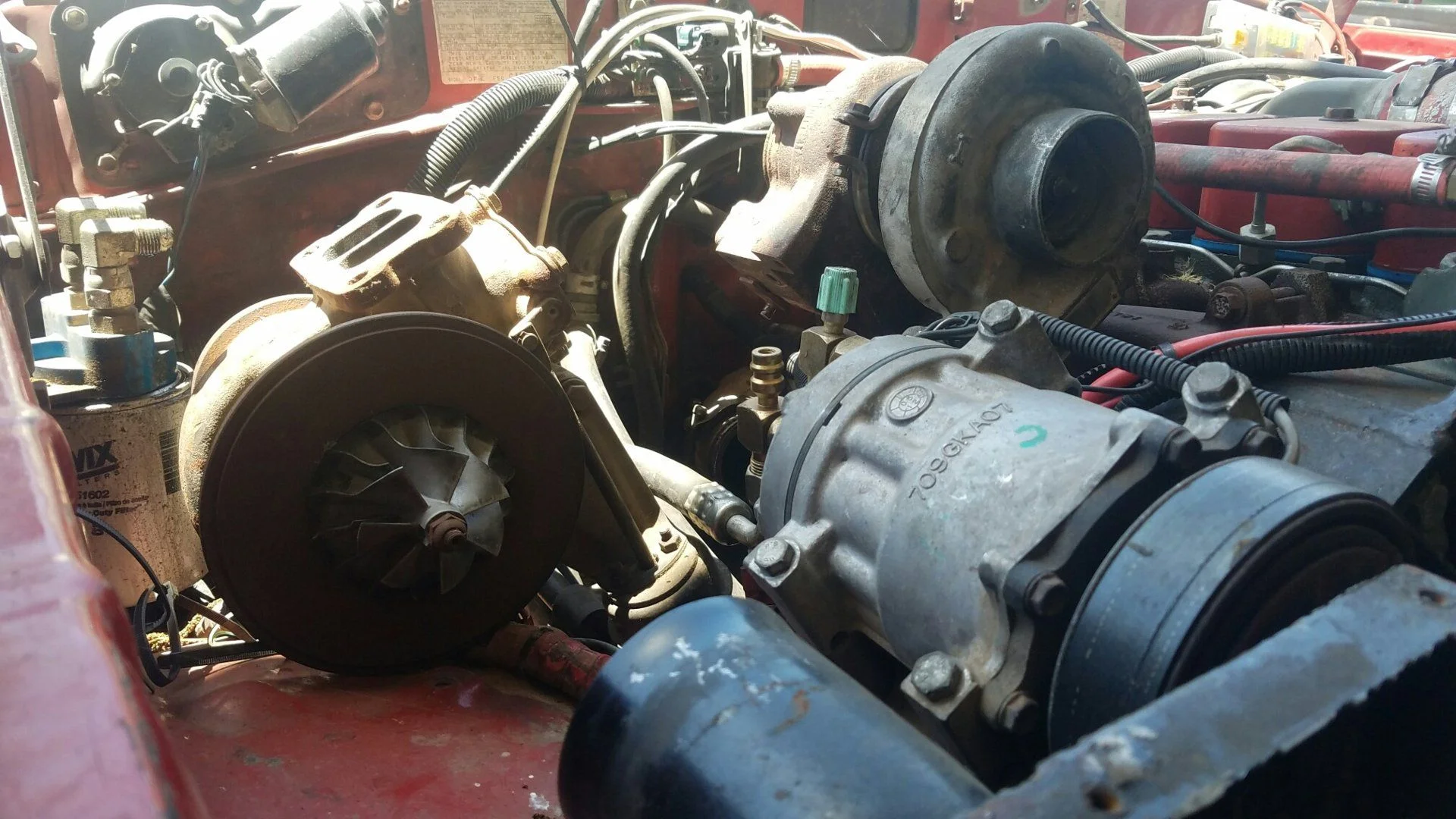

Does anyone know what turbo would work better for a compound set up with 3.73 gearing. I have the stock hx30 and can't figure out which is better a 62/14 or 62/12 for the larger turbo. Anyone have any idea?
62/14 and 62/12, is that inducer size/turbine housing cm2? Not familiar with that sizing method.
62 is inducer on the compressor and 12 or 14 is the exhaust housing size. I'd say go with the 14, and that would be the smallest I'd run especially since you've got an inline pump and have more fueling potential. I've run a bunch of different sizes (advantage of using a variable vane turbo for my primary/atmosphere) and am currently in the 16cm range now (so in your language a 60/16) and playing at 55psi.

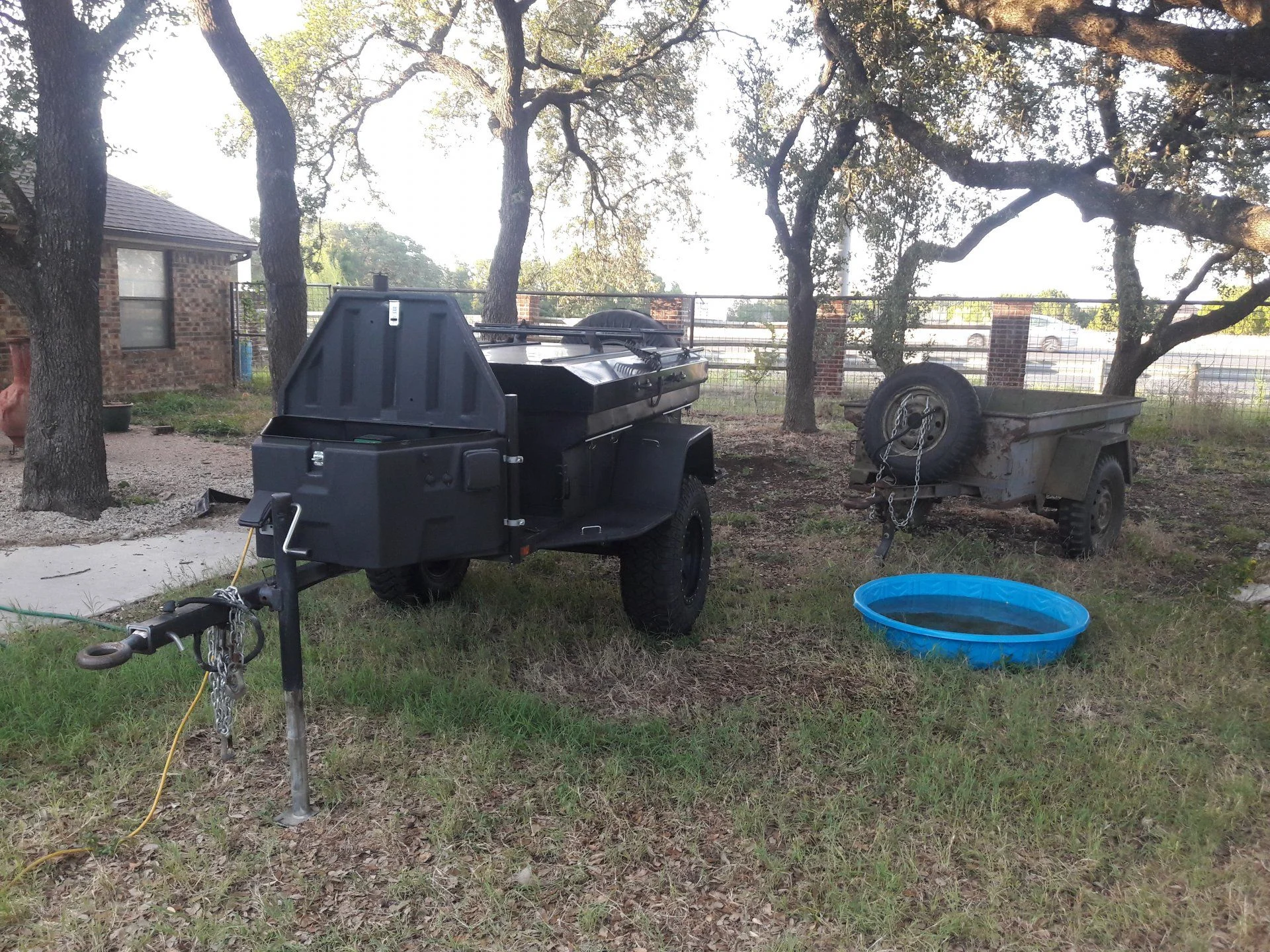

I want to say thanks to @copperhead37 for selling me his awesome off-road trailer and being patient with me while i figured out the logistics of getting it to Texas from Florida while I'm overseas.
Anyway here are some awesome pics.
I guess it's time for an update. Big Red is still getting the second turbo installed. Probably be done sometime in October. Need to get studs installed and a new gasket along with new intercooler piping. The guy working on it is doing me a favor so I can't really rush him.
