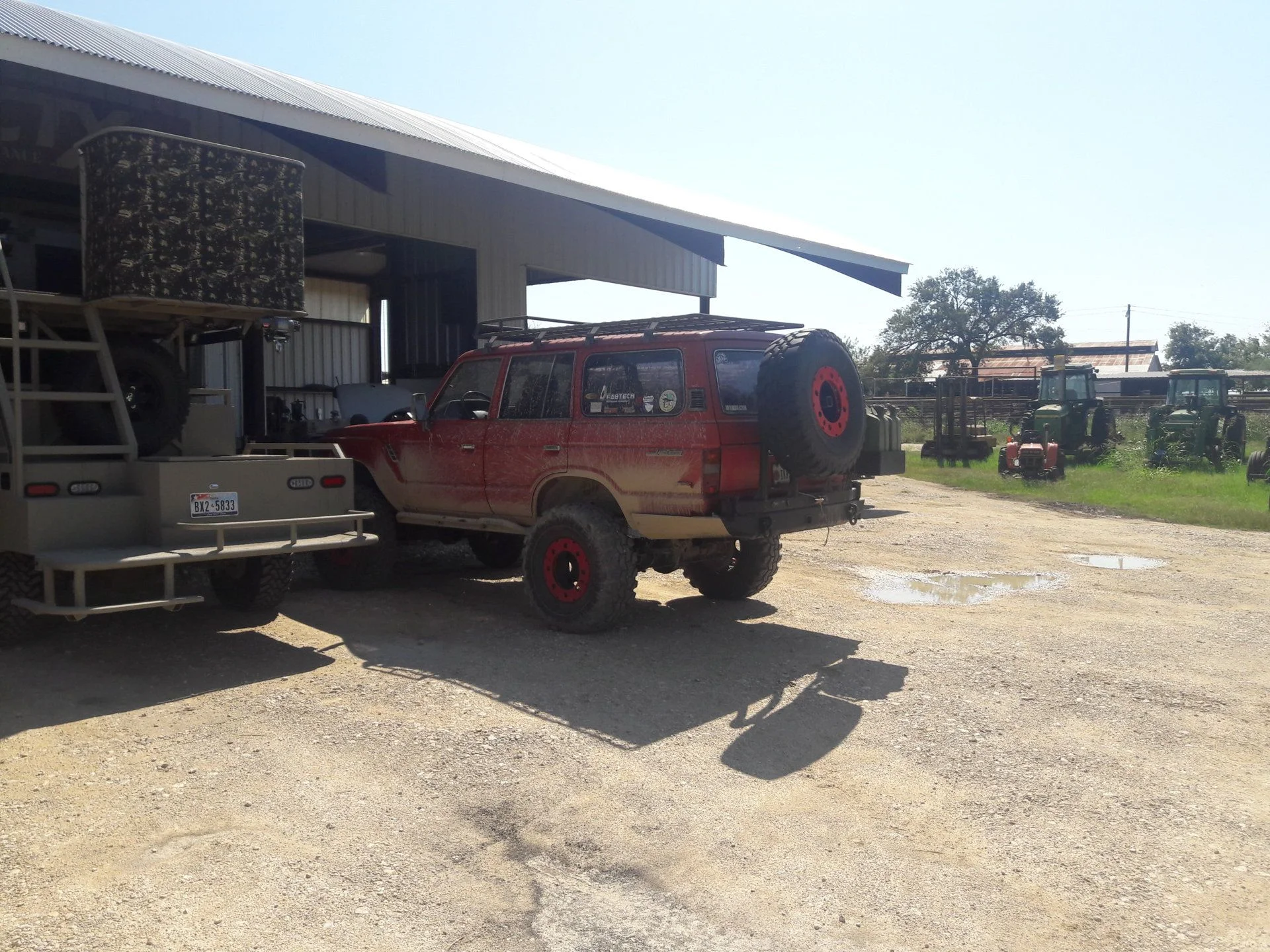

Drove it for the first time since the compound install. I'm very pleased with the acceleration and power, but I'm still stuck with the high EGT issues. This is a preliminary test run, and I didn't drive it hard because we still haven't installed the studs. I had a guy hold the camera while I took it to the field to try it out. Not the best video, but good enough for government work.
On the way back I blew out a boot, it sounded like a tire was punctured. Right now I'm thinking of advancing the timing, keeping stock injectors but putting in better delivery valves for the pump. This will be a long trial and error process.

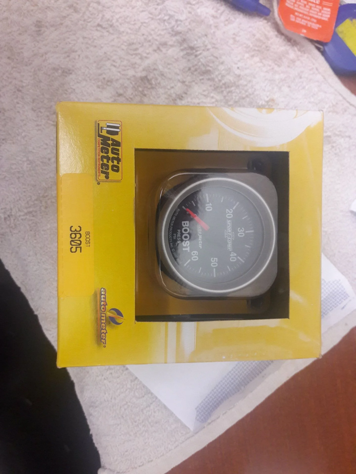

The center-right gauge is boost, it hits 30psi no issues, the center-left is the PYRO, it can go to 1400 degree is a second or two.

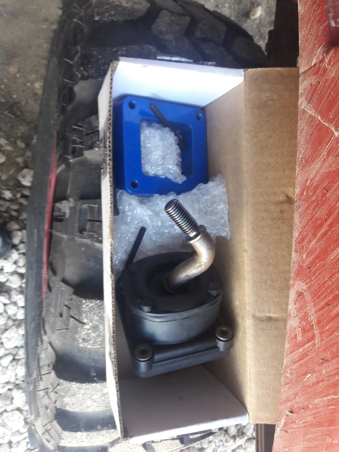

Forgot to add these. The short shifter goes in this week, but might take it back out if i don't like the feel of it.

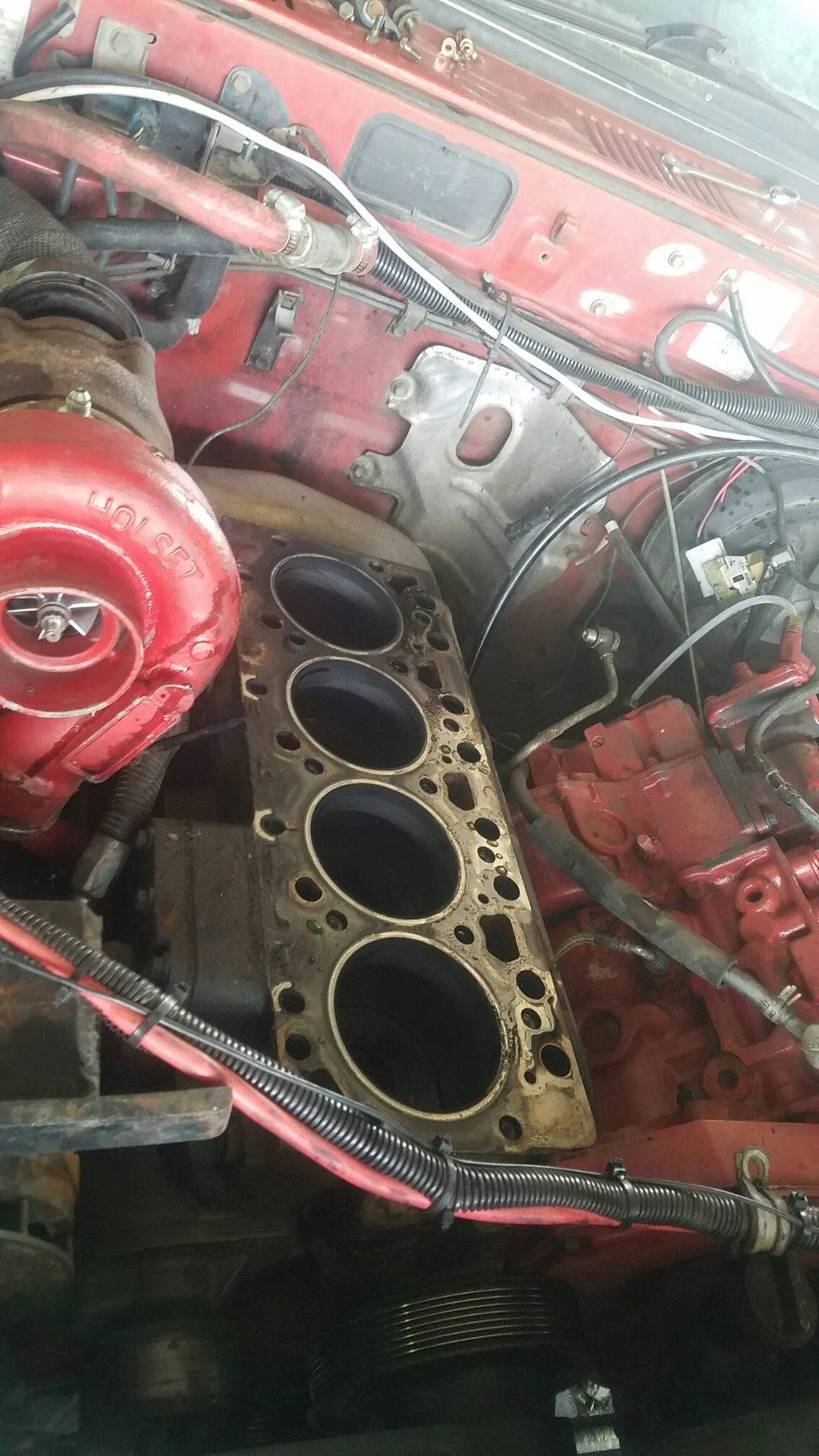

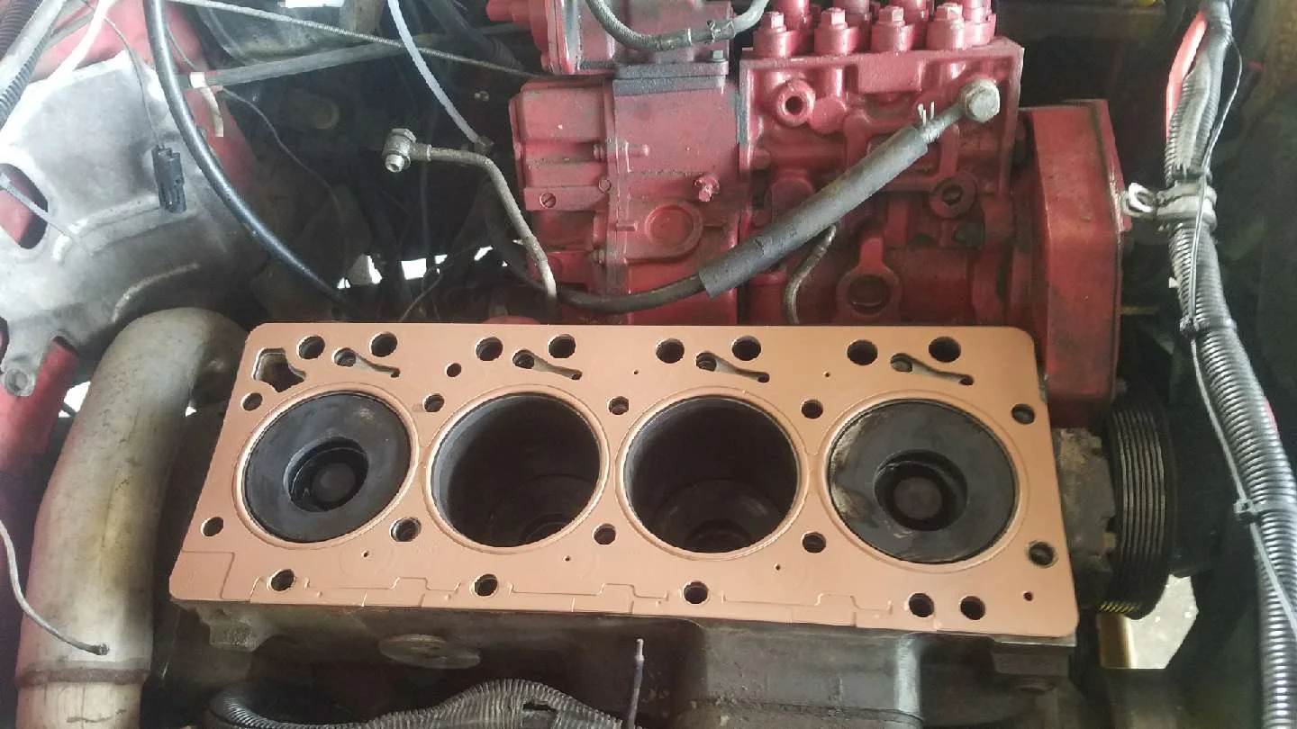

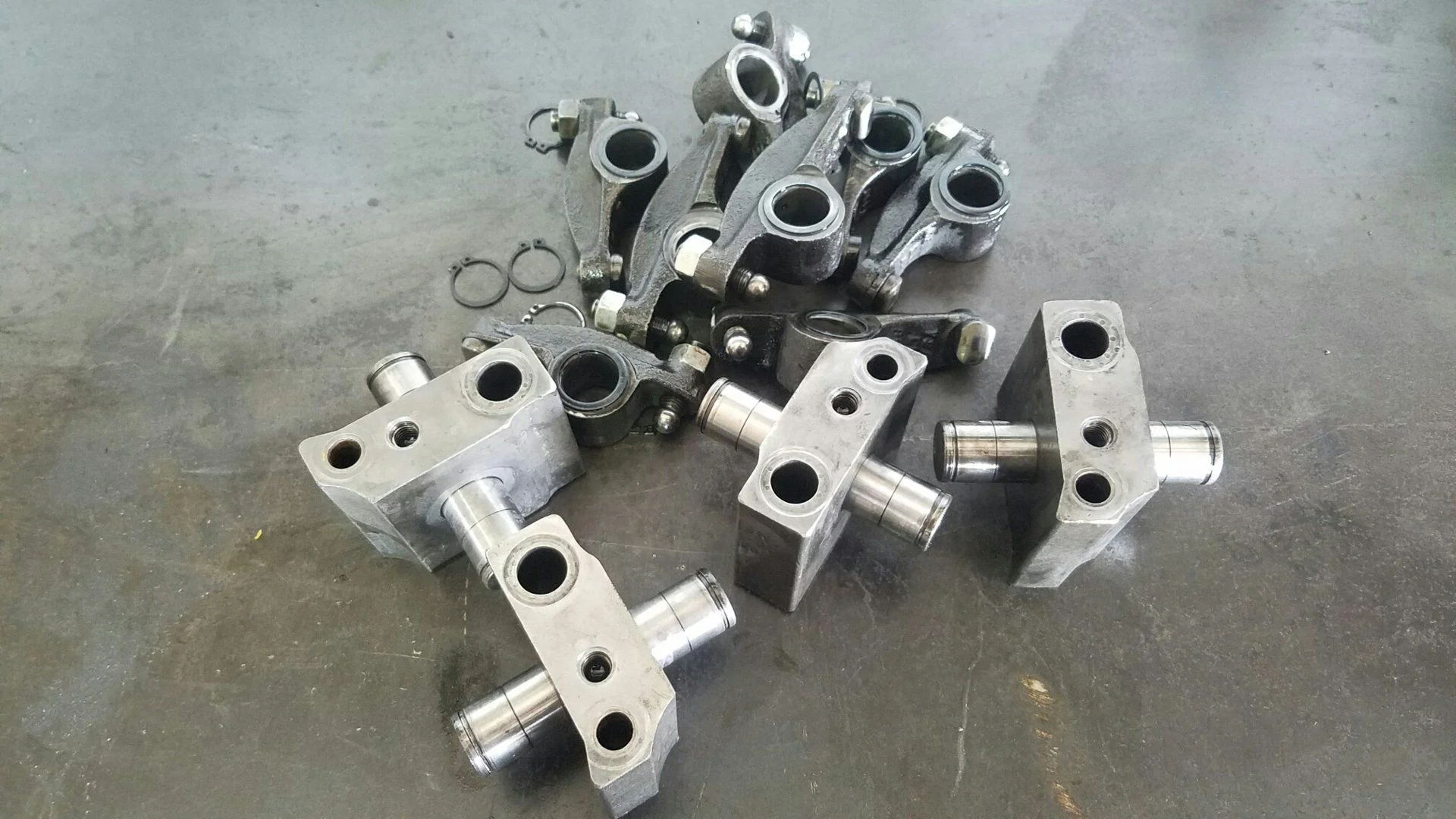

Yes, i figured might as well do a head gasket. Going to deck the head and reinstall it with studs.
Then it's just playing with the pump and timing until i find that happy medium without melting anything.
How heavy was that head? Did you muscle it off yourself?
No, this is beyond my skill set. It's at a buddy's shop. He's doing the actual work. I occasionally show up to micro manage, take pics and pretend i know what I'm talking about.
I “helped” do my first head gasket last week on our forklift at work. The Toyota 4Y alluminum head was so light you could hold with one hand.
I've taken my head off a couple of times, only the weight lifter with a young back would be able to muscle it off without hurting themselves. I've found that hooking it up to a engine hoist is the easiest, especially when putting it back on the block. You can go slow and give yourself plenty of time to align things going down. Studs make it easy to get it on right.

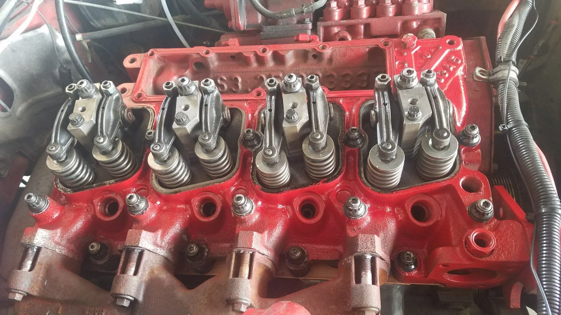

More porn pics. Aiming for this Friday, in time for Octoberfest in Fredericksburg.
