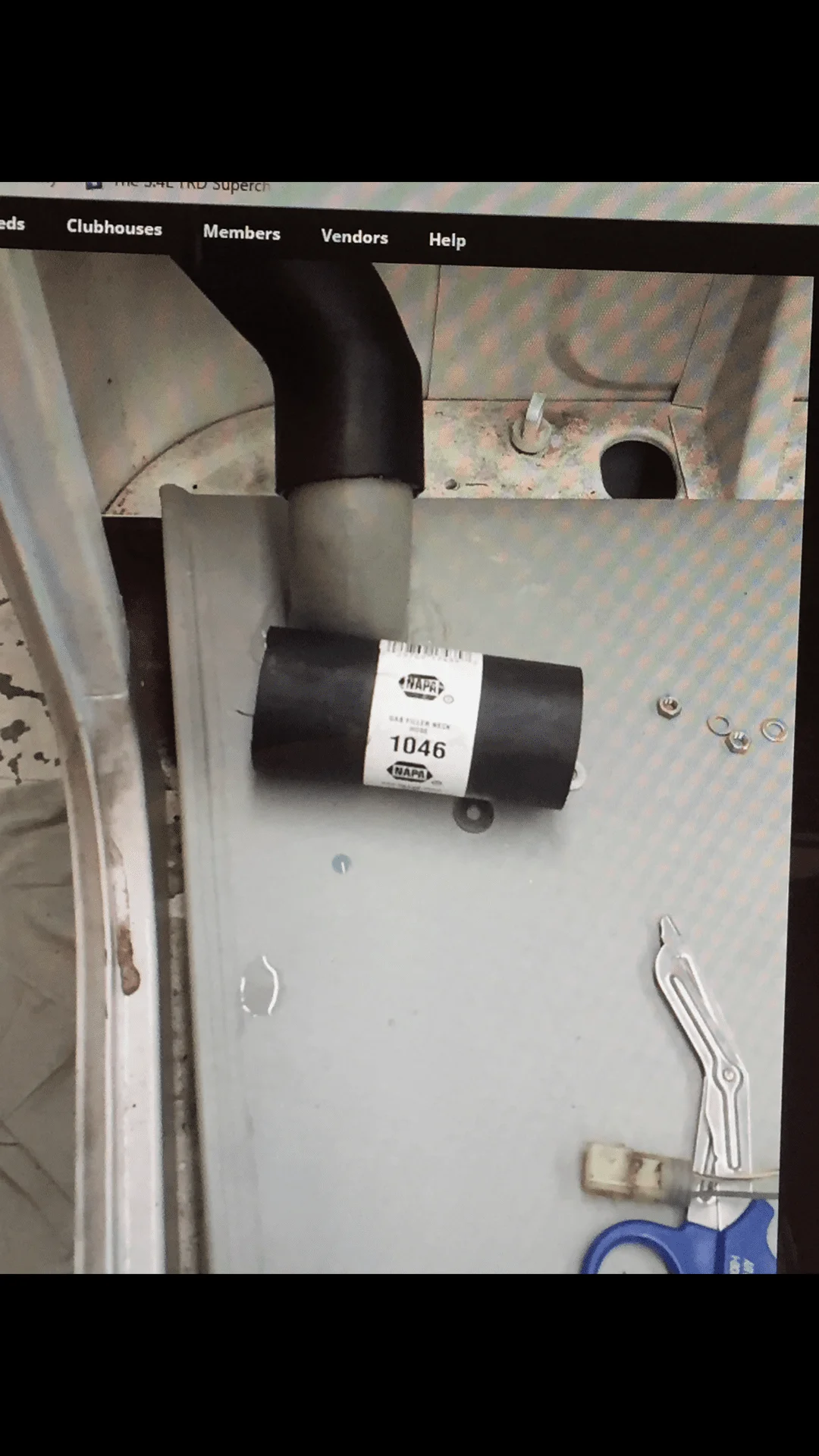

Here is a NAPA hose number that should work for the filler neck. Obviously you will have to trim it. Good luck!

I knew that picture would be handy
no worries! I took that picture just for such a need.. PN was easily visible and scissors sitting there. THat little hose was about $25 or more i believe.. Wasn't cheap but exactly what was needed. Nothing in this hobby is cheap.
