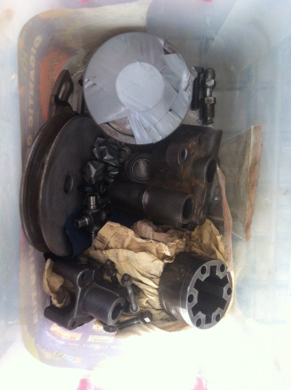

But I have had a chance in recent days to get some things done! My current job affords me access to a cabinet blaster which is making life easier!
Once blasted I put my lawn ornament 80 to good use. I have plenty more things to run through the cabinet over the next few days.

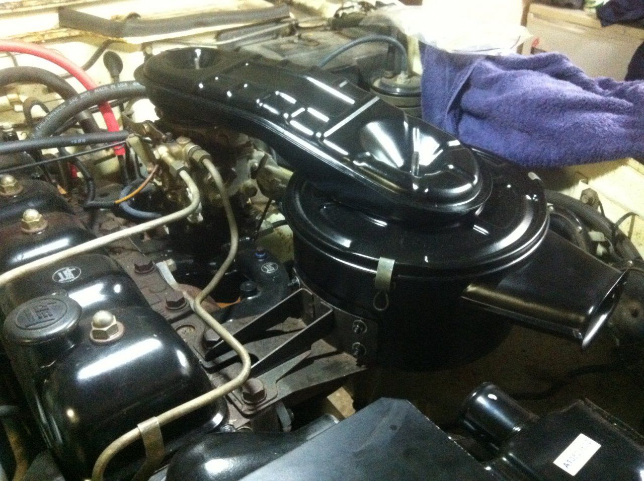

Air cleaner painted and reassembled.

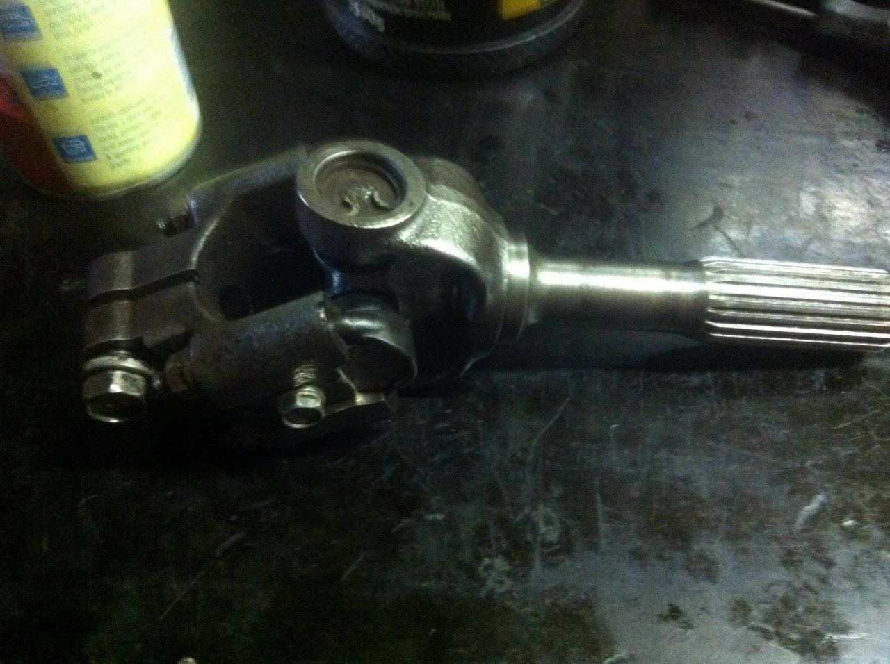

Steering shaft stripped, cleaned and re-greased. Waiting on the other half to be done then off to be painted.

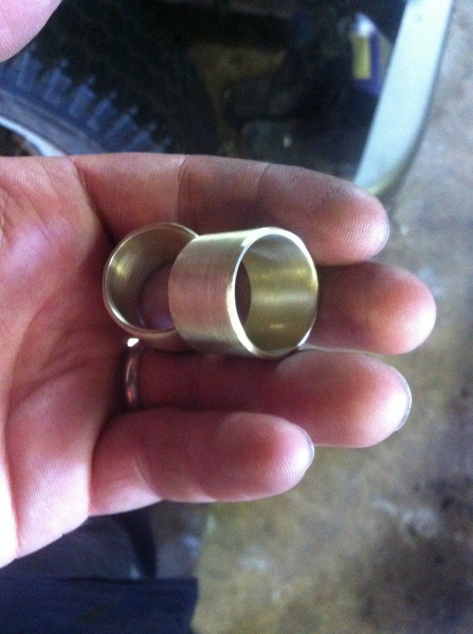

My other idea was to press out the old bushes and refit them in another orientation so an unworn section of them is taking the load. Or machining up some new bronze bushes, I have access to a machine shop with work at the moment.

I finished rebuilding the steering shaft this arvo after installing a new interior into my 80. Small steps, but I'm slowly getting through the list.
I got busy and busted out some bearings on a lathe at work, just plain brass so it will be interesting to see how well they wear. Pump is rebuilt and painted now, but I will strip it down after a short run and check how well the bearings are going.

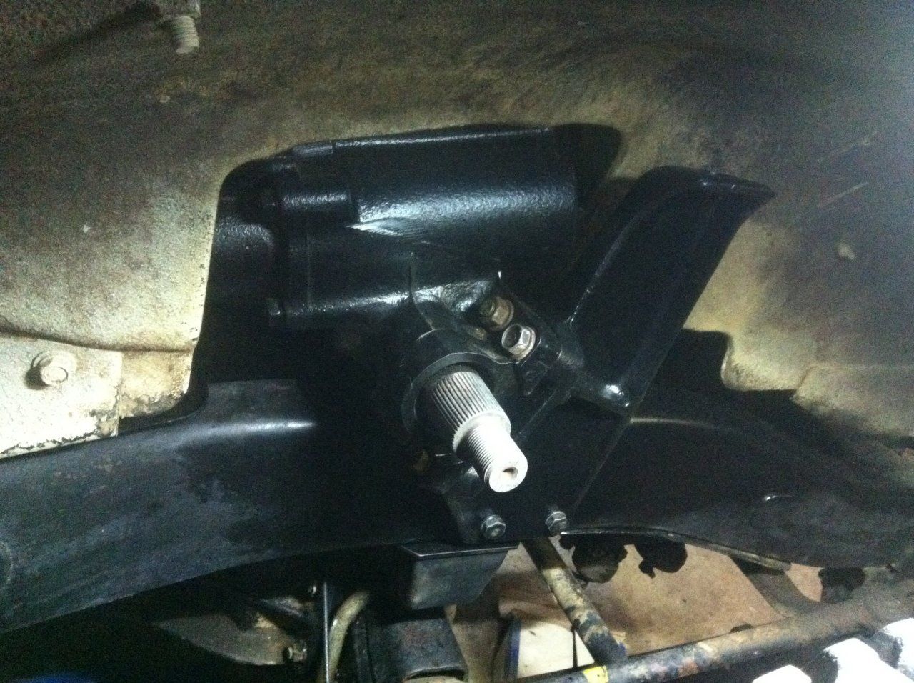

The steering shaft between the box and the firewall is too long. I didn't realise that the power steering box uses a shorter shaft and in my haste at the wreckers I only grabbed the female section of the shaft. My solution is to use the shorter power steering box female section and cut 15mm off the male non power end which will shorten the whole shaft by around 25mm. After that I should be able to just sneak it in!

Let me know how these work! Did you create front and rear bushings? Are they the same length? How did you deal with the plug on the back of the pump - re-use the one that was in there, or replace? I assume you had to press it out to get the rear bushing out...
Yeah I made front and rear, I didn't exactly replicate the OEM bushes, they have helical oil grooves in them which would have been too time consuming for me to machine. Both of the bushes are the exact same dimensions as the old ones. The welsh plug on the back of the pump is easy to tap out with a drift. It has an o-ring that provides the seal, the seal kit I bought came with a replacement, you just gotta make sure the plug goes back in the correct orientation.
