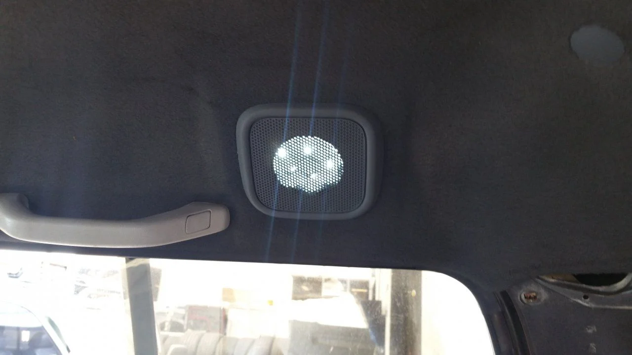

I mounted an extra dome light there in the hatch and added an led. I grabbed power from second row dome following a post i searched out on here. Been there for 6-7 years no problem. Ill look but pretty certain ive sold all my extra domes to others doing the same.

I used an extra dome light as well. The handle on the hatch is offset so I mounted the dome light close to center. I used a brighter warm white LED panel since we use the tail gate quite a bit for cooking, prep, and setup. The LED is wired into the 2nd row dome light and can function either independent or switch on/off with the opening closing of the doors. I would like a lower powered switched red light option. I have power in the hatch. Adding a switch and LED's shouldn't be too difficult.

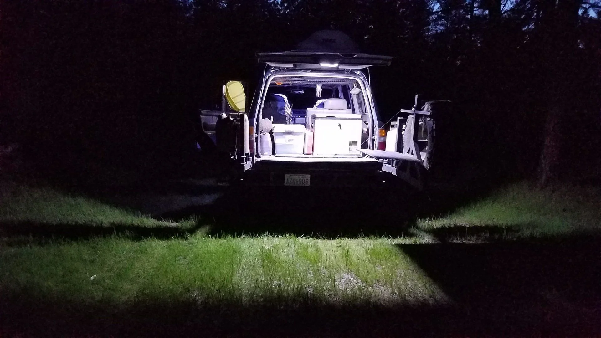

I mounted one of these: https://www.amazon.com/gp/product/B00C1YI2XA/?tag=ihco-20 on the hatch near the latch and added a small switch inside the handle area. Tons of light.

I have a 93 so I pulled back the headliner a bit and found the factor harness bunched up by the DS D pillar. Harness connected directly into another 80 dome lamp that I flush mounted into the hatch. Great mod!

I have same but does not seem as bright as your pic? I have them under the doors as well as puddle lights.

Yes and makes it super easy to find your Land Cruiser when gathered with the masses of LC's.
