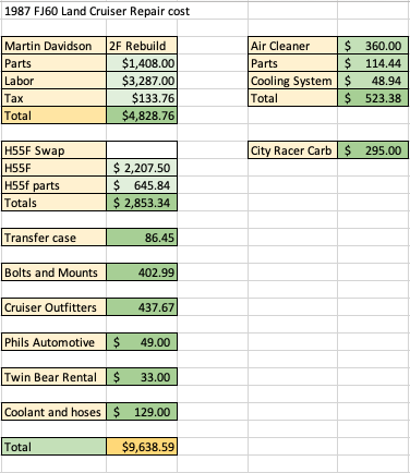

I mean I can go on and on about pros and cons. I was keeping track of the main cost of the swap. But there is a lot of stuff that kept adding on after everything was back in place, not to mention tools and days of work that I didn't keep track of but kinda wish I would of just for the data. What you see is my cost, I got a deal on the h55F. But this was my cost doing all of the work myself and I am sure there is probably another 2k in parts, fluids, and cost that are not included in this spreadsheet.
You can do it cheaper maybe, but I felt like I did it the right way using all OEM Toyota parts.
12k and a lot of work and waiting time.

Much appreciated!I mean I can go on and on about pros and cons. I was keeping track of the main cost of the swap. But there is a lot of stuff that kept adding on after everything was back in place, not to mention tools and days of work that I didn't keep track of but kinda wish I would of just for the data. What you see is my cost, I got a deal on the h55F. But this was my cost doing all of the work myself and I am sure there is probably another 2k in parts, fluids, and cost that are not included in this spreadsheet.
