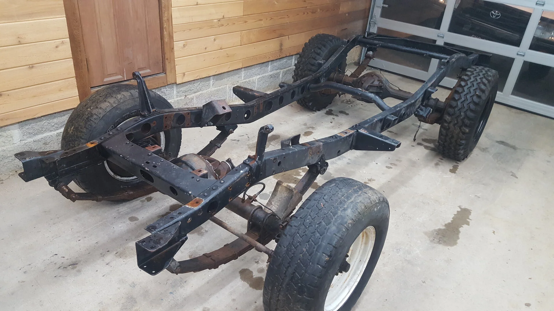

He said many of their restorations they put a new frame under them, and galvanize most of them.

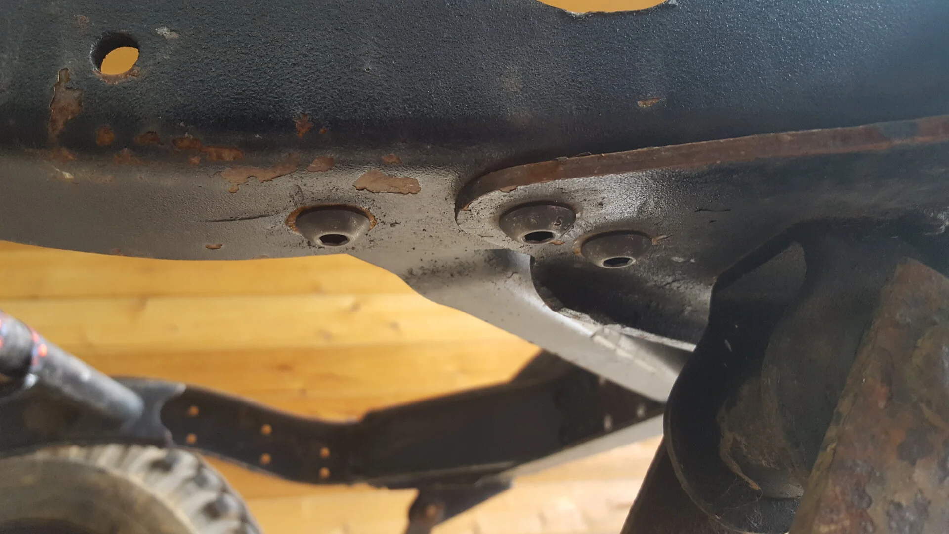

Negative, no way I would want to remove that many rivets. I also don't like removing rivets and replacing them with bolts. Ultimately, I think the rivets are much stronger. I galvanized this frame over a decade ago and it doesn't have a spec of rust on it. I think galvanizing a 40 frame makes it pretty much last a lifetime.
Just curious. Much better option than powdercoat
Yes, no need to split the frame. I didn’t and the end result is great. I painted it later with black epoxy.

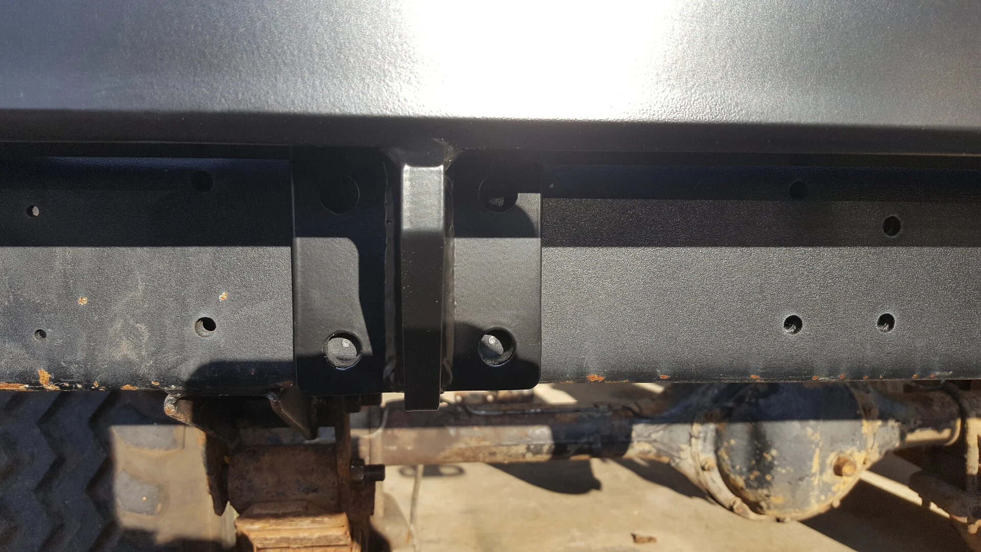

Since this 40 will have an Aqualu tub I didn't want to hang a factory tire carrier off the aluminum body. Last May when I picked up the new frame in Phoenix I met up with Dave and got one of his 4plus swing out tire carriers. I didn't want a cooler basket and opted for a single side carrier only. Last weekend I got it fitted and drilled the four additional holes in the frame. I want to have to do as little as possible to this frame once its galvanized.
Yesterday my hardware came in to replace the 5/16 hardware the rear crossmember was installed with. I used 3/16 button head bolts with prevailing torque flanged nuts. The 3/16 bolts require running a tap through the holes for fitment. There are 7 per side. One of the bolts for the rear frame/spring hanger required clearancing one side of the button head to fit. The previous owner of this frame didn't have a 5/16 bolt in this location because it's such a tight fit.
This one needed the bolt head clearanced.
Once I had them all installed I torqued them down as tight as humanly possible. This is as close to the factory rivets as I could find for hardware. I contemplated actually welding up the hex head and flap disking it smooth so it would look like a rivet from one side. I decided since they will only be visible from underneath the 40 it wasn't really worth the extra effort. With the prevailing torque nuts and once the galvanizing gets on the exposed threads these things aren't going anywhere. Actually good possibility the galvanizing will fill the hex heads.

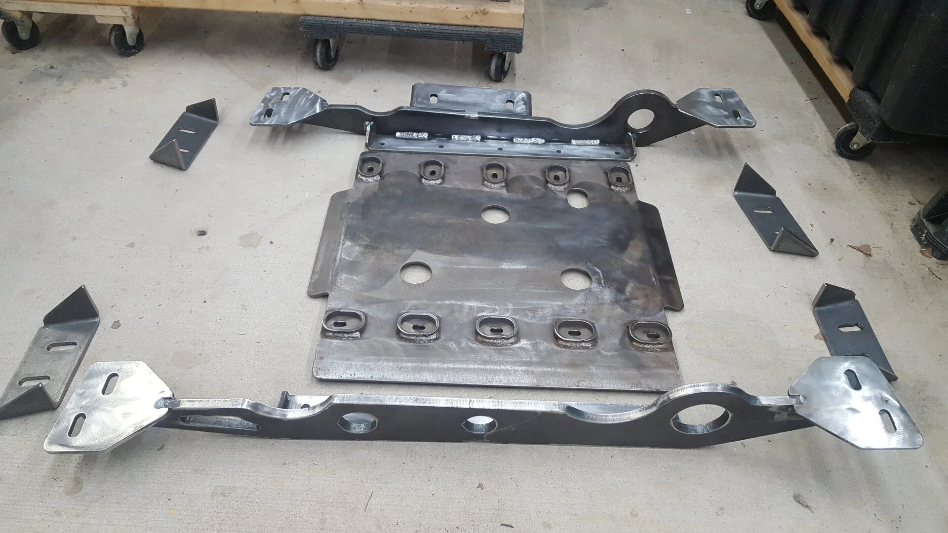

Had a long work trip to Arizona last month so I met up with @lcwizard and camped at PB cabin. Dave made this awesome trans crossmember/skid plate for me so I can finally get this frame finished up and off to the sand blaster. Rolled it back in the garage this evening with the hope of getting it knocked out in the next couple of days
Really interested in the hot dip galvanising the chassis, have heard the chassis could twist from the process?
Any truth behind that and would you need to check the dimensions of the chassis after the process.
