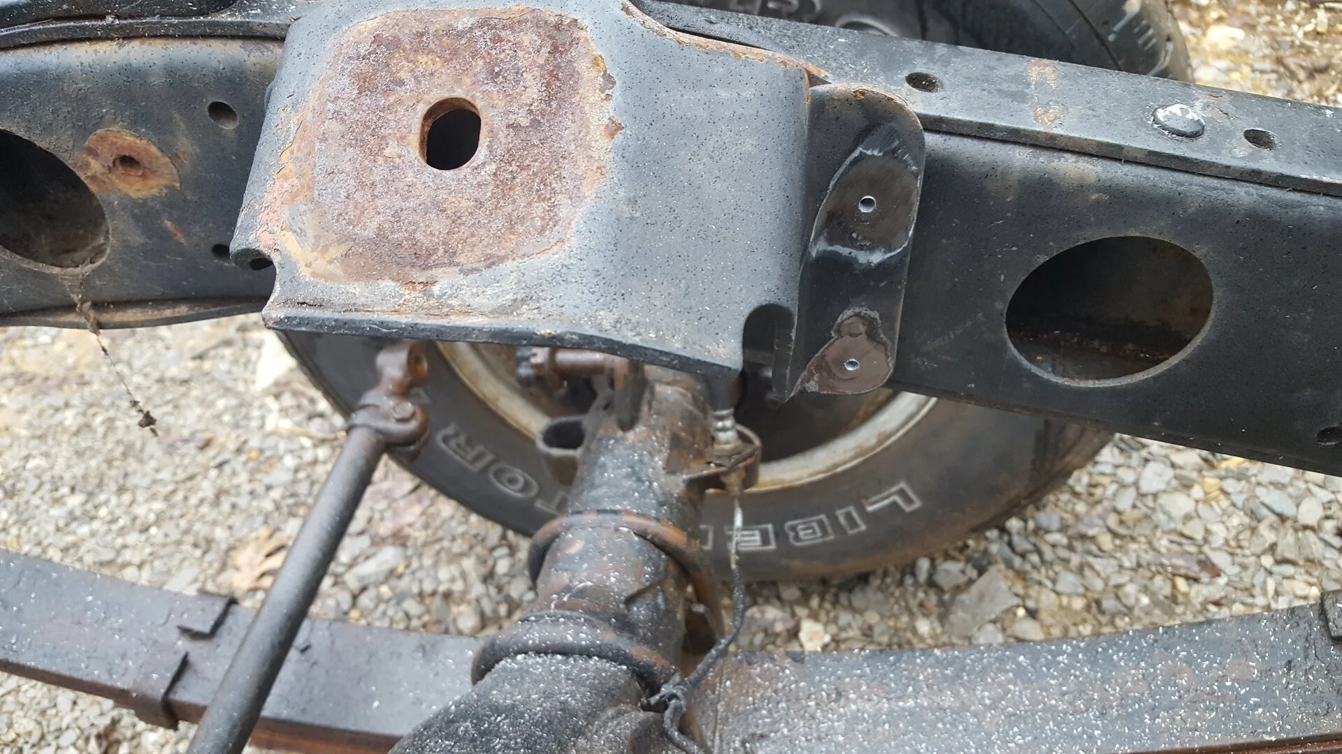

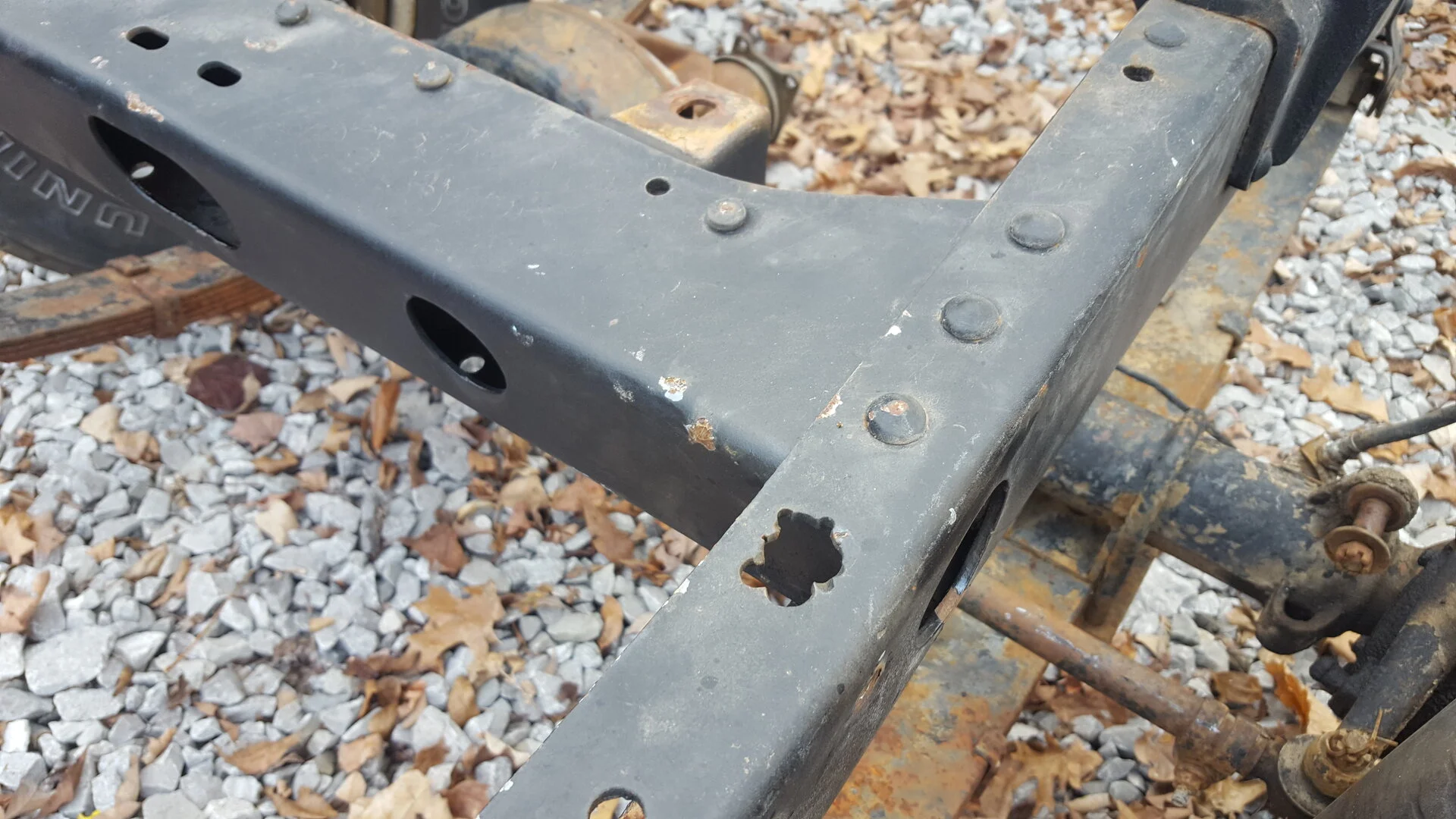

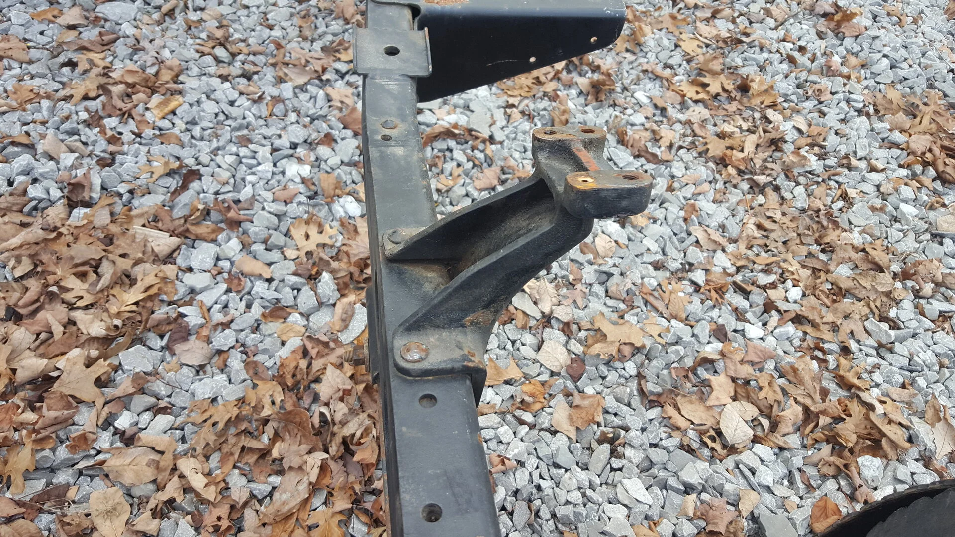

No rust issues with this one. A funky hole, and someone replaced the rear cross member at some point.

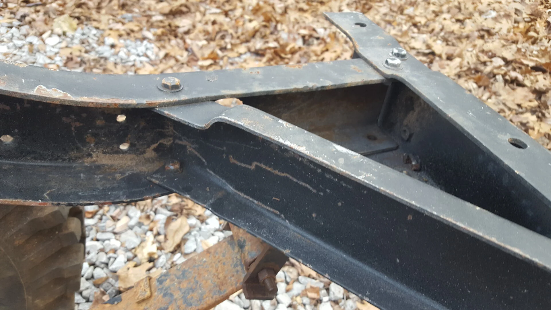

Pretty pleased that instead of removing the rear most rivets the previous owner removed the entire diagonals, which made for a much cleaner installation. I hate seeing bolt heads on the rear cross members between the bumperettes.

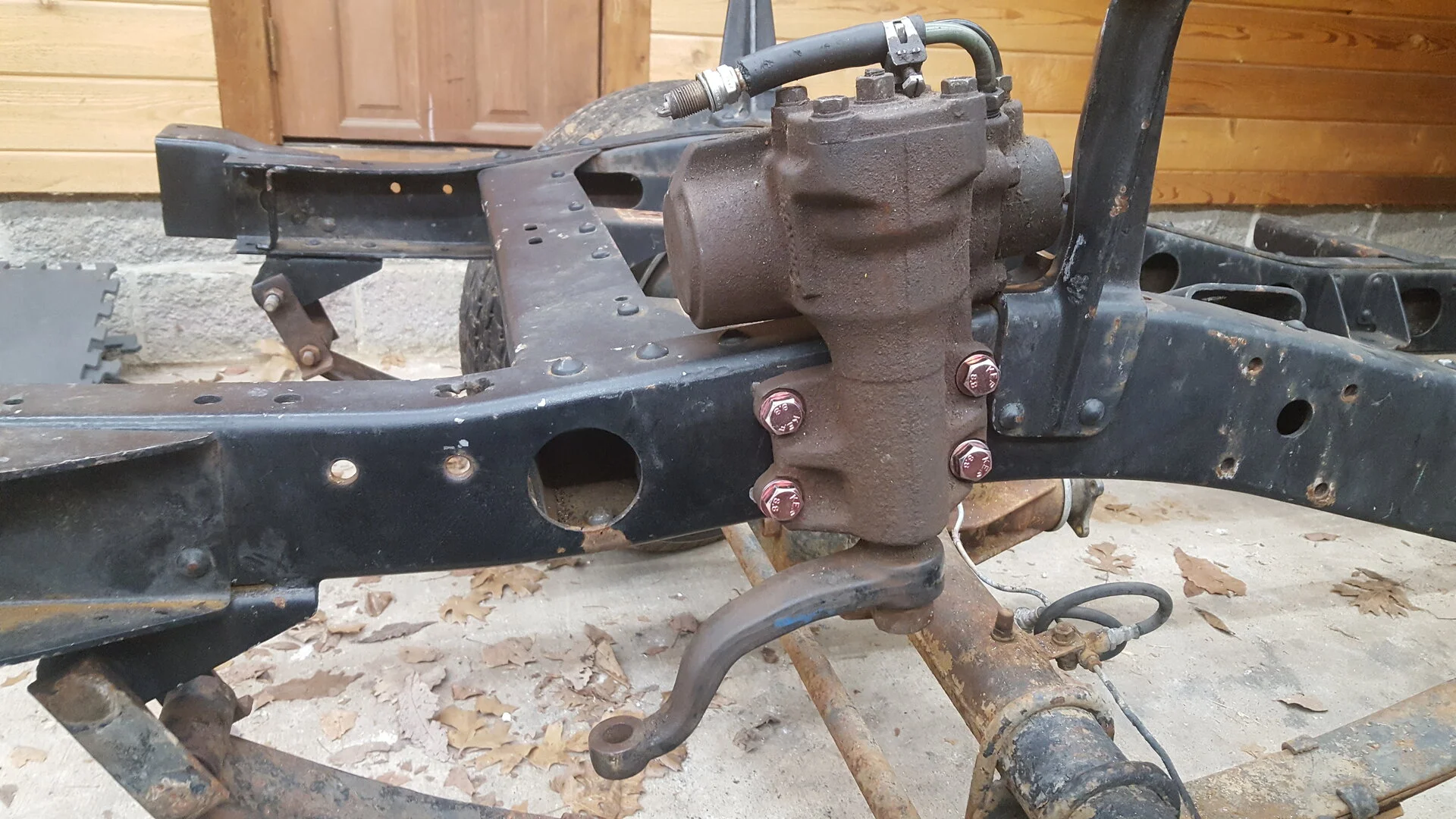

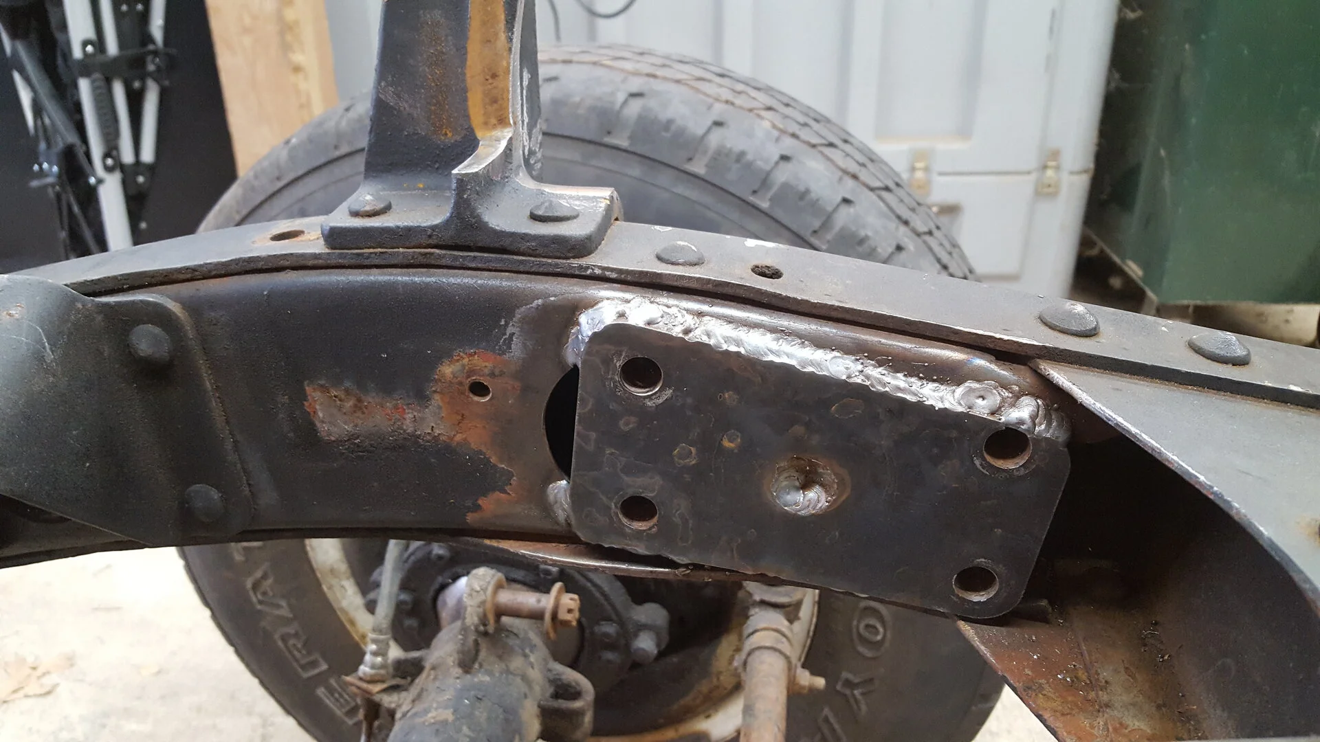

I cut a plate to box the inside of the frame rail. The I.D. of the relay rod from the factory 40 steering box to the center arm is perfect size to make anticrush tubes out of. I had to rig something to cut it with somewhat square because I don't have a band saw.

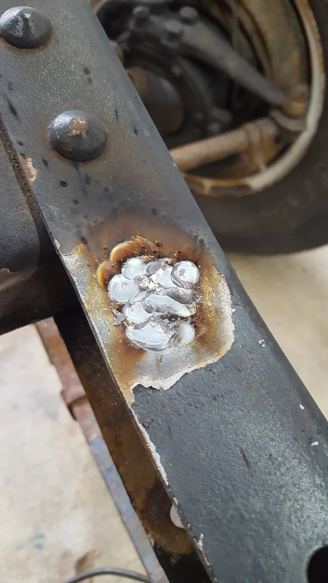

Using an extra plate helps keep it square for welding.
On previous 60 ps conversions I pushed the tube through the outside of the frame, chamfered the frame and welded the tube to the outside wall, then ground it back flat. I don't think that there was a ton of weld that remained and it really served little purpose. Doing it this way the tube is flush to the inner wall of the outside rail.
