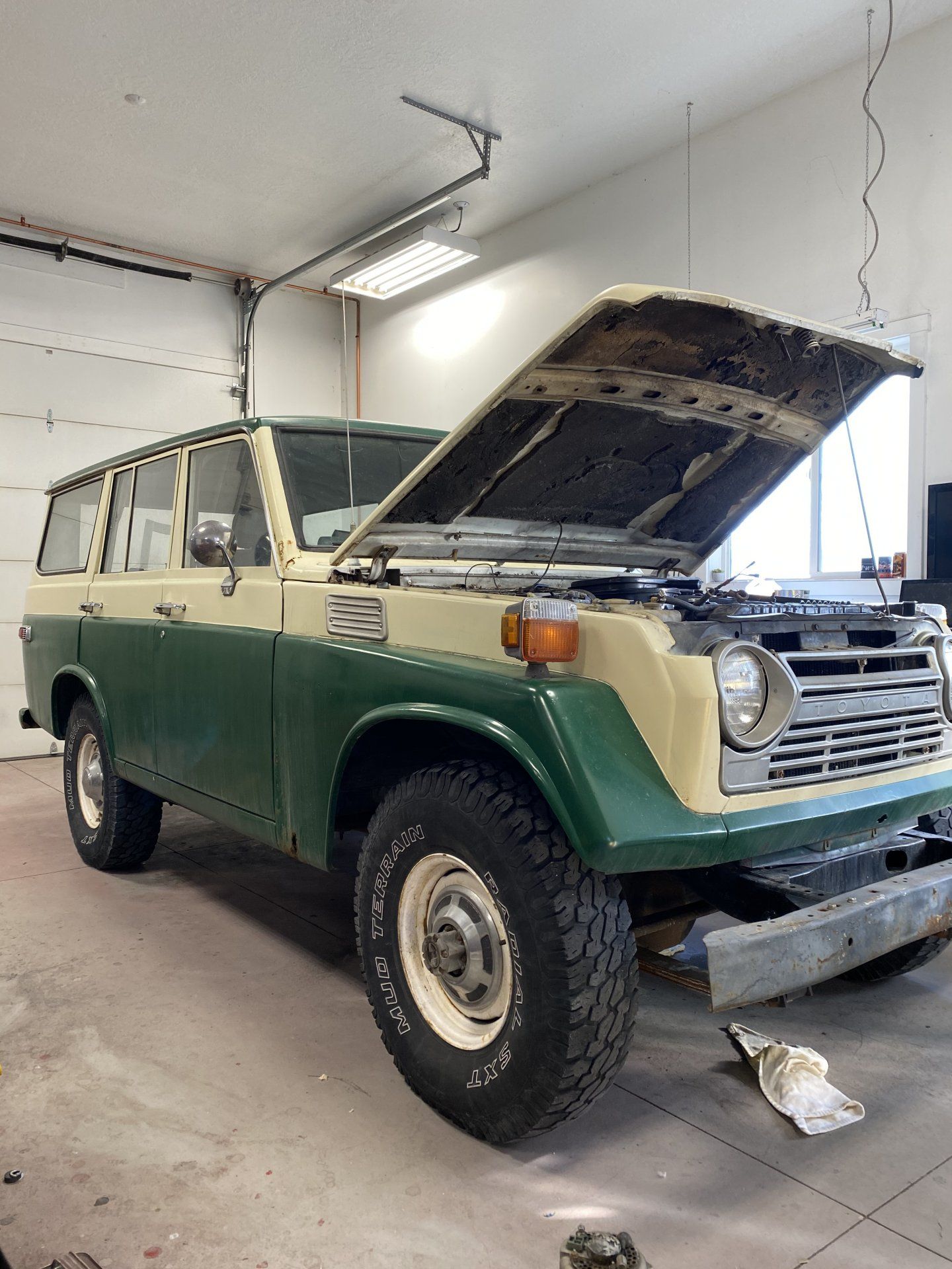

Another 55 added to the bunch.......
Congrats!
Does she still look like this: View attachment 2555892
No, I wish. After a bad pint job and some more rust it looks like the picture below. Although I do like the stock wheels much better.

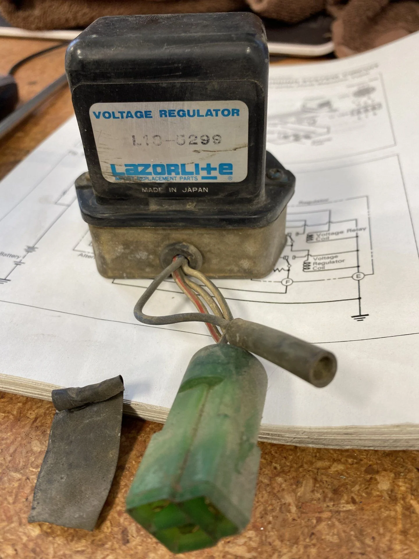

So, the alternator situation didn’t make much sense so I decided to dig into it a little more and I need to retract my previous comment that there was no external regulator. I found it under the intake tube on the drivers inner fender. Now I just need to re-wire the connectors, not sure why they were cut and spliced, but I ohm’ed them out and they go where I expect. Anyone have a 3-prong alternator connector? I’d like to fix it right.
I recently changed my alternator to a 55 amp 60 series alternator and bypassed the external regulator. As Pablo said @Coolerman has the bits to make that easy and a good write-up on his website with instructions. @FJ60Cam can source a refurbished alternator for you if you have trouble finding one.
I’ll have to check out his write up, from the wiring diagrams I looked at it seems pretty simple, I have both types of alternators, but I’d have to rebuild the internal regulated one so for now I may just keep with what I currently have. Thanks for the heads-up, I love having resources like this documented.

This is the connector I found at the regulator, I cut it off and will be fixing it correctly.
Wiring on the regulator side is repaired, still looking for an alternator connector, but at least some progress.

Well, I got the wires repaired and the alternator installed. I was a little disappointed when the remand alt. came with a pigtail instead of the correct plug at the alternator itself, but I guess you get what you pay for. So now I have to decide if I want to wire the original connector in, or wire directly to the alternator. I’m not a big fan of the pigtail, but........
