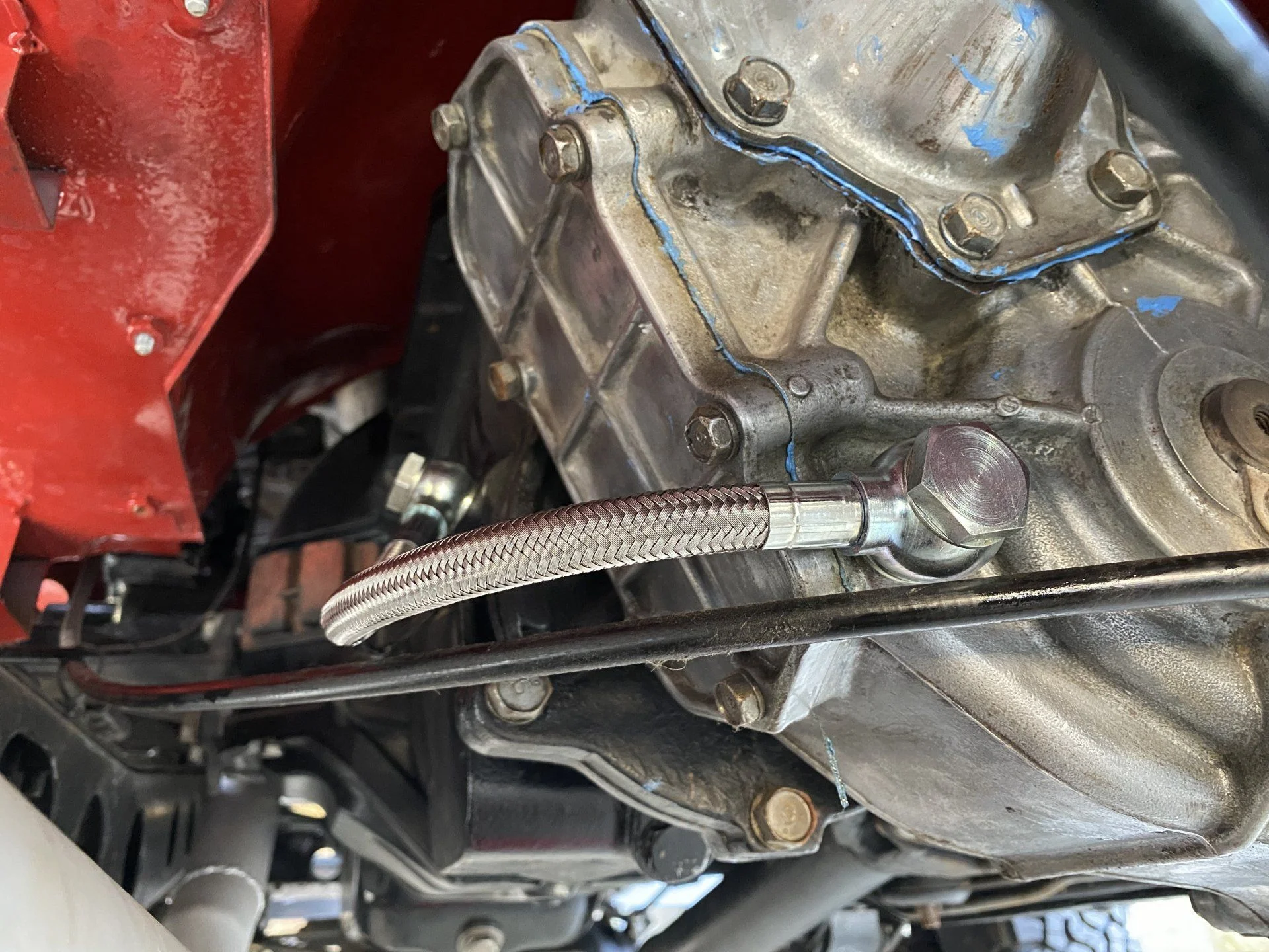

Well, I bought this off @shipmag (transmission / transfer case bypass hose) a few years ago.... I decided today was a great day to install it!!
Edit: I did this back in December, but failed to post it here!!
Thank you @shipmag, that is a great piece of work!
Changed transmission and transfer case oil while i was under the truck.
Transmission oil looked perfect.... transfer case oil looked its age.
5 quarts 90wt did the trick, enough for both.
