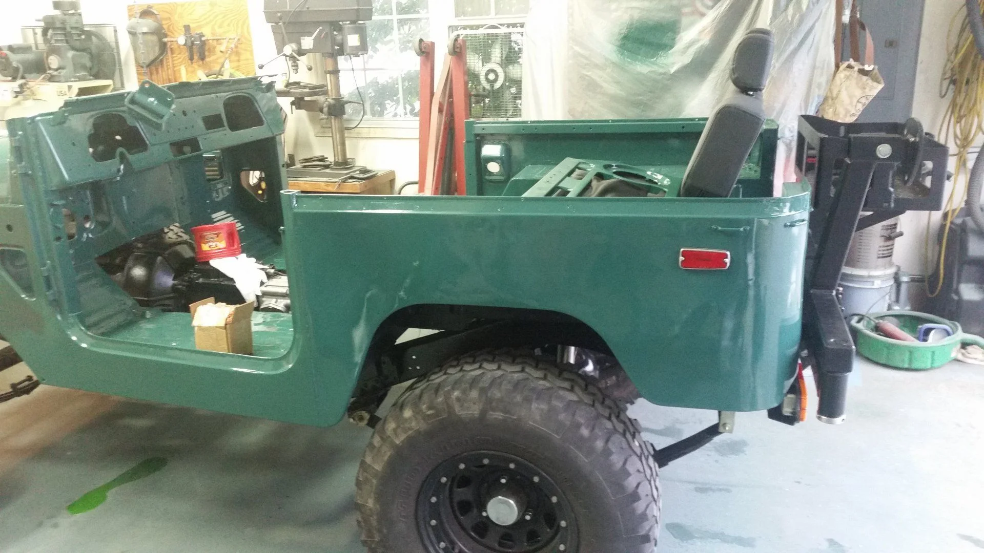

There is something about doing it yourself that... the learning and satisfaction. That beats a showroom finish any day. That said, it sure is shiny!
What did you paint your springs with? Rust Bullet? I'm wondering about keeping things slippery inside the packs
Yeah, I shot them with Rust Bullet. I am going to bet that I should have broke them down all the way, but then again, I am just building something to have fun with!

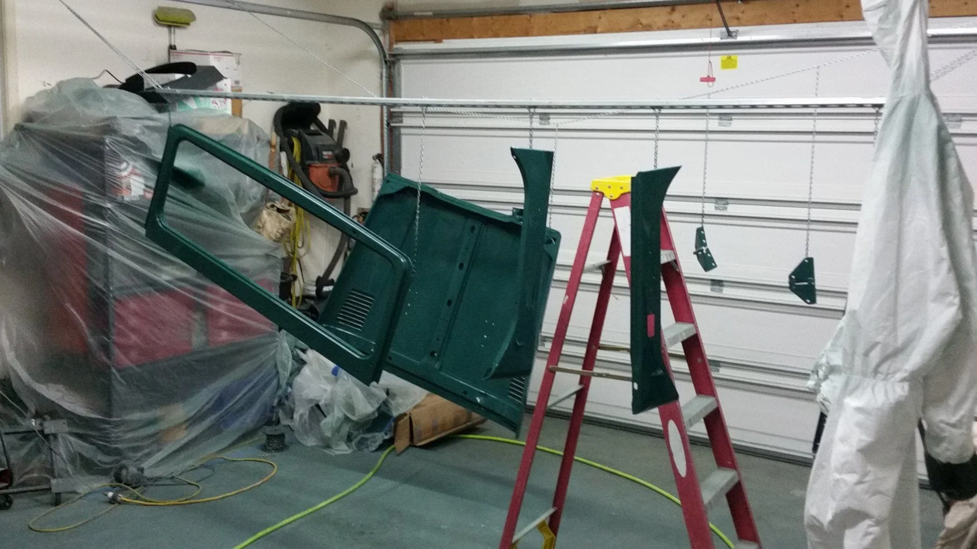

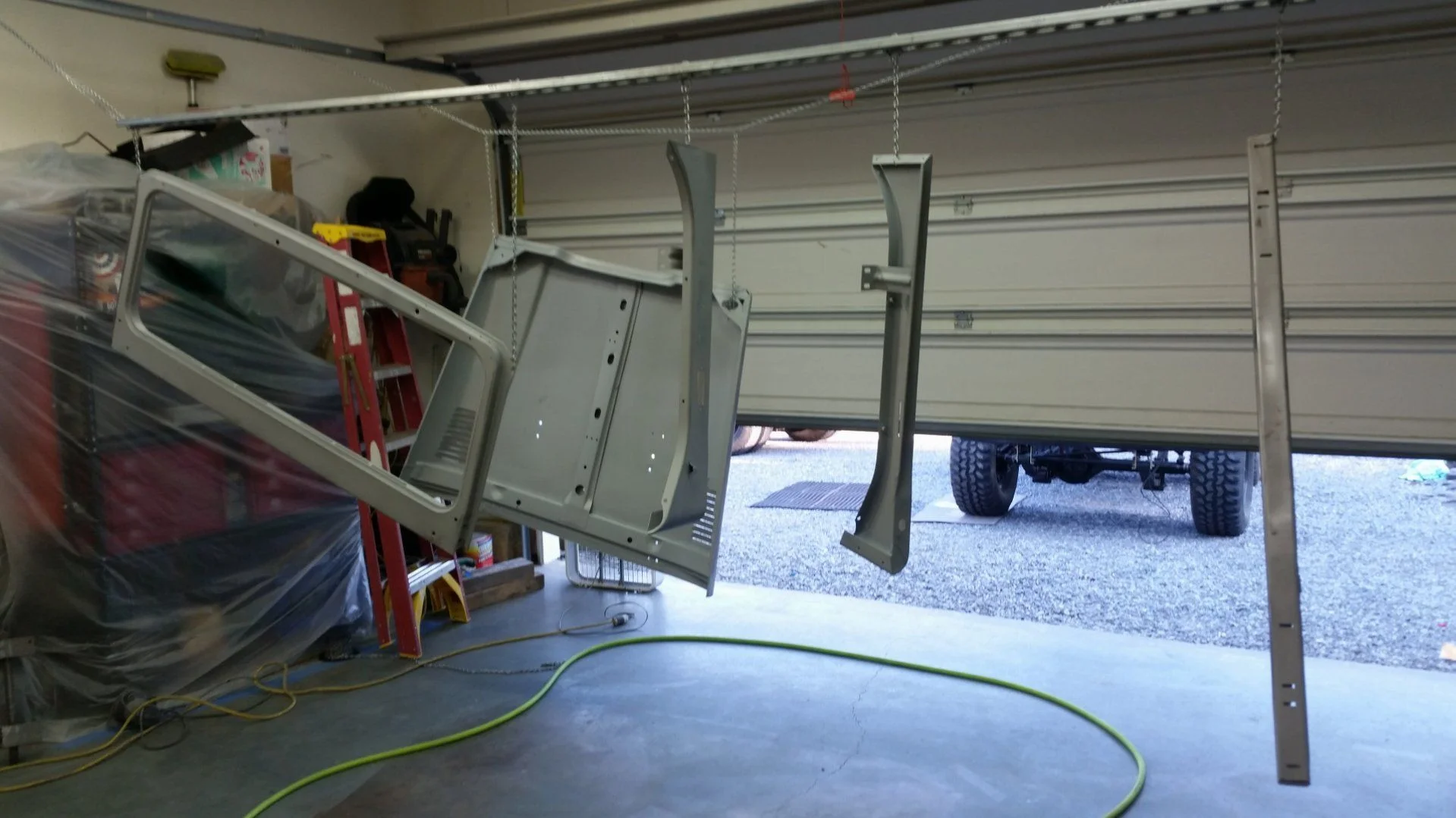

Curious, what did you use for stripping paint? Soda? Paint remover?
I've got a blaster I've used for my frame that will also do soda, just haven't tried he soda yet. Not sure how much profile it will leave
Looks nice
I took my parts to a local shop that does some sandblasting, the frame I did by hand in my front yard. The tub and body parts all got sent out. I'm not sure what they used to blast with.
Local shop in Maryland.
Looks nice
I had my body bead blasted and it came out great, I was told soda was abrasive enough.

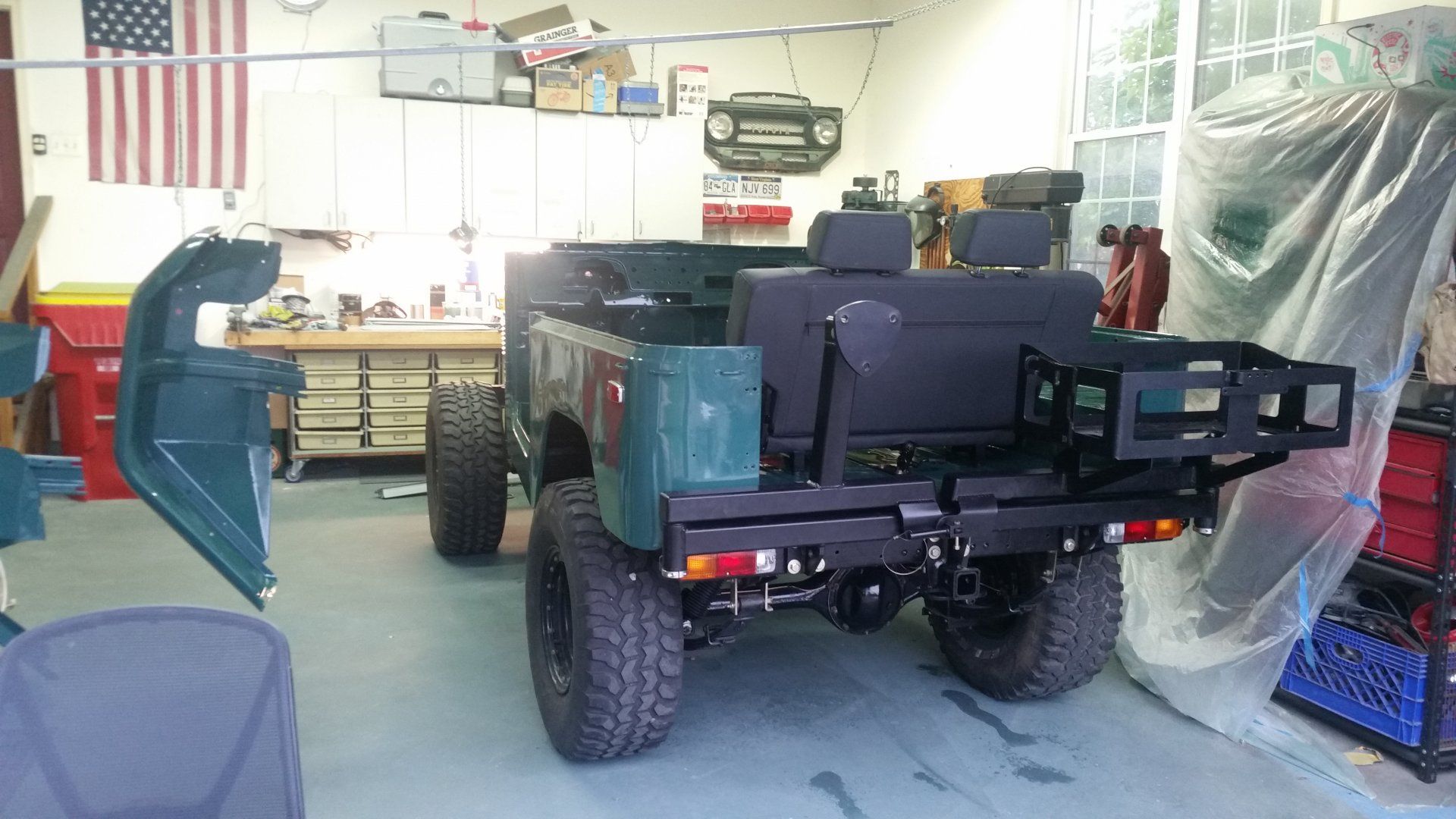

I need to clean out the basement so we can get the house listed, most of the mess is Landcruiser parts! Putting the big items that I can together, staging the rest so I can make the most of my time.
I spend 6 months away, and look at how much progress you've made! Coolio!

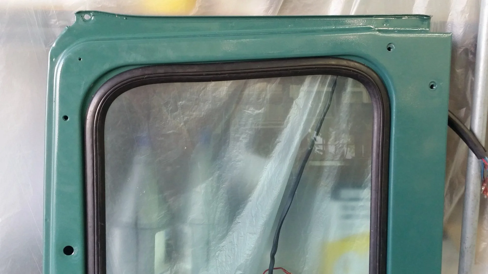

That windshield gasket was a PITA.
