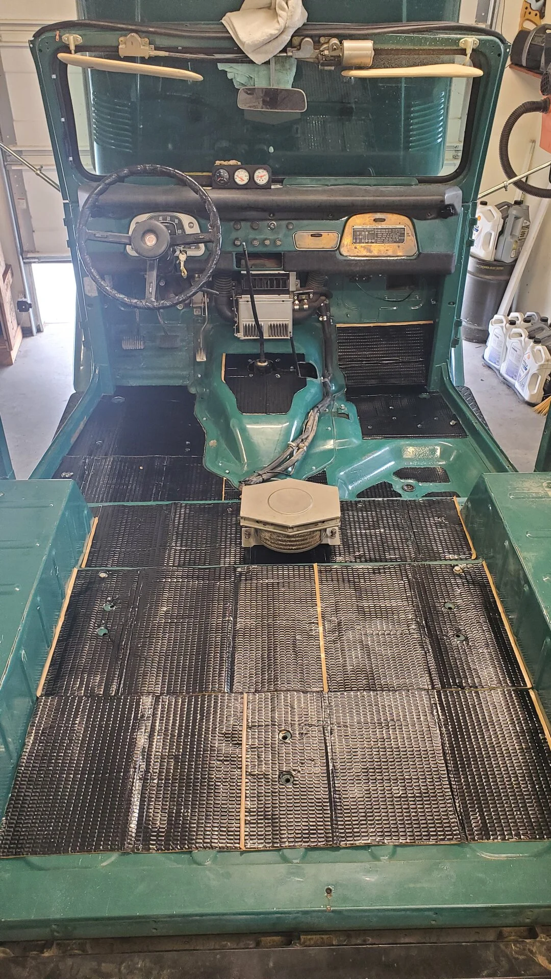

This will either be a massive improvement on noise reduction and insulation in the cab, or it will be the worst idea I've had yet, there's probably no middle ground in that.

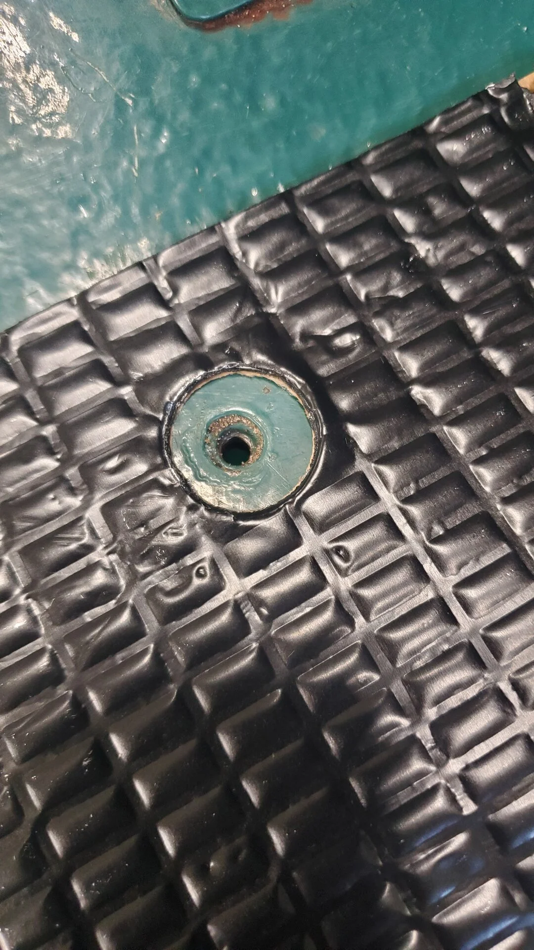

Siless 80 mil sound deadening mat cut to fit in most of the cab, I'm still finishing up the rear.

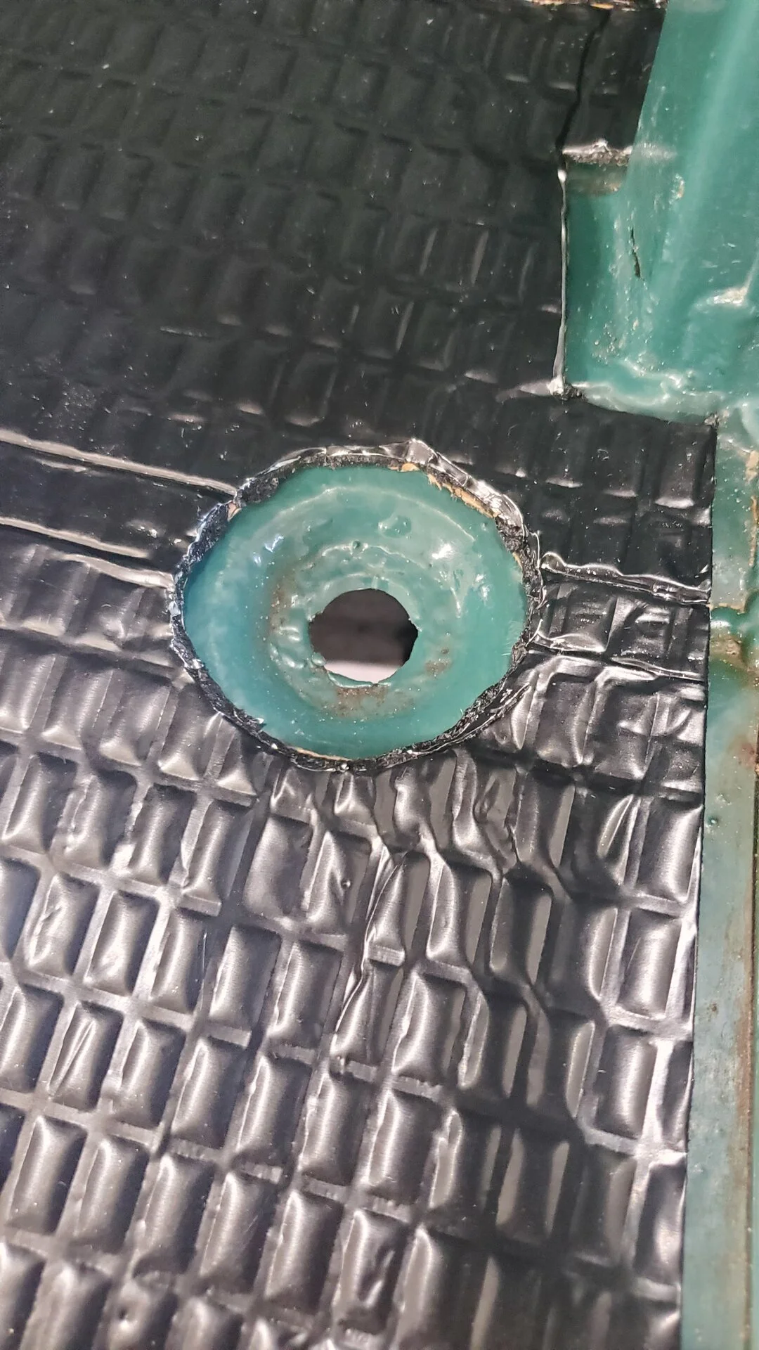

I'm doing all I can to weatherproof every bolt hole and leak prone area I can find, and leaving some extra room around the holes that are in the sheet metal already. All of the unused holes are going to get rubber plugs with some sort of sealer dope to help ensure they're as weatherproof as I can get.
The sound deadening mat is going to get a layer of Siless 157 mil heat insulation over that, then a rubber mat of some sort to cover and protect all of that.
Again, I'm either going to create a complete disaster, or not. Time will tell, and Fluid Film will get sprayed liberally every fall.
I haven't officially stuck it to the body and rolled it on yet, I may need to knock back a couple shots of something strong before I get the courage.

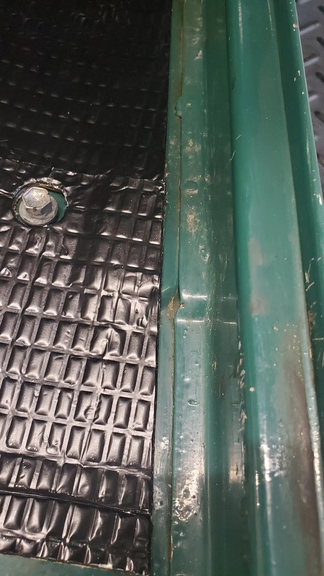

All this has been thought about.
I'm installing it with (hopefully) enough space around the rust prone areas that I can see what's going on, a little space around all the holes, flanges, and seams. May even spray some Fluid Film on some of the worrisome areas in the fall. Hopefully the large flat areas that are clean and free of rust will be fine, it's just the areas around bolt holes and such that I worry about.
Winter is the only time that moisture is much of a concern, the rest of the year isn't bad, and things dry out pretty quickly.
It's definitely something that I am going to need to monitor for a few years.
Is there a way to do this with a removable membrane? Maybe mimic the vinyl/rubber floor mats and adhere the sound deadening and insulation to that?
I thought of that for a while, but it would be a waste for the sound deadening mat.
Just trying to justify a dumb decision.
My original plan was to apply the insulation to the backside of a mat that can be removed to allow everything to air out and dry.

Why not a mat with it on the bottom? That would suck to peel off if it doesnt end up doing much. A mat is removable at least.
Are you putting this inside the doors too? I will be watching this too - wanting to do the same in the near future
Possibly, I have one sheet left at the moment, hoping to save it for the doors.
With it stuck to the bottom of a mat it wouldn't dampen the sound as designed, at that point it wouldn't be anything more than an insulator of sorts, and probably not a very efficient one.
Someone has to do it to see if it's worth the effort or not, might as well be me!
I'm not covering any seams, joints, or holes.
I can vouch for Siless in the 80 and the pickup, I’d definitely put down vinyl or carpet overtop though, I don’t think it would hold up to normal floorboard traffic well on its own.
There was a couple of spots in the 80 where I remember having fitment issues bolting the seat brackets to the floors. I had to go back and cut out the foam/butyl for the bolt holes to line up.
